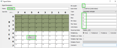

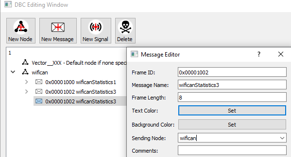

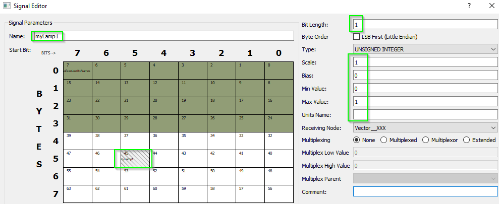

The "conversion" of your findings into a DBC file is indeed a manual process. You found out, e.g. for Lamp1, which CAN ID and which bit in this message controls the lamp. This information you put manually into the data base file (dbc). You can do this with the DBC editor which is included in SavvyCAN.
SavvyCAN->Menu->File->DBC File Manager.
There either press the button "Create new DBC", or load and edit an exiting one.
In the editor, there are two steps do be done:
1. Create a message (button "New message"), which has the ID you found out, and give a name to that message, e.g. myLampControlMessage. Also the length (often 8 bytes) is specified here. E.g.
2. Create a signal within the message (button "New signal").
and double-click on the signal to set its properties. The most important details are the signal name (which you can freely choose), the bit position (which you select by clicking on the 8x8 bit matrix), and the length. This could look like this:
(BTW: The SavvyCAN DBC editor seems to have a bug, it shows in the signal window also signals which are assigned to a completely different message. This irritates, but does not harm.)
