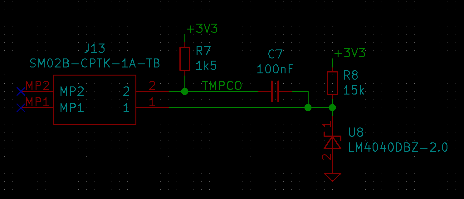

I've done measurements on the coolant sensor that exist in the Prius Gen2, Auris and Yaris inverters.
I can conclude that it is a 2kohm NTC with a beta of 3664 according to measurements done at 25degC and 50degC.
The sensor is connected to the logic board but doesn't go anywhere after the input filter. I will attempt to modify the board and connect it to the Uaux input, which again, on the board is just connected with a pull-up to 3,3v rail, hence always reading 16,43V. The Uaux signal can be sent out on the CAN-bus without modifications to the OpenInverter SW.

Is this the one that's mounted on the coolant pipe connected to the two pin connector on the logic board?

Yes, that the one.
My plan is to connect it like this, where TMPCO goes to the ADC:
EDIT: Using a gain of 4 on the Uaux signal in the OI CAN-interface and then rxBuf is the CAN-data:
const int8_t tempMap[49] = {-20,-18,-17,-15,-13,-11,-10,-8,-7,-5,-4,-2,-1,0,2,3,5,6,7,9,10,11,13,14,
                            16,17,19,20,22,23,25,26,28,30,32,34,36,38,40,42,45,47,50,53,57,61,65,70,76};
uint8_t tempRaw = rxBuf[6];
if(tempRaw < 10) {
tempRaw = 10;
if(tempRaw > 58) {
tempRaw = 58;
inverterStatus.coolantTemp = tempMap[tempRaw - 10];

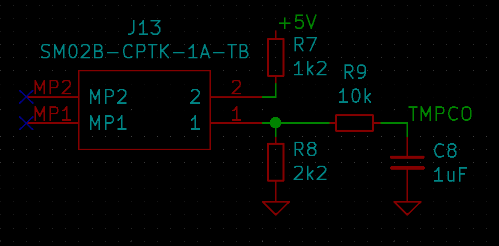

Just realized the the above wount work.
The Uaux pin is the same as the mprot and if you pull this pin "low" it will trigger PWM stop in the inverter => no good.

I think this will work:
Always keeps input above 2V, hence reads as digital high but still enough room to measure coolant temperature with enough accuracy.
