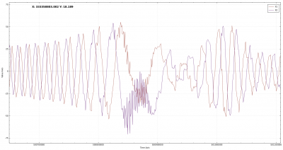

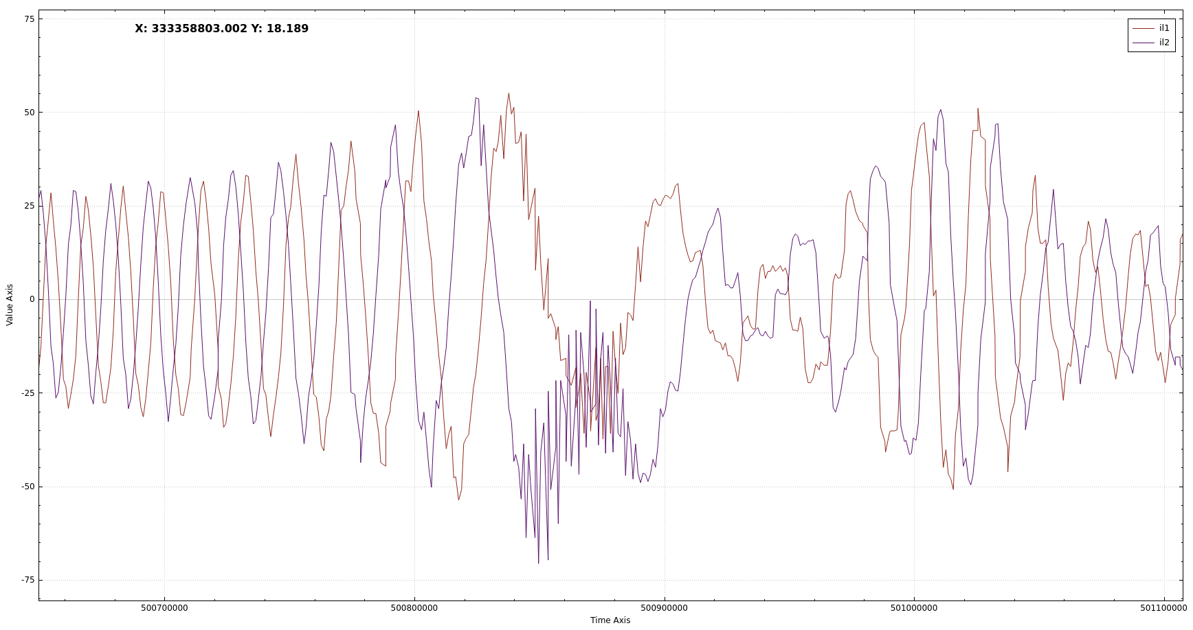

Help! I'm trying to implement the Park Clarke transformations on my data to get an initial two-dimensional representation of my current with respect to voltage angle.
I am using the FOC module in openinverter as it implements the necessary calculations, but the output is nonsense.
I've put together a spreadsheet to highlight what's going on. I'd be grateful if someone could have a look and tell me where I'm going wrong.
The spread sheet does the following:
* Generates 3 phase voltage outputs
* Calculates current (as if there was a simple resistive load)
* Does a Park and Clarke transformations on the result
Unfortunately, things just don't seem to add up. If I swap the ia and ib measurements, things look a little saner (see sheet 2), but I was rather expecting either id or iq to be zero.
I'd appreciate any insight into what I'm dong wrong here!

Update: If I feed -i1 and -i3 into the transform, instead of i1 and i2, I get the expected result (see updated spreadhseet). But why?

Using Ia and Ic into the Park transform also works (Id=0, Iq=3). Need to find a phasor diagram to see which phases are supposed to lead and which lag to see which it should be.
Edit - U2 should lead U1, you have it the other way round (U2 lags) so using U1 and U3 corrects this.
Edit2 - sorry, you have U2 leading. Not completely sure what the problem is but it's something to do with the relative phase of the two phases going into the Park transform.
Edit3 - see https://www.mathworks.com/solutions/ele ... forms.html for a graphical representation. The voltage sequence for maximums should be U1, U2, U3, you have U1, U3, U2. Swap U2 and U3 and everything works.

Thank you. This makes a lot of sense. The V/Hz firmware calculates the voltage outputs like this:Pete9008 wrote: ↑Thu Feb 09, 2023 5:51 pm Edit3 - see https://www.mathworks.com/solutions/ele ... forms.html for a graphical representation. The voltage sequence for maximums should be U1, U2, U3, you have U1, U3, U2. Swap U2 and U3 and everything works.
sine[0] = SineLookup(angle);
sine[1] = SineLookup((angle + PHASE_SHIFT120) & 0xFFFF);
sine[2] = SineLookup((angle + PHASE_SHIFT240) & 0xFFFF);

If I reverse the phase order (so that i1 leads), everything now adds up, except that the final result is negative. I'll check the link provided.
Edit: If I offset everything by 90 degrees I get the results I'd actually expect. So changing the voltage output like this should un-confuse things:
sine[0] = SineLookup(angle + PHASE_SHIFT90);
sine[1] = SineLookup(angle + PHASE_SHIFT90 - PHASE_SHIFT120);
sine[2] = SineLookup(angle + PHASE_SHIFT90 - PHASE_SHIFT240);

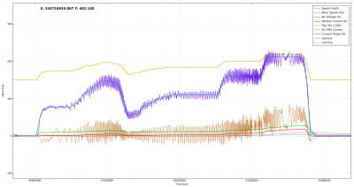

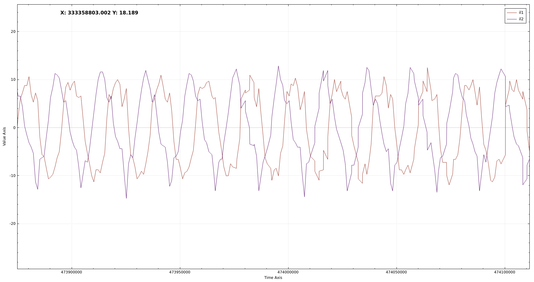

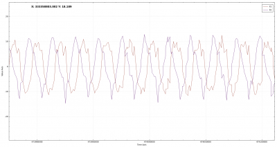

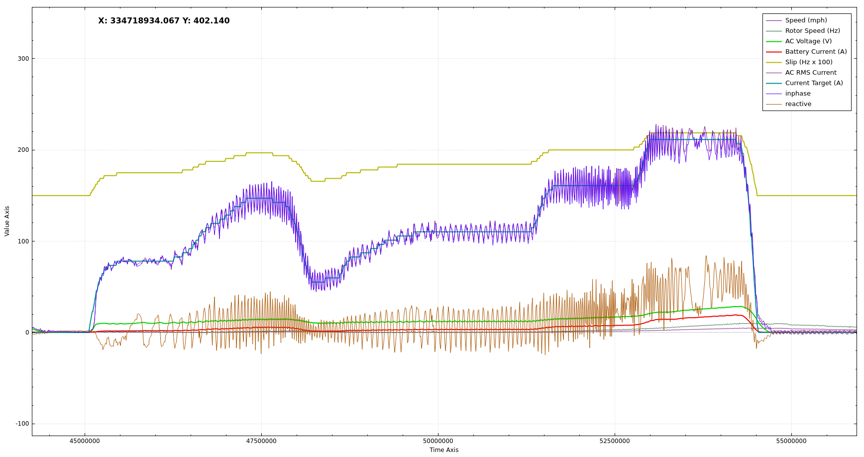

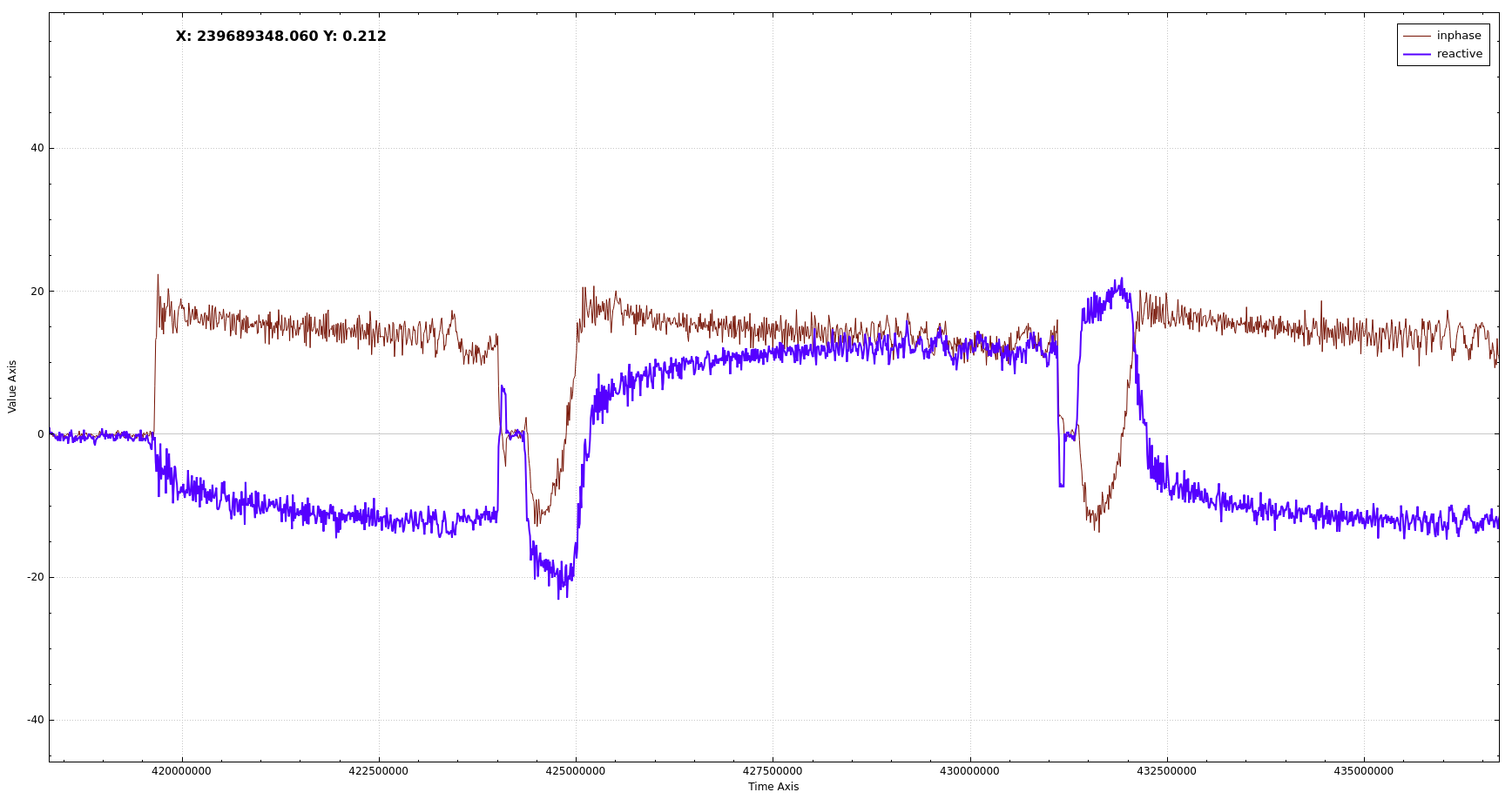

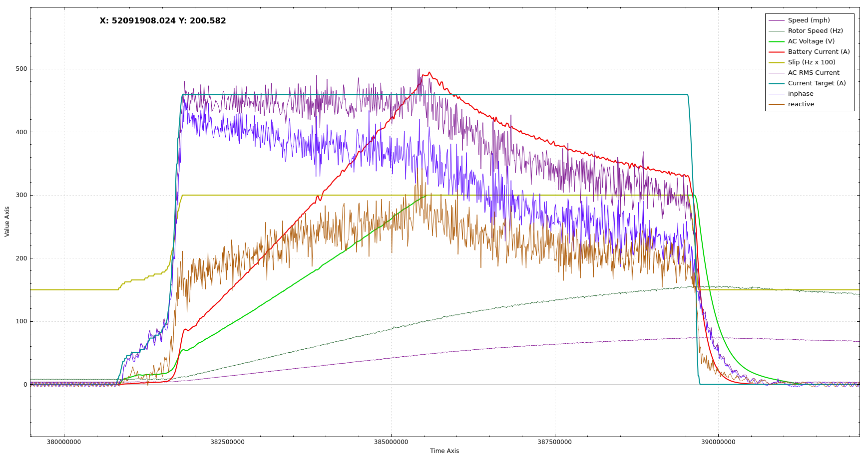

This is now working. By applying Park and Clarke to the measured current using the angle of the voltage as the reference angle, we can obtain some new data. I believe the id and iq values in this case represent inphase, and reactive current respectively. Here's a excerpt from a basic bench test showing forward acceleration, followed by two reversals of the torque direction (and as a result rotor direction).
The inphase current (brown) shows a positive value during acceleration and a short negative period (regen braking) during the direction change. The direction of the reactive current (neither positive or negative, since it's at a tangent to voltage) depends on the rotor direction.
I'm not sure if this is useful, and it's a slightly different direction from what I was planning, but it's interesting to have another view of the data.
It seems I now have three possible directions I can go in to attack current control:
1) Calculate per-phase targets as planned. My main worry here is that there will be no feed-forward with this approach. Individual phase currents change much faster than any other metric, so I'd need a much tighter control loop.
2) Translate the measured phase currents into amplitude and angle rather than just amplitude. This gives me two corrections that can be made rather than just one.
3) Use the id and iq data (inphase and reactive current), and attempt to make corrections to those. This is essentially a variation of the amplitude-angle model, but probably an easier one to work with mathematically.
The part I need to get my head around is what targets to set, and what corrections to make to reach those targets.

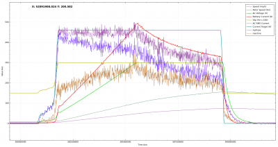

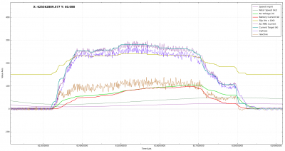

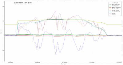

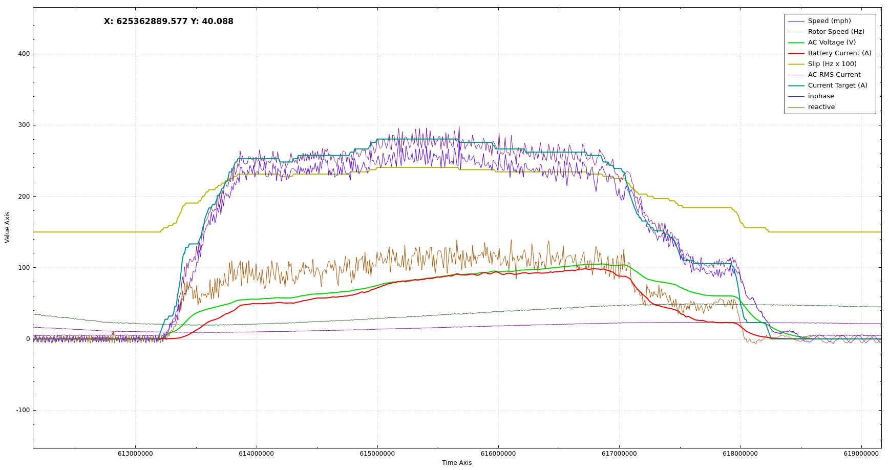

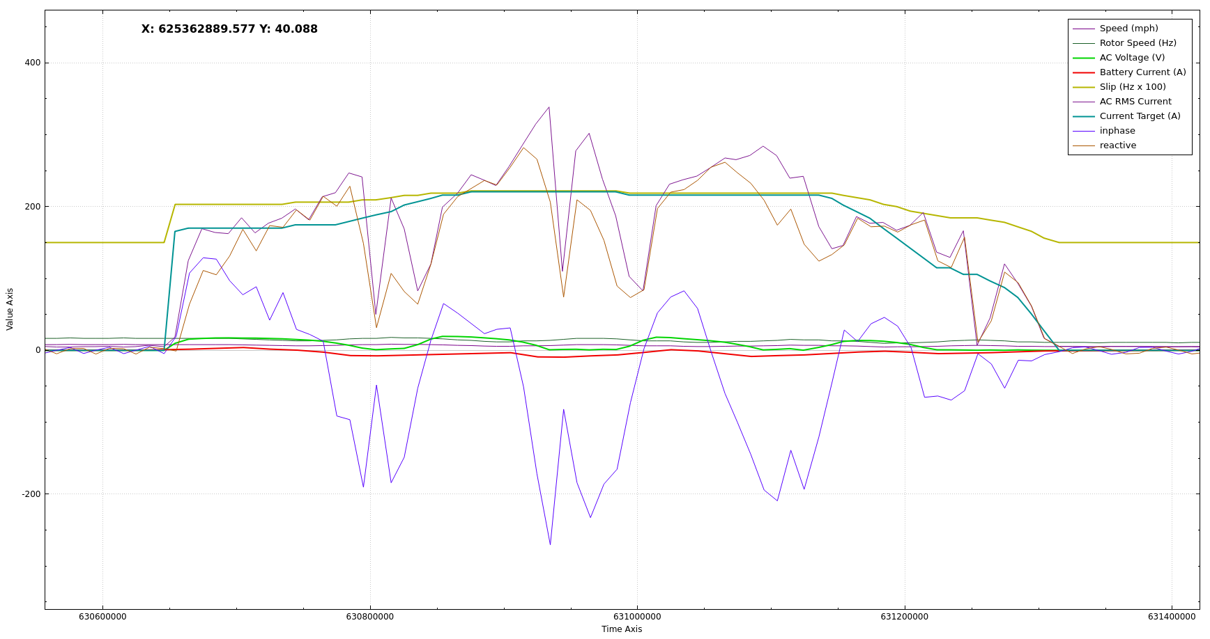

I loaded the inphase and reactive current logging firmware into my car today and went for a drive. Here are some results.
Hard acceleration 0-60 Steady driving 50% current Very low speed creeping Regen (selected by changing slip direction with selector while rolling) Some of this data makes a lot of sense to me. Some of it less so

Interesting results but I must admit I'm struggling to see where you are going with this (which is why I haven't commented previously).
As far as I can tell you have invented a new and novel way of measuring the real and imaginary power going into a 3-phase motor??
The transforms look like they are working well now.

You are correct that I have no idea where I'm going with this, but I'll try to explain how I got here!
At the moment, we generate three phase voltages at a desired frequency, and I wanted to work out how I might get from that starting point, to instead directly controlling current.
The first question I had was how the phase currents differed from the phase voltages. It seemed that the best way to represent this was with two-dimensional plots. Then, rather than having to plot two-dimensional voltage, and two-dimensional current separately, and try to compare them, I decided to rotate the current measurement by the voltage angle to create a two dimensional plot that directly represents the two-dimensional difference between commanded voltage, and measured current.
On the topic of current control, when it's time to make my three sine waves into current targets rather than voltage outputs, I hoped this data might give me clues about how best to modify the voltage and frequency outputs to achieve a desired current. The obvious approach to current control is still to measure each current, then output a voltage correction on each phase accordingly, but I wondered if this might offer ways to make the same corrections but in a rotating reference frame with much less gain.
However, while this isn't really what this thread was supposed to be about, but I got super interested in this real/imaginary power plot, for a couple of reasons, most notably because if there is an optimal balance between real and imaginary power, I thought I might be able to adjust slip automatically to achieve it, giving optimal results at any speed without the need for manually configured slip limits.
Ultimately, I feel like the more ways I find to examine the data, the more I will understand the operation of the motor.
Yes, this is probably an unnecessarily obscure way to measure this, rather than just multiplying the voltage and current on each phase. It's just where I ended up when I started trying to look at current in the rotating reference frame.
I found a couple of papers on controlling induction motors on the basis of real and reactive power:
https://digitalcommons.lsu.edu/cgi/view ... ool_theses
https://www.researchgate.net/profile/Re ... ion_detail
Ultimately, these seems to be a correlation between slip, and the ratio of these currents, so understanding how they behave may be beneficial. I don't believe this necessarily helps with the problems I was trying to solve though. Just an interesting tangent!

I can't help but think that this is the way you will end up doing it. Which reference frame it is best/easiest to do it in is a very good question (and I haven't a clue)!catphish wrote: ↑Fri Feb 10, 2023 4:02 pm On the topic of current control, when it's time to make my three sine waves into current targets rather than voltage outputs, I hoped this data might give me clues about how best to modify the voltage and frequency outputs to achieve a desired current. The obvious approach to current control is still to measure each current, then output a voltage correction on each phase accordingly, but I wondered if this might offer ways to make the same corrections but in a rotating reference frame with much less gain.
Doing something just because it might help understand the system is an excellent reason in my bookcatphish wrote: ↑Fri Feb 10, 2023 4:02 pm However, while this isn't really what this thread was supposed to be about, but I got super interested in this real/imaginary power plot, for a couple of reasons, most notably because if there is an optimal balance between real and imaginary power, I thought I might be able to adjust slip automatically to achieve it, giving optimal results at any speed without the need for manually configured slip limits.
With zero (unachievable) slip the Iq and Id you calculate are actually correct for the rotor field. As the slip increases the vector rotates and more current appears to be transferred from d to q. So, as you say, the ratio could be thought of as a way of measuring slip.catphish wrote: ↑Fri Feb 10, 2023 4:02 pm I found a couple of papers on controlling induction motors on the basis of real and reactive power:
Very interested to see where this ends up going.

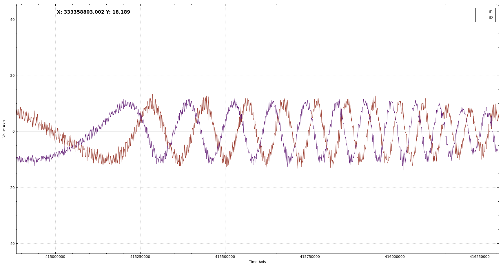

EDIT - just twigged what the ripple on the Iq and Id plots is, it's the 5th harmonic distortion isn't it! That would mean that if you use Iq and Id in the control loops it should still eliminate the harmonic content (and avoid the three individual phase current controllers from fighting each other which is something that's been bothering me). I think you may be on the right track here

Here's my initial attempt at realtime per-phase current control: https://github.com/catphish/stm32-sine/ ... #L86..L118
Here's what the result looks like on the bench at low frequency: And high frequency: And here doing a sudden direction switch (peak target current set to 50A): High frequency oscillations can be seen when operating at low frequency. Clearly some more work is needed, but it's looking promising so far.
Edit: Just to clarify, waveforms aside, the motor appears to run perfectly / smoothy but with no load, this is only a very rudimentary test.
Edit2: It's worth noting that I've increased the frequency the calculation runs from 4.4kHz to the full 17.6kHz. I wonder if it would be worth doing the same on my main current control branch.

I think tomorrow I will re-run this test with an oscilloscope attached to the current sensors so that I can see what the waveform really looks like (ie better than 1ksps resolution). I will also look at plotting the voltage output for comparison.
It seems my gain is probably a bit too high, hence the oscillation, but I suspect this may actually be improving high speed performance as the overshoot becomes "predictive" at higher slew rates.
