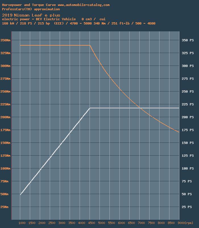

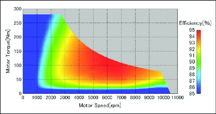

Hi everyone,
I have a gen 2 EM57 and inverter, and I have bought an Openinverter board but have not installed anything into the car yet. I am trying to calculate the expected performance for a given battery cell count, and thought I should ask for some help. The reason I'm asking this now is because I am considering using fewer cells from my Chevy Volt battery, and want to make sure I fully understand the impact that will have on how the car drives. The main reasons for this are for space and weight savings, as the car will be used mainly for Autocross.
We've probably all seen this graph before: Looking at the peak power, it seems to be 275 N-m at 2750 RPM which of course equals 80 kW.
Then there's this chart for the 160 kW Leaf: Here, the motor makes constant torque all the way out to 4600 RPM.
I know the 160 kW Leaf has a higher capacity battery, but I thought the voltage was the same. My understanding was that in order to maintain a given torque into a higher RPM, the voltage input had to be increased to overcome field weakening, so I would have expected the 160 kW graph to look like the 80 kW graph but scaled vertically by a factor of 2 (at least, approximately, and assuming the battery voltage is the same). Similarly, I thought that if you wanted to increase the speed at which field weakening takes over, the battery voltage had to be increased.
So, if I wanted to set up my Openinverter to increase the max current by 50% (120 kW), what would my graph look like? And if I wanted to decrease the battery voltage by say 12%, then what?

Re: Leaf EM57 estimated output at different voltage/current
That is in EM57 just to protect the battery. If you use more powerfull inverter it doesnt have that limit.

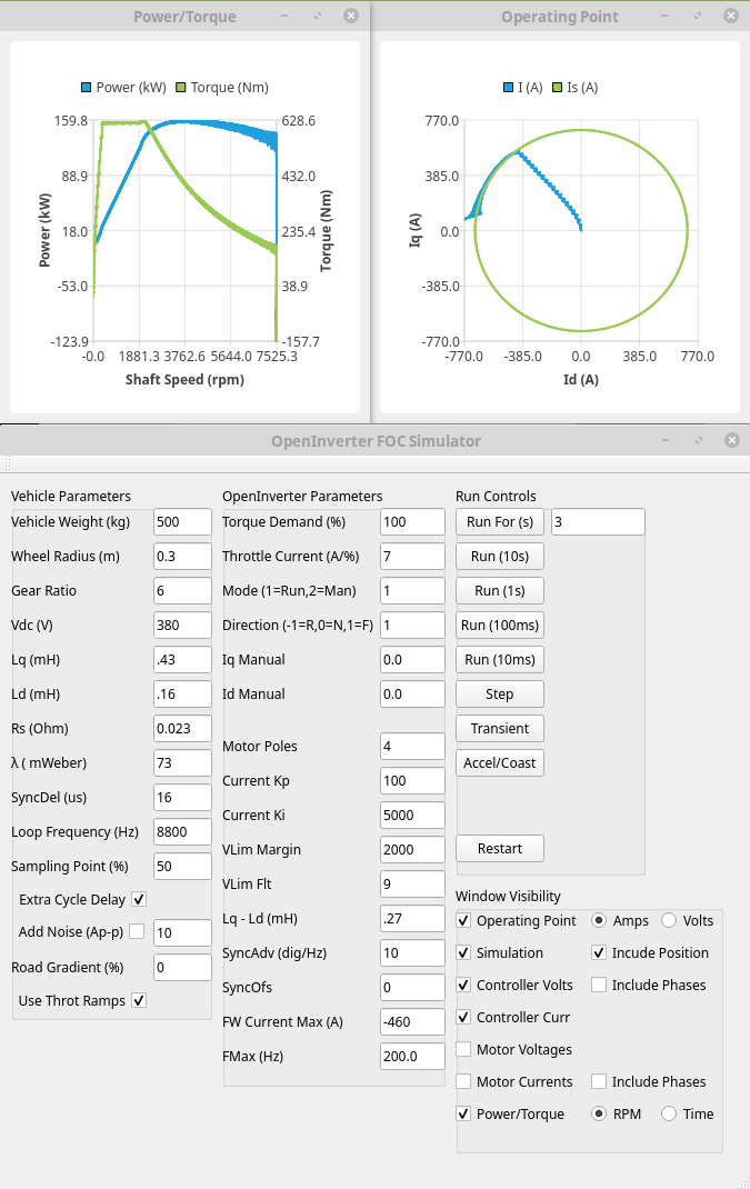

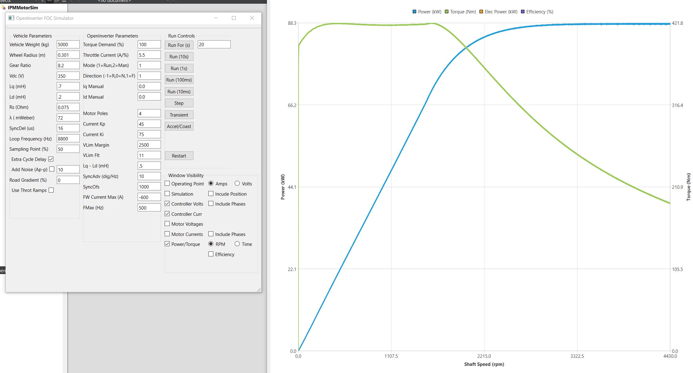

Awesome, thank you so much!
I suppose I should next ask if anyone has some Inverter settings that work well with this motor. And the latest firmware version. I started off with the Leaf motor example and GT86 parameters from the wiki, but it looks like some of the parameter fields have changed.
I can get it to spit this out, but I can't really figure out why the torque is dropping off at such a low RPM.
Glad you got it working
Try more FW Current Max, it should be set to around -flux linkage/ld so around -500.
Because of the low value set you are running out of -Id at higher speed and the control algorithm is having to back off the power instead to maintain control over the motor.
Okay, I think I am making progress! Thank you! I plugged in those settings and got some pretty weird graphs, but once I started adjusting the Current Kp and Ki settings, it started to look better:
It still seems down on peak power and the torque is still falling off at a lower RPM than I would have expected. Increasing the FW Current Max beyond 600 started to produce some weird results into the higher RPM range. Peak power is still only around 88 kW.
I also had to keep the vehicle weight pretty high, I think if you lower the weight too much, it starts doing some weird stuff (graph turns into a spiral). In any case, my vehicle should come in closer to 800 kg and probably won't be able to use much more than about 300 N-m of torque, which is why I'm so focused on where it starts to drop off (or, more to the point, where the torque begins to drop below ~300 N-m).
Unfortunately I've not used the simulator much with the latest OI firmware, or with Leaf parameters, but had a quick go with it yesterday. It's definitely not as stable as I remember and the power does seem a bit down. When I have time I'll try to have another look. Johannes probably has most experience using it with Leaf settings - @johu - any suggestions?
Regarding power there are a few things that could affect it:
- Wrong parameters - flux linkage in particular has a big effect on torque. If anyone has a running Leaf/OpenInverter setup with a web interface some csv logs would be very useful to verify we have the right settings - see viewtopic.php?t=3047
- Mtpv - I'm sure there is more power to be had in FW but haven't been able to progress it recently (see viewtopic.php?t=3080 for more details).
- There is no point going above -flux linkage/Ld for FW current. The flux linkage/Ld is the point that gives minimal back emf, so maximum field weakening, moving away from it in either direction just makes things worse. The spirals you mention are usually when the control loops are trying to find the minimum but instead of hitting it are circling around it.
- Unchecking the extra cycle delay box will improve stability. It means that the simulator doesn't fully represent the way the PWM values are updated in the OI firmware but that shouldn't matter for what you are doing.
- Until we know we have the right parameters for the motor, and the Mtpv stuff sorted, it may be worth not focusing too much on the absolute power levels and just use the simulator to evaluate the relative change produced by different battery voltage and throttle current settings. The other option is to tweak flux linkage (probably the parameter with least certainty at the moment) till you get values that you believe.

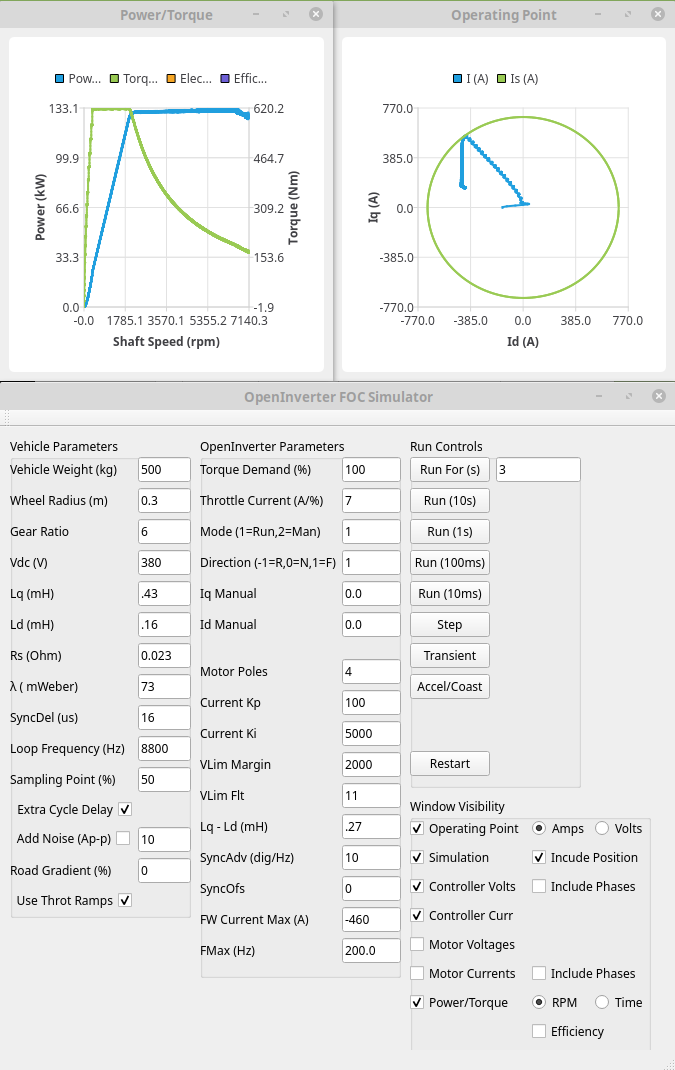

Two things. First Dusty4 very kindly took some logs from his Leaf motor (see viewtopic.php?p=52875#p52875) so we have some better motor parameters to try
Also I've had a look at the simulator to see what's causing the stability problems and have found a fairly obvious bug
. If the motor current goes above around 400A using the standard param_prj.h file the adc saturates and the stability issues start. Essentially this is simulating the behaviour of the inverter correctly but the default file is for a Prius inverter which has a lower range on the CTs, not normally a problem on the Prius but if the same file is used on a Leaf setup without revisions you get adc saturation and stability problems. Sorry about that.
This is probably why you found the need for the very low kp and ki gains.
To fix change the lines in the param_prj.h file (the one in the same directory as the IPMMotorSim.pro file) from
to
and rebuild the project. This should fix it in the simulator.
Here are a couple of plots using Dusty4's parameters and the fixed simulator code. First with the standard code: And next with the pseudo Mtpv derivative I'm working on: Unfortunately the later isn't ready to be released yet. (Edit - but it is getting a lot closer to your 250Nm @ 6krpm)
Oh wow, that's awesome! Thank you so much! I was just typing out a reply to thank you for your last post and when I hit submit, it told me there was a new post, haha. I'll make that change shortly and retest. I really appreciate all the help. Again, THANK YOU!

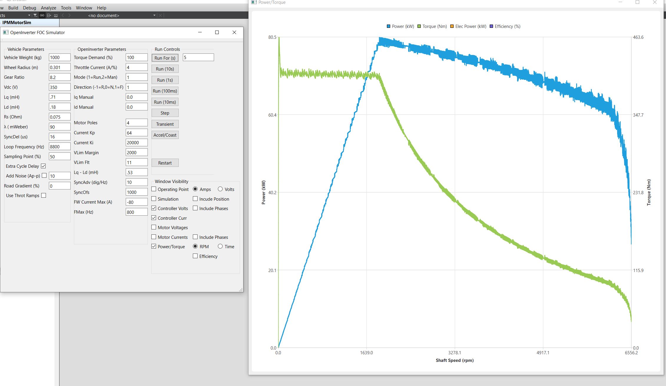

Hi, the settings here has helped a lot. I have set up a "dyno" rig to try to find out how to configure my setup for my boat using only 48V. I'm using Auris inverter (about the same spec as Prius inverter I guess) and Nissan EM57 motor. The KV of the EM57 is 18.46 according to sources, and correlates very well IRL. I'm able to get around 850 RPM on my EM57. Question is, is it possible "to learn this setup new tricks" with field weakening? I find no setting in the latest v5.24.R FOC to tweak so that I could get more RPM. Problem is, I do not want to go beond 48V on the battery side and the boost converter on the Toyota inverter seems to be very limited, only able to squeeze 3kw out of it before the heat sinks scream for help. Is it possible to trade torque for RPM in my setup? I would only need to go to 1500 RPM.

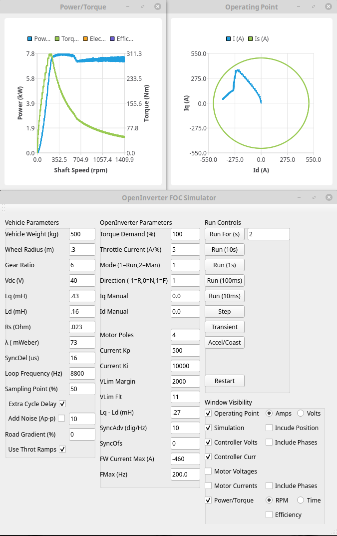

Was curious what might be possible here so did a couple of simulations. I've used 40V to allow for the voltage drop across the IGBTs and diode's. First with the standard parameters:
The boost converter is limited to around 100A so at 48V this is around 4.8kW so it's not too suprising that you struggle to get more than around 3kW before things start to get hot.
I think you will be better off bypassing the boost converter (to remove the series resistance) and driving the DC bus directly from the battery. You should then be able to get around 8kW. If you need more then I'm afraid that you will need a higher battery voltage or a different motor. It might also be possible to rewind the Leaf motor to suit lower voltage operation (see posts by Romale).
Edit - thinking about it 40V might be a little pessimistic (some of the volt drop is already included in Rs) so another plot at the full 48V to give the optimistic view on what could be expected: So 10kW - the real figure will hopefully be somewhere between 8 and 10kW.
There is a bit of oscillation coming in at higher speeds so another with the PI gains increased to compensate for the lower voltage (the actual gain seen by the motor is the product of the gains and the battery voltage):
So the limit is about 8kW up to the speeds you need. The motor is actually in field weakening above around 350rpm.The boost converter is limited to around 100A so at 48V this is around 4.8kW so it's not too suprising that you struggle to get more than around 3kW before things start to get hot.
