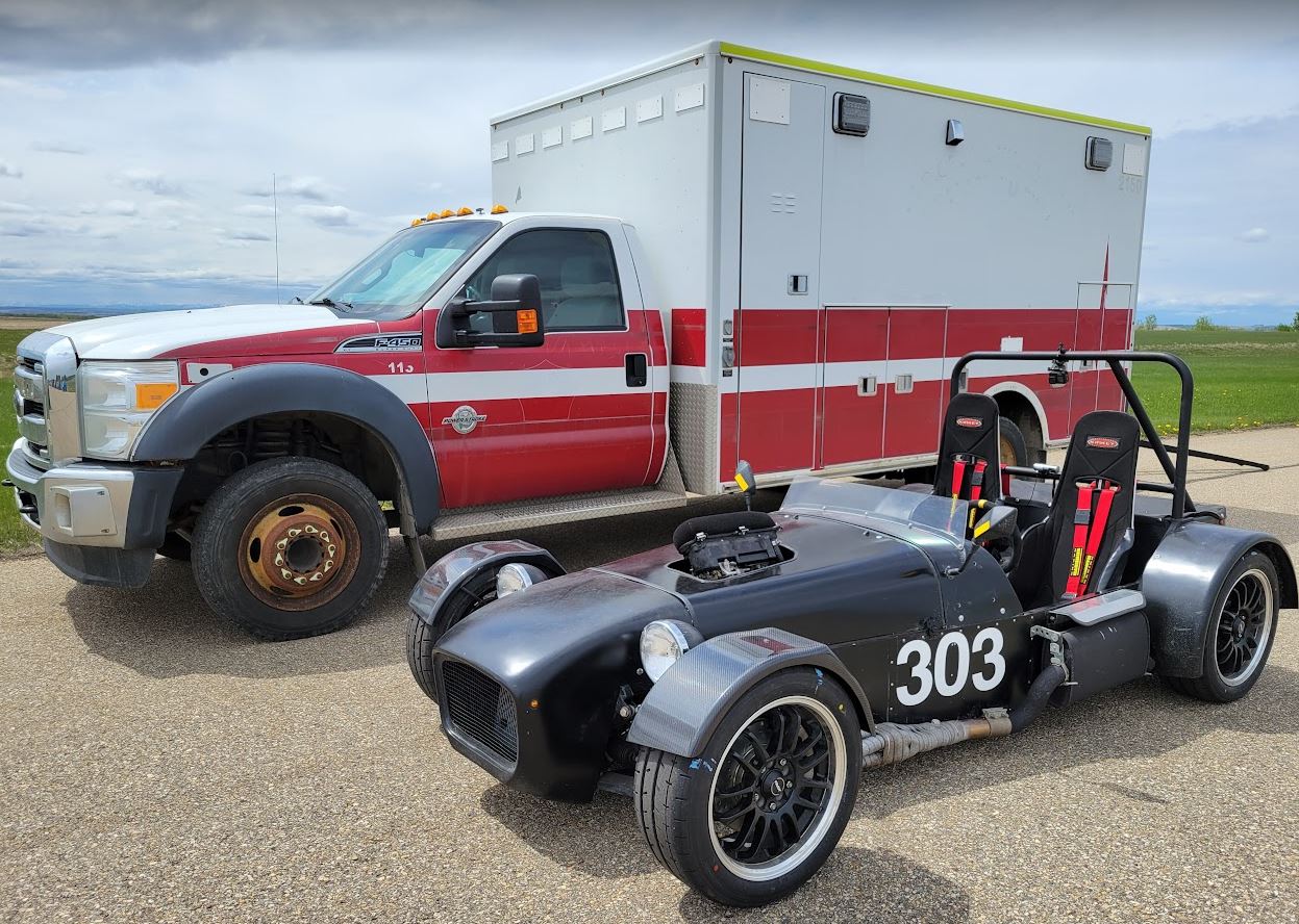

As I am getting further in my project and coming here for more help/info, I thought I should also explain my build and present my work to date.

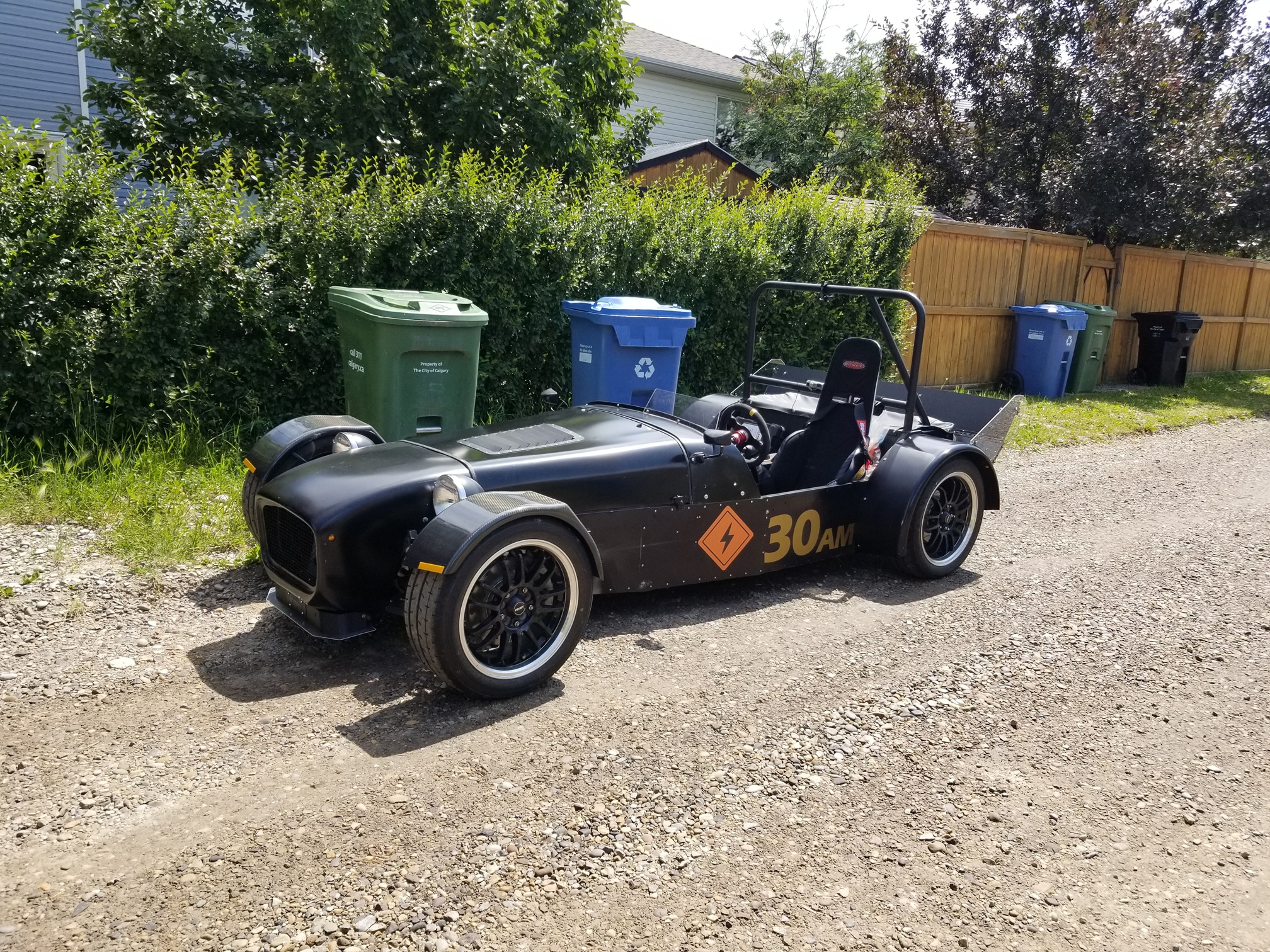

I built this car entirely on my own and completed it in 2019. It is based on a Lotus/Caterham 7, following the original 'book' dimensions for such replicas. That is to say, it's the smallest chassis size commonly used. Many are widened, stretched vertically and longitudinally, but not this one. I built it primarily for Autocross, but I also wanted it to be street legal. That meant some extra weight due to things like headlights and tail lights, a passenger seat, and a 16ga steel floor pan for safety. All told, with fluids and no driver it came in at a hair over 1200 lbs (550 kg). It's been fun to drive with the motorcycle engine (2004 Yamaha R1), but the bike engine is not so great for street use, and even at autocross its lack of low end torque made things difficult. Due to the high redline, I could go 110 KPH in first gear, but in 6th gear on the highway it was still over 5000 RPM - that gets old pretty quick. Also, even after repacking the muffler after every other event, I was still always on the edge of being over the noise limits. So, I asked myself, how can I make more low end torque and reduce noise at the same time? :D
Here's how the car looked at the end of last season:

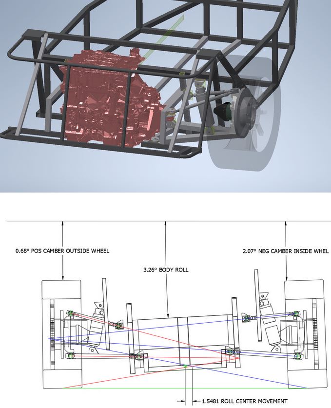

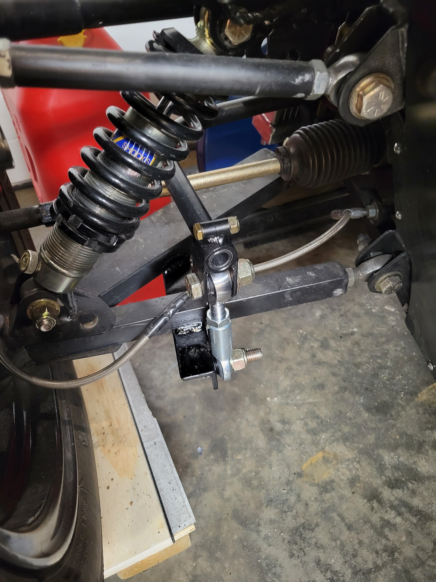

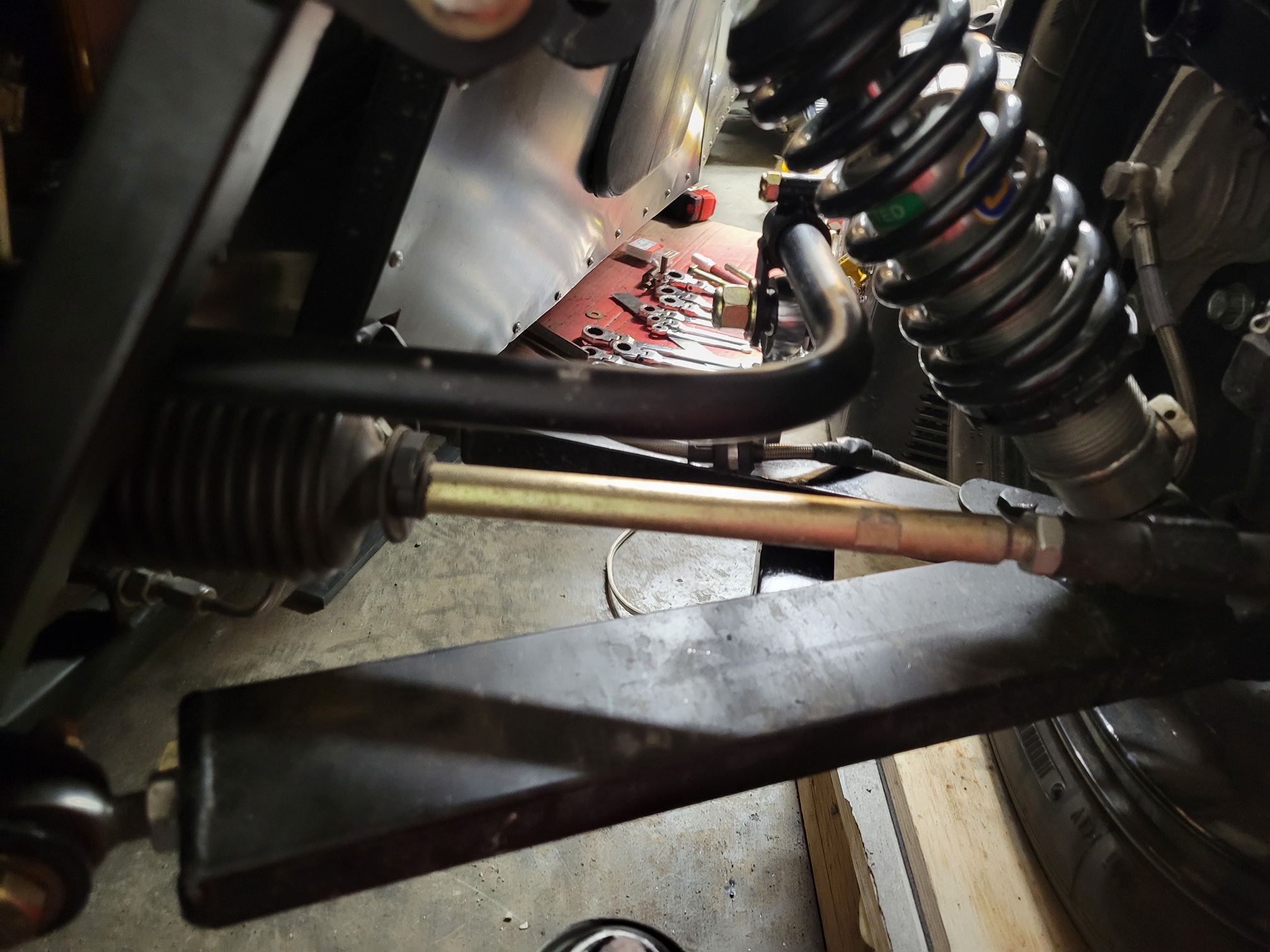

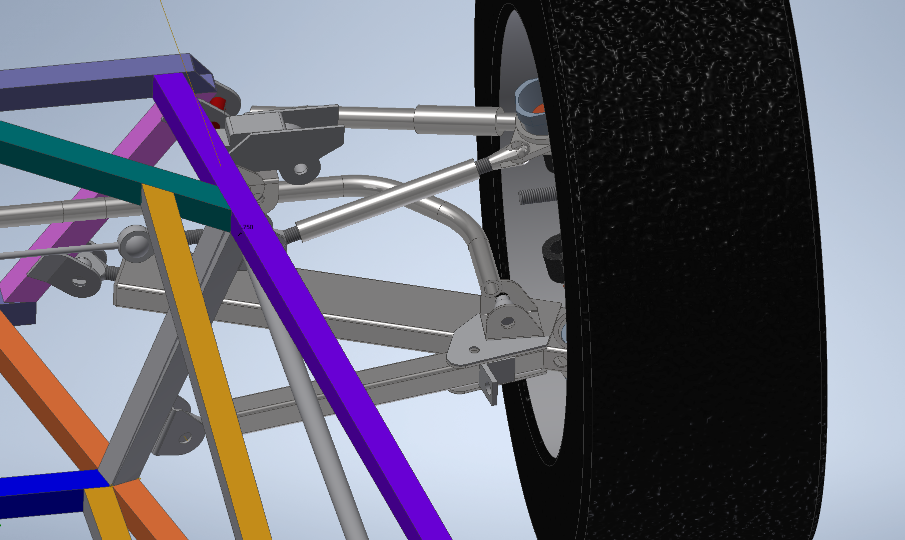

I also designed the suspension myself (I'm a Mechanical Engineering Technologist by trade), so I already had CAD models to work with. I decided to use the Leaf motor and gen 2 Chevy Volt battery modules, and at first I looked at mounting the Leaf motor in the font and cramming the batteries around it, and in place of the fuel tank in the rear. That didn't look great.

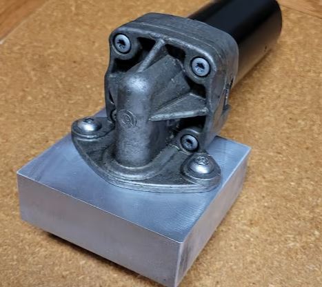

Eventually, I decided my best course of action was to do away with the heavy (60 kg?) rear axle and use the Leaf motor together with its gearbox, with a new independent rear suspension. I'll need to shorten the half shafts, but that looks easy enough. I also had to mount the motor backwards. I know that people using unmodified inverters, this also requires swapping two phases to the motor and to the resolver. I'm not sure how they deal with the resolver offset being effectively backwards, but since I am using an Openinverter board I don't believe I will have to worry about any of that.

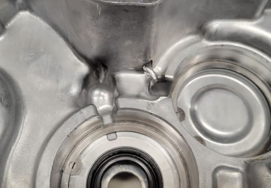

I've also modified the reducer for reverse operation, but only time will tell if it's enough. It's from I believe a 2015 model, so it has open bearings. I bought a BMW oil pump from eBay and made an adapter block for it. The plan is to pull oil from the lower drain plug hole and pump it back up to the upper reservoir (where it would be splashed to when running 'forward'). If anyone is interested I'd be happy to provide more details on this, but basically I drilled some holes in that reservoir and lightly ground some channels into the case in hopes of directing oil flow to the bearings that would not be splash lubricated in reverse operation.
Oil pump on block:
Example of holes in reservoir and grooves. The hope is that the flow from the pump and general chaos of oil flying around is enough to keep these bearings lubricated. I may switch to sealed bearings if I can find them, but for now they have proven pretty elusive. Thanks to another member here I have the part numbers for the two on the outer side of the gearbox, but that company doesn't list a bearing for the inside, so I'm not sure if the size was changed or not. It's very hard to find sealed bearings that can handle 10,000 RPM on the input shaft!

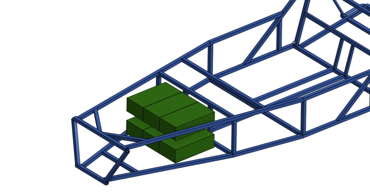

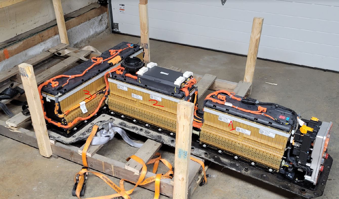

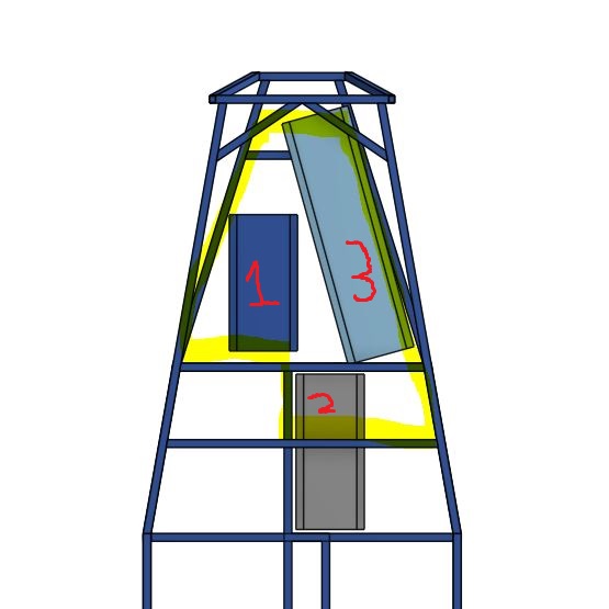

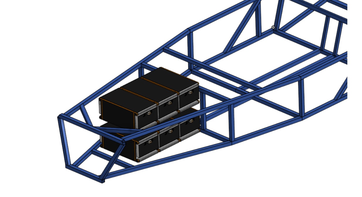

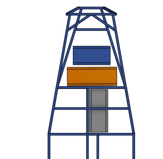

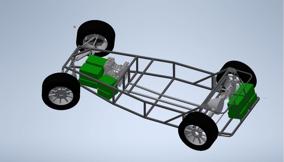

Okay, so for fitting the battery, I've been playing Battery Tetris for a while and have a few options. Some of them I like, others not so much. Given that I really don't need a lot of range, I would like to keep the weight of the battery to a minimum - but I also need enough voltage to reach a top speed of 130 KPH or so.
I'm currently off work on parental leave due to my wife and I having a baby late last year. While I'm off, I don't have access to Autodesk Inventor so I have been using Onshape instead. If anyone is looking for another option for free 3d CAD, it might be worth a look. I like that I can open and work on things with my tablet or my PC. The only catch is that anything you make is publicly available for anyone else to copy into their own workspace.
All that said, here's what I am looking at. The yellow outline is roughly the space I have to work with.
And for reference here is the pack with the corresponding cell groups numbered:
I have a steering rack right at the front that might be touching module 3 as it's shown here - it'd definitely be close either way. I also have the steering shaft running down the left side of module 1 but shouldn't be an issue as it runs higher than the battery in that area. The way I am showing module 2 will reduce passenger legroom by a bit, but I don't often have passengers, so if that's what I have to do, I might be okay with that. If it looks like I can do away with one group of cells (going down to 84s from 96s) that would make life a bit easier. Have to run more calcs.

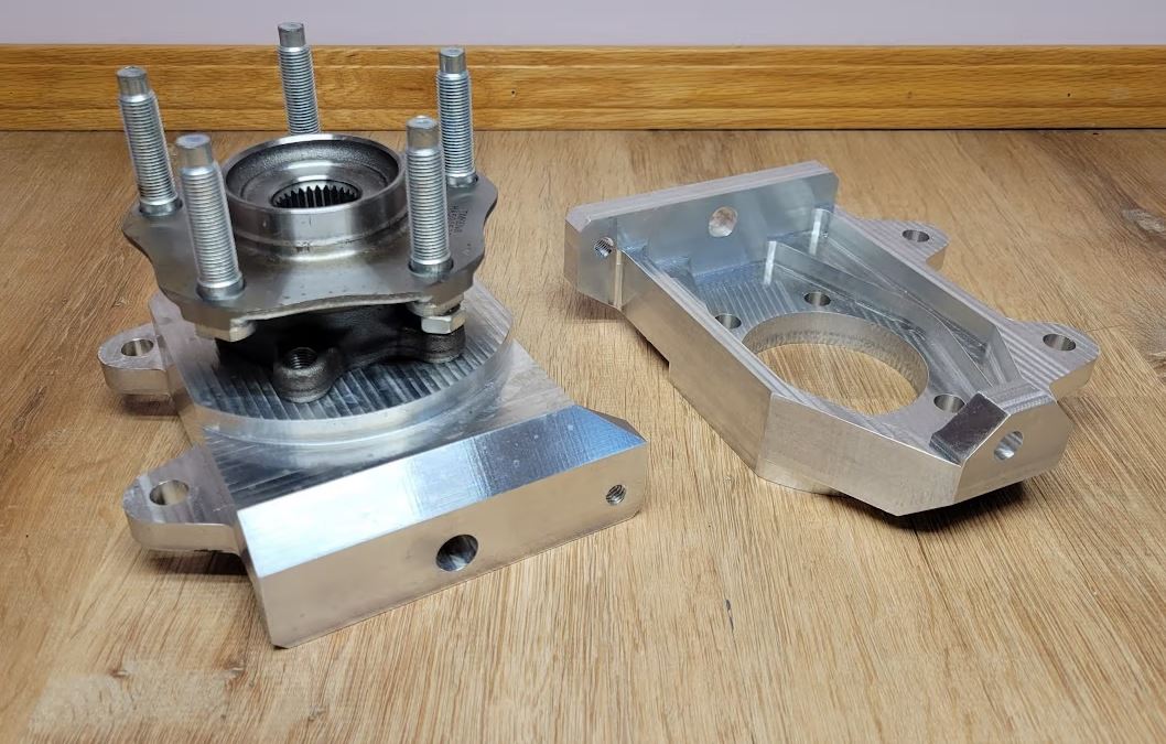

This is the aforementioned Leaf hub on the new uprights I designed. I pressed the OEM studs out and replaced them with 1/2" studs to match what was on the axle I removed. The PCD was the same, thankfully, so no need to do anything with adapters or mismatched wheels. I even managed to get them to accept the Ford Mustang brakes that were already on the car.

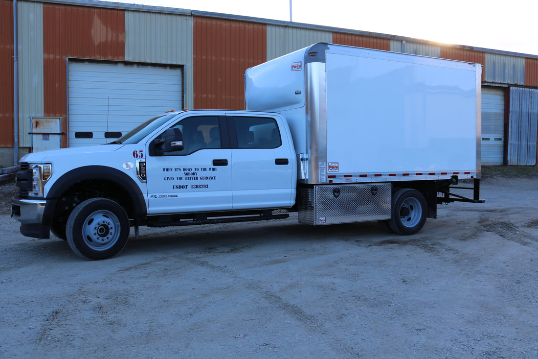

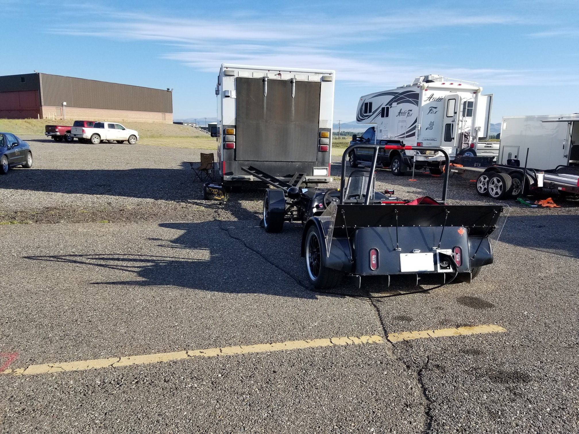

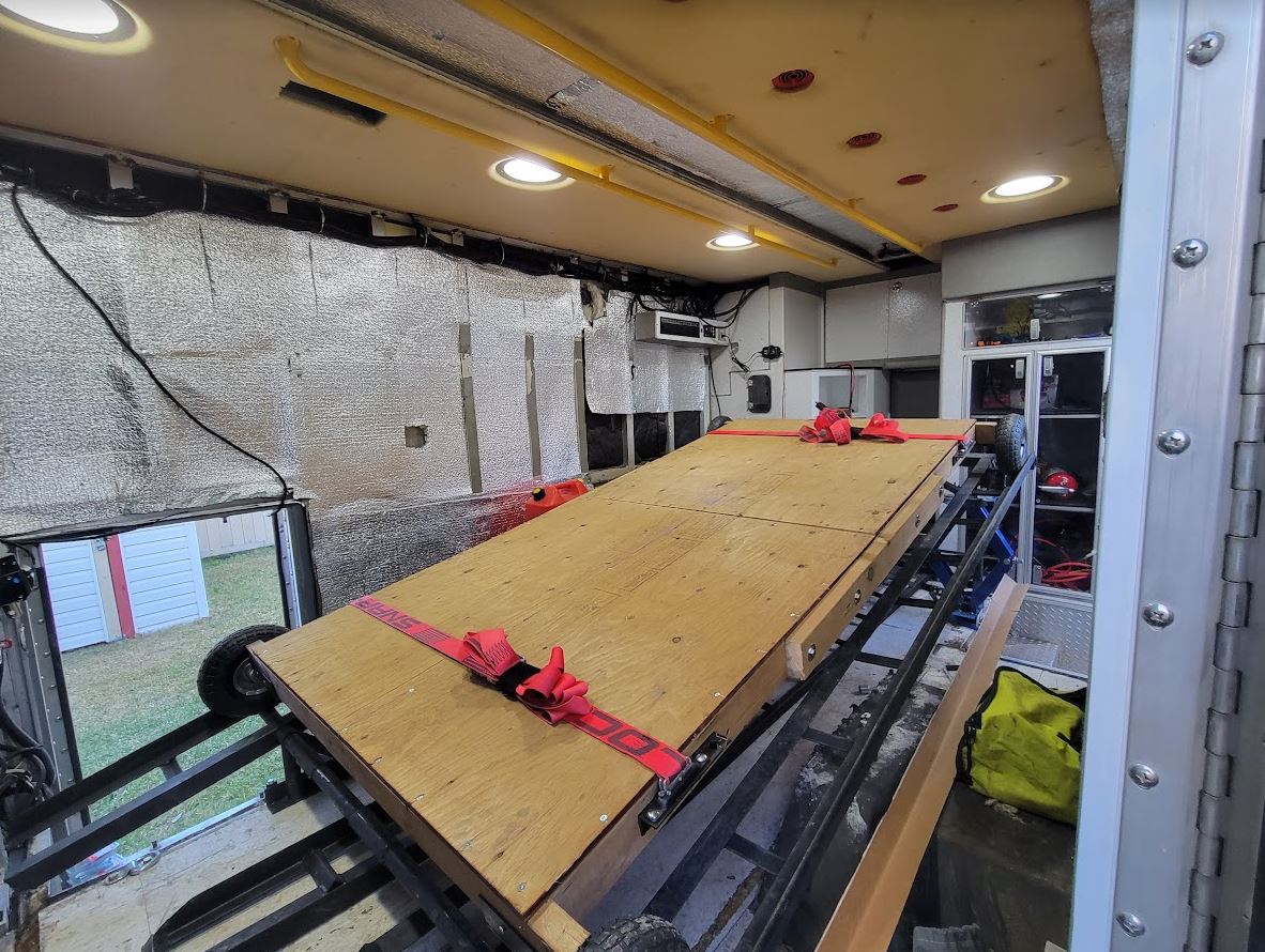

And as a side note, because I'm a 'necessity is the mother of invention' kind of guy, here is the ambulance that I use for transporting the car to and from the track. Trailering it was not fun and I do not have room to park a truck and a trailer, so I sold both and bought the ambulance. That also meant I didn't have to use the truck to commute to work and could replace it with a more sensible daily driver.
I stripped the interior and made a set of articulating ramps so I can winch the car in and then lower it down. Amazingly, the net weight of the ambulance plus car and ramps almost exactly matched the weight of the ambulance before I started gutting the interior. I also built a little sled that can ride on the ramps to make hauling things around easier. I've used this thing to move a lot of furniture for friends and family...
Here's an older video showing the car being loaded. I have since changed the front tow hook so I don't have to remove the nose cone anymore..
And for anyone interested, this is an Autocross run (Headphone warning - LOUD!):

Edit - have you considered sacrificing the passenger seat completely and putting pack 3 there? As a track car the bettery weight would both balance the drivers weight and keep the weight close to the c of g for a low moment of inertia. The shift in weight to the back might also benefit getting a rwd car off the line too.
Zieg
Posts: 385
Has thanked: 168 times
Been thanked: 160 times
Re: Homebuilt Locost 7 - from Motorcycle engine to Leaf power!
Post by Zieg »
Oh cool! Yes, MOT stuff can be a pain from what I have heard. These cars are way more common over there so a lot of my information (and a handful of parts) came straight from the UK. Here, I still did have an interesting conversation with my insurance company. They won't classify it as a motorhome unless it has a sleeping space and either a fridge or stove. I said I could put a hammock and a hot plate in it, but apparently that didn't fit the spirit of the rule. :D
And yeah I have considered deleting the passenger seat, but only as a last resort. It's nice to give the occasional ridealong, and I already knew it wouldn't be truly competitive while also being street legal. So, instead of building a formula-style car or A-mod, I built a Locost partly in so I could share the experience.

Trans tunnel is only 4" wide on the inside (6" on the outside due to the 1" square tube). There's only 17" of width on the passenger side for the seat, so widening it at all in the seat area would mean deleting the seat. With the way I have module 2 shown, it would already mean narrowing passenger legroom to 12" or less from about the knee forward. I could also try and cheat an inch or two into the driver side footwell since I don't need room for a clutch pedal anymore. That would be a fair bit more welding, though.
I think if I can drop the 12s group off module 3, I might be in good shape. Also on the todo list is to try laying them sideways and see what that looks like. Even staggering them vertically might be an option. Not great for the vertical CG, but it's so damn low anyway that it might not be the end of the world.

The way you have drawn it is making a lot of sense given the constraints. Don't like the idea of vertical stacking at all, the low c of g is one of the things that makes these cars handle so well.

Not shure if this is what you are implying but if you remove a couple of cells from the #3 module and place it as far back as possible in the old engine bay it looks like it will fit sideways and then #1 and #2 also sidways in front of #3. Hope this makes sens? Tried edit your picture in GIMP but didn't manage to do what I wanted.

Zieg wrote: Sun Feb 12, 2023 5:40 pm Okay, so for fitting the battery, I've been playing Battery Tetris for a while and have a few options. Some of them I like, others not so much. Given that I really don't need a lot of range, I would like to keep the weight of the battery to a minimum - but I also need enough voltage to reach a top speed of 130 KPH or so.
Can you fit one or two modules behind the rear axle?
I have a Dax Rush and this is where my fuel tank is - quite a decent space.

Hmm, that's a good idea. I think I can get away with ditching one 12s group. The orange one seen here is that module 3 with one 12s group removed (so just 2x 16s). I do need to allow for some space around the ends for the water cooling connections, and around the long sides for the holddown clamps. Then I plan to form some sheet metal into a protective box over the whole thing.

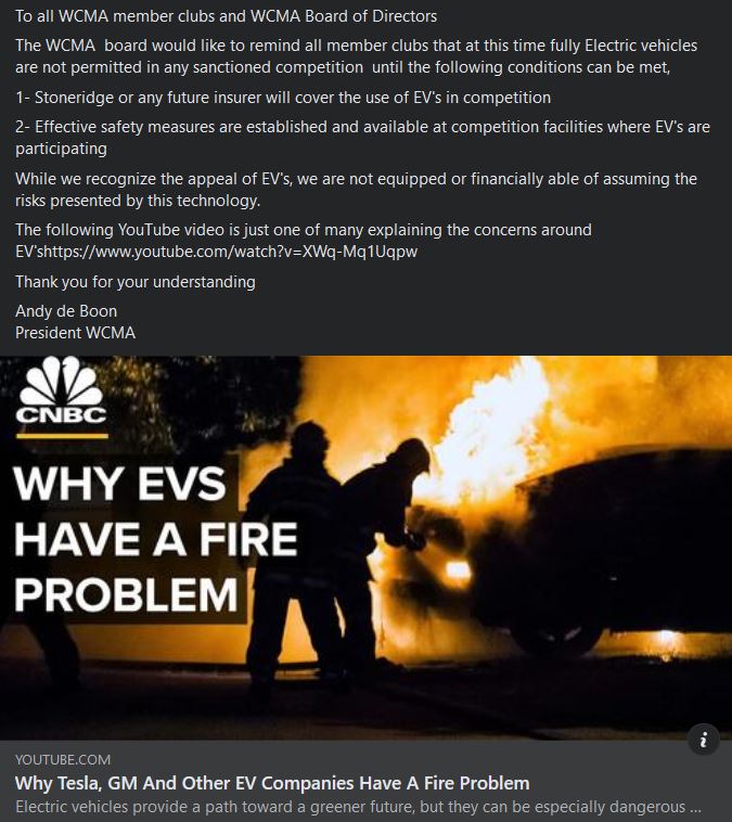

Pete9008 wrote: Mon Feb 13, 2023 11:00 am How do the rules affect EVs, are they in a separate class or is there some form of handicapping system?
Ha, well, that's an interesting question. There are different classes based on the car and the modifications done. There is an EV class but it's for production cars only. I was in the D Mod class, but after the conversion might not really fit in that class anymore. The good news is the car was fast, yes, but not truly competitive in D Mod. The cars that are competitive have huge front and rear wings, no passenger seat, very small diameter racing slicks, and so on. My last car was a Mazda RX8 which was in a stock class and very competitive, but my days of placing top of the class died when I sold that car, haha.
Also, on that note, unfortunately for this season (and last), electric vehicles are not permitted at any motorsports events in Western Canada. It looks like the insurance company got scared and dropped a blanket ban, which is most unfortunate. I am hoping this gets lifted before the season is over, else I will be stuck driving on the street, and maybe the odd day at a private track that I may or may not be able to get onto through a friend.
Here's the message that went out to all clubs. It bugs me that a hybrid with more battery on board than my car would still be allowed, simply because it's not 'fully electric'. Maybe I should mount a 1cc model airplane engine with a propellor on the back and call it a hybrid range extender?

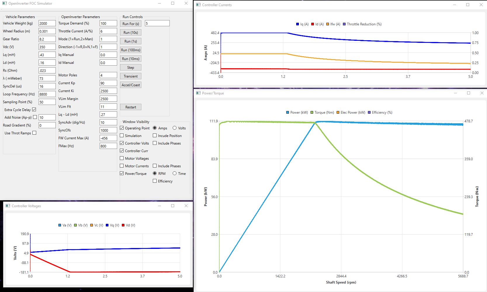

Also wondering what your plans are for battery current limits, what's the Volt battery capable of, are you going to keep the original battery liquid cooling circuits?
Well I have heard of people pulling 1000 amps from the gen 1 packs (admittedly those were arranged in 3P and mine are 2P). I kind of figured that if I wanted to make about 120kW then I'd be pulling somewhere around 350-400 amps. Here's the latest from my testing in the simulation software. I was meaning to ask if the Iq line in the controller currents chart represented actual current from the battery. If so, it looks like peak draw could be closer to 500 amps, although that's also while developing more torque than I could possibly put to the ground. In fact, if I think I am making more than twice as much torque as I could actually use in the low end, I might want to hit up Bratitude for a set of his 4.35:1 gears when they're ready.

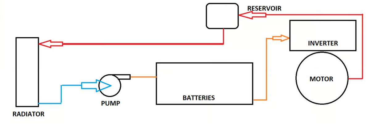

I will be maintaining the liquid cooling. I grabbed an electric booster pump from Davies Craig and a reservoir from a Chevy Bolt. Planning to run the loop like this:

Afraid Iq and battery current are two different things even though they can sometimes look similar. Afraid the only way at the moment is to work it out from power (I = P/batt volts). Best accuracy is to check the efficiency box which then shows electrical power into the motor as well as shaft power and use that for the calculation. Thinking about it probably ought to add a graph for dc current at some point.

140kW might be possible with the BMW. If you assume a 360V pack voltage and 20V of sag then you need 140,000/340 = 412A which is around 12C. Feels a bit high but for brief periods maybe?? Even half a 70 sec run is still well outside the normal pulse discharge time though and if you are using regen that will also heat the cells (although regen does increase the chance of locking the rear wheels so not sure I would on track). The only way to tell is to try it while carefully monitoring everything. I'm planning to limit at 100kW but then that's all my motor can do.
If you find evidence of the BMW packs being used at higher currents please post it as it would be great to find out what the limit is.

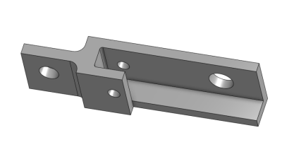

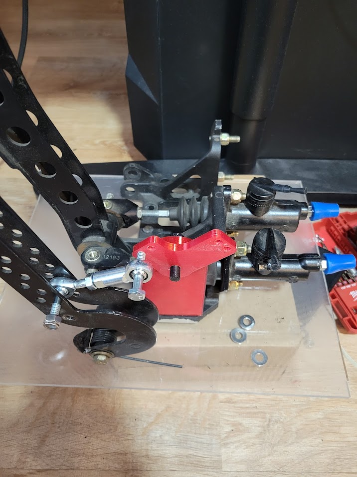

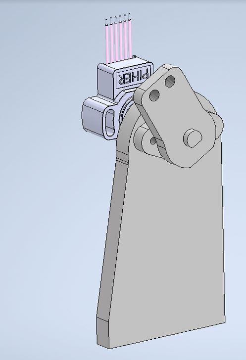

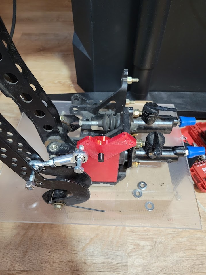

And coming soon: My Accelerator Pedal Position Sensor mount. Really annoying that Tilton has a bracket for mounting a hall sensor to their pedal boxes, but Wilwood does not. So I somewhat ripped off the design and am making my own. 3d printed a couple prototypes to refine the concept and enlisted the help of a friend with a basement CNC machine to bang out the basic shapes. He wasn't sure he could get a nice round hole for the bearings though, so I'll bore those out on my manual mill once I get my hands on 'em.

That looks like something Superfast Matt's besties "Send Cut Send" could do very accurately.
Zieg
Posts: 385
Post by Zieg »
Yeah, you're right. I originally asked my friend because of the machined fit I need for the bearings, before he told me he wasn't sure how well that would turn out on his machine.
I will probably be using them for other stuff though, including my battery enclosure. My combat robotics club was actually sponsored by them last year and they made a bunch of parts for our arena.

You need some speed holes adding in that bracket ;)
