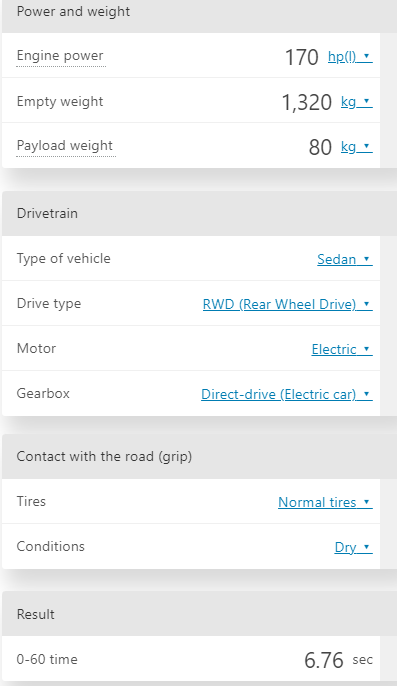

Has anyone timed 0-60 runs using the GS450h transmission and inverter? I've just started test driving my build and I think I'm coming in around 7 seconds. Very unofficial, on new tires and Tesla batteries out of a Mercedes B250e. Also, I'm not using low gear at all at this point, only driving in high. I'm not shooting for a race car, and it's already MUCH quicker than this car was originally (1964 Rambler Classic with in-line 6 and 3spd auto), but I'm just curious what others are seeing.
Also, what are the max amps you're pulling?

Do you know what the new weight is?
'google' says the Rambler was about - 2755 lbs | 1249.647 kg? - 'guessing' your new weight would be around 1400kg with driver and full tank of electrons?
this 0-60 calculator says you need around 170bhp to just dip below 7 seconds.
https://www.omnicalculator.com/everyday ... calculator

I have not weighed it yet, but your guess is right about where I was thinking it should end up. Even though it only had an inline 6, those old cast iron blocks were heavy.SuperV8 wrote: ↑Fri Feb 17, 2023 10:05 am What an awesome project - and what a transformation. Some serious hard work/skill there.

I had forgotten that one as well. His car is much smoother than mine. I need to work on the rear axle I installed. My esti-counting seems to confirm around 7 seconds for me as well.

Damien's recent YT video:
Spoiler alert - his GS450 measured about 225hp.
Assuming the same 1400kg weight -225hp would get you down to just over 5 seconds 0-60 according to that calculator.
