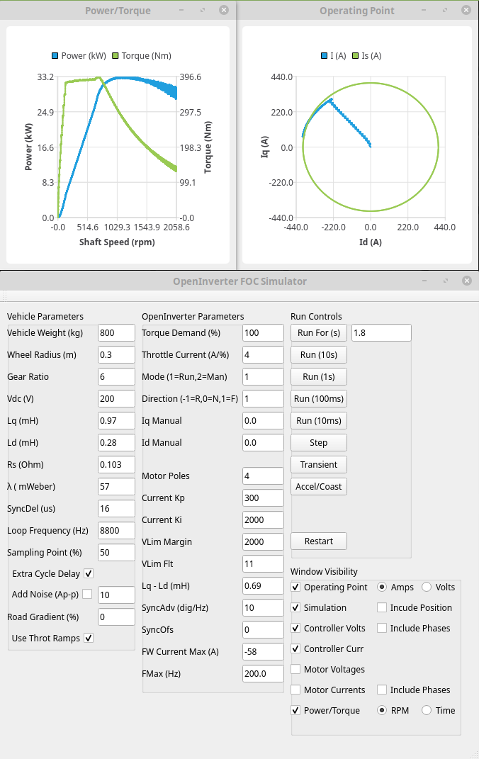

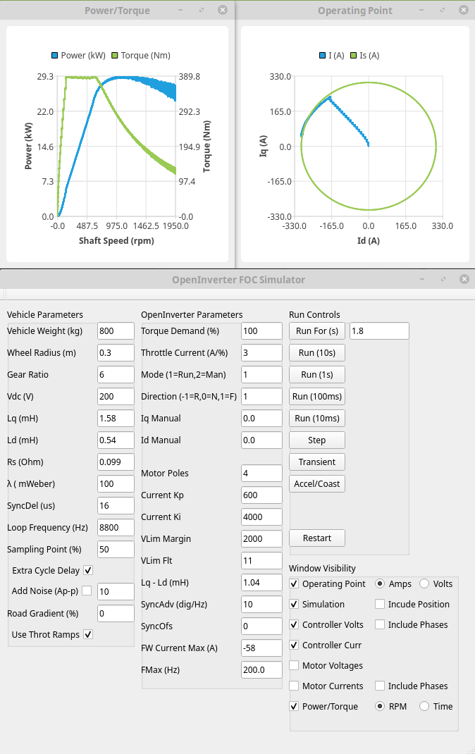

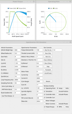

Got curious about what might be possible so decided to do a few simulations based on Ev8's rx400h motor data (the best data currently available). First plots still have a gearbox ratio set in the simulator as it allows the simulation to run a bit quicker, it doesn't affect the power or torque figures quoted as these are at the motor shaft. Edit - If I have my sums right then the 2krpm max on the plots, if used for direct drive, should be around 140mph.
First MG2 at 360V: Pretty good, 400Nm to 1300rpm (around 90mph) and 60kW peak per motor so a total for the pair of around 160bhp!
Still MG2 but dropping the voltage to 200V: Much faster torque drop off, still giving 400Nm to 50mph though so could still be worthwhile.

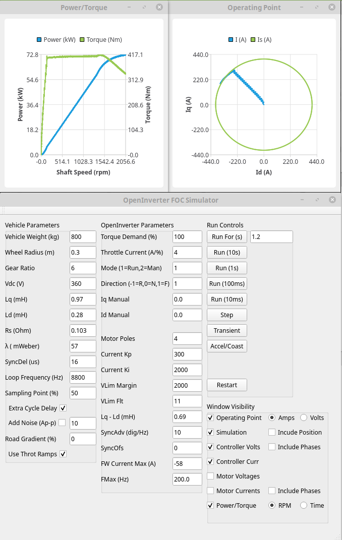

Also decided to see what MG1 can do as it is much lighter. First at 360V: Now this surprised me, it needs a little more current to do it but it's making the same torque (and keeping it up to a higher speed) and even more power, a total of almost 200hp for the pair!
MG1 but dropping the voltage to 200V: so again pretty similar to MG2.
Finally decided to simulate what a pair of MG1s at 360V could do in a 800kg car. No point showing the plot as it looks the same but it shows the car accelerating from 0 to 150mph in 20seconds. Torque is completely flat to 100mph and is still at 650Nm (for the pair) at 150mph! It would need a battery able to supply 800A though!
I suppose the big question is whether MG1 would melt or whether the cores would saturate at this current level. This might actually work though - I may start looking for a couple of rx400h gearboxes for when I'm finished with the current conversion.
Edit - If it would take 500A then simulation says that one MG1 could produce 650Nm
The core is likely to saturate before this point but wonder at what level?
Edit2 - thinking about it these torque levels for MG1 would be nice but I think it is highly likely that the core will saturate or windings melt before getting there, MG2 is a much better bet even if heavier.
Edit3 - Before anyone else notices I forgot to set Icrit to the correct value in all the above plots
Fortunately it's not pushing far enough into field weakening to matter so doesn't make much difference!
Edit4 - Fairly sure that the 13.4kg ebay weight above is for MG1 (the generator not the motor). Both the Gen2 and Gen3 Oak Ridge reports are pretty consistent about the weight of MG2 - 45kg (with around 10kg of that being the casing). In particular Table 2.7 of the Gen3 report contains a lot of useful data on the Prius, Camry and LS600h motors.

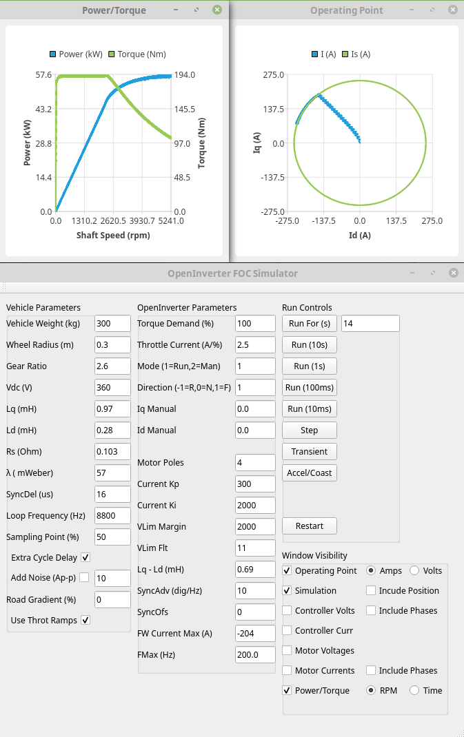

Can't seem to give up on this so have given a little more thought and now believe it can be made to work. I'd dismissed the epicyclic gears because on the Prius MG2 drives them on the ring gear which is wrong for reducing speed (although I now believe this is only the case for the Prius, the rx400h is different having a second set of gears). Plus MG2 is already too heavy and adding the gears makes this worse.
Now I'd previously dismissed MG1 because I didn't believe it could do the job but I've now changed my mind. Moving to MG1 actually makes it all easier! MG1 already drives the sun gear and so the gears work perfectly for this. Using Prius ratios (I don't know the rx400h values but probably similar) it would be possible to get either a 2.6 or 3.6 reduction ratio depending on whether the ring or planets are locked. The 2.6 would be best here. The lighter weight of MG1 also means that the gears can be added without it all getting too heavy.
So chucking this into the simulator with a 360V battery gives: Now the torque is before the gears so would increase by 2.6 giving 500Nm (per motor). The scaling is such that the 5.2krpm is still around 140mph so this full torque will be available to around 70mph, it will then drop to half this by 140mph. That seems a much better compromise. Motor current also drops to 250A giving a motor power dissipation of 6kW (thinking a little more, because of the way the calculator works out Rs, some of this will be in the inverter) which is easily manageable continuously. Power is around 75bhp per motor so 150bhp boost in total. This looks just about perfect for a FWD assist. A pair of rx400h MG2's driving through the gears would probably make a fairly potent stand alone RWD power unit with built in LSD and torque vectoring technology too!
The FWD assist looks like it might be my next project once the Smart conversion is finished
Edit - just for completeness simulated a run on a 800kg car, 60mph in around 6.5sec and 140mph in 18sec (ignoring drag so completely unrealistic though)!
