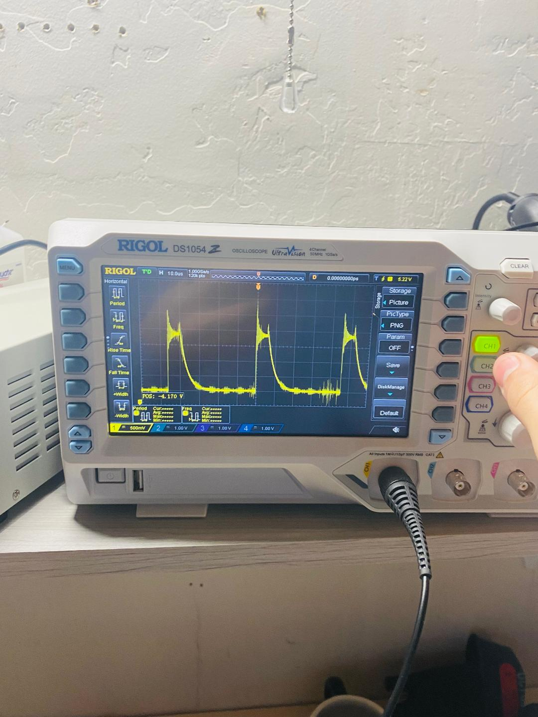

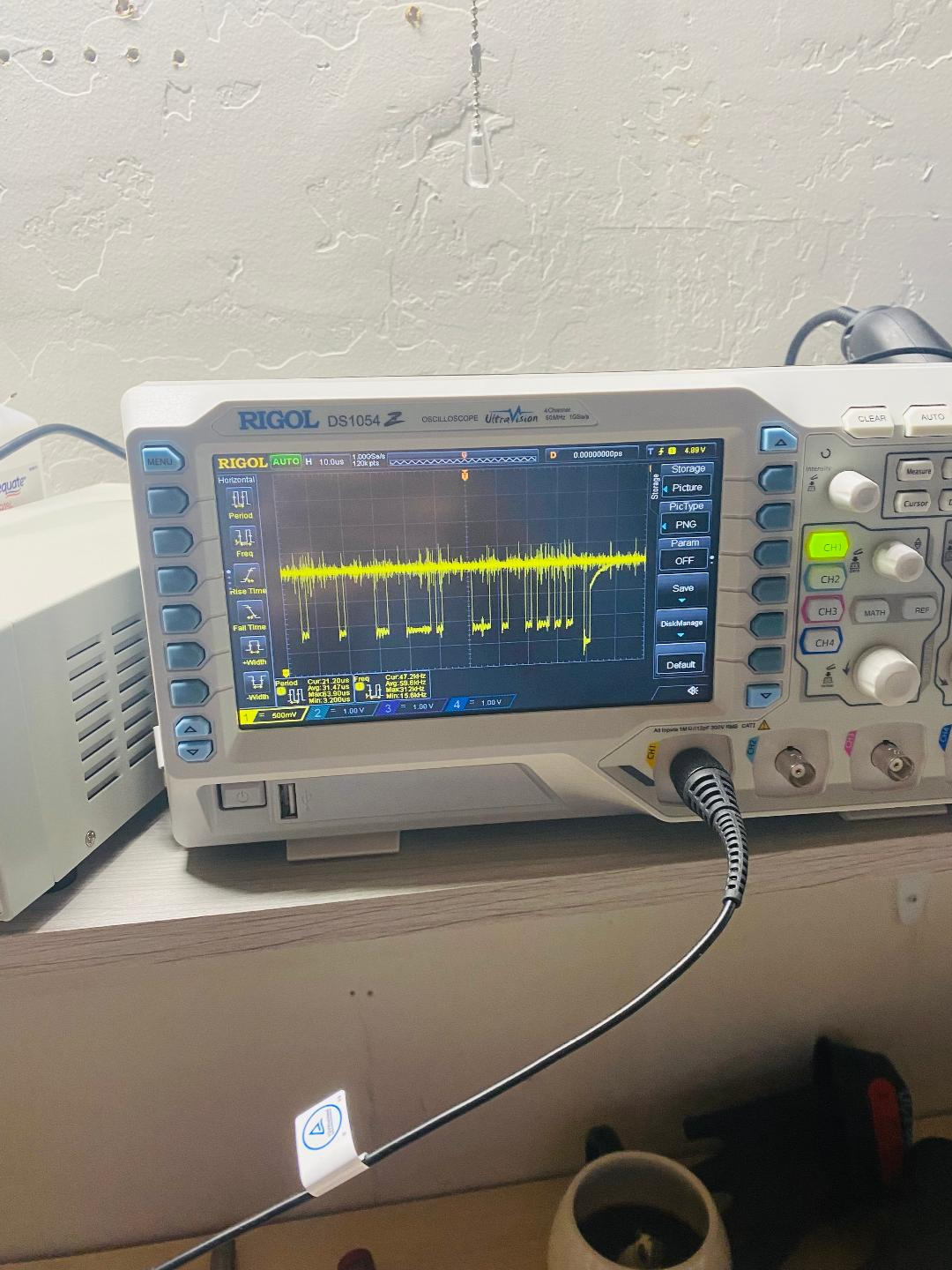

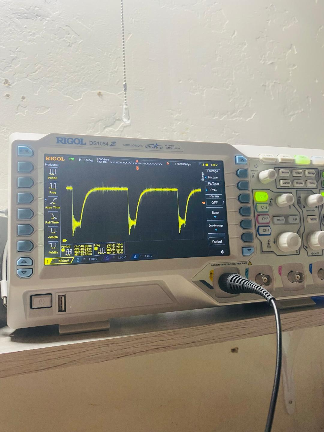

Hello friends,
I have been working towards a first spin up test, and I have been stymied by INVudc suddenly reading zero.
The inverter I am using is from a 2013 Nissan Leaf, I believe that is a Gen 1.
This was a parameter that had been working since my first boot up of the Zombieverter, but it will no longer read the actual value.
The problem:
- Inverter is not correctly reading voltage. INVudc = 0.
What may have caused it:
- A couple times, on accident, I opened the main contactor before the precharge contactor.
- I changed the firmware around a lot while trying to get my throttle to work. (1.10A -> 1.11A -> 1.10A -> 1.7A -> 1.11A).
What I have tried:
- I checked all the connections thoroughly.
- I hooked up my oscilloscope to CANL and CANH without the VCU plugged in to check for a heartbeat. See Fig 1A/1B.
- I hooked up my oscilloscope to CANL with the VCU with the VCU plugged in to see if data was being sent. See Fig 1C.
- While in dir = drive, opmode = Run, and potVal = 20% torque commands are being sent, but nothing is happening. This is expected, however because the nissan leaf will not attempt to move unless it measures over 180V. Each test I verified with my mulit meter that the voltage was in fact 190 volts, but INVudc always read zero.
Is there anything more that I should do or check? Is my Inverter bad?
Thank you for your time.
Fig 1A
Fig 1B
Fig 1C

I found the answer! I have been using CAN2 for my inverter. For some odd reason, the pinouts that were on the wiki did not correspond to the the CAN1 and CAN2 on the web interface. It wasn't until I selected CAN1 for the inverter that it began working again! :)
