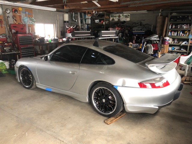

Hi All,
My project is a 1999 Porsche 911 with a Tesla SDU. The plan is to use a 2013 Nissan Leaf 24 kWh battery pack and the 2013 Nissan Leaf PDM.
Here is the link to the diyelectriccar.com forum page: https://www.diyelectriccar.com/threads/ ... st-1077391
Here's a link to my YouTube Playlist of this build - https://youtube.com/playlist?list=PLZU7 ... sF_n0Pzj_P
I'm planning to purchase the OpenInverter Tesla SDU logic board and the ZombieVerter VCU. I'm wondering if this makes sense to people or if there is a better way to run the electronics in this car? I want to keep the cost down which is why I like these parts.
I'm wondering if the ZombieVerter VCU will allow us to charge batteries using the Nissan PDM? The PDM needs CANBUS commands to start charging as well as adjust the current and stop it when the battery is full.
I'm hoping someone can confirm that the ZombieVerter will work with the OpenInverter SDU logic board and the rest of my project before I buy both.
Thank you!

Great build, thanks for posting1:)
Yes, after some configuration ZombieVerter can run both the PDM and the openinverter logic board

Johu, thank you for the response and for confirming that the OpenInverter logic board and the ZombieVerter board will work with these parts! I plan to buy these parts quite soon.

Nice car with factory Aero Kit too. 👍
Looks cool with roof bars.
