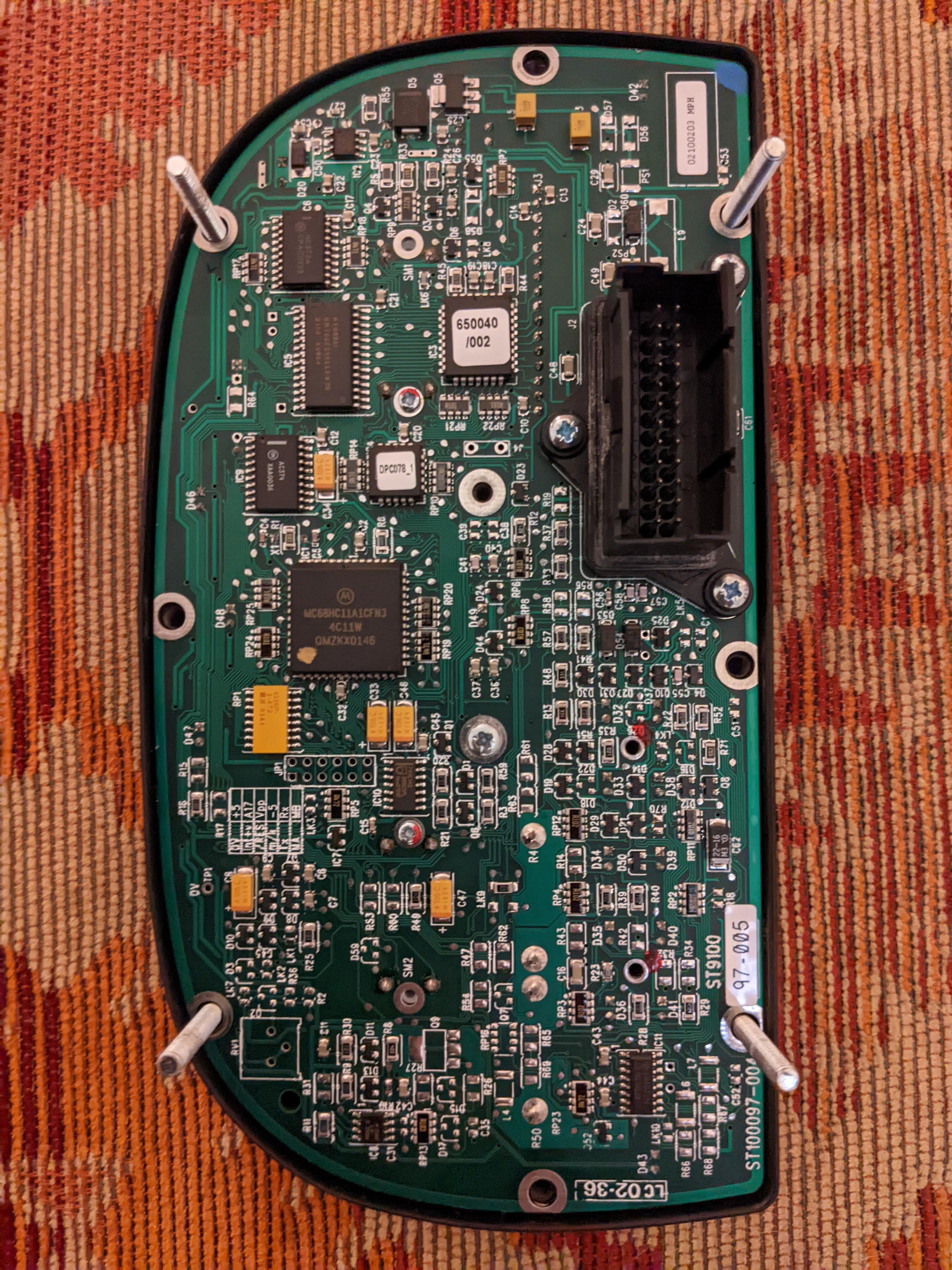

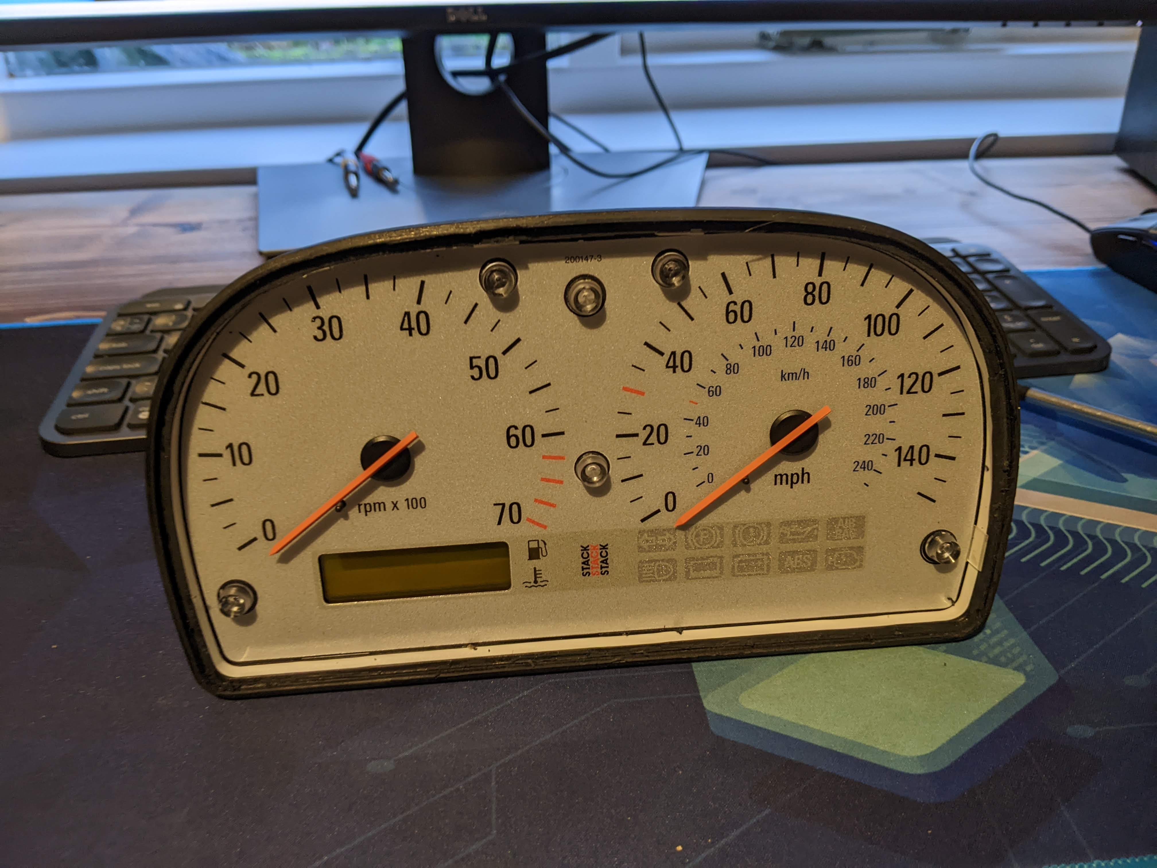

As part of my VX220 build, I am currently in the process of reverse engineering and reprogramming the Stack gauge cluster.
The goal is to allow the gauge cluster to display relevant data such as state of charge and motor temperature, replacing fuel level level and engine temperature, and also to use the techo needle to display current or power.
This is probably a little off-topic on this forum, but I thought I'd document my findings here. The gauge cluster is built with the following hardware:

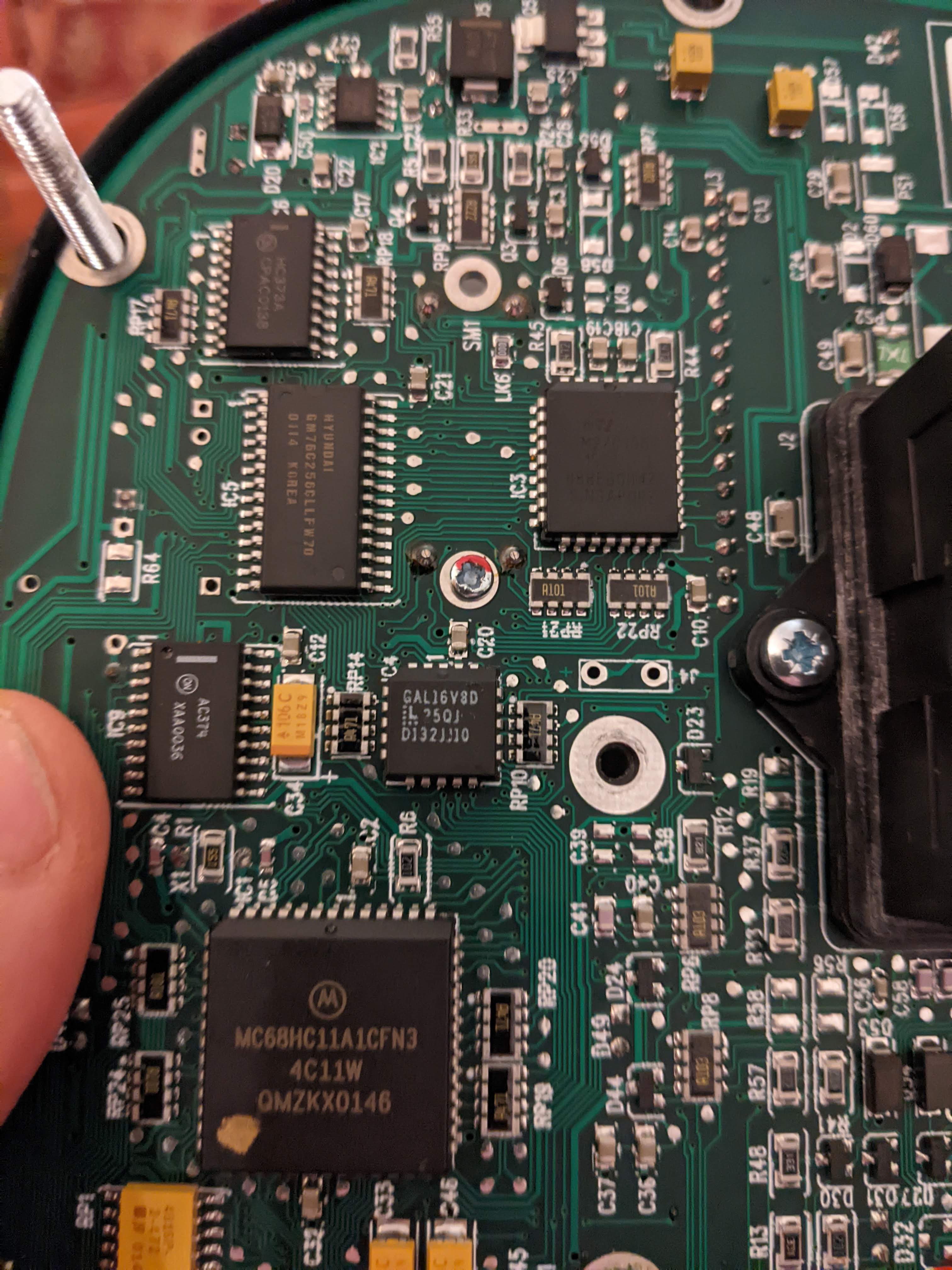

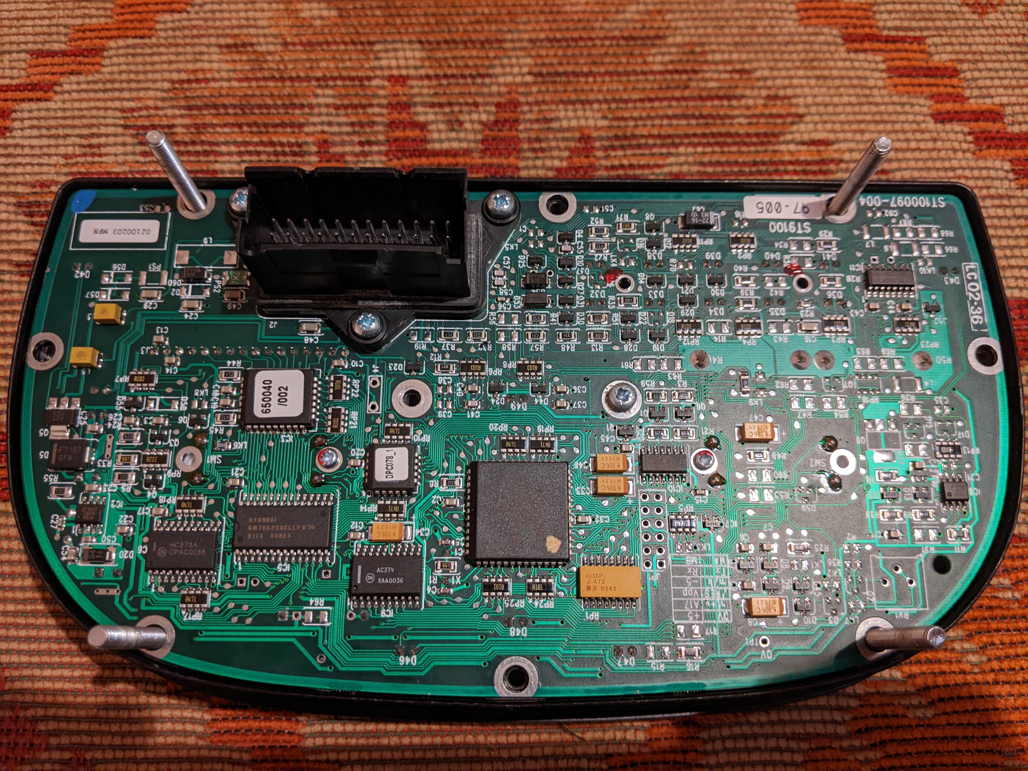

  • MCU/CPU: MC68HC11A1CFN3
  • SRAM: GM76C256CLLFW70
  • ROM: M27C1001

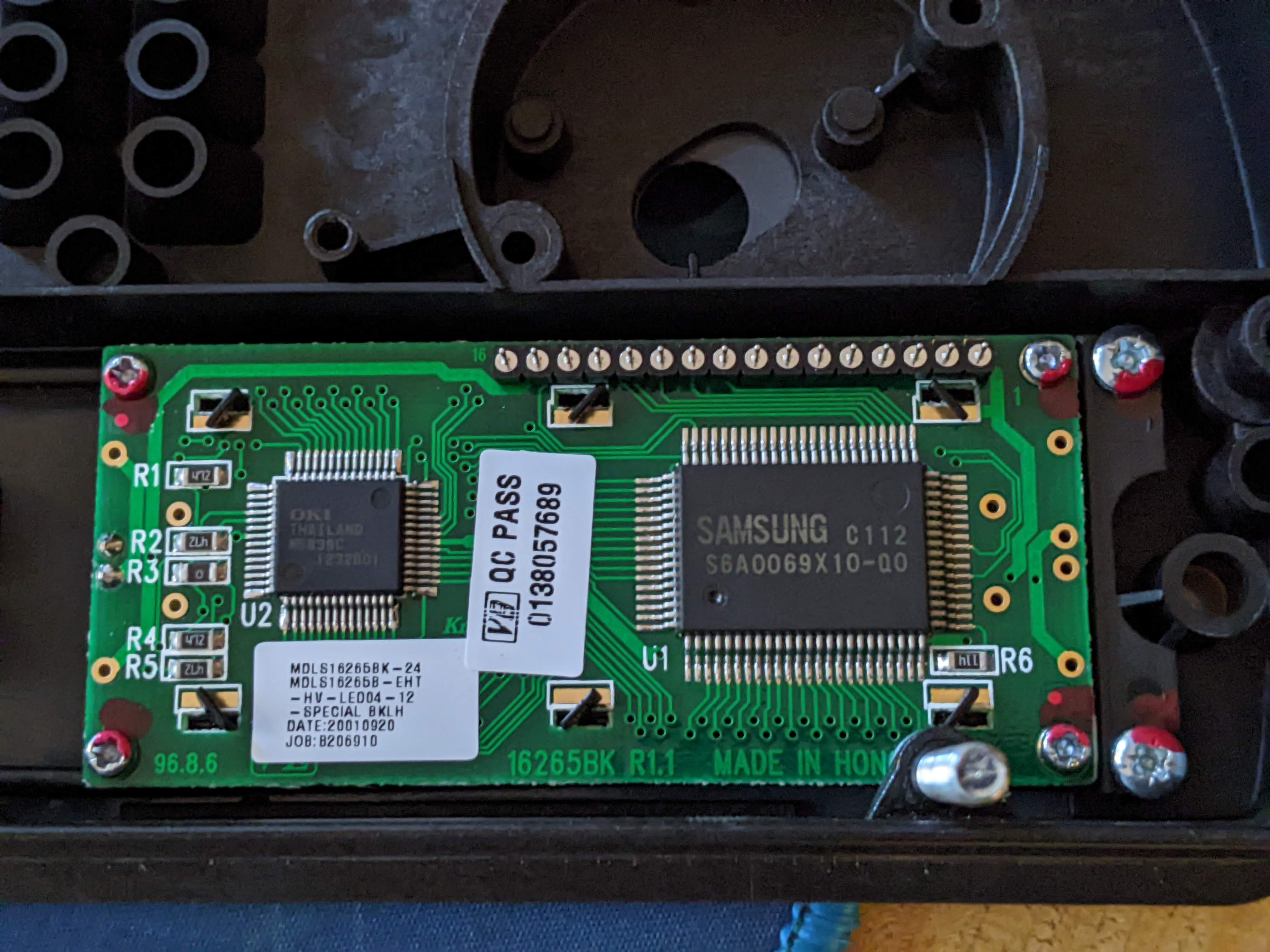

  • Display: S6A0069X10-Q0
  • Address decoding: GAL16V8D

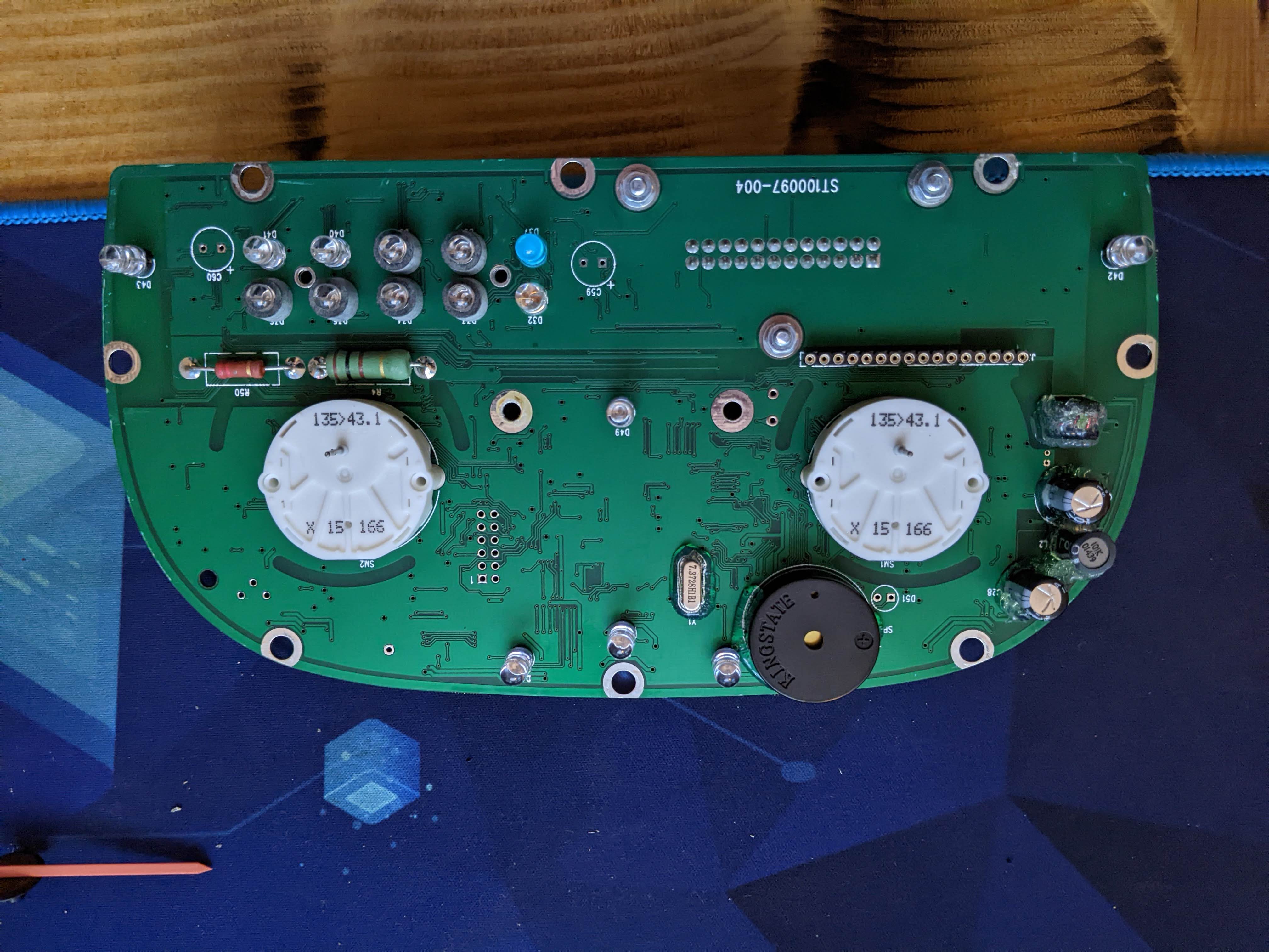

  • Output buffer driving 2 x stepper motors: AC374
  • Stepper motors: X15.116
This microcontroller is super interesting because it has internal peripherals, but also an external 16 bit address bus, allowing external peripherals to be mapped directly into memory. After a few days of reverse engineering, I have mapped out the memory and GPIO:

The board exposes the following lines on a debug port:
  • UART RX
  • UART TX
  • MODEA
  • MODEB
  • RESET
Using this debug port, I am able to reset the microcontroller into bootstrap mode and load a new program via the UART. This must be sent at 7200 baud which is a little inconvenient, but using a genuine FT232 USB cable, this works perfectly. I have been able to successfully load and execute code, write characters to the LCD, and control the stepper motors.
Unfortunately, the on-board ROM is one-time-programmable, so in order to permanently reprogram the board, I would need to replace the ROM chip with a pin-compatible flash. This is certainly possible, but my preference for now is to run the device in the manner I am running it now. I will connect an STM32 or RP2040 board with CAN to the debug port. This can reprogram the cluster at startup then stream data from CAN to it.
See attachments with detailed photos. I will now work on a simple firmware that accepts data from serial and displays it. The biggest challenge will be reliable stepper motor control.

The needles have mechanical endstops inside the motors, so zeroing them should just be a matter of doing a full sweep. Unfortunately, i destroyed one of the steppers in my test unit trying to take it apart. Should be able to replace it though.
