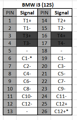

Hi, i got 8S Cell Module from X5 wihout CSC and want to connect CSC from I3 but i dont know pinout for Cells, would be fine is someone know or have it.
tnx a lot

thank you
