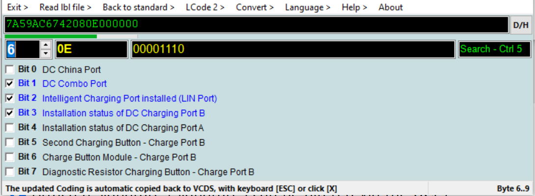

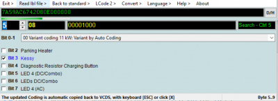

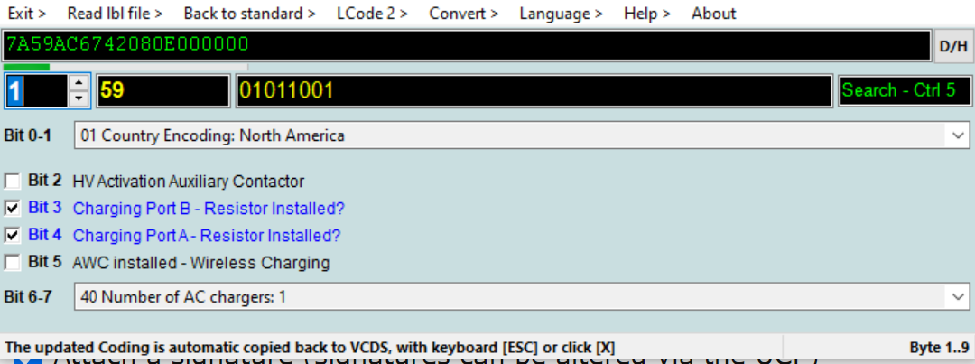

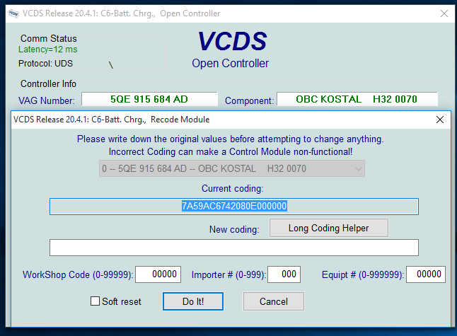

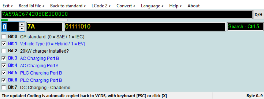

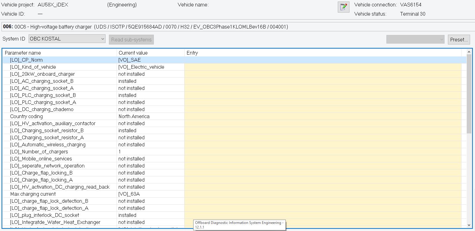

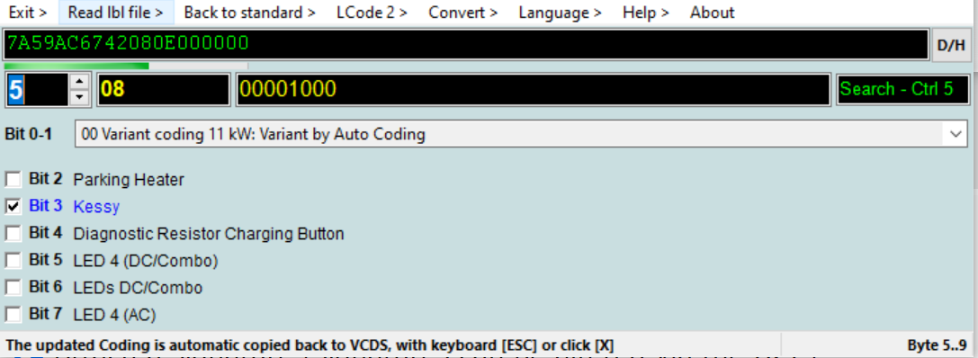

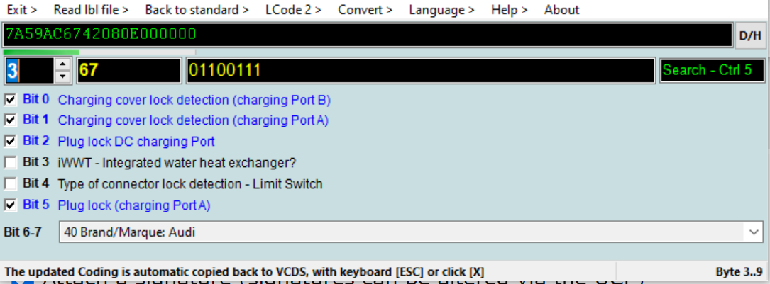

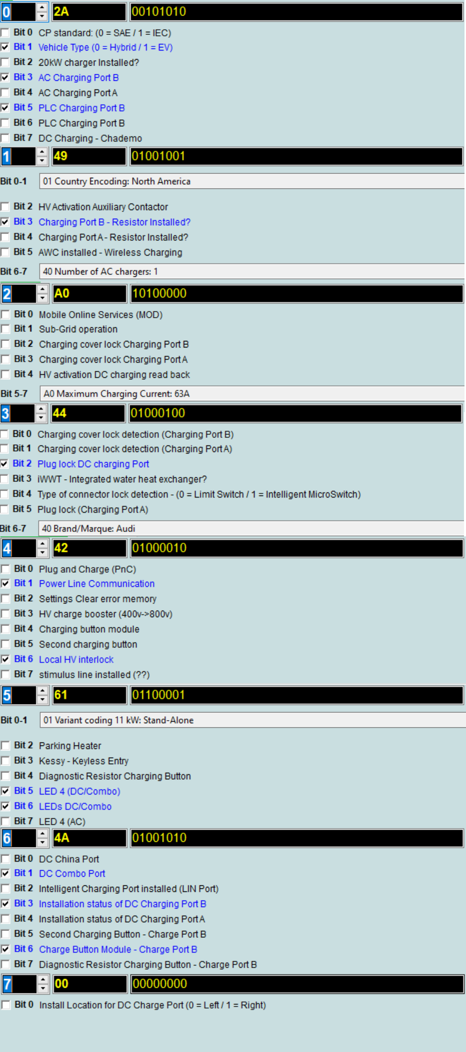

Coding Options (VCDS/PIWIS/ODIS)

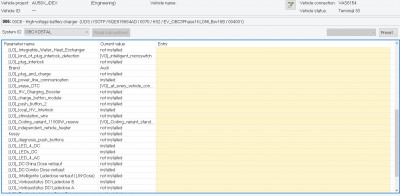

The MLBevo chargers seem to all use the EV_OBC3Phase1KLOMLBev16B config/odx
I primarily use Porsche PIWIS tools, and since the Taycan uses a similar charger, the engineering and coding options match up.

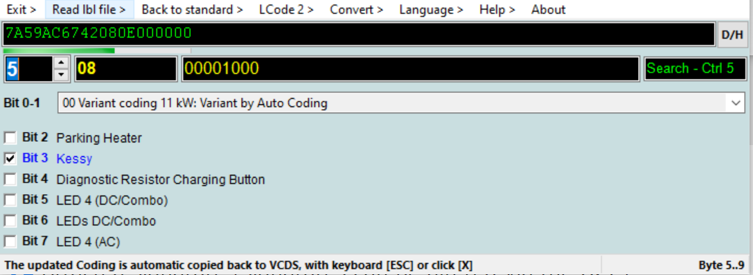

Other similar tools that can be found are VCDS, iDex, ODIS Engineering & OBDEleven... All should allow modifying the charger coding.

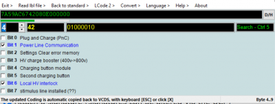

I've created a VCDS Label file to aid in coding, It's attached.
You can open in the VCDS LCode.exe program (no purchase needed) and it's a interactive way to determine the coding value required.
The coding breakdown is listed below:
Bitfield 0 -
CP standard - SAE/
vehicle category - Electric Vehicle / Hybrid
20kW charger
AC charging socket B
AC charging socket A
PLC charging socket B
PLC charging socket A
DC Charging - Chademo
Bitfield 1 -
Country encoding (NAR/
HV activation auxiliary contactor
Charging socket resistor B
Charging socket resistor A
AWC installed - Wireless charging
Number of AC chargers (One/Two)

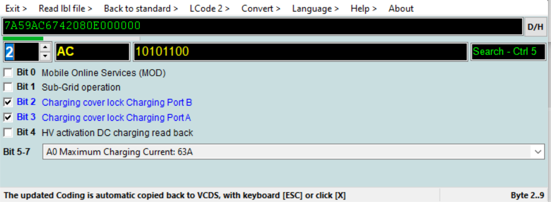

Bitfield 2 -
Mobile Online Services (MOD)
Sub-Grid operation
Charging cover lock (charging socket B)
Charging cover lock (charging socket A)
HV activation DC charging read back
Maximum charging current (63A)
Bitfield 3 -
Charging cover lock detection (charging socket B)
Charging cover lock detection (charging socket A)
Plug lock DC charging socket
iWWT - Integrated water heat exchanger?
Type of connector lock detection - Limit Switch
Plug lock (charging socket A)
Brand/Marque (VW/Audi/Porsche)

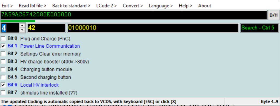

Bitfield 4 -
Plug and Charge (PnC)
Power Line Communication
Settings Clear error memory
HV charge booster (400v->800v)
Charging button module
Second charging button
Local HV interlock
stimulus line installed
Bitfield 5 -
Variant coding 11 kW (reserve)
Parking Heater
Kessy
Diagnostic resistor loading button
LED 4 (DC/Combo)
LEDs DC/Combo
LED 4 (AC)
Bitfield 6 -
DC China socket installed
Installed DC combo box
Intelligent charging socket installed (LIN socket)
Installation status of DC charging socket B
Installation status of DC charging socket A
Two charger can B
Charging button module socket B
Diagnosis resistance charging button socket B

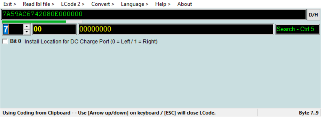

Bitfield 7 -
Installation location DC charging socket
The VCDS Scan for my charger is as follows:
My LCode Lable File looks like this:
You can download LCode from Here:
https://forums.ross-tech.com/index.php? ... 117/page-7
Coding label is uploaded as a TXT file, Rename to .xpl or .lbl to open
5QE-915-684-AD.xpl.txt
(2.68 KiB) Downloaded 898 times

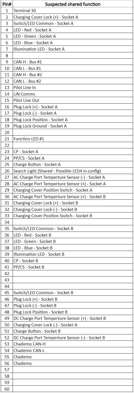

Base wiring required
I've started to combine several wiring diagrams along with info gathered by Damien.
As it looks, the modules have a standardized IO layout, with only several differences pending the configured settings.
The info posted below is theoretical for now, until I get to test most of them:
Confirmed the following:
Pin 1 - 12V DC+
Pin 3 - Sensor Ground (Both pin 3 and 45 can be tied together)
Pin 9 - CAN H
Pin 10 - CAN L
Pin 30 - Charge Port - AC+
Pin 33 - Charge Port Cover Position Switch *Other side tied to sensor ground pins 3/45*
Pin 35 - LED Common
Pin 36 - LED Red
Pin 37 - LED Green
Pin 38 - LED Blue
Pin 39 - Socket Illumination LED *Other side tied to ground pin* (Debating if this should be tied to the 3/45 pins)
Pin 40 - Charge Port - CP
Pin 41 - Charge Port - PRX
Pin 45 - Sensor Ground (Both pin 3 and 45 can be tied together)
Pin 46 - Plug Lock +
Pin 47 - Plug Lock -
Pin 48 - Plug Lock Position (Resistive 1k/11k unlocked/locked) *Other side tied to sensor ground pins 3/45*
Pin 49 - Charge Port - DC+
Pin 51 - Charge Button *Other side tied to sensor ground pins 3/45*
Pin 52 - Charge Port - DC -
Pin 60 - Ground

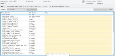

*Alternate Coding Options*
VCDS is likely the best option for most, but there are also other tools that friends/family may have.
ODIS Engineering is a common tool that works with some of the simpler dongles.
iDEX is also an option (however I have yet to get it working)

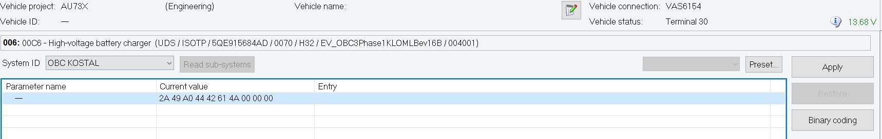

Finally I use PIWIS3 for my coding and a VAS6154 cable It's a bit more user friendly, but requires some additional setup and isn't as common.
Below is my post coding result from ODIS using a VAS6154 cable:
From this you can see that my final coding is:
2A49A04442614A000000

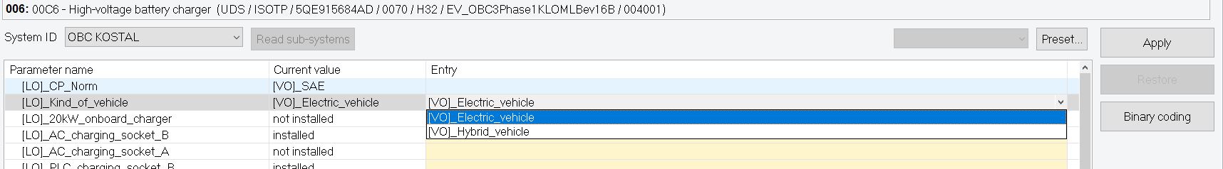

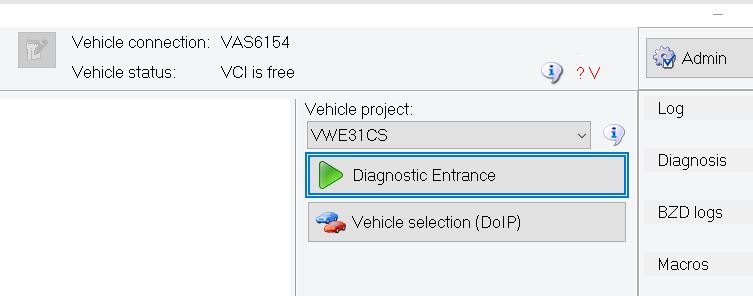

Some Good News!
After more ODIS messing about, I Managed to copy over the newer project files for the AU58X platform into ODIS Engineering 12.
This at least gets us the same text based mapping as my long coding calculator above...
The project files should be copied into the following folder on the ODIS Engineering Install: C:\ProgramData\Offboard_Diagnostic_Information_System_Engineering\MCD-PROJECTS-Engineering\DSVR-ProdiMCD
Download link for the Project Files, A 7z file of the IDEX Project file folder, Gofile link as it was the easiest way to get this out:
https://gofile.io/d/8jLy7v
Will try to upload to a more suitable host in the future

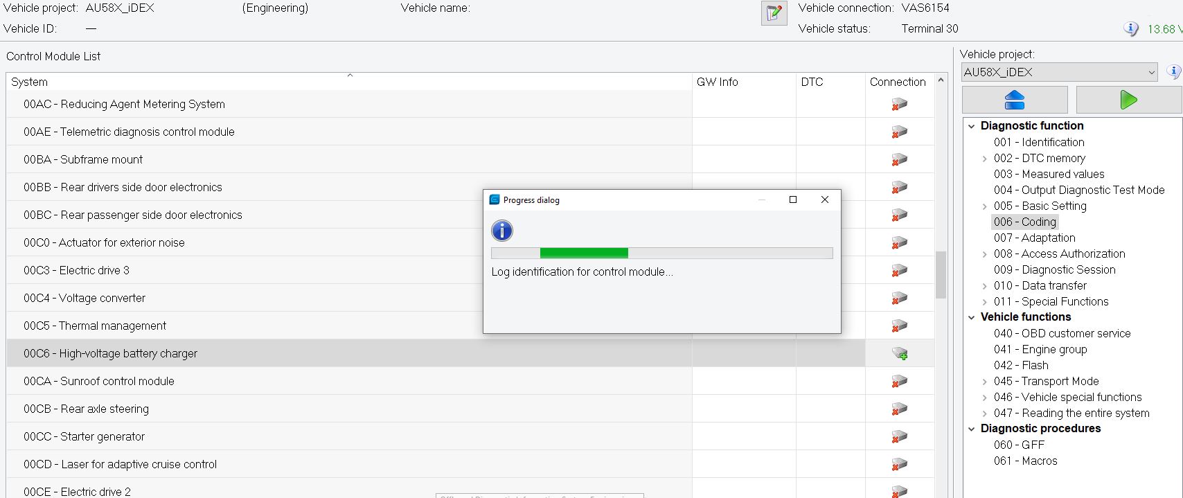

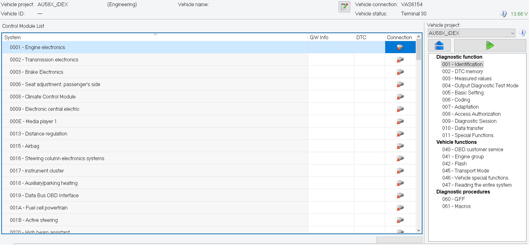

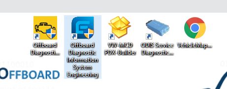

Below is the explination on how to code via ODIS.
There are also lots of Youtube videos explaining module coding, but I wanted to make this a bit more specific for the charger:
  • To Open, Click the blue Icon ODIS - Engineering
  • When Opening ODIS, You'll likely get some startup errors, after they timeout, Say OK.

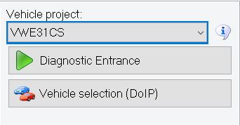

  • Select your interface; This will likely be the trickiest part of the whole configuration.
  • Select your Project, If you copied the project files over, you'll see AU58X_IDEX in this list
Project Selection.JPG (20.05 KiB) Viewed 23504 times

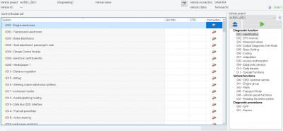

  • After a period of unpacking and preparing, you should be greeted with a list of modules that exist as options, all of these will show a red X, along with the charger.

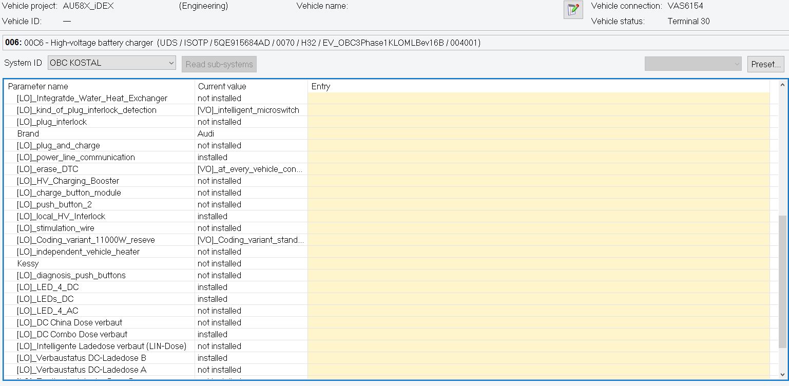

  • Scroll down to C6, Select and navigate to the right to coding, double click. Comms should be established and the program should read the latest coding within the charger.
  • With the coding screen loaded, you should see the following options:
Select what options you wish to configure for, when done, the list will be populated with whatever changes were made, and you should be able to click apply to save the settings.

Started to investigate 684J 11kW charger. Used lcode but to code using vcds security code is needed so that was no go. Need to get some odis compatible adapter next, I think.

evMacGyver wrote: Sun Feb 11, 2024 5:36 pm Started to investigate 684J 11kW charger. Used lcode but to code using vcds security code is needed so that was no go. Need to get some odis compatible adapter next, I think.
If that's one of the batch from Lars I believe it's probably from a Taycan and probably won't response to ODIS. At least in my experience. Might be best to look for a VAS6154 device and get PIWIS.

LRBen wrote: Sun Feb 11, 2024 5:52 pm If that's one of the batch from Lars I believe it's probably from a Taycan and probably won't response to ODIS. At least in my experience. Might be best to look for a VAS6154 device and get PIWIS.
This one is from Audi e-tron or thats what I was told. I think VAS6154 is good for odis too, so looking for one.
Mitchy
Posts: 147
Has thanked: 7 times
Been thanked: 92 times
Re: MLBevo Charger- 11kw & 22kw Info
Post by Mitchy »
Try 20103 for the security code; I thought I documented it above but looking back I may not have.
Mongoose seems the easiest and cheapest ( $30 for a knockoff unit that can do J2534)
VAS6154 adapters seem to run ~$60.
