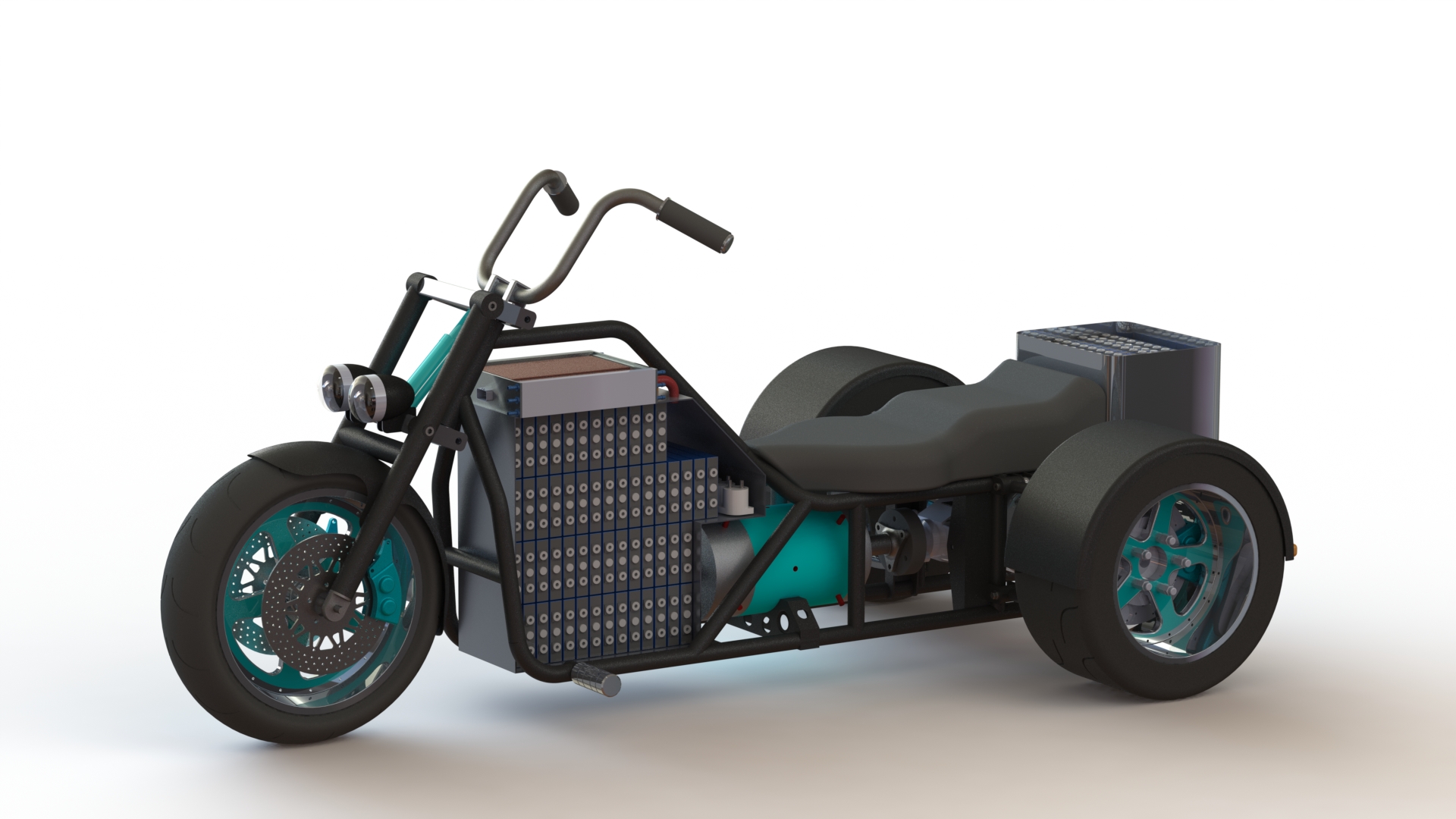

Hi Guys,
Has anyone tried using an OI with a Hyper 9 motor?
I am designing a trike and would like to use a Hyper 9 direct coupled to a 3.45 diff but i have a dilema.
I want an AC motor for regen and easy (neat) reversing, but I also want to run a high voltage pack, say 280-300V so that I can utilise DC charging via CCS or Chademo. I understand this has a lower voltage limit where a 144V pack is likely to be a problem for most chargers.
I have a Transwarp 9 already but the Hyper 9 will allow me to delete ugly reversing contactors and fit more batteries due to shorter length etc. Not to mention gaining regen.
I'm not sure if the Hyper 9 is primarily an IPM motor that also has SR characteristics or the other way round and whether this will work with OI.
Do you think it would be possible to run a 300v pack but limit the max volts to the motor to stay within its limits?
Are the Hyper9 and Hyper9HV internally the same and only controllers different or are there stator differences?
Im guessing required torque and rpm will govern what AC voltage will be applied to the motor anyway?
My calcs look like about 3500 motor rpm at 100kmh. Planning on small diameter rear tyres to keep rpm as high as i can but this is about as good as it gets with a 3.45.

The Hyper9 is rated for DC voltages up to 130V and the Hyper9 HV for up to 180V.
That means it will have quite low inductance so the control loop might go unstable at higher voltages than that. A way to counteract this somewhat is running a high PWM frequency. This rules out the Prius inverters. The Tesla M3 inverter with SiC FETs is designed for higher frequency, 17.6 kHz should be possible. But it is yet hard to hack, see Damien youtube channel.
All others, Leaf, Ampera, i3 will rather max out at 8.8 kHz
Apart from that it's a regular IPM that provides torque through permanent magnets and reluctance combined.

My reason for the question about the Hyper 9 is related to my design of a motorcycle trike. Originally I had planned to use a series wound Transwarp 9 because I have one, but they are quite long and takes up a lot of real estate that could be used for batteries.
Plus I'd really like to have regen and the ability to reverse easily without having to resort to reversing contactors.
But using the standard controller with the Hyper 9 limits me to 144V and I would also really like to be able to do CCS or Chademo charging (min 200-250V?).

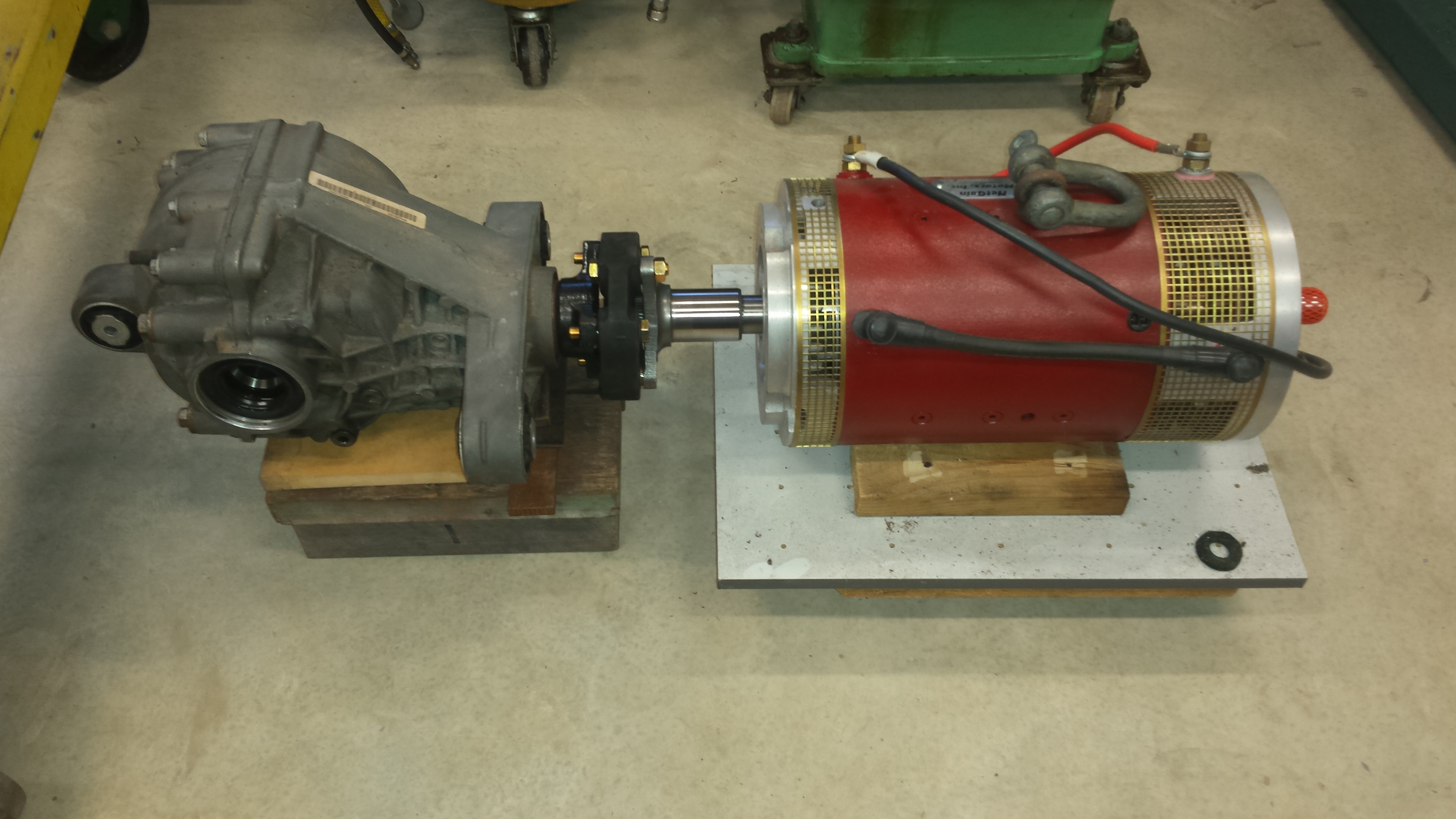

Leaf motor looks pretty small but my plan was to direct couple to a Commodore/Camaro style IRS diff at 3.45:1
The output shaft on the TransWarp9 fits the output coupler on the 6speed auto which bolts straight up to the guibo on the diff. See pic.
Obviously the Hyper 9 is not splined but I could machine up a coupling to match the 1 1/8 keyed shaft.
So my thoughts are mainly due to the off the shelf availability of the Hyper 9 rather than anything else.

That makes perfect sense. Very nice trike design BTWmikejh wrote: ↑Wed Apr 19, 2023 2:05 pm My reason for the question about the Hyper 9 is related to my design of a motorcycle trike. Originally I had planned to use a series wound Transwarp 9 because I have one, but they are quite long and takes up a lot of real estate that could be used for batteries.

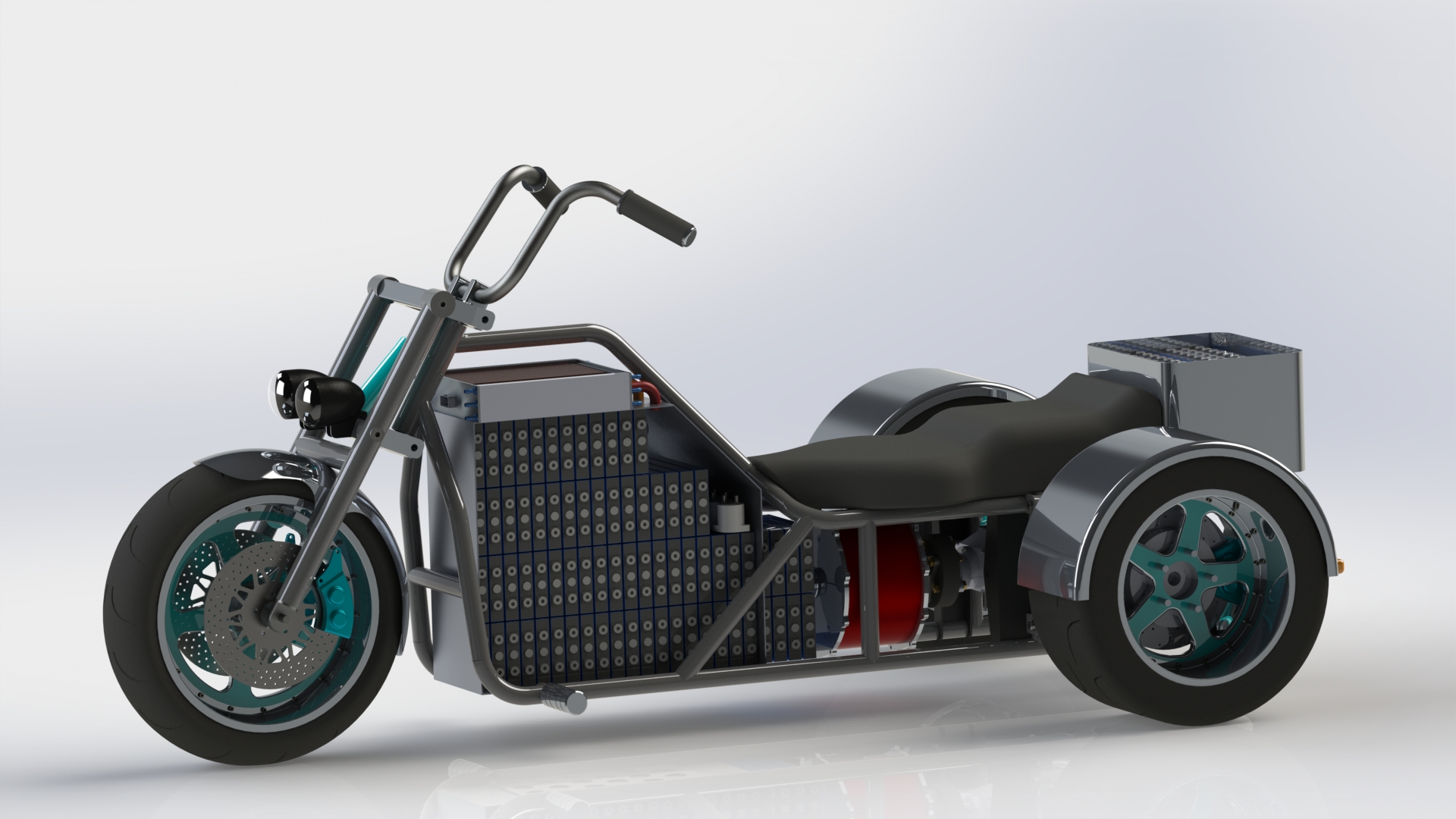

Thanks for the compliment on the trike. Its a work in progress. The beauty of CAD is you can try hundreds of combinations before ever cutting any metal. Might have to try to model up a Leaf motor. You've certainly got me thinking about it.
Shame about the tiny output shaft. Still I can machine up a similar coupler and get the splines wire cut to suit.

Maybe I'll try to fit another two cells in the rear box and go for 100 cells all up. Nice round number and 320V.
