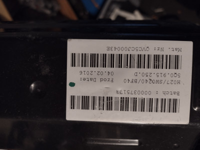

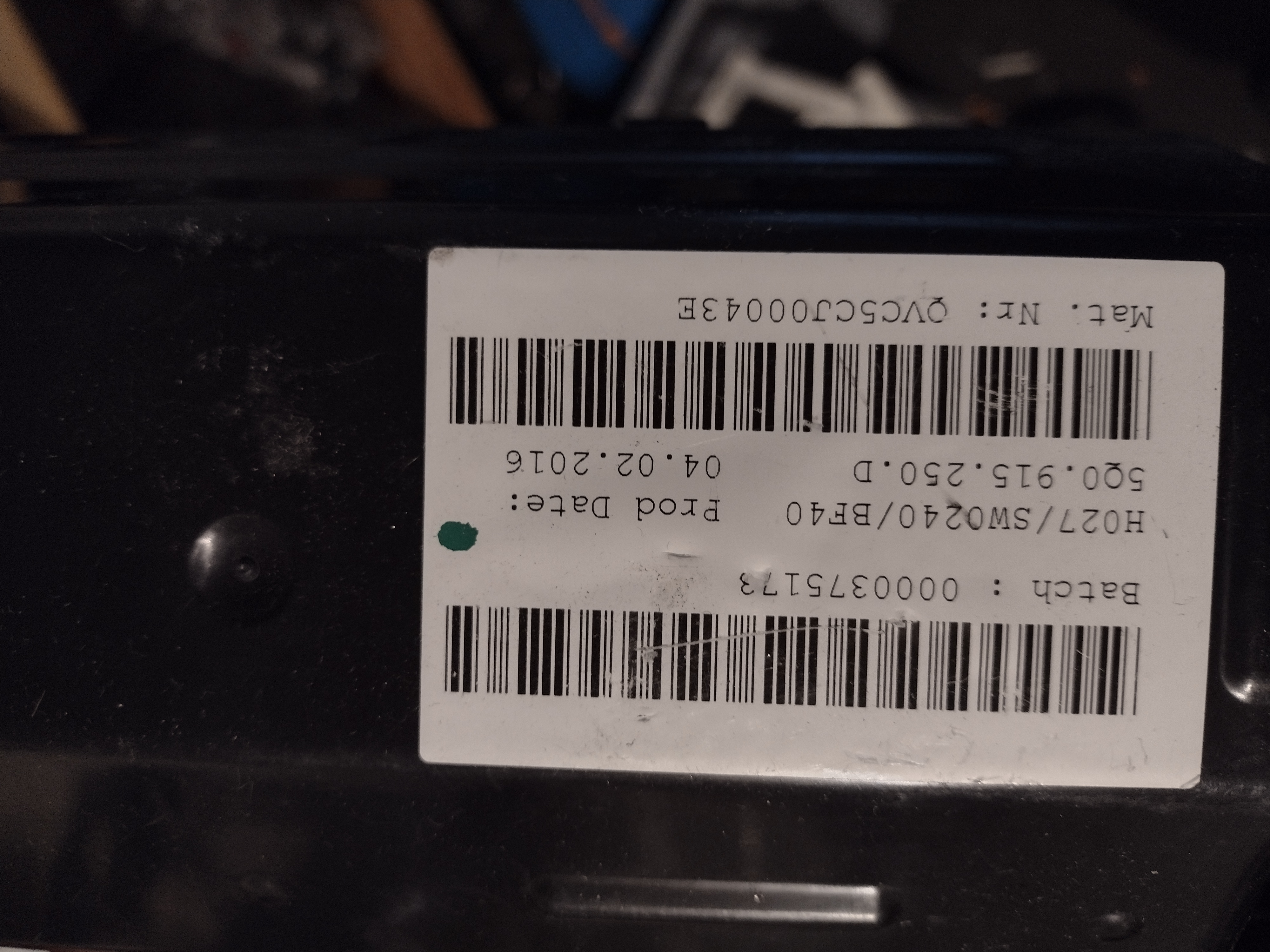

Thanks, that's a great step into the right direction!
Can I ask what's the vw part number?

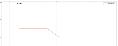

Heres a couple of can logs if anyone whats a poke around. One log has 2 tests taking place, first one without loss of isolation and second with. The other has 3 tests, no loss, loss from positive HV and loss from negative HV.
so 0xBA is the main controlling ID. I thought that 0xBB 3rd byte first 4 bits was the feedback, but that's not looking correct from 2Tests.csv
The DBC is a WIP and so shouldn't be taken as gospel at the moment.
- Posts: 1884
- Has thanked: 91 times
- Been thanked: 517 times

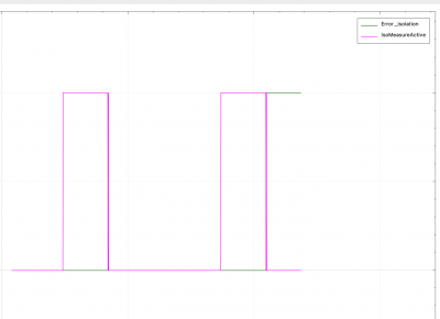

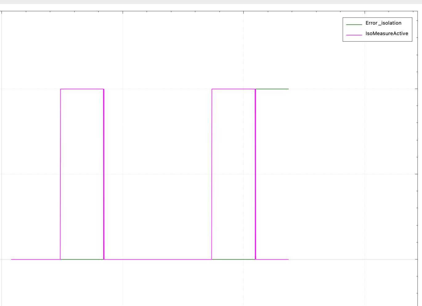

Re: VW Golf GTE Contactor Box
Right, here's another test, if 0x97 is coming from the BMS master, you can see from this plot, it does 2 tests, and after the second test the isolation error flag is set.
What I'm looking for is how the BMS master knows to set this flag from the messages coming from the Contactor Box, IDs: 0xBB, 0x15b, 0x16a95419, 0x18fed002, 0x18fed003, 0x18fed004, 0x18fed005, 0x18fed006, 0x18fed007, 0x18fed008, 0x18fed009, 0x18fed00A and 0x1a55545f
Nothing is jumping out to inform the master that there's an isolation issue. Any one fancy taking a look?

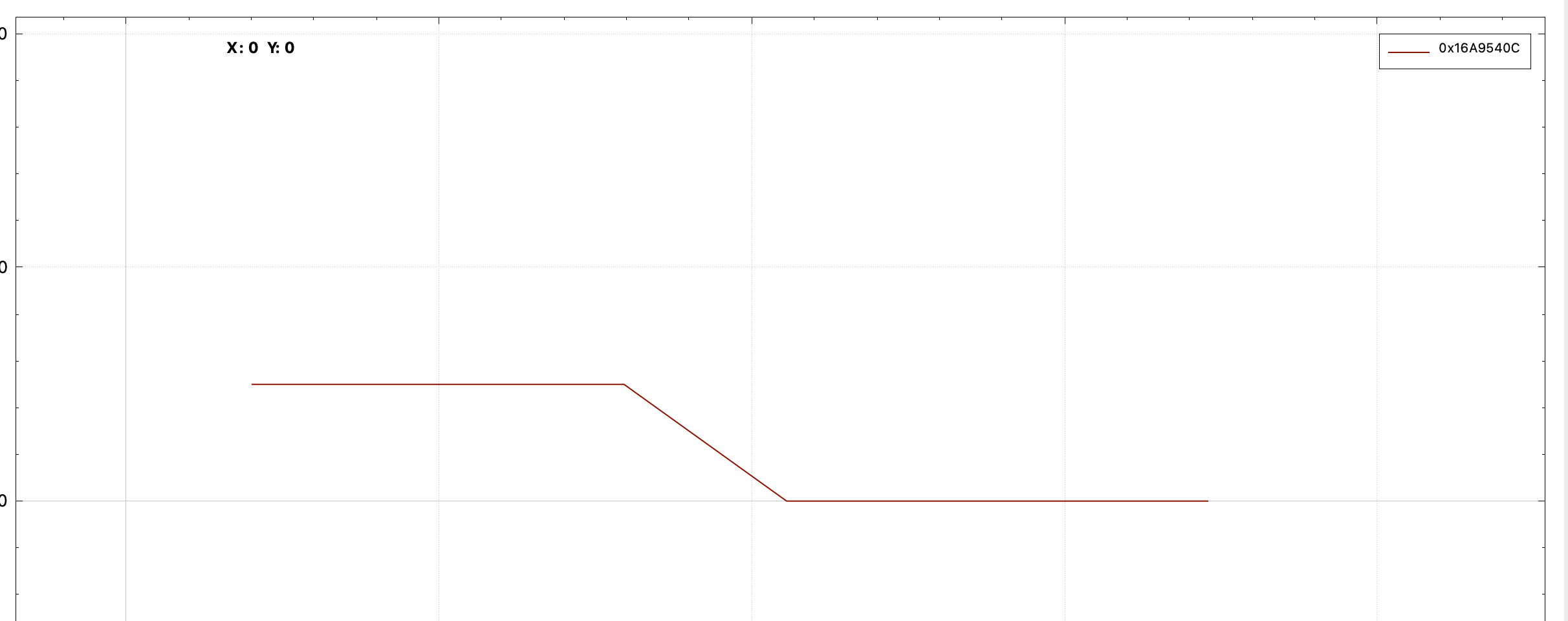

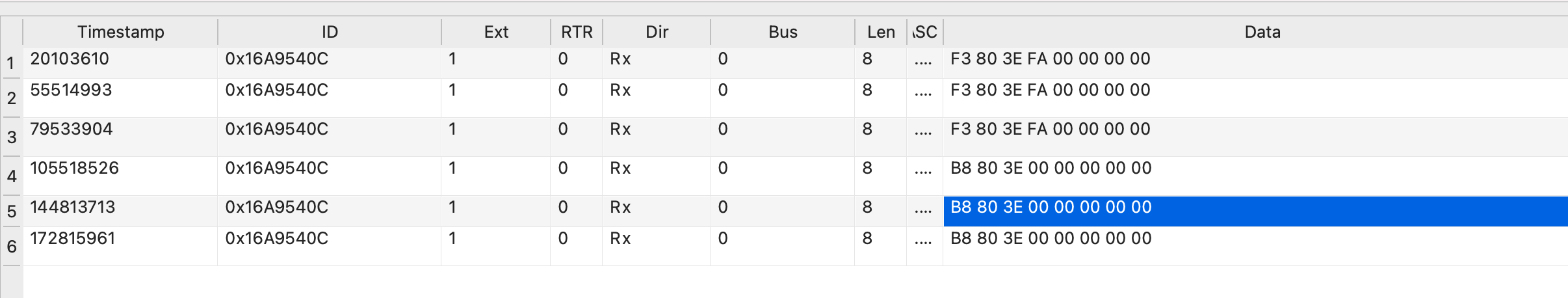

Finally got it. After an Iso test a single 0x16A9540C message is sent with the result
4th byte along seems to show resistance
Not sure if the 5th will be HV positive resistance to ground, will need to test further.
I did 6 tests, 3 first without fault and 3 with a direct short to ground from the HV negative.

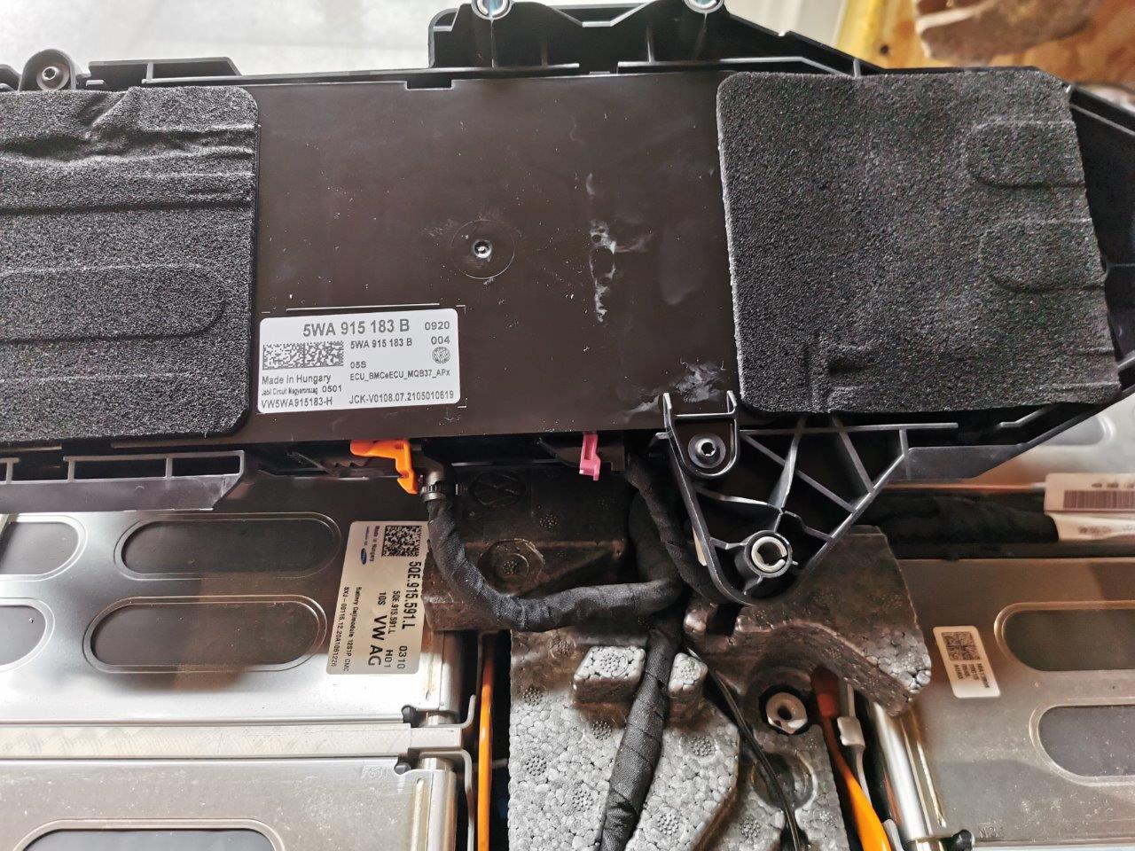

I have the same control unit with code 5WA915183B from Škoda Octavia IV PHEV (battery manufactured 2020)
Seems like control units J840 Battery Regulation Control Unit and J497 Module Monitor Control Unit
are integrated into one control unit under the contactor box so called ebox
my battery doesn't have this separate control unit marked with red circle. I think that all of them are integrated into one unit now.
picture from VAG SSP 550 – The Passat GTE
pinouts that are on the wiki https://openinverter.org/wiki/VW_Hybrid ... s#Golf_GTE don't match with this version.
I wonder where to get that kind of info?
