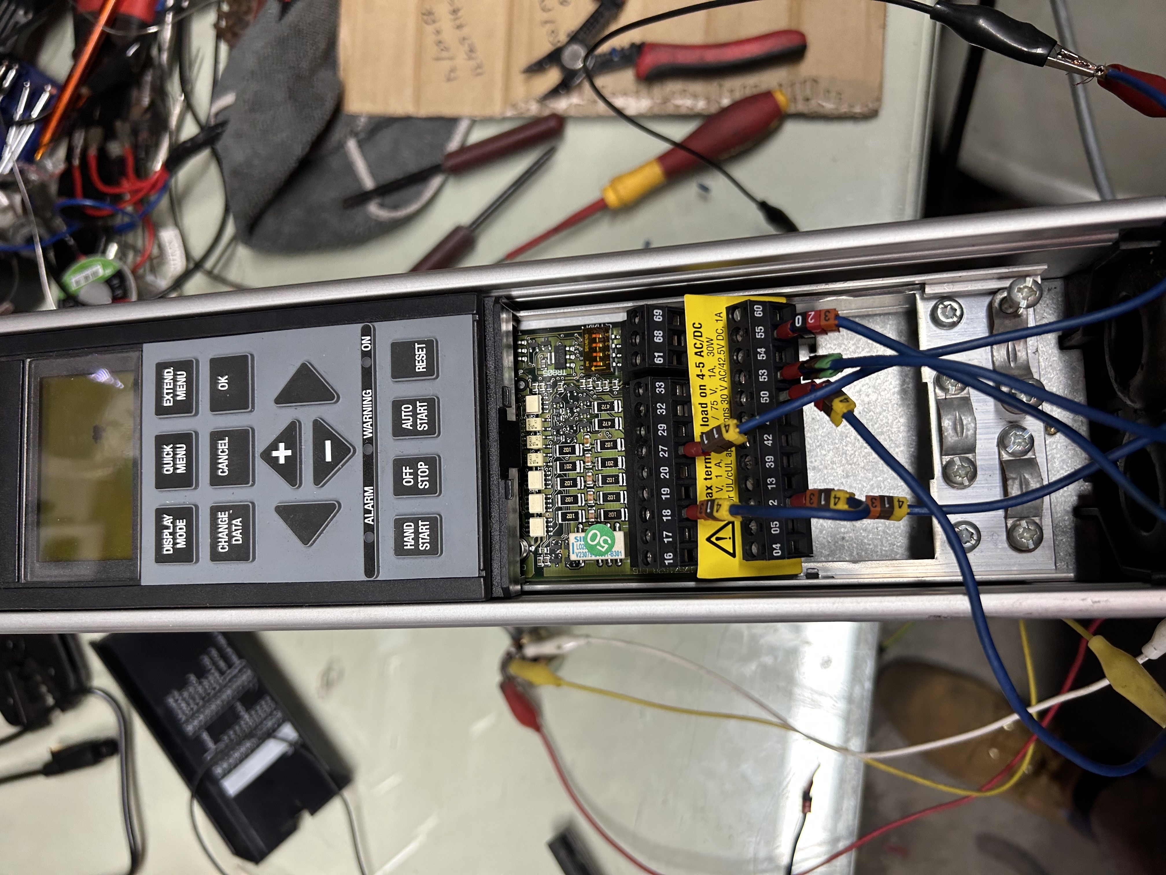

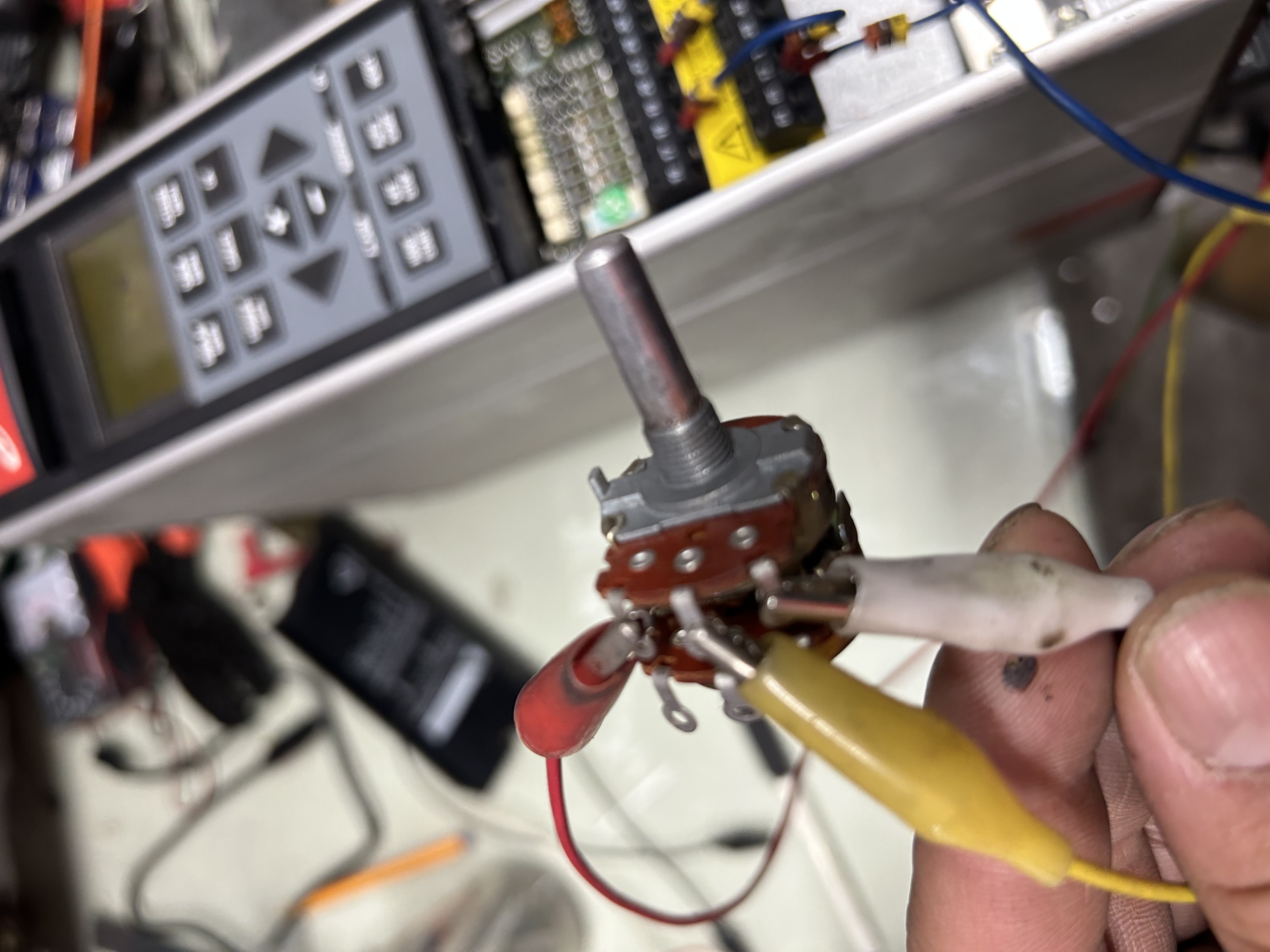

Please note that I have almost 0 knowledge about electronics and engineering aspect.
As you can see I have attached 2 pictures on my Danfoss VLT 6000 HVAC and potentiometer.
I have read through the manual and the manual says attach potentiometer to 50,53 and 55 slot.
as I did and set the low and high voltage to 0 to 10v.
changed slot 53 option to "reference"
When i spin the potentiometer i get an error of low voltage which means it's wired correctly right?
I just need to change the speed of motor via using potentiometer not the button on the panel,
Please direct me any parameter set up or process that i have take to use this potentiometer?

does the manual state how the potentiometer is connected to pins 50, 53, 55? Show the manual page and a photo of the cables from the inverter to the potentiometer!
