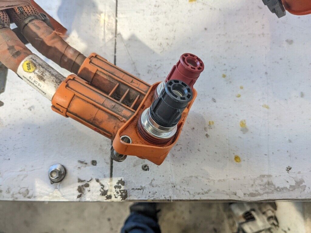

Would anyone be able to identify these type of connectors used on Audi E-Tron HV cables? Wondering if its possible to source the mating parts :)

Will have a look into it from what I have.

https://www.mouser.co.il/manufacturer/a ... -shenzhen/
Similar to this, I'll verify the part numbers when home

Thanks for checking. Do you know are the E-tron cables 95mm2?

Sorry, only have the high voltage junction box. I'll measure the internal ones and report back.

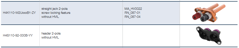

So it looks like this is a Rosenberger HPK series connector, so what I'll need is the 2-pole header if I can find it but not looking like its for sale to the general public that I can see, but at least I know what it is now
