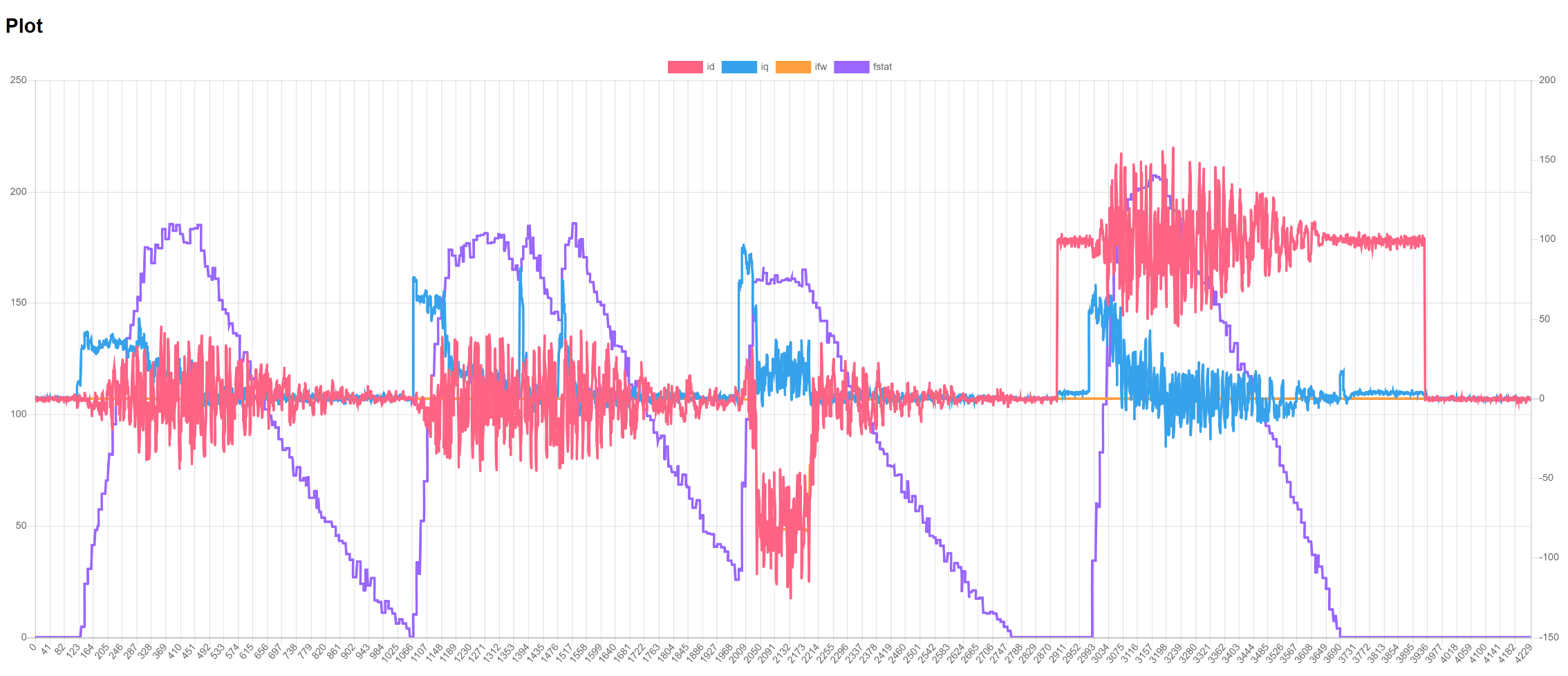

However, at my current battery voltage of 308v or so, I was only reaching 3600rpm (180hz - it's a 3 pole pair motor) where with the original inverter my previous limit had been 4000rpm (200hz). So as a first attempt at setting up flux weakening, I took an initial guess at the fluxlinkage value, set fwcurmax to -100, and revved up. To my surprise, I only reached 160hz. I could see on the graph that Id magnitude was increasing, so I knew that the flux weakening had engaged when I needed it. After some experiments changing fwcurmax and fluxlinkage with no results, I eventually just injected manual positive Id and to my surprise this worked - was able to reach past 180hz depending on how much Id I set.

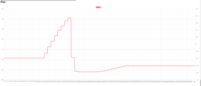

Here is a plot:
The first 2 runs are with fwcurmax at 0. The third run fwcurmax is at -100 and you can see the max frequency is lower. The fourth run manual Id is at 100 and I reached just a little past 200hz.
So seemingly the flux weakening Id output has a sign flip somewhere? I figure I must be configured improperly, since it's working properly for other folks. I tried running the motor in reverse (flipped dirmode) and still had the same behavior. (limited to 160hz at fwcurmax of -100)

Guessing that you are running on the wrong syncofs null. Try adding/subtracting 32768 to syncofs (whichever keeps the value below 65536) and trying again. The motor will run backwards (which can be fixed by swapping a couple of phases and retuning syncofs) but you should then have field weakening rather than field strengthening!

Pete9008 wrote: Fri Jul 07, 2023 7:54 am Guessing that you are running on the wrong syncofs null. Try adding/subtracting 32768 to syncofs (whichever keeps the value below 65536) and trying again. The motor will run backwards (which can be fixed by swapping a couple of phases and retuning syncofs) but you should then have field weakening rather than field strengthening!
I knew it must've been a simple fix. Now it's working great! Flipping the direction switch in the interface worked so I didn't need to swap my wires that were already all ziptied up...
