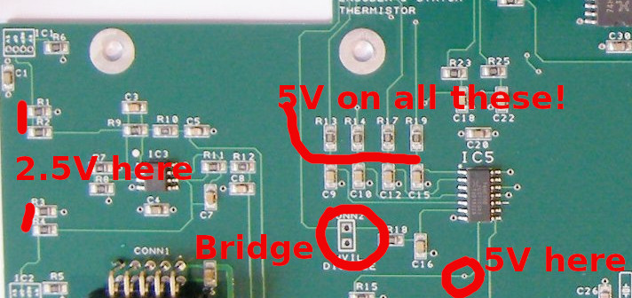

Hey all. I ran into some trouble with my latest SDU board installation. The sensors really put up a fight this time. I ended up using the heat gun a little too aggressively, and long story short, they got too hot and melted out of the sensor rings. Could I have damaged to sensor rings themselves?
I had some new current sensors and installed them with a new SDU board. I buttoned everything back up, but now I'm getting persistent OVERCURRENT errors as soon as I hit START.
When powering up 12V, I hear the precharge contactor close and see:

However, I'm not sure why it's showing udc of 83V, as I am using a 65V e-bike battery.
When I hit the START button, I see:
opmode: Off
lasterr: OVERCURRENT
status: UdcBelowUdcSw
udc: 2.4 V
udcmin: 0 V
udcsw: 50 V
[72592]: WARN - HICUROF2
[72602]: STOP - OVERCURRENT
For some reason, udc drops to 2.4V.

This is a V8 SDU board that I built and programmed myself.
The inverter & motor previously worked great with a V6 board and the original stock current sensors. I sold/traded that board+tray+sensors for their stock board+tray+sensors, so now I'm trying to get my motor back up and running with a V8 board. This is also my first time installing new sensors. I've read thru several related threads, but not sure if they apply to the V8 board.
Also, it's not clear if the Troubleshooting guide refers to the SDU boards, as the resistors mentioned are not on the bottom right side of the board. Are these still the correct resistors to test?
Any advice on how I should proceed with troubleshooting?

After loading the correct SDU params, I see the correct udc value, but I still got an OVERCURRENT error when I hit start.
I opened it up and found that I didn't quite trim the current sensor leads all the way down, and a couple were bent over and contacting each other. I trimmed them down to the board and put it back together, but I still got OVERCURRENT when I hit start. Could I have damaged the sensors?
Also, I watched Damien's latest video, which inspired me to open it back up and test the IGBTs. I followed the procedure per this thread, and the lightbulb does not light up on any phase, so I hope this means I didn't manage to fry the inverter. Please let me know if I can perform any other tests to verify this.
The new board I ordered from the webshop is still stuck in customs but should be arriving soon, so at this point, I plan to just put that in with new sensors and see what happens.

OK, I received the new board from the web shop, installed it with new sensors, and got the same symptoms as before. I.e., Everything seems fine until I press start. opmode says Run for a fraction of a second; then I get OVERCURRENT. udc is showing the correct value.
@johu - Thanks for posting the testing steps in the Electronics Basics page you made.
When I perform the first step, the voltage rises to a value over 2V (~3V), but then goes to 0V.
When I do the second step, it starts off negative and then rises to 0.6V.
Here's a video of me performing the test for clarity: https://photos.app.goo.gl/LfAy5VqAycMMVLuz9.
Can you please clarify if the 0V is ok to see after the multimeter maxes out (in my case ~3V), or should it stay at the maxed-out value? The wording is a bit unclear to me. If there were a failure, would I not see any rise in voltage at all and only ever see 0V right from the start?
Also, I noticed the parameters that came pre-loaded on the new SDU board I just received are not the same SDU parameters found in the parameter database. Can you also help me understand this discrepancy? I assume the preloaded parameters are preferred, but let me know otherwise. Attached for reference.
Thank you so much!!

Re: Persistent OVERCURRENT error after installing SDU V8 board w/new sensors
0.6V sounds fine. In the other direction it doesn't go to 0 but to OL, overload
All good.
I think you're not going to get around some probing on the control board while it's powered. Most likely culprit is the interlock which you can override by closing CONN2/HVIL Disable with a solder blob or jumper wire.
Above said jumper you will find 4 capacitors side-by-side. These all need to read around 5V on the upper side.
Finally you can measure the voltage on the left side of R15, it should also be 5V. Also check the voltage on the left side of R1 and R3 (current sensor outputs). Should be 2.5V

Here's a video of me performing the tests above: https://photos.app.goo.gl/b4rpCbvxkmJiQU2Q8
I performed the measurements both with and without the HVIL jumper shorted and got the same exact results.
R1: 2.45V
R3: 2.45V
Ohhh, haha thx for explaining that now I understand! I was really worried the inverter was toast.
They all read 0V.
R15: 3.75V
R1: 2.45V
R3: 2.45V
Sorry, I uploaded the LDU params by mistake like a dum dum. Please compare to the actual SDU params online, they are indeed very different from what came preloaded.
So all is well except those 4 signals that should read 5V but read 0V. Those are the error signals from the gate driver board. Could there be a dodgy connection? Either in soldering or in the actual connector. Does the gate drive board look clean or are there signs of heat damage or something?
R15 3.75V is fine also.

I assume the gate driver board is the one underneath the logic board that's encapsulated in clear plastic? If so, the only thing I can see are two pads marked G that have a little black around them. The 24-pin IGBT connector looks good to me. Pics here: https://photos.app.goo.gl/j5P5TPSmvoksicUJ8
Also, I only had 12V connected. Should I also have HV connected when doing the measurements?

I uploaded pics of the top of my gate driver board. Not sure if you had a chance to take a look, but I can't tell if anything looks out of the ordinary.
Sorry forgot this. Not all pins above 15 should be above 0V, but certainly FAULTA-FAULTC and UVLO.
I can't see any bubbles or black stuff on your pictures, so not sure what is wrong. Can you pull up one of the fault pins say with a 470 Ohm resistor to 5V? Or is it forced low? E.g. pin 22
