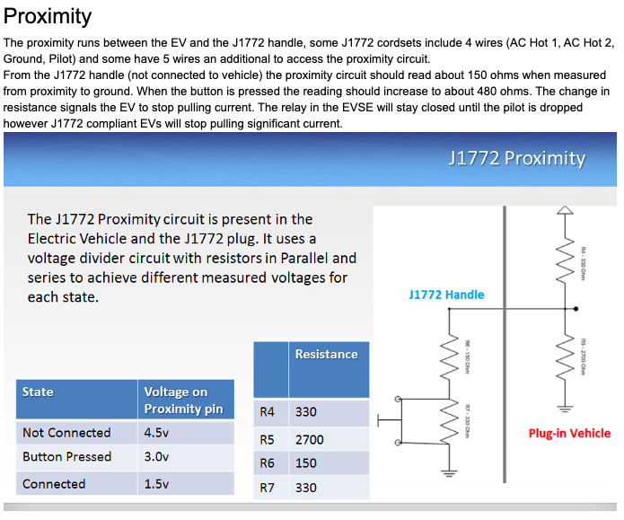

arber333 wrote: Mon Nov 11, 2019 8:36 am Does anyone have another system?
Most OEM EV's use the charging connector Proximity Pin to detect the cable. It works even if the EVSE is unpowered or faulty. Why not use that scheme?
https://openev.freshdesk.com/support/so ... -sae-j1772

Kevin Sharpe wrote: Mon Nov 11, 2019 9:43 am
Correct! I think now that EVSE connectors are standardized we can use this scheme. While i converted Mazda there wasnt firm standard, so i did what was safest at the time.
Perfect, i'll use that! Thanks!!!

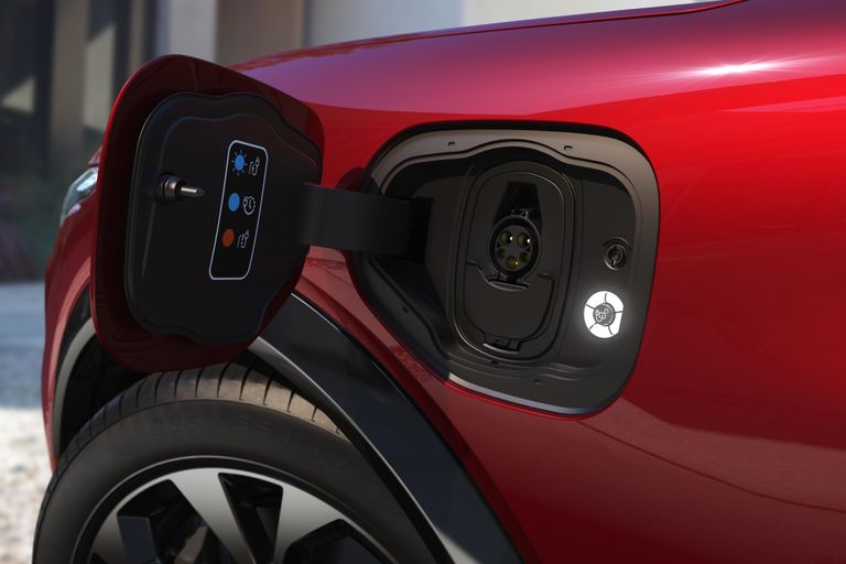

dima
Posts: 157
Re: Charging-Cable Lock and Driveaway prevention
Post by dima »
Just came across this picture from Mustang Mach-E. That door push button looks like a nice idea.
