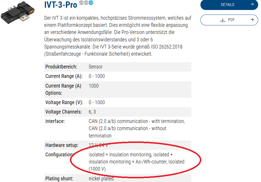

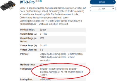

There's not many options. At least that I've come across. I've recently reverse engineered the golf GTE isolation monitor, but not yet put it to work.

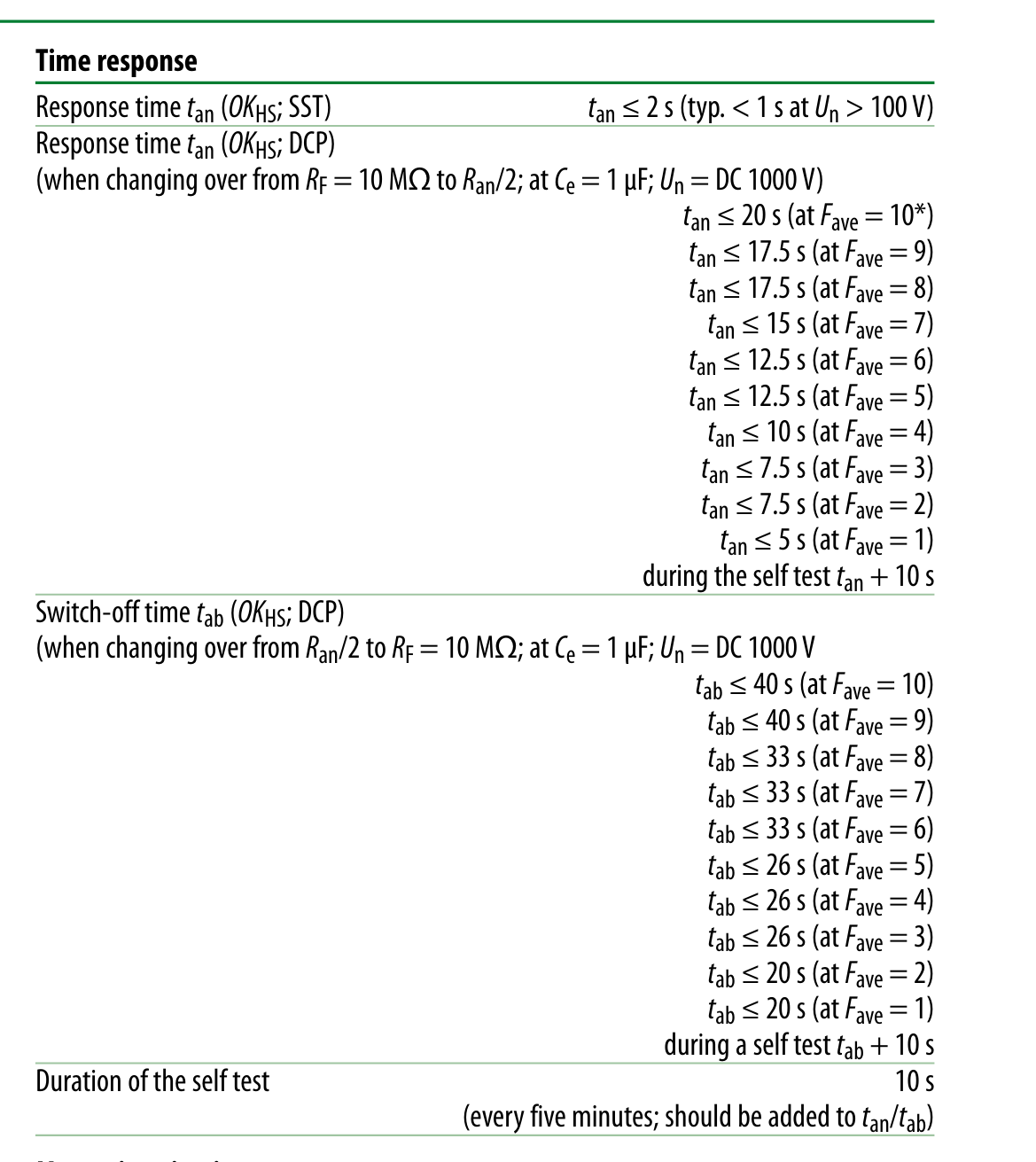

In the EU you can buy it for €290 if the version without digital outputs and with 250 kBaud is sufficient.
I was also wondering if one of the two voltage inputs can be used to monitor the DC charging port
