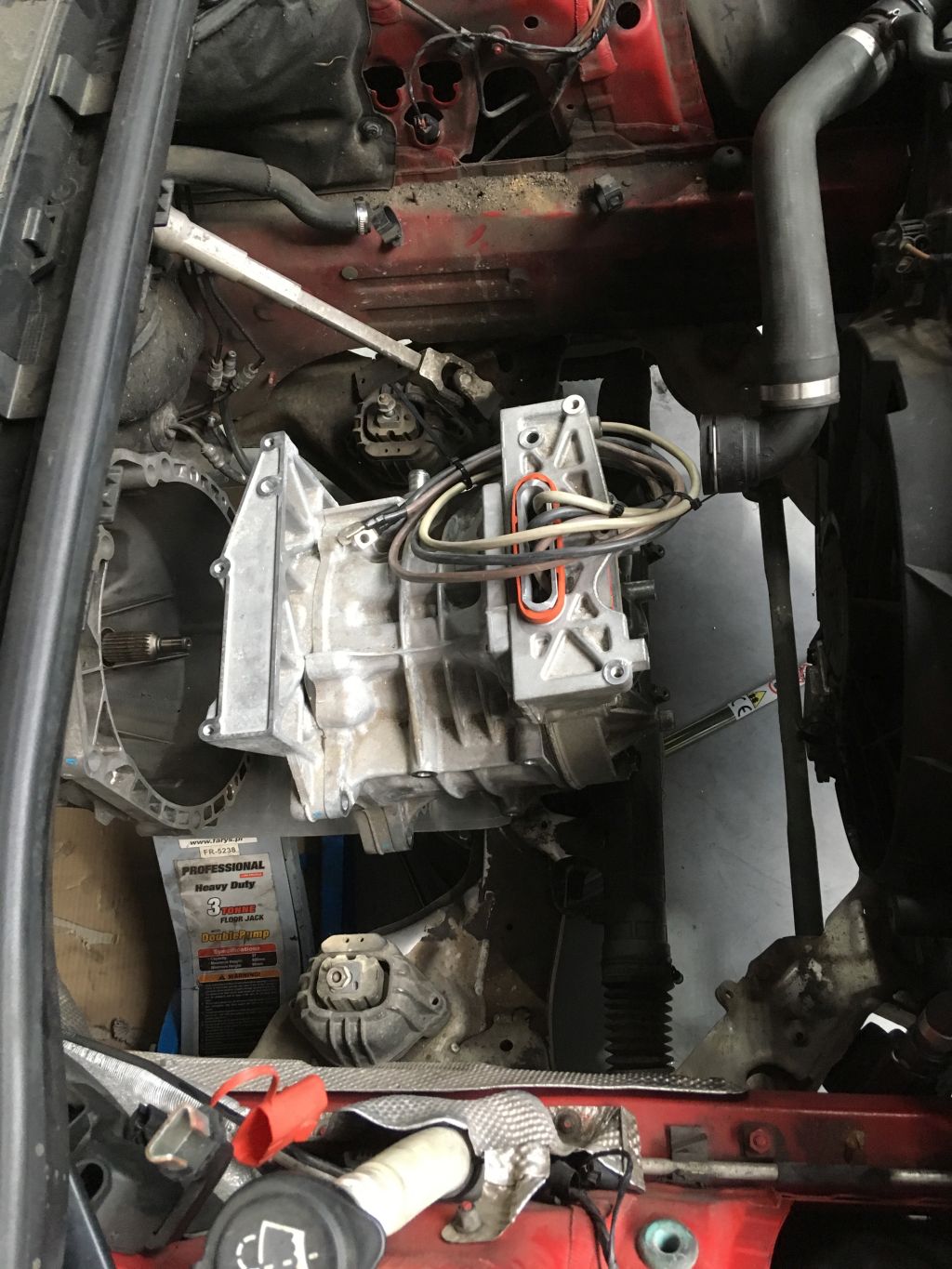

I have Installed 4.12r in my Mazda inverter and at first all was good. But today I had to drive through heavy traffic and there were severe vibrations below 2k rpm. I used the same settings than 4.71 version you sent me for testing last year.

Yesterday i installed 4.12R in my Mazda with ACIM motor and AB encoder and tried to drive. I noticed nothing special when starting etc... However in the dense traffic i noticed a lot of vibration at transition from drive to regen. This was much pronounced when throttle was held at small rpm. Amplitude kept rising and i had to use the brake to stop the shakes.
Today i replaced it with 4.71 version. It supposed to have additional encoder filtering. And it works! Driveoff is noticably smoother and transition at low rpm is felt like a small kick not lots of vibrations. It is obvious better PID is applied here since initially at start throttle applies larger torque that is lessened if the throttle is held. This feels very natural and smooth. Johannes why not apply this math to the later code?

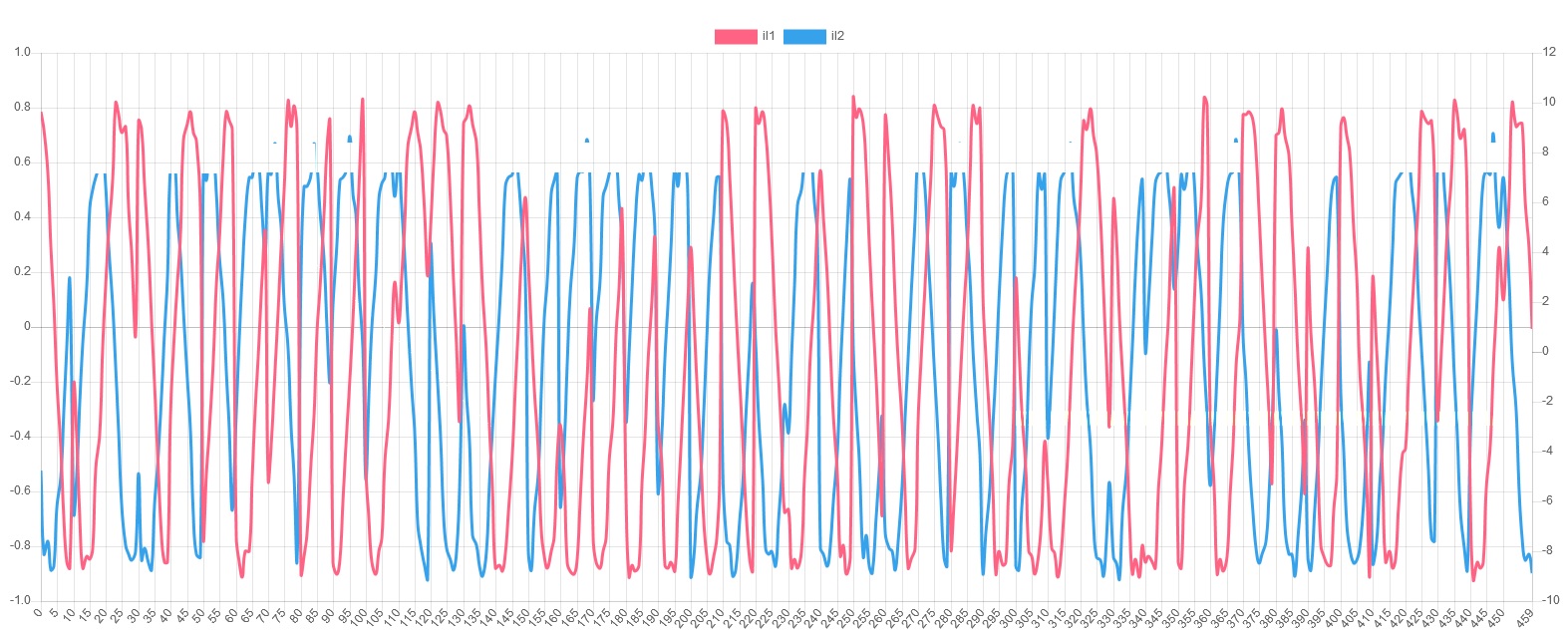

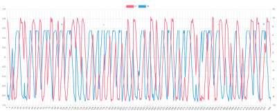

Yes, You have ups and downs but there are always about one value, let's say 10+/- 3. Mine is 2 +/- 6, strange
From beginning of my inverter I have not stable current read. Even Johannes gave ideas if I have some lamps/magnets/other interferences to Melexis chips but I haven't anything like this near to chip. Cables (strip) from Melexis 1 and 2 should be twisted and in shield maybe? I used normal tape of 3 wires. Probably at the end I will must to use Tamura current sensor.
Re: Inverter Firmware v4.12.R
Was the current graph you posted taken with no actual current on motor? Can you please elaborate the issue?damian.lo wrote: ↑Sat Mar 23, 2019 7:31 pm Yes, You have ups and downs but there are always about one value, let's say 10+/- 3. Mine is 2 +/- 6, strange
It was taken with motor running on bench with Start Inverter in Manual Mode.
Now I have 36V DCrail for trials.
So sorry if I’m stating the obvious but you’re reading an AC signal there and it’s normal to see an alternating signal from -8 to +8 amps.
From the motor I know, but I don't know why I was thinking that after transformating by code on gauges or plot the result will be some absolute value, let's say about 8A (+/-). So was good reading, but I was expecting like RMS value?
You should plot il1rms and il2rms for the RMS values. It seems like you plotted il1 and il2, these are the raw currents.
Exactly, I plotted il1 and il2 and expect values for rms. Thanks nailgg, that You kicked me in a.. to wake up
