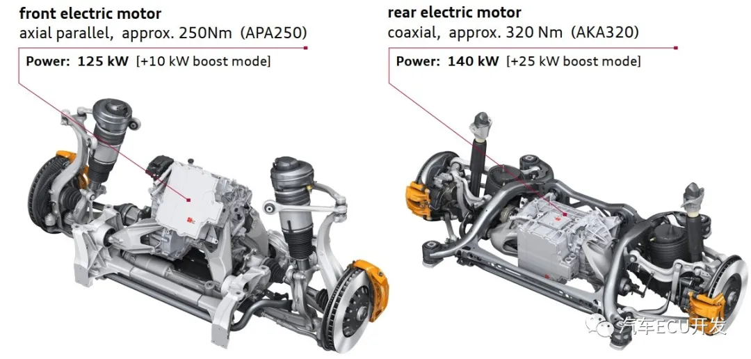

Just a query to see if anyone has a E-Tron Rear Drive unit in hand?
Looking to see if it's a worthwhile motor to look into, since it's Co-Axial, It may be a better fit for my conversion.
This link has about the best info I can find:
https://inf.news/en/auto/9438e646df1797 ... 58faa.html
Front Motor: APA250
Rear Motor: AKA320
Not too worried about the inverter right now, but if you have a motor and are willing to take a variety of pictures, I'd like to try photogrammetry to get a somewhat usable scan.

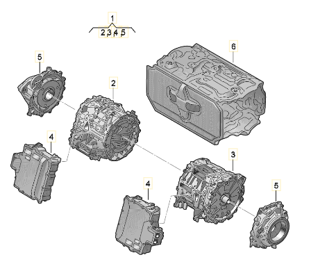

Can't help with photos but can confirm part numbers for complete traction motors - including inverter and reduction drive:
Front motor = 0EF901141AN
Rear motor = 0EF901141AM
If you're feeling 'racy' there's also a dual rear motor version from the e-tron S!
motor only PN 2&3:
right 0EF901091T
left 0EF901091S
