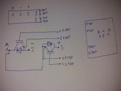

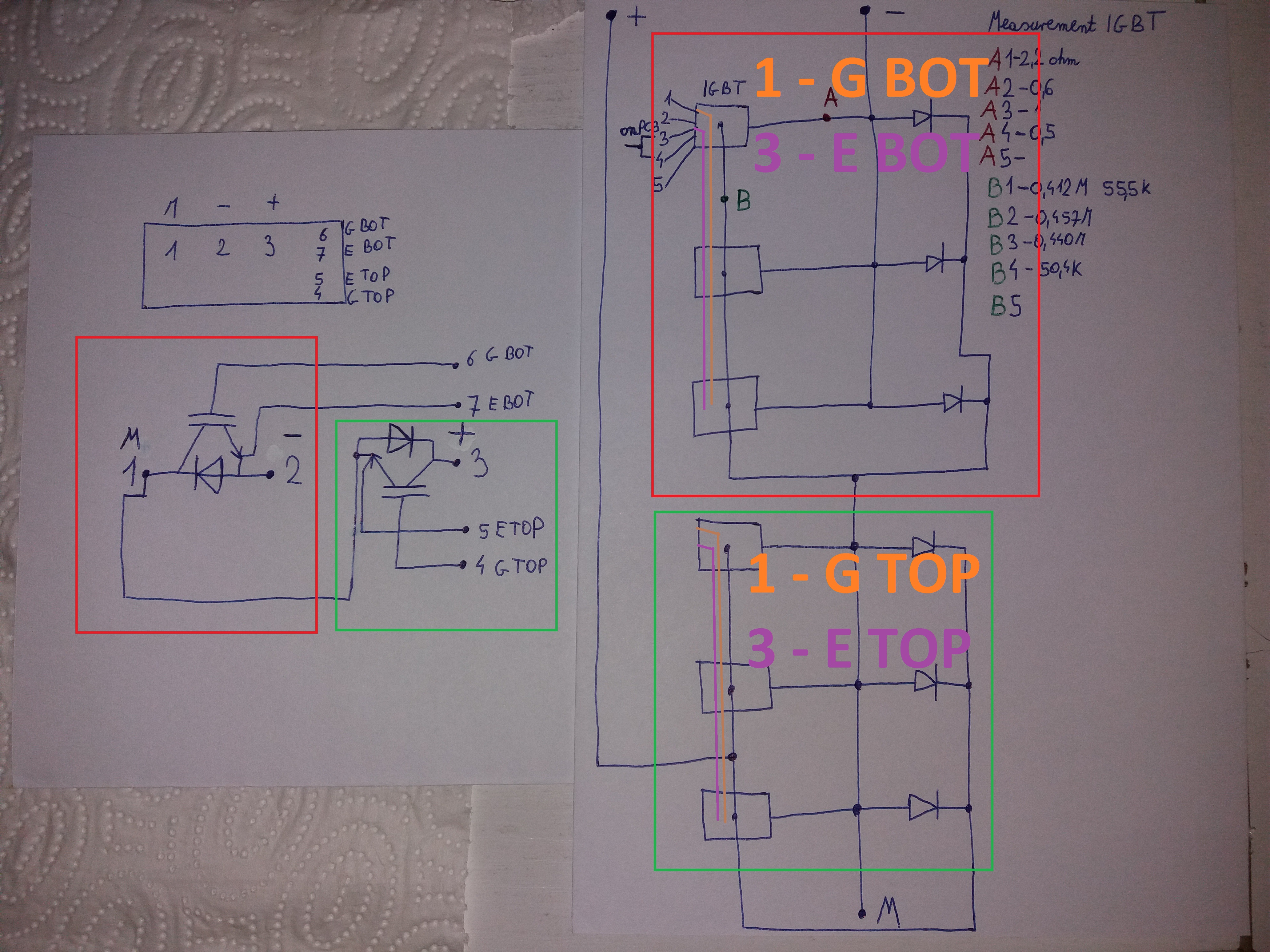

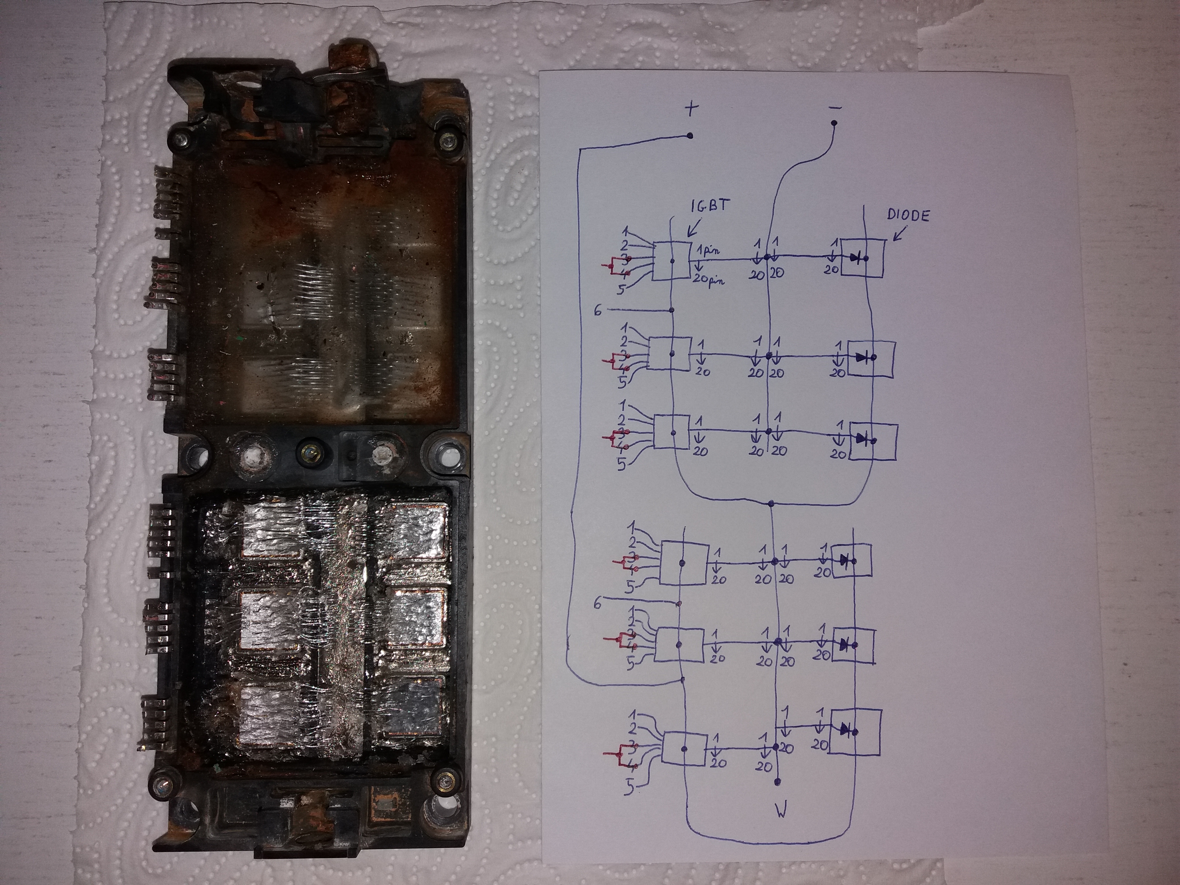

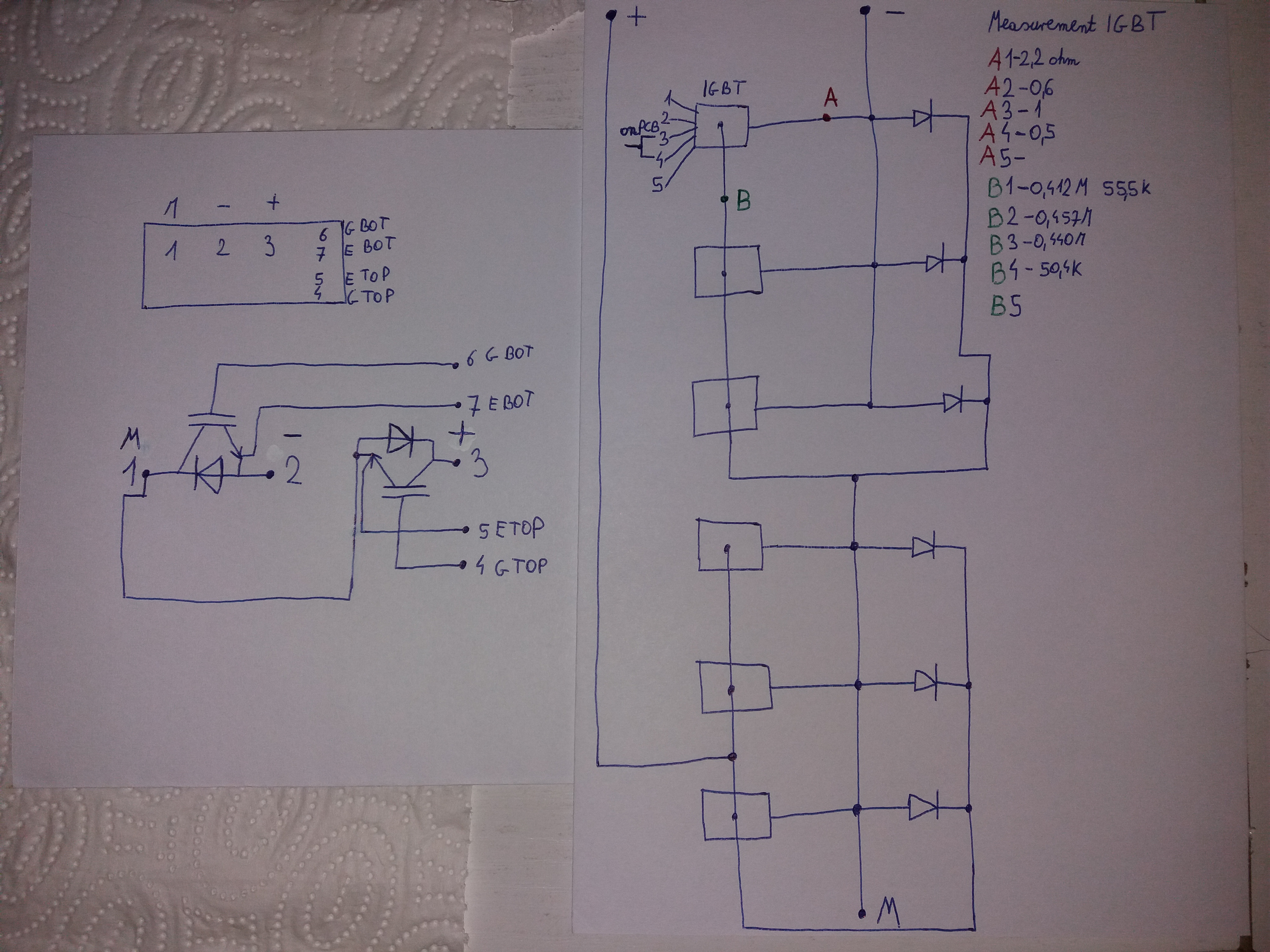

I want use electric motor also from Leaf 1
I can't find datasheet for IGBT from Leaf 1 so I don't know where are GTOP, ETOP, GBOT, EBOT
I made measurements and I drew a diagram
My inverter from Leaf 1 is after bathwater in saltwater in sea so I can use only IGBT

I think all the time how to determine where the points are GTOP, ETOP, GBOT, EBOT
I made measurements but are illogical to me and unstable. For example, A1 means resistance between connector A and 1

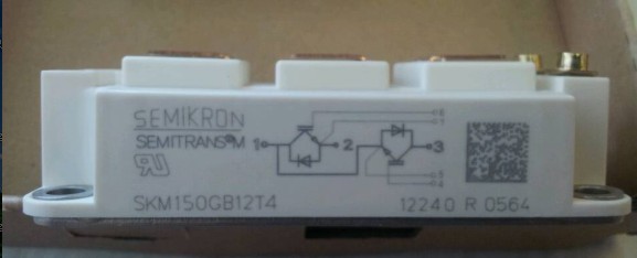

Can I please about measurements igbt half bridge module which is below for comparison
Free-Shipping-SKM150GB12T4-POWER-IGBT-TRANSISTOR-100-new-original-Genuine-IGBT-Module-Half-Bridge-232A-1200V.jpg
Been thanked: 1918 times
Re: Starting the IGBT from the Leaf 1 inverter
Do you now for the +, - and OUT are (3, 2 and 1 on the depicted Semikron module)? If so you can now find where these pins show up on the smaller connections. EBot= "-", ETop = "OUT". The gates will be pins that don't seem to connect to anything.
So you can hook up the brick to a lab power supply and feed a few volts to OUT (positive) and "-". You can find the gate by applying like 12V to the small pins until your lab supply shorts out.

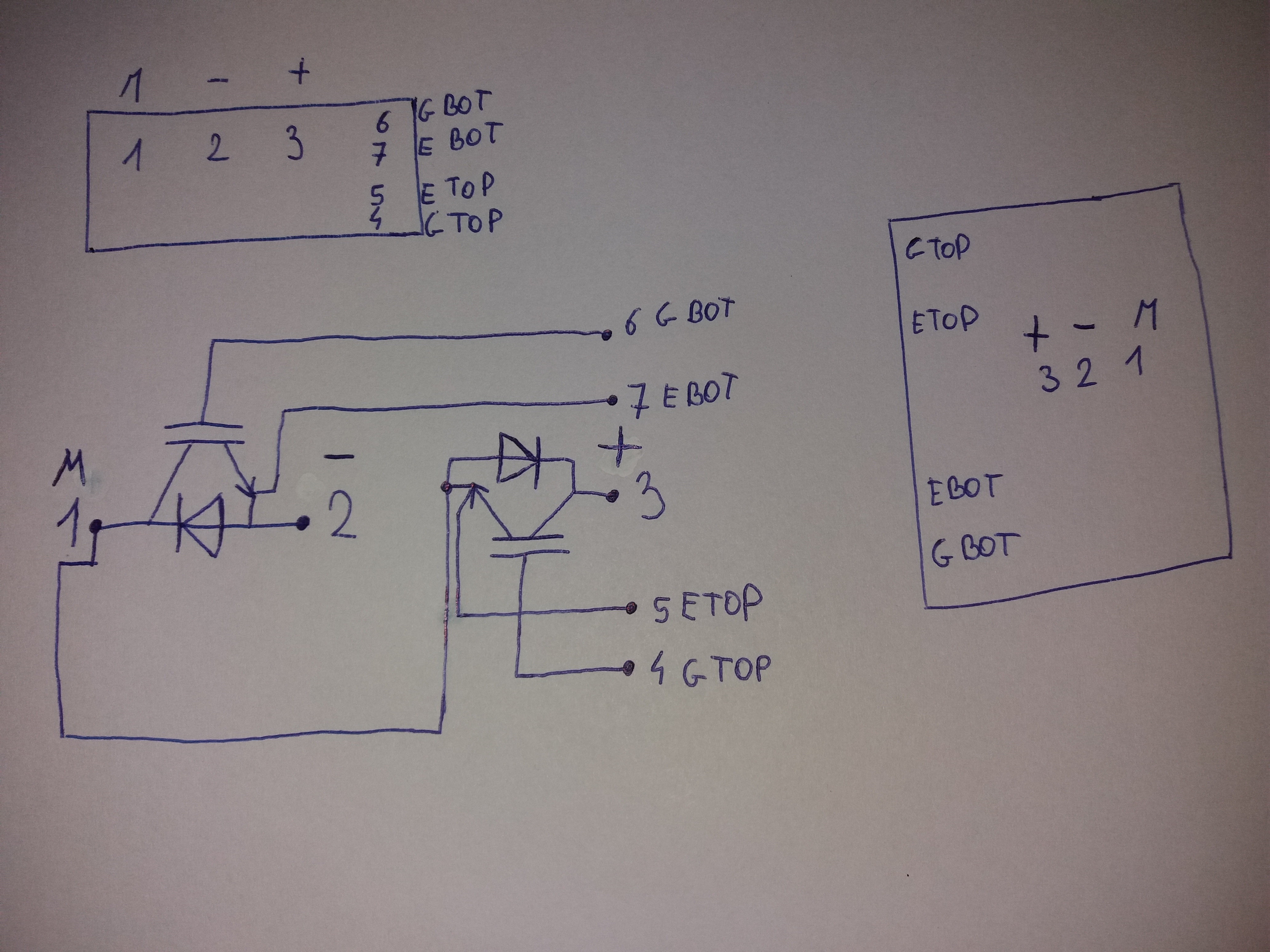

I found pins, please about checking correctness. What are the other pins for ?
Why when I took the voltage from the gate the bulb switched off (first transistor is broken) ?
Why the lower transistors conduct less voltage (the bulb shines darker) ?
Not sure why they conduct differently. Maybe still some salt water remainders?
There should also be a thermistor in each module, isolated from the other pins. I would expect a couple of kOhms between some pin pair.

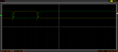

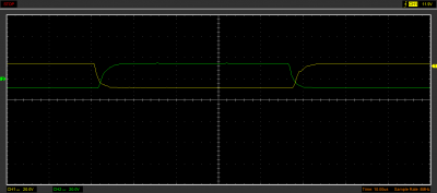

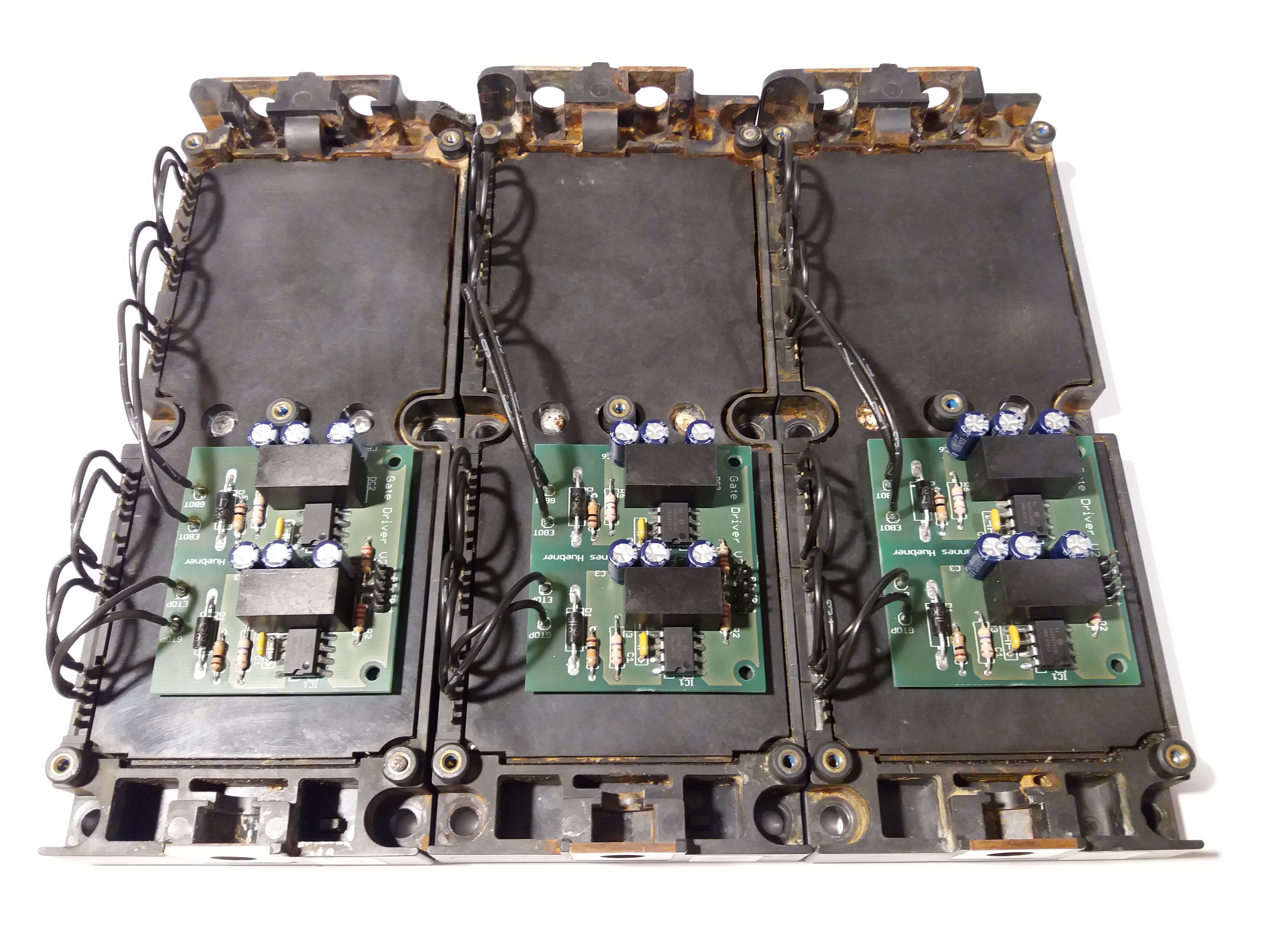

I connected IGBTs to Gate Drivers
After a short worked, each SI8261BBC for TOP side failed and Gate Drivers began to draw large current 0,3A -0,6A each one separately.
After replaced SI8261BBC draw current is ok and signal is probably correct.
But I ask myself why there was a malfunction

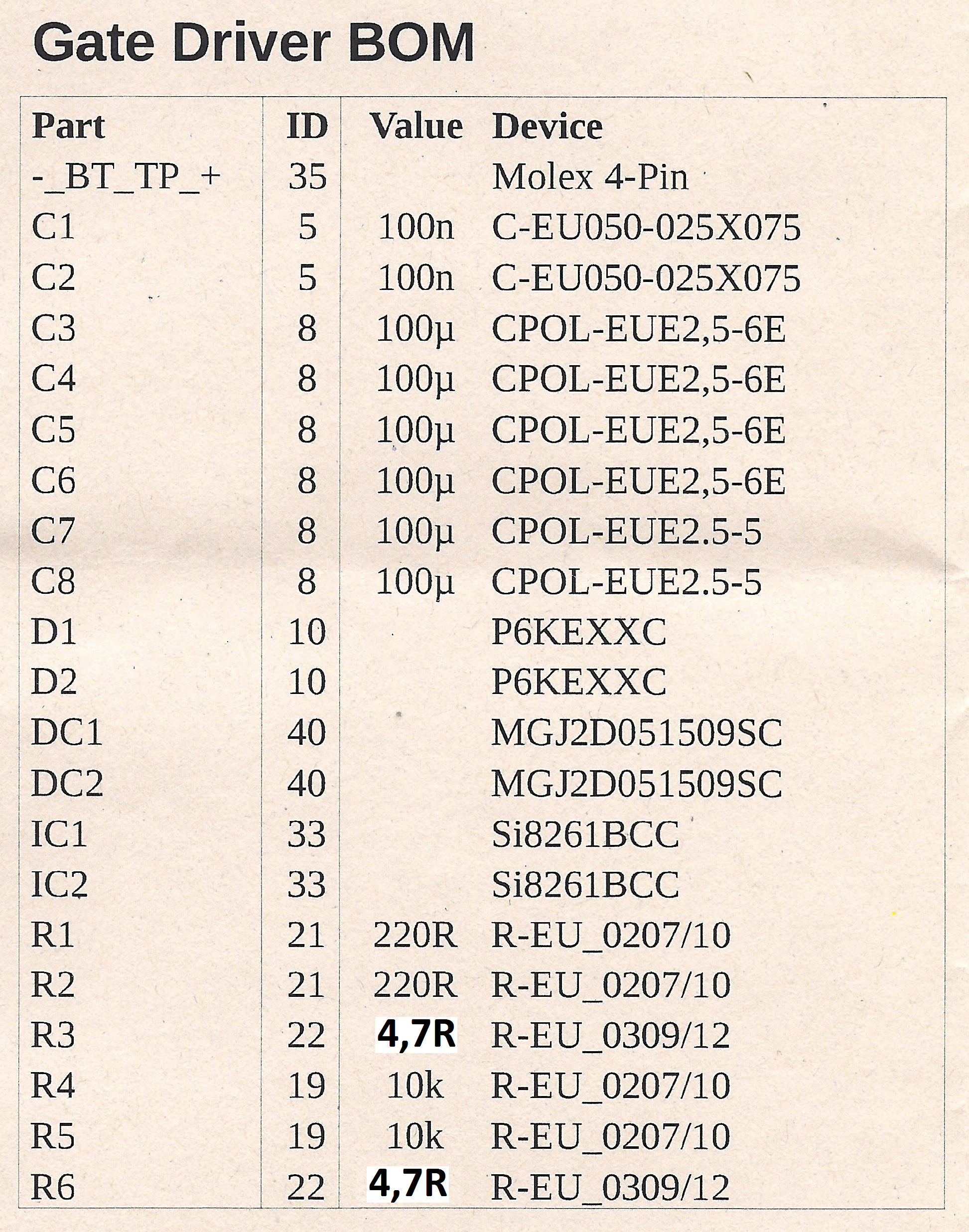

Do I have to adjust Gate Driver to IGBT ?
Do I have to change any components from BOM ?
Or maybe my IGBT is damaged ?
Johannes, what do you think about it ?

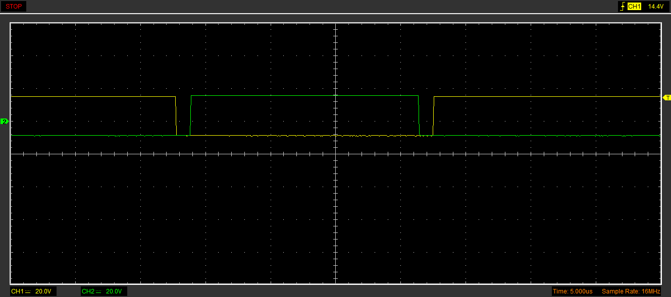

Before replacing SI8261BBC, Gate Driver 1 output, (yellow - G TOP, GND - E TOP), (green G BOT, GND - E BOT) (IGBT disconnected)

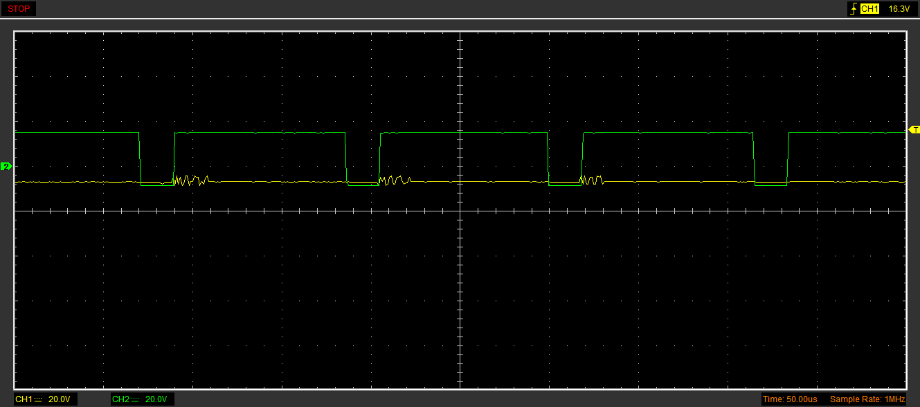

After replacing SI8261BBC, Gate Driver 1 output, (yellow - G TOP, GND - E TOP), (green G BOT, GND - E BOT) (IGBT disconnected)

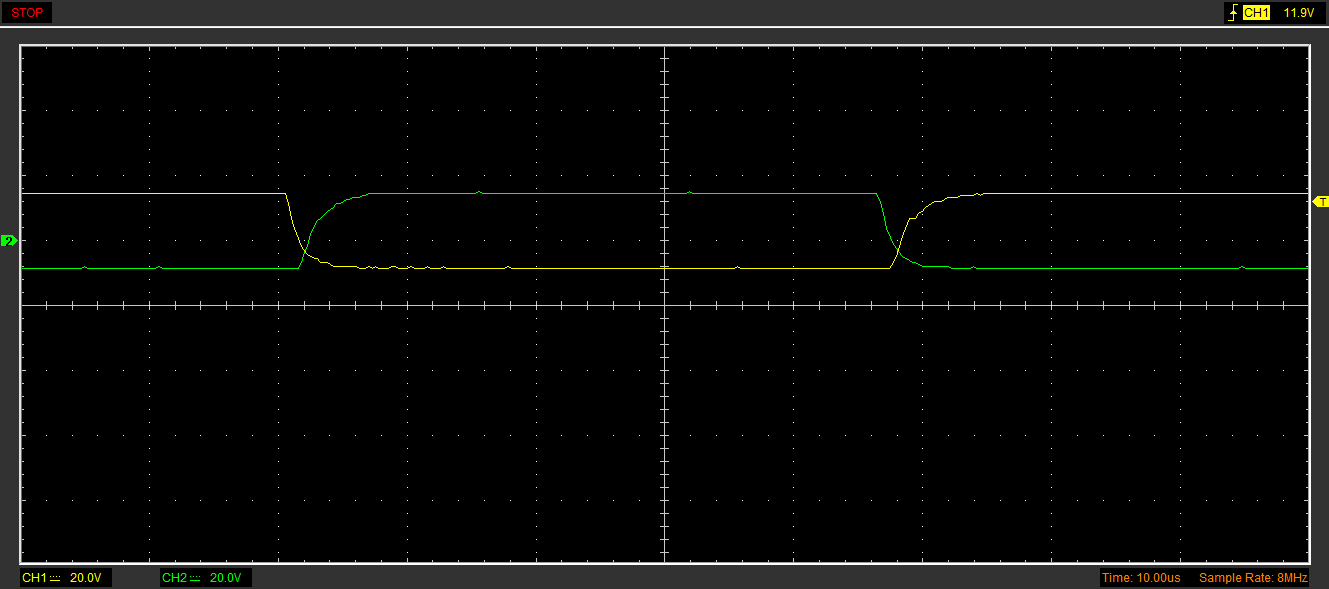

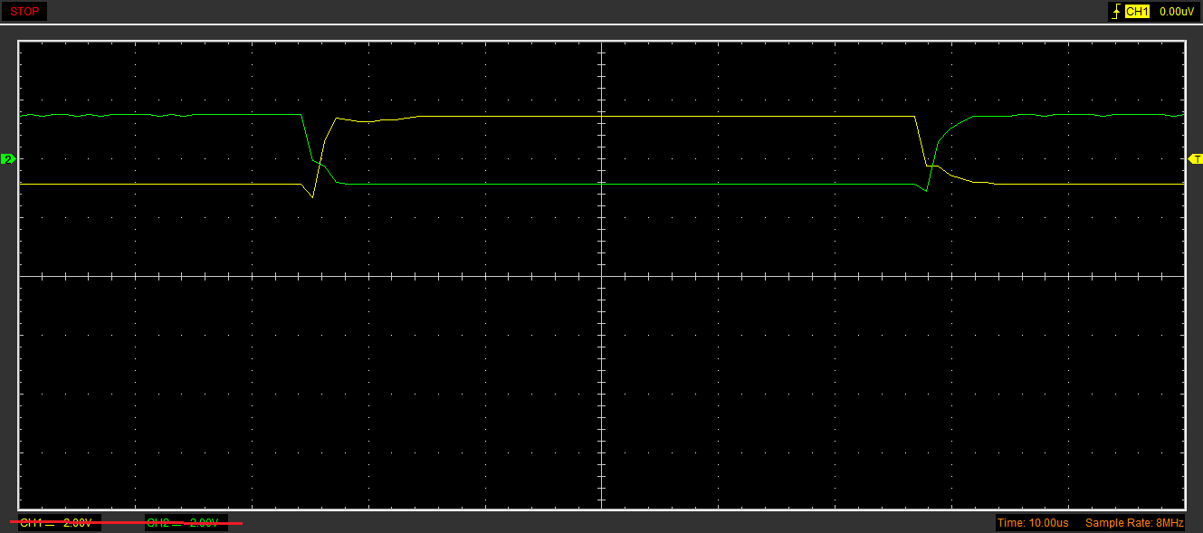

Daniel
Posts: 24
Joined: Thu Nov 21, 2019 7:21 pm
Location: Poland
Post by Daniel »

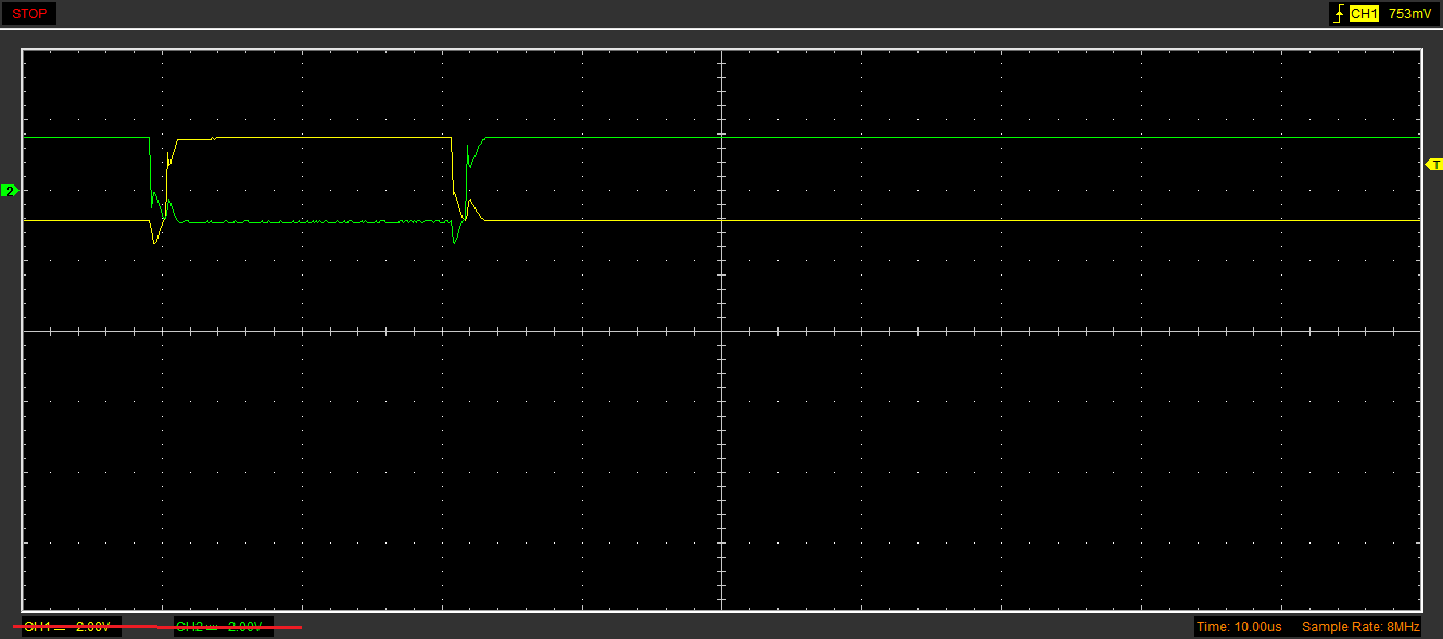

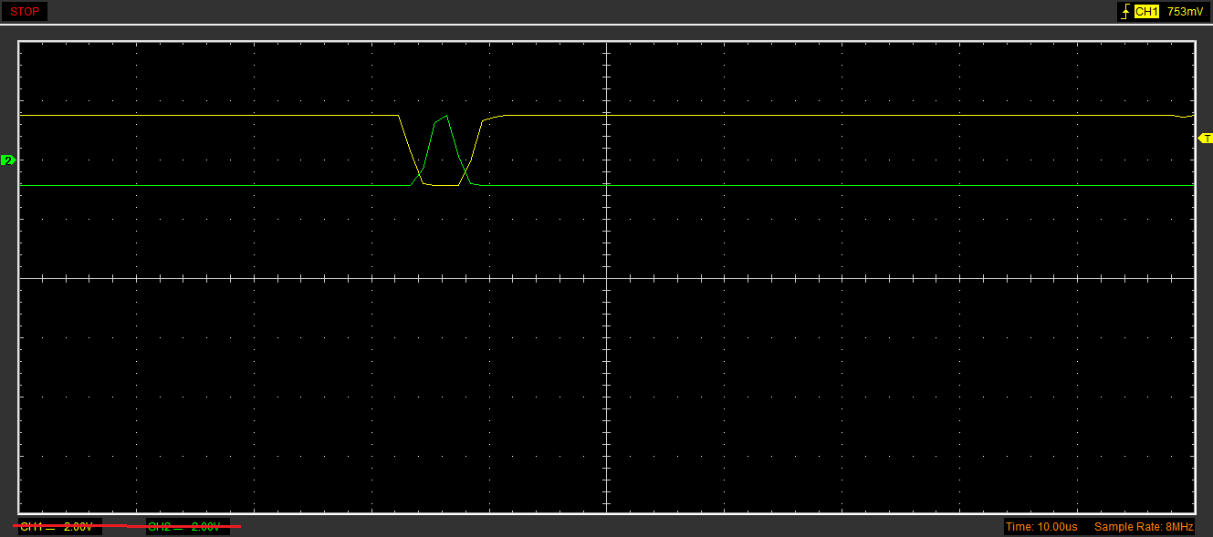

I connected IGBT to Gate Driver in several ways but it probably doesn't look good.
I think that my IGBT is broken or the Gate Driver is wrong adapted to Nissan IGBT.
What Do you think about measurements below ?
Could anyone borrow Nissan IGBT, or maybe anyone had similar problem ?
Gate Driver 1 output, (yellow - G TOP, GND - E TOP), (green G BOT, GND - E BOT) (IGBT connected)

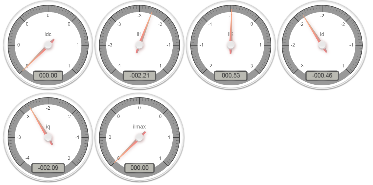

arber333 wrote: Fri Mar 20, 2020 5:40 pm What does your fault pin says?
I have only hicurof error
Device Status - resolver connected without calibration, because I have stoped in this place
During Run Mode
During OFF and in next step Run Mode
(Current channel 1 or 2, respectively, is below 1.23 or above 2.06V when no current is flowing. Check wiring and voltage dividers)
I made measurements on Main Board V3:
IL_1 - 1,628 V
IL_2 - 1,639 V
So Why I have errors ? I don't understand.
Hm... maybe you should swap your current sensor wires. When i designed my new board i setup current sensors on STM32 pins the same way they were connected in ACIM controller. But now FOC code wants to see sensor reaction from certain pin. If that does not happen brain trips error.
I solved this with swapping current sensors in software with parameter "pinswap". I think Johannes had a similar problem.
