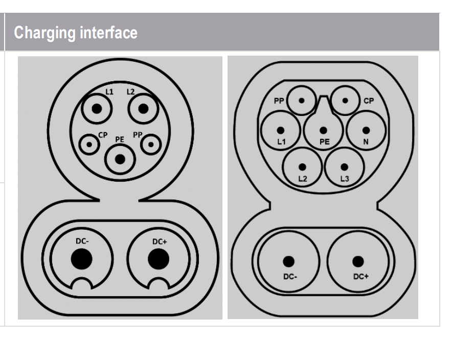

Hello, folks.
I'm sure it's a silly question, but maybe somebody wonders about the same...
Could somebody please settle the correct CCS pinout for me? The pinouts in the below 2 options are mirrored - some show DC+ on the right, others - DC+ on the left. Similar goes for the CP and PP signals.
All pictures below are or the sockets\inlet\vehicle side.
I think it should be option 1.
Option 1:
Option 2:

Looking from outside to the vehicle inlet, on the right side is DC+ and CP. This is what I can confirm from various CCS2 test setups. This would match option 1 above.
