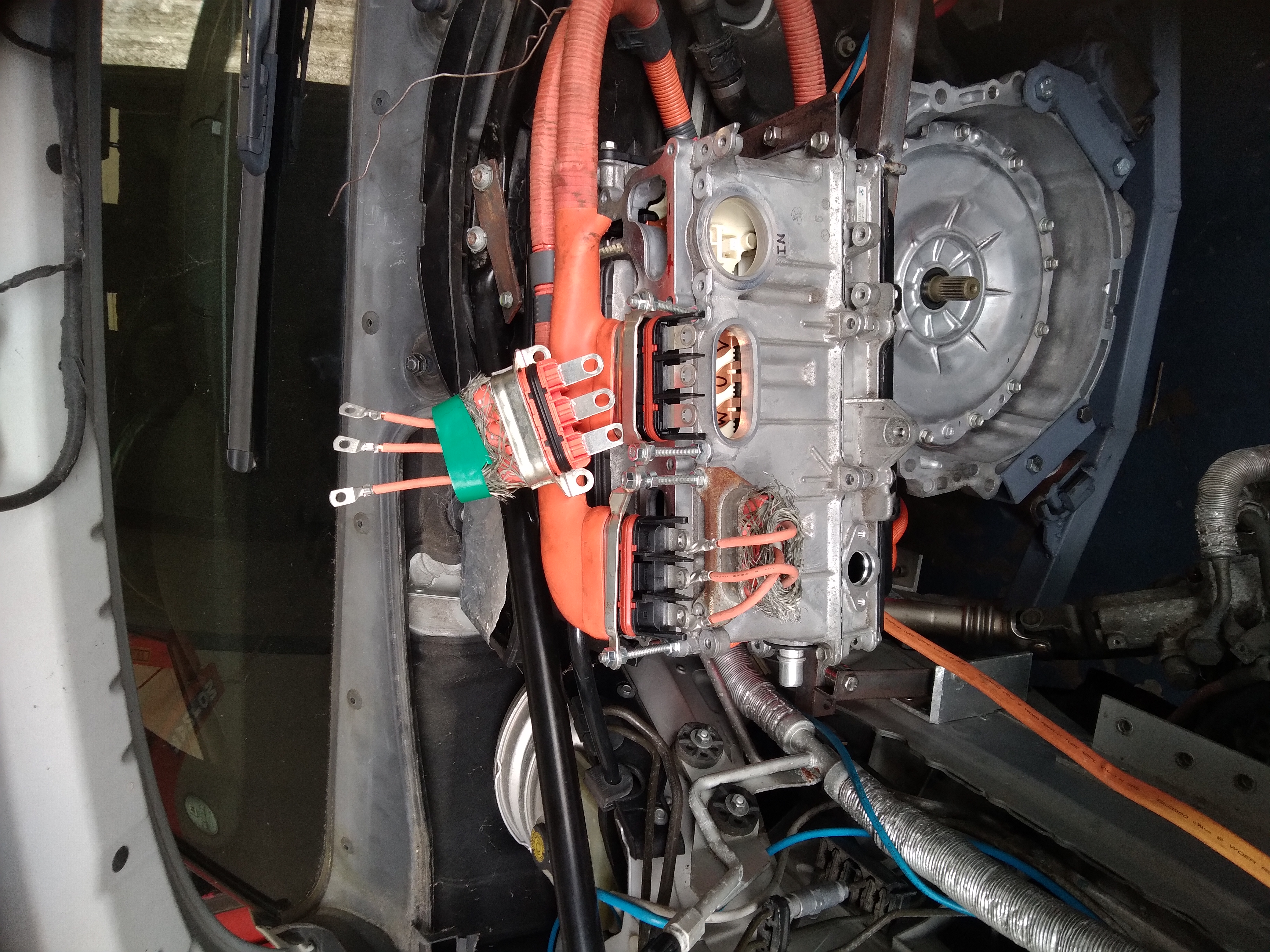

This last month have been aiming to find how usable the Gs300h L210 is, progress is that have a drivable rig to help find dome answers... Early days, but progress to here so far.

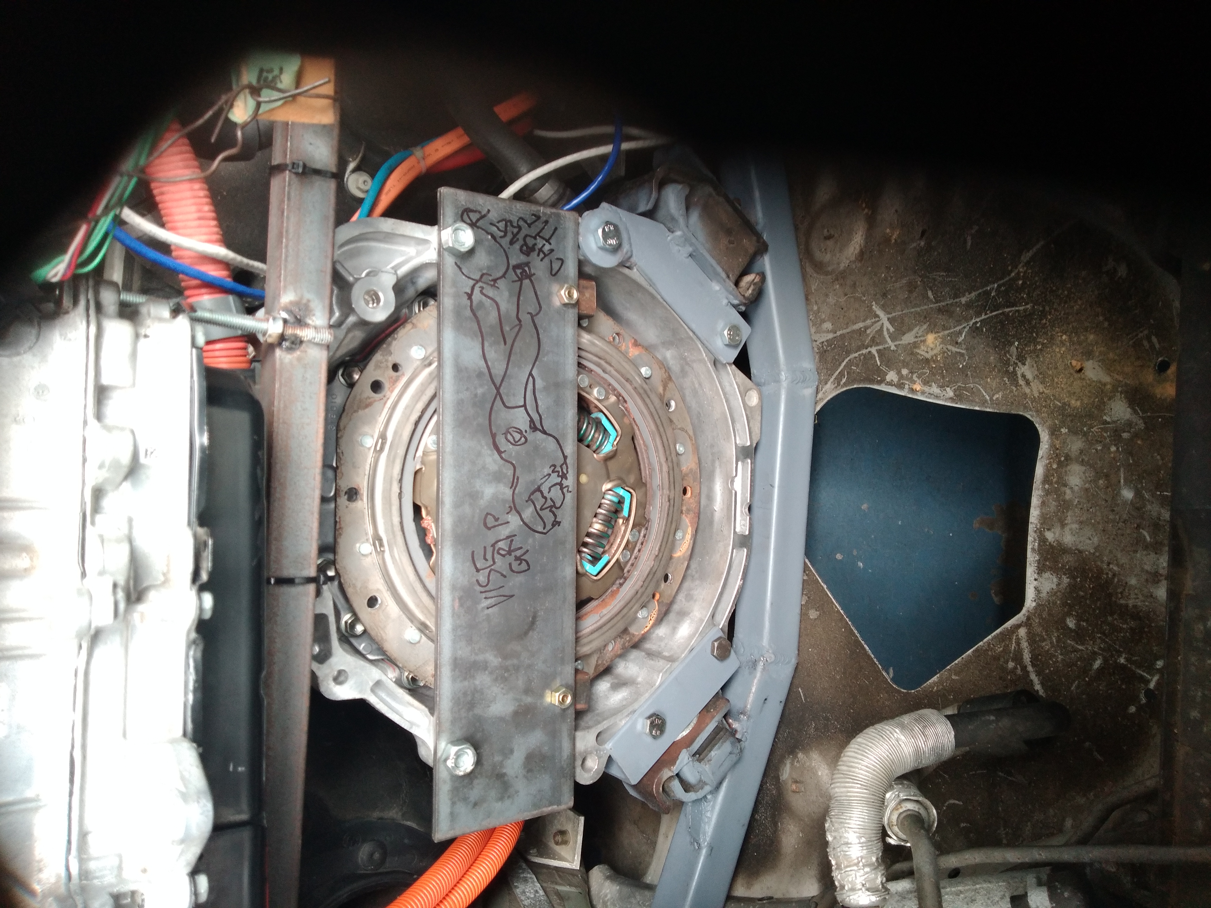

The test rig at present is using MG2 only, and until yesterday had not locked the IC input shaft, so effectively MG1, which has resolver connected, but no UVW, was not rotating, as the input spline was free to turn.
Am using a Prius ZVW30 inverter, with sync serial communication. I had thought it was this set up that was limiting to 45A bus current, and also a speed cap of 53kph, I guess at maybe 2000rpm MG2 speed, I will get a display and confirm this.
Some brief runs, before rain set in, and some fiddling of HTM stream, and managed marginally better, but more testing to confirm this when weather permits.
Will update as progress made.

Locking plate in place,
couldn't find a real pair of Vise grips and a cable tie,
Hope to try some varying HMT data 76, and 78, I think for the Zvw30 inverter.. Will be different numbers on the 300h inverter, and different again on 450h, which the code I am using was derived from. Unfortunately my learned friend and code expert is down with covid at this time.
The task continues.
