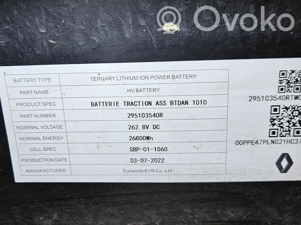

marcexec
Posts: 239
Location: Dublin, Ireland
Has thanked: 1042 times
Been thanked: 111 times
Re: Audi A2 Prius Gen2 - huh again?
Post by marcexec »
The Dacia Spring one that was recently discussed maybe and the newer BMW PHEV packs have nearly doubled the capacity in very similar form factor.
My Suzuki RF400 build @ES
Honda IMA & Lebowski howto
Been thanked: 1918 times
Spring battery sounds good, is it at least 96S? Couldn't find much details
EDIT:
Too low on voltage :(
