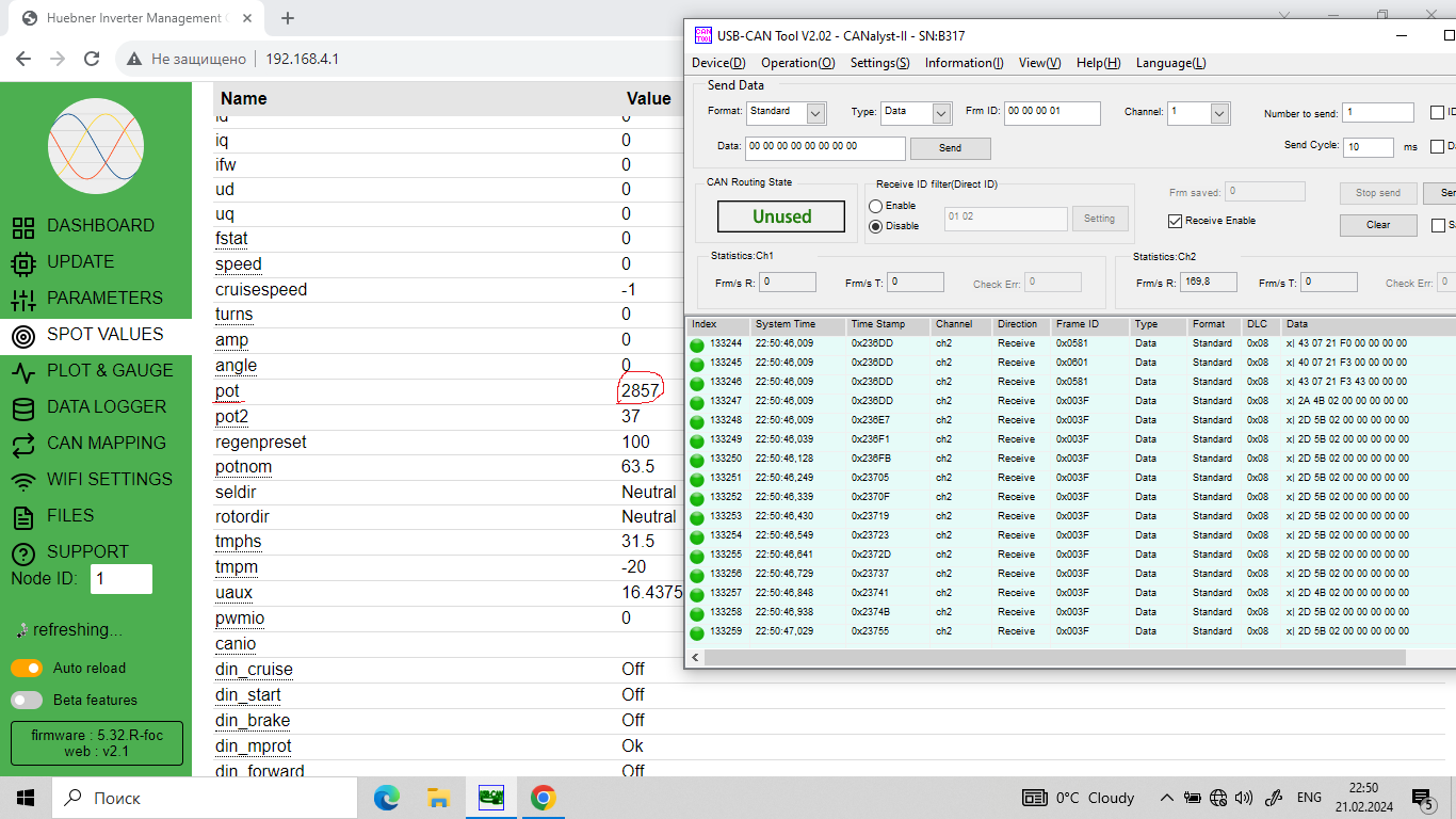

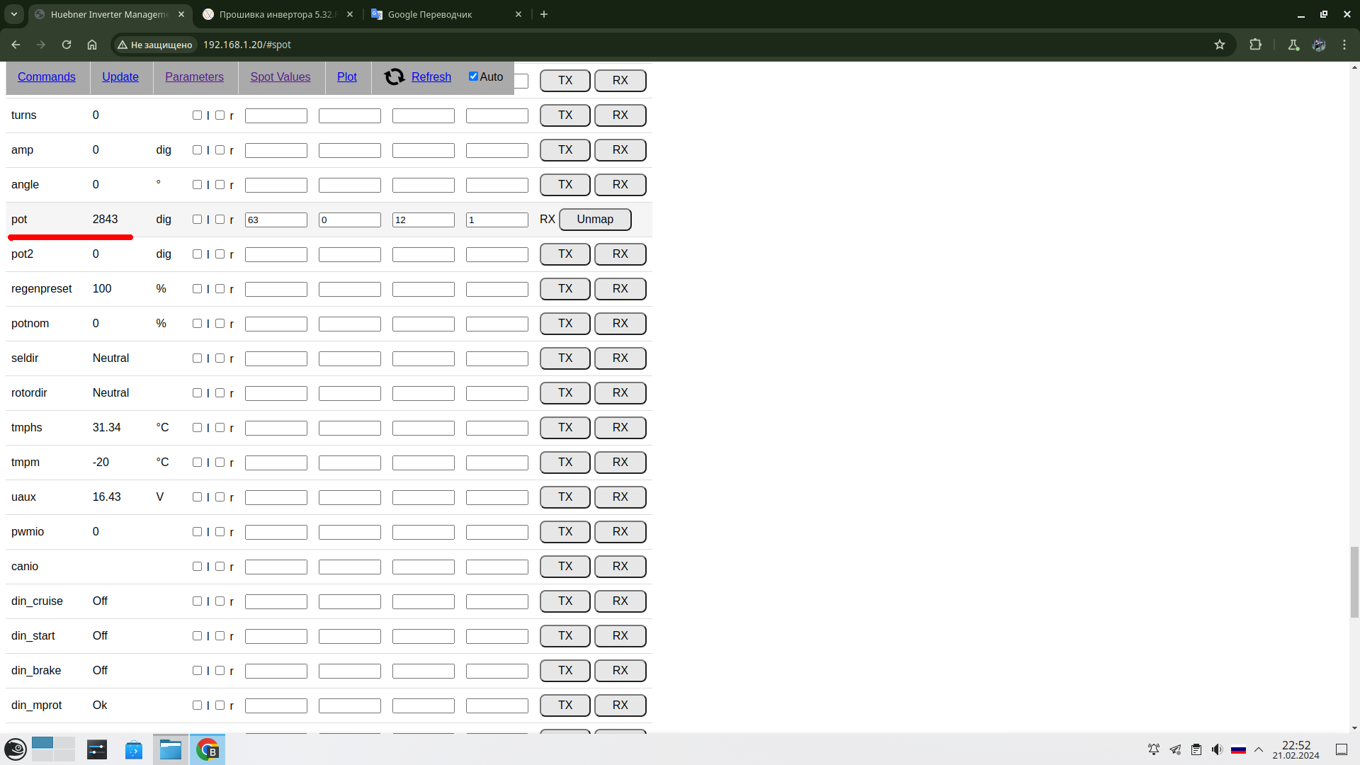

Tried to update this morning but can’t seem to get the can throttle between my 2 Prius gen2 boards working, one board uses analog throttle then transmits pot and pot2 via canto the second board.
Tried
Pot Tx 1, 0,16,0
Rx 1, 0,16, 1
Pot2 Tx 1,12,16,0
Rx 1,12,16,1
No joy just cantimeout error
Noticed the extra Id and node options in communication, do these need to be the same or different?
Feeling pretty dumb today
Been thanked: 1914 times
Re: Inverter Firmware 5.32.R
muehlpower wrote: Fri Sep 15, 2023 3:59 pm The safety improvements have been discussed extensively, but this is the first time I've read about "Traction Control". How does it work?
Yes this is an acceleration rate limiter
Ev8 wrote: Sat Sep 16, 2023 9:45 am Tried to update this morning but can’t seem to get the can throttle between my 2 Prius gen2 boards working, one board uses analog throttle then transmits pot and pot2 via canto the second board.
Release notes :)
Safety critical control parameters now have a fixed mapping in one message with sequence and optional CRC check and can no longer be freely mapped.
I guess this was bound to happen. With this software there is no way to exchange throttle signal between inverters. Simply due to the lack of a running counter that can be mapped to CAN.

Ah nuts that’s a shame, I guess it’s a limited use case mine, but will also effect anyone running Damien’s dual motor gen3 board, not that I can think of anyone

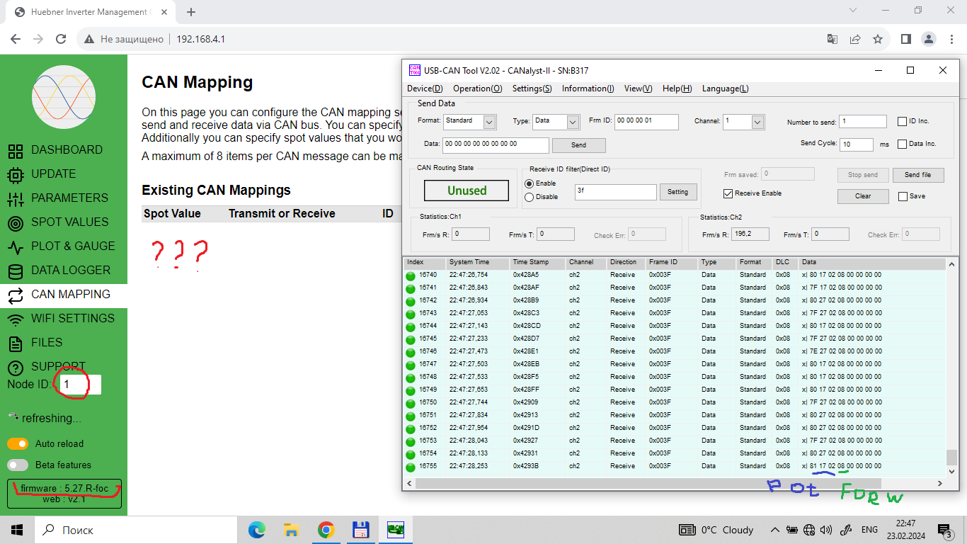

Does anyone have any examples for using the new can message for safety critical control parameters in stm32-car, stm32-vcu or similar?
If not, no worries, I'll have a go.
I sent messages manually using CANUSB and can-utlis
turnip73
Posts: 60
Joined: Wed Dec 26, 2018 1:38 pm
Location: Greystones Ireland
Has thanked: 26 times
Been thanked: 50 times
Post by turnip73 »
I had a go at using the new can message for safety critical control parameters in stm32-car:
   typedef struct {
    unsigned char SixBits:6;
    unsigned char TwoBits:2;
   } tEightBits;
   tEightBits canrun;
   tEightBits canio;
   canio.SixBits = Param::GetInt(Param::canio);
   canrun.TwoBits = g_canrun;
   canData[0] = 0 | canio.SixBits << 24 | canrun.TwoBits << 30;
   canData[1] = 0 | canrun.TwoBits << 14;
   can->Send(0x03F, canData);
https://github.com/hakanrolsson/stm32-c ... prius-gen2
Sorry, missed that one. Here's a version with the full set of parameters: https://github.com/jsphuebner/stm32-car ... r.cpp#L460

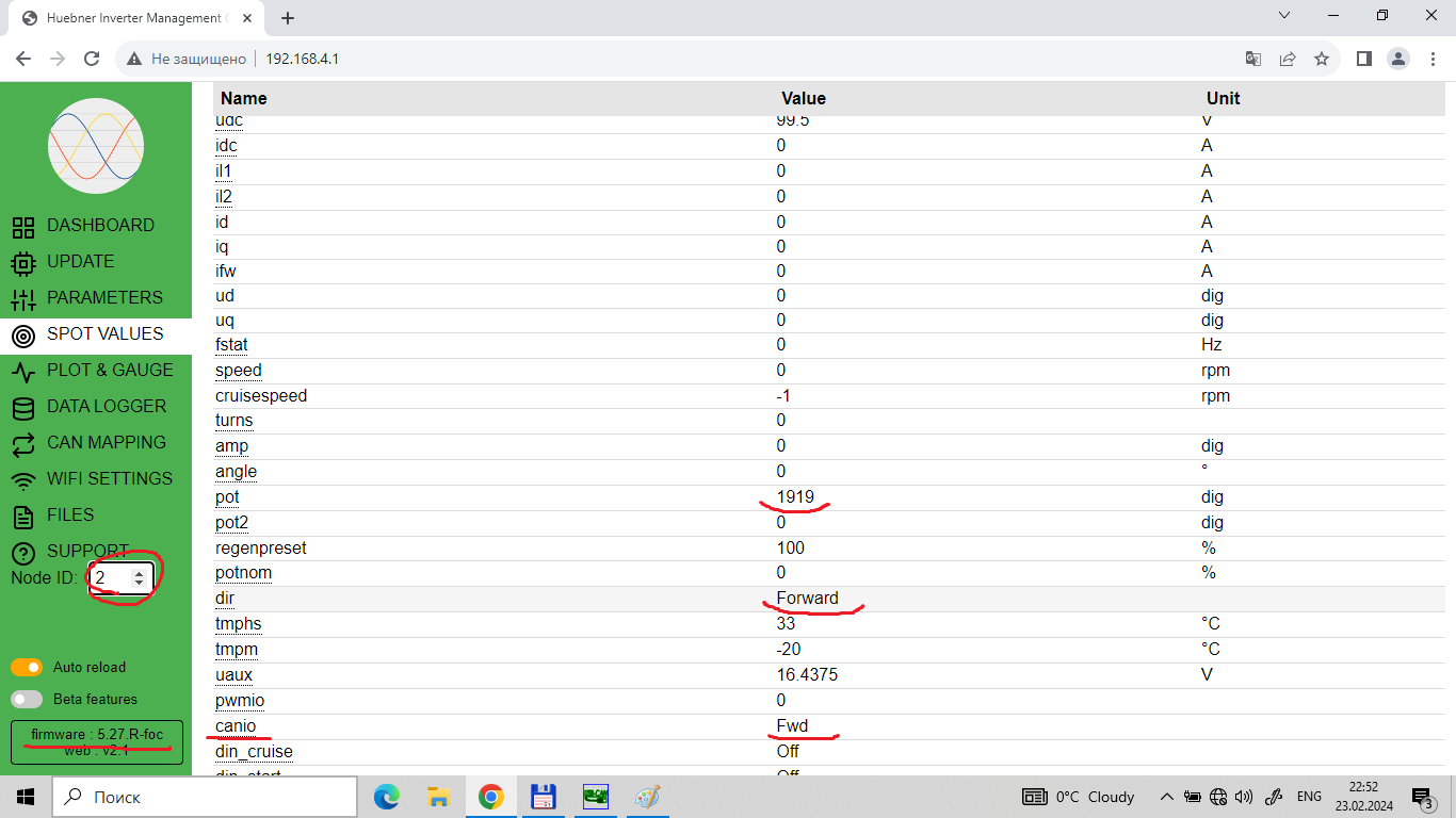

Loaded this firmware to SDU V6. My direction is set by switches: dirmode:Switches. Forward and reverse are swapped i.e when seldir=Forward; motor spins in reverse and rotordir=Reverse and vice versa.
Has the option to swap signals in the UI been removed?
Edit: ok. I found that there's a signal swap option in the UI. Gonna test it tomorrow.

alexbeatle wrote: Sun Oct 15, 2023 2:58 am Loaded this firmware to SDU V6. My direction is set by switches: dirmode:Switches. Forward and reverse are swapped i.e when seldir=Forward; motor spins in reverse and rotordir=Reverse and vice versa.

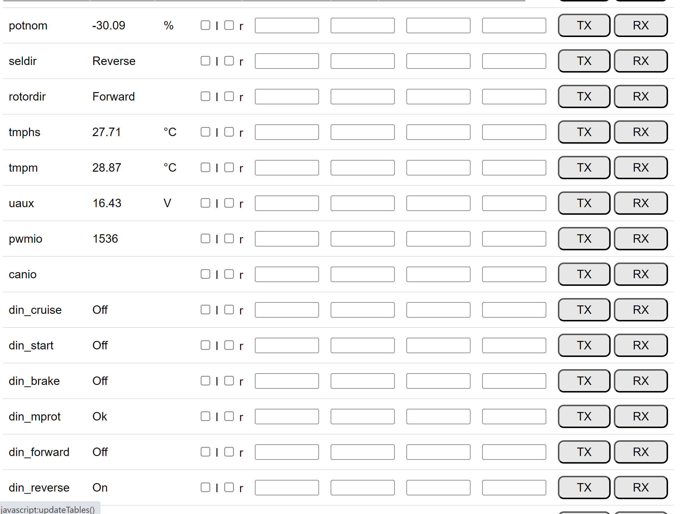

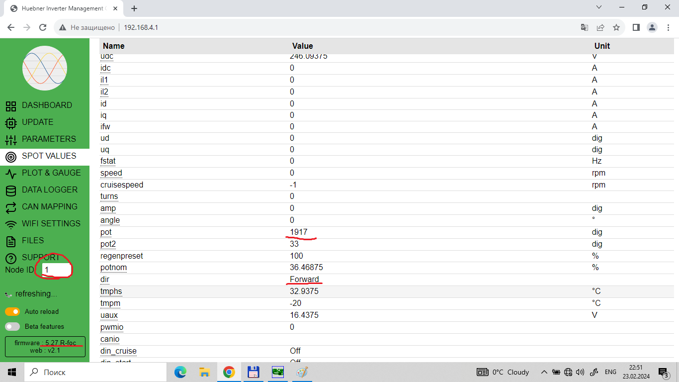

Here you are. When dirmode:Switches, it spins in the opposite direction of the direction selection. Selected reverse, but spins forward in the below.
Oh, that's funky. Could it be related to the reversed phase order that catphish had found?
I'm guessing this issue isn't new but now through revealing rotor direction it becomes visible.
It might not happen with FOC, will check later.
What would be the proposed fix? Correct phase order? Or introduce pinswap to sine firmware allowing to swap PWM channels 1 and 2?

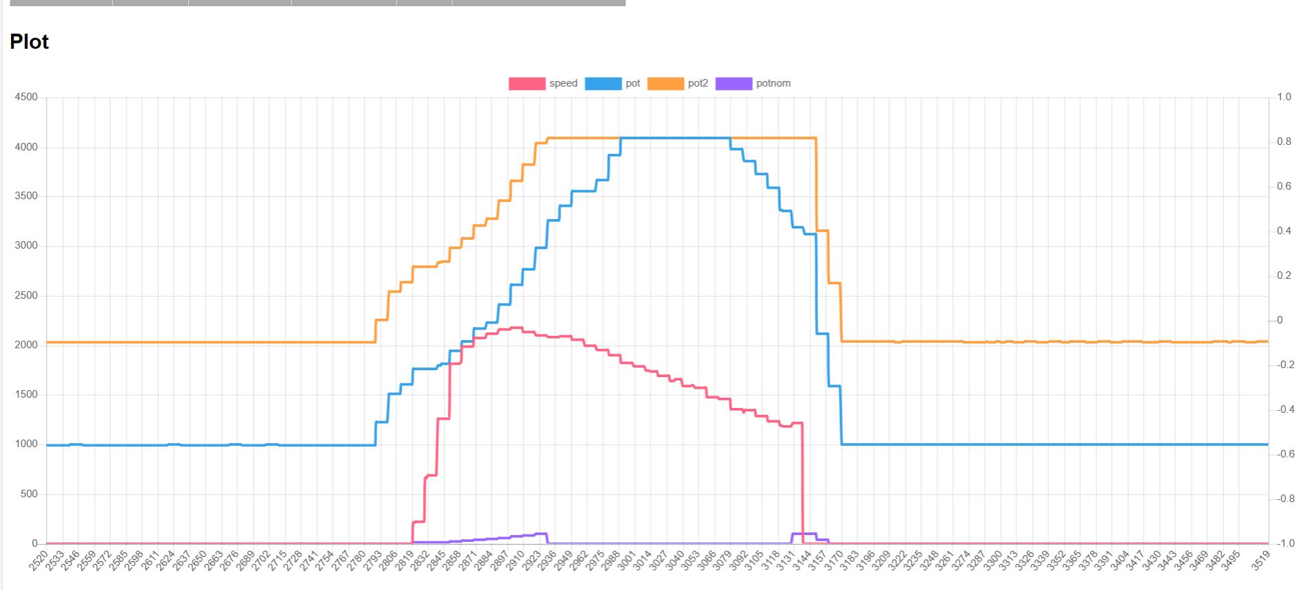

Yes, throttle goes out of range. You have set potmax=3000 where in reality it reaches 4095. Same with pot2.
Please can someone rewrite throttle calibration done with the web interface? This is super outdated https://openinverter.org/wiki/Schematic ... rottle_pot
