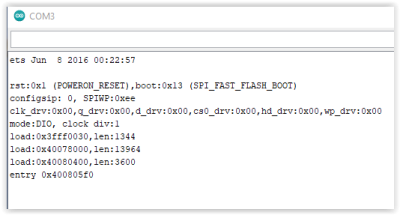

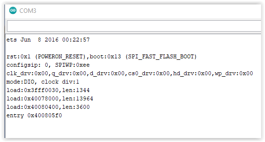

Re: Cannot access web interface on New Tesla LDU V6 Board
Hi !
I have been trying for several hours to get a new ESP32 WROOM32 operational with the web interface, but cannot get it to work.
ESP32 Sketch data download OK (see screenshot)
ESP32 Sketch downloads OK. (see screenshot)
After boot, it shows this in de serial monitor:
Right out of the box there was an Wifi-AP visible (unique ID, partial MAC?), after download nothing appears on the Wifi. Tried another ESP32 as well, same behaviour. Sketch used is the one referred to in de previous post of Johannes.
Further checked: Supply voltage is 3,32V and stable, pin3 (EN) goes delayed to '1' at boot (also tried some manual resets by shorting EN to GND).
Expecting to make some stupid mistake or forgetting something...

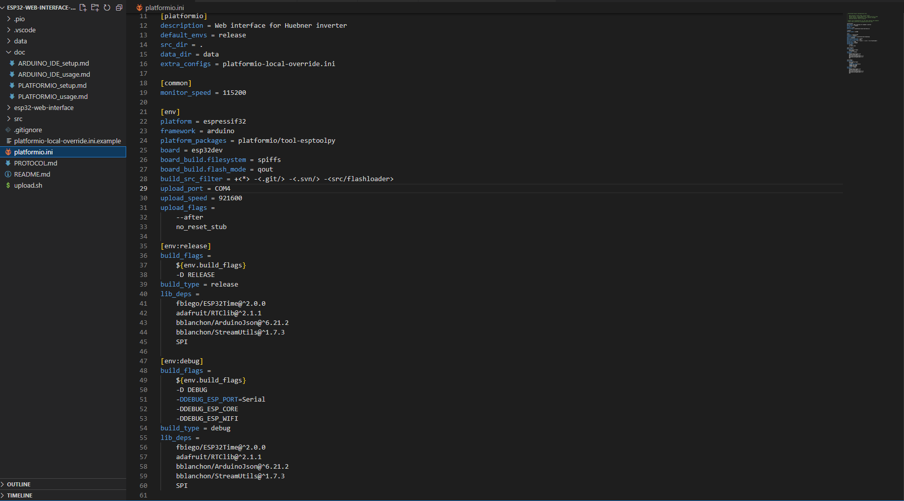

Earlier I did the programming with Arduino IDE 1.x. (FS / sketch). Just installed the python / platformio environment and got the "pio run --target upload" and "pio run --target uploadfs" to work. Both successfully download serial to the ESP32 (after editing the platformio-local-override.ini) but unfortunately the behaviour of the ESP32 is identical. No wifi and the serial monitor shows identical.
EDIT: Just tried uploading a random ESP32-webserver example project, that runs ! Console outputs, wifi comes available and webserver functions. Can it be that there is some file missing in the https://github.com/jsphuebner/esp32-web-interface project ?

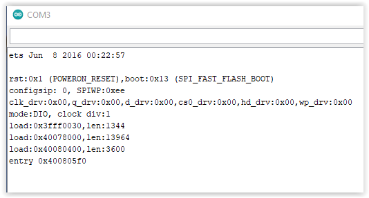

- FJ3422
- Posts: 122
- Joined: Fri Jul 10, 2020 9:55 am
- Location: Netherlands
- Has thanked: 13 times
- Been thanked: 3 times
Thanks for the tips !
Just tried:
CAN-backend version
Initially stalled at the " (SD_MMC.begin())" instruction. After removing the SD initialisation, project runs & webserver is functional !
uart-backend version (which I need)
Does hang after the "entry 0x400805f0". Debug-message at the very first beginning of void setup(void) is nog even shown.
What does the ESP32 do before the setup call ?
[edit] The 'uart-backend version' had Serial2 defined as debug output port, so did not see anything on the serial monitor at the programming port. Set it to 'Serial' to find that the SD initialisation was also the issue here. Removed it and it works ! Thanks for your help !
