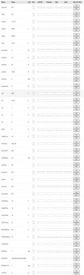

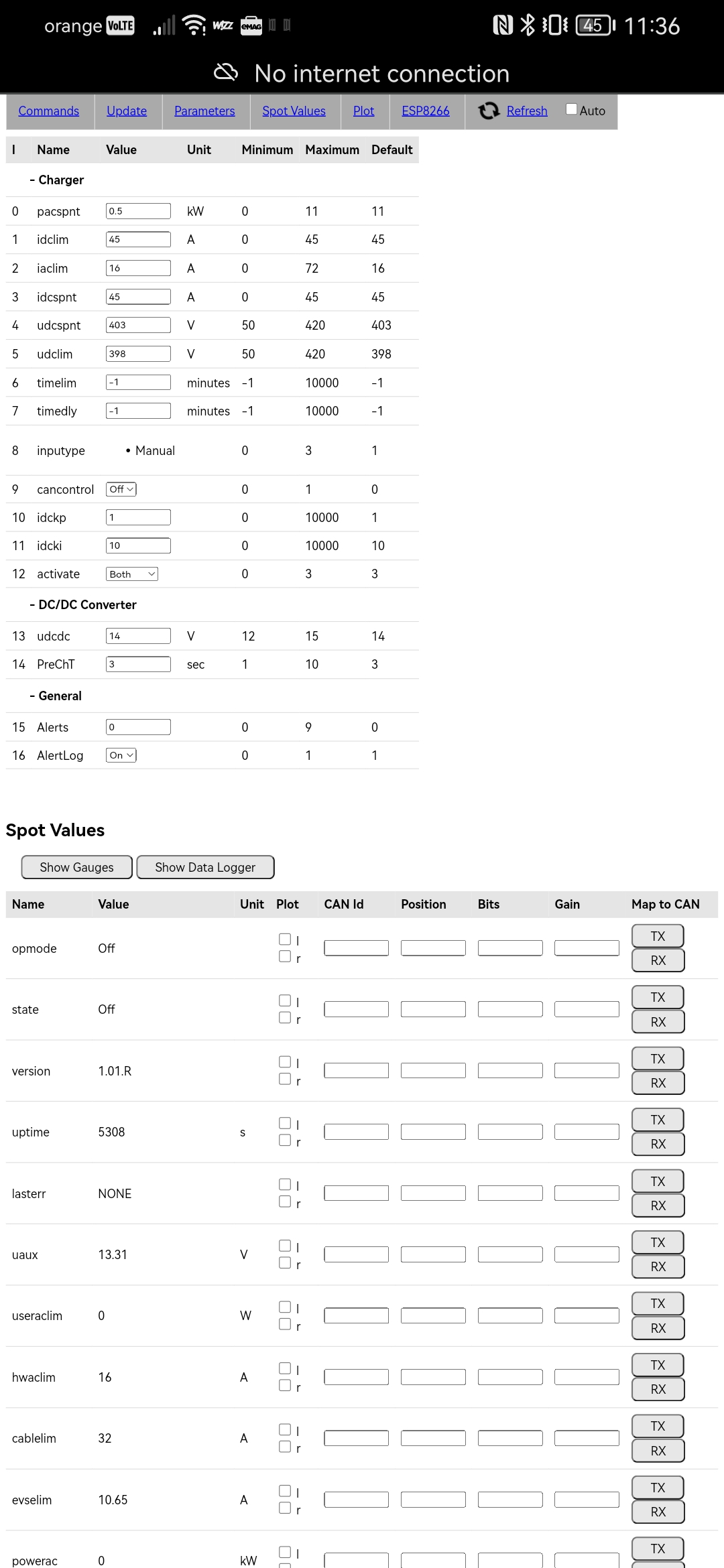

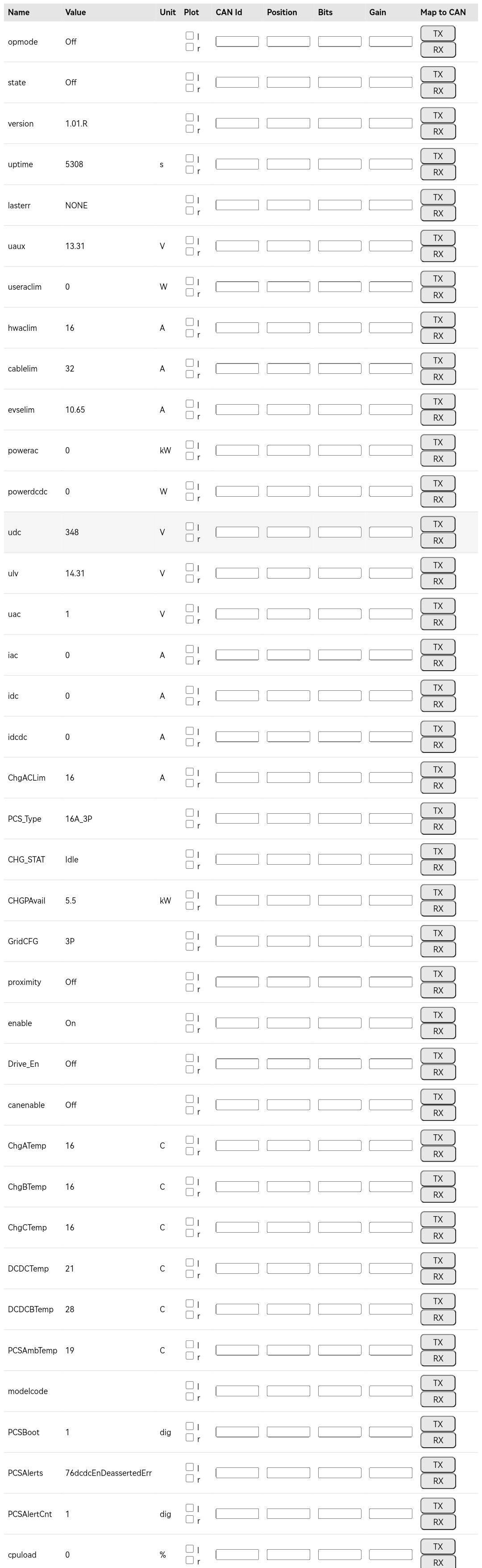

Hi, I just picked the last PCS topic hoping for a little help. I test bench a PCS with Damiens controller, all I could get to work is the dcdc, charging over 14v (tryed to set at 13v but still charges at 14v). Anyway, the charger is in iddle, or off state, with 12v on input1.
Oh, and no input type setting, just manual.
I am using a granny cable/charger wich does nothing when I connect it. No errors, just not triggers to start charging. Have i done something wrong? I have some screenshots:
