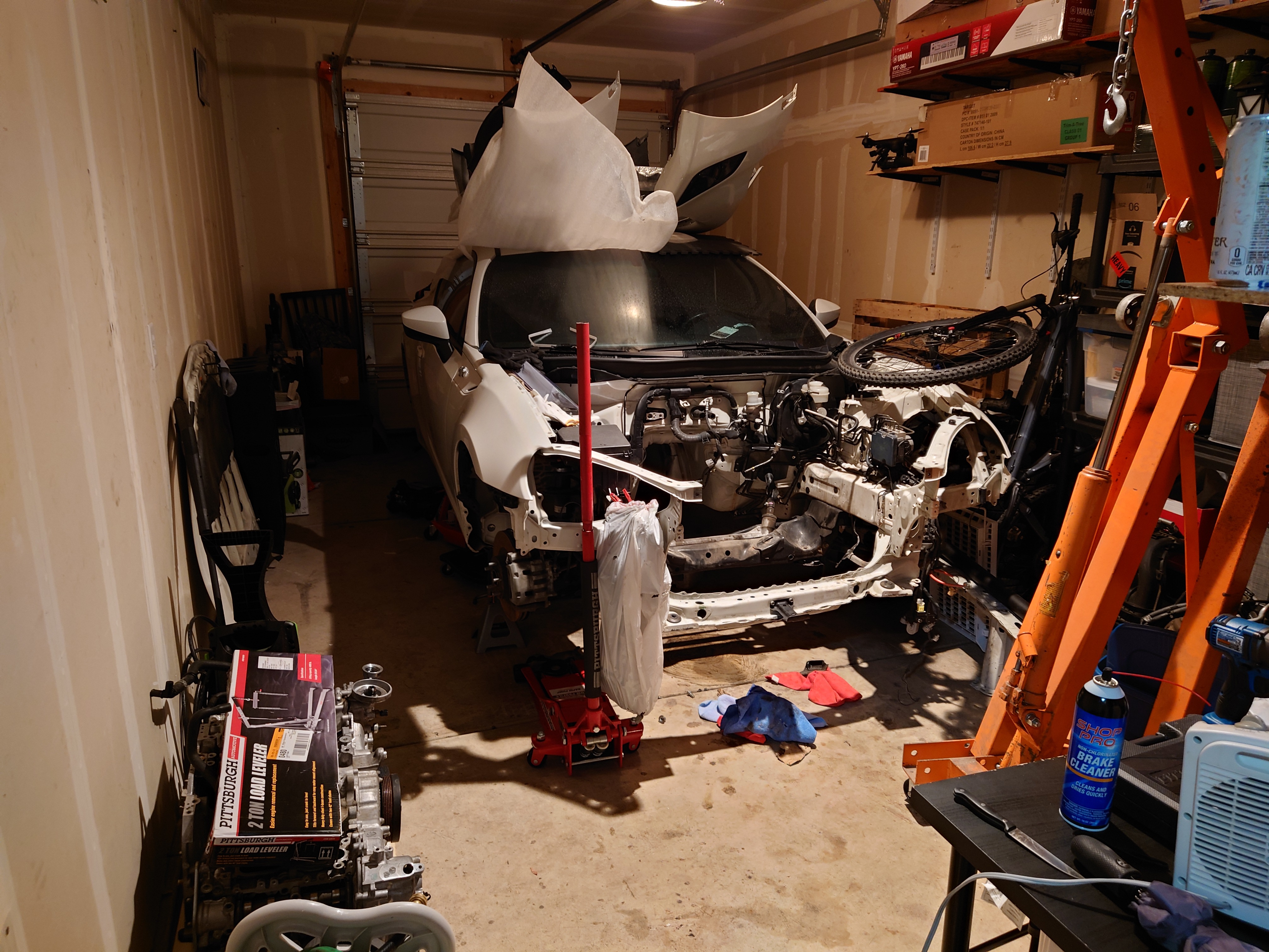

A quick update: I have the car mostly stripped. The dang ICE motor is still in it though for the time being. Have ordered an Inverter + transmission from Sendico but it has not been a straight forward process. We'll see if/when I get them and how much they cost. A side note- I found some Enerdel battery packs on eBay for roughly $2k and I think these are the specs: 355VDC 50AH 17.7kwh. I saw one build using these but the person hasn't been active for a while. Too good to be true? Anyone have experience with these? Tyty

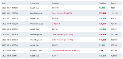

Here is a screenshot/quick breakdown of my Sendico experience: The inverter was 10,500 yen ($71.31 USD) and the transmission was 36,509 yen ($248 USD). To be able to ship it to me they had to partially take it apart, clean it(I think the 20,000 yen/$135 charge), then pack it. So there was a few extra fees + shipping which was the last big payment. All together from a random conversion calculator it put me just shy of a grand at $999.03.
All things considered it isn't "that bad" with all the variables of other transmissions or purchasing this same transmission from a different country. I found a GS300h on eBay coming from the UK that had free shipping for $600 something USD but it got returned to seller for being too big to import and new shipping estimates were $1k-$1,200 iirc.
I also got a few "yes" and "no" answers from Sendico saying they would and wouldn't ship it to me. It wasn't until one of their Discord admins stepped in that everything got figured out. So your mileage may vary based on that as well. I also think they have updated their website to filter these types of parts out to not have to do this again but that is just my perspective. Once I get my "work bench" cleared off I will take pictures of the transmission and inverter and post them as well. It wasn't as torn apart as much as I thought it was going to be but still enough for me to fk it up trying to put it back together so we'll see how I tackle getting it in one piece again.
