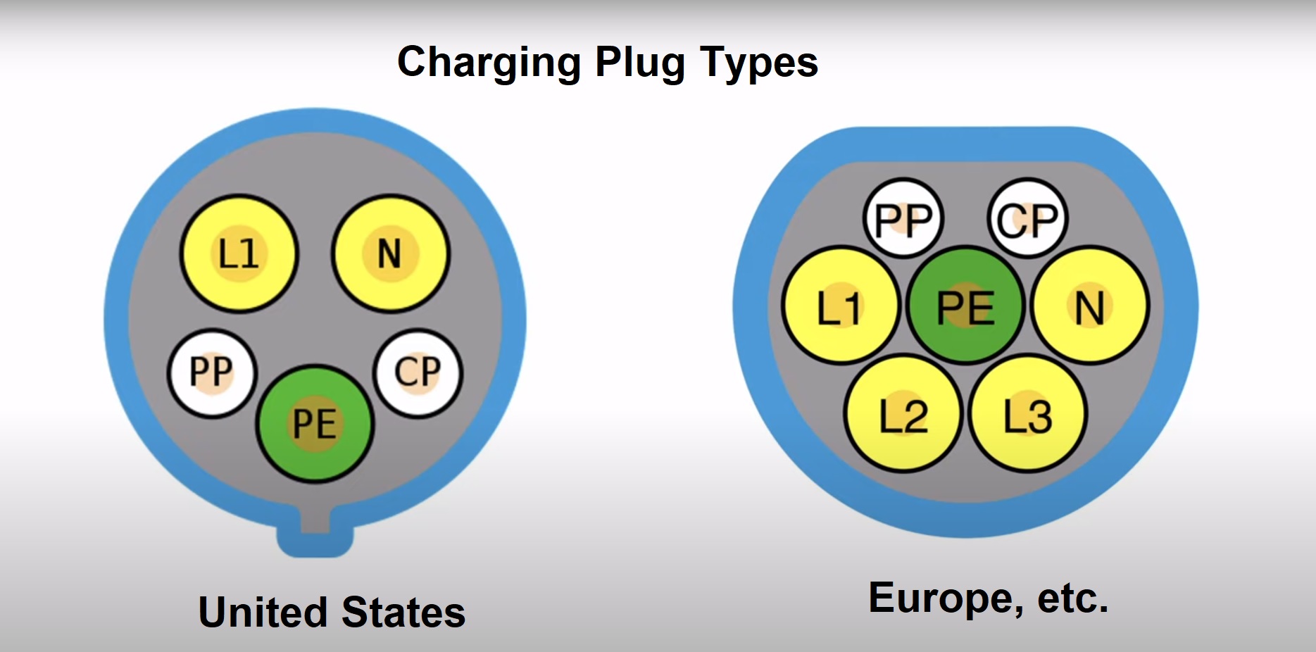

Re: How does AC (smart) charging actually work? PWM explained!
Post by Gregski »
Video Takeaways With Direct Links Back To The Video
Two Different Types of Charging Plugs

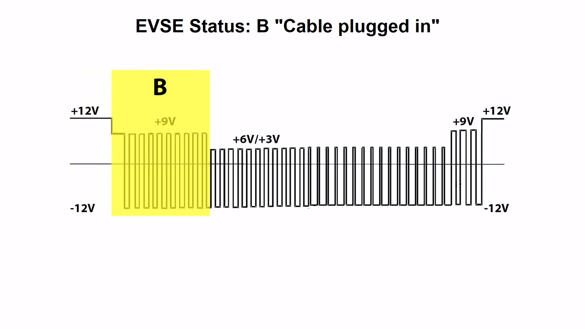

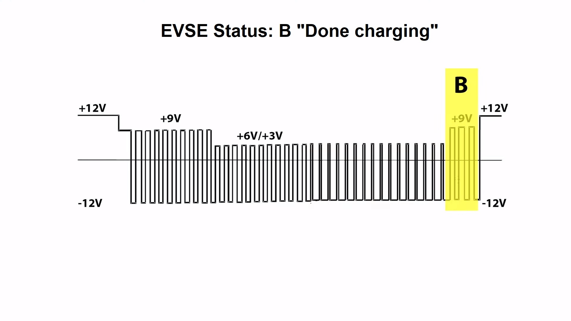

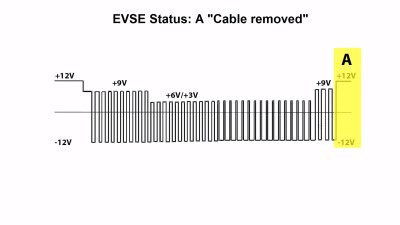

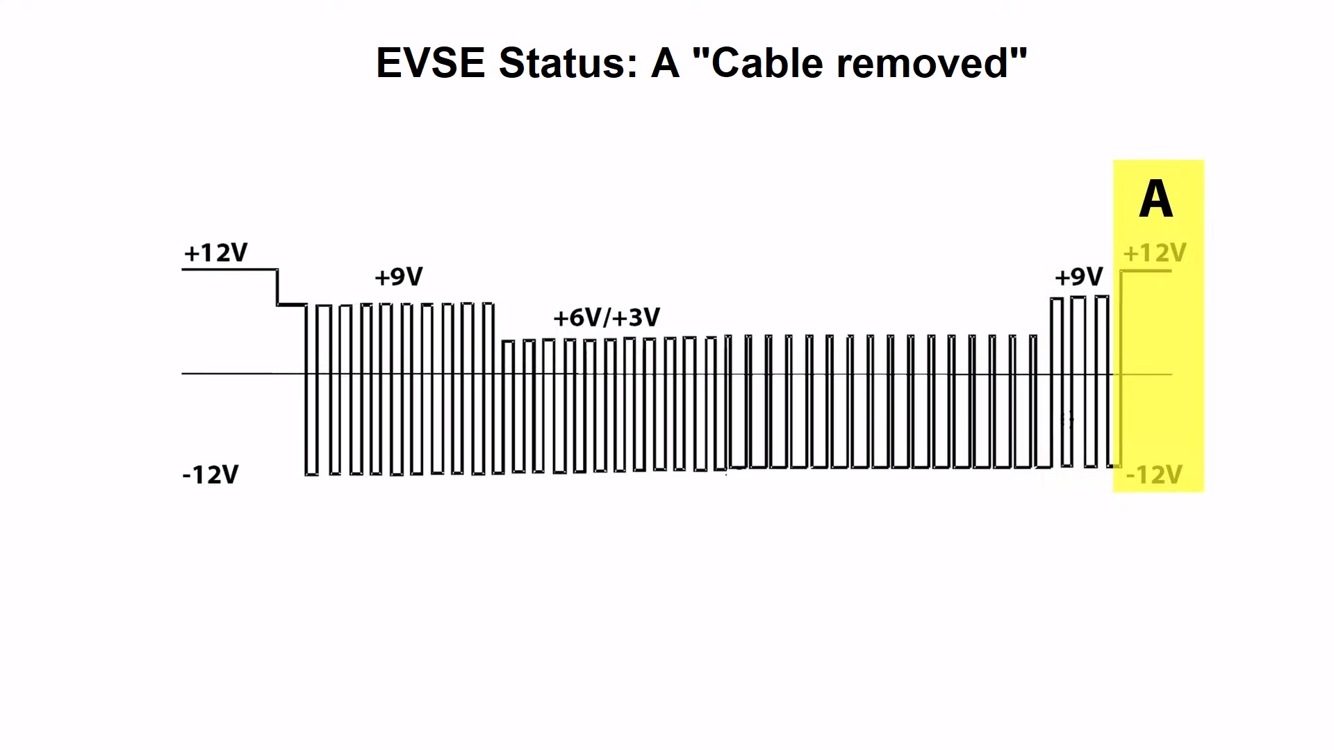

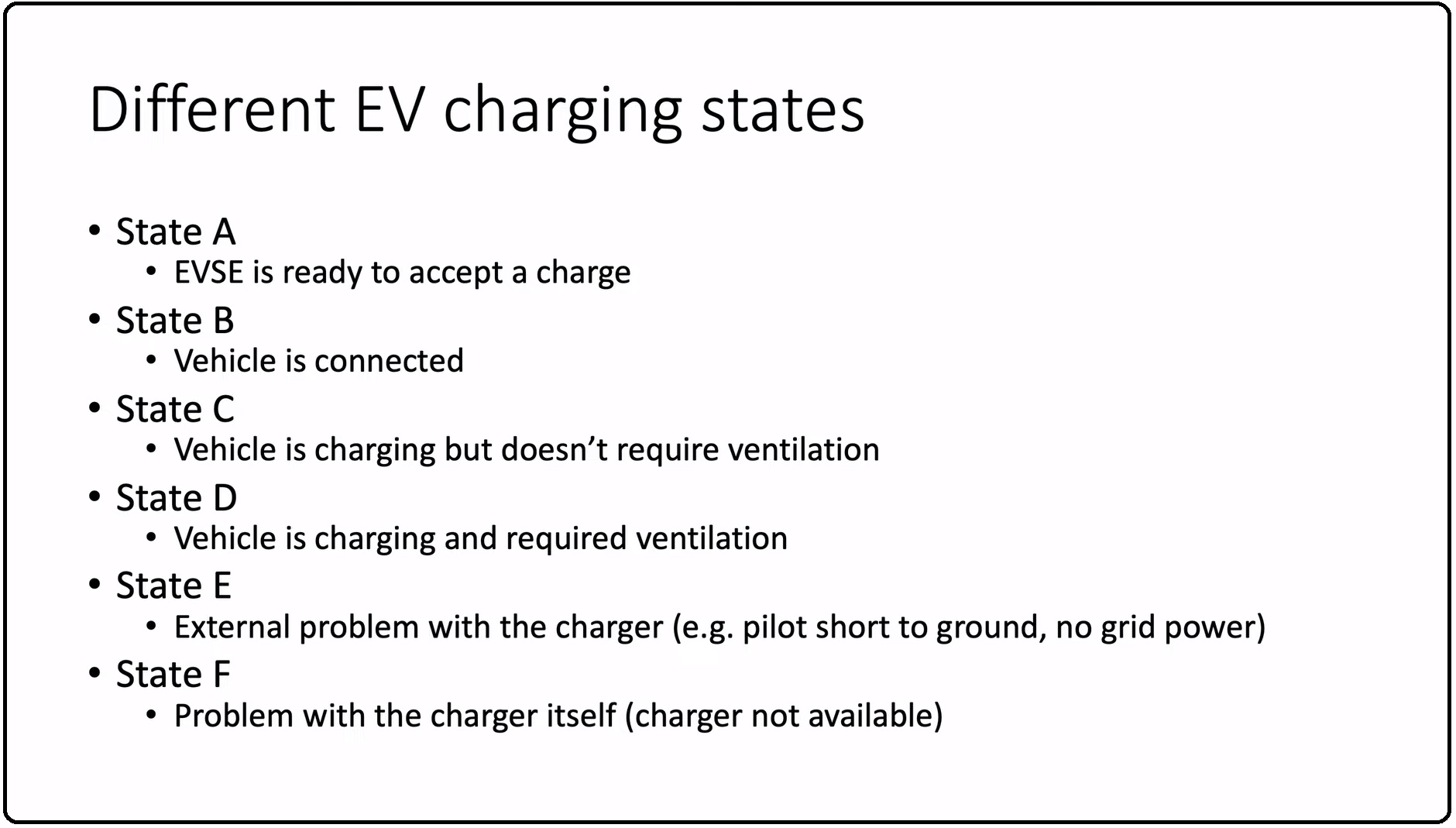

Post by Gregski »
The EVSE Can Show One Of Six Different States / or Statuseses
EVSE Status: A, B, C, D, E, F

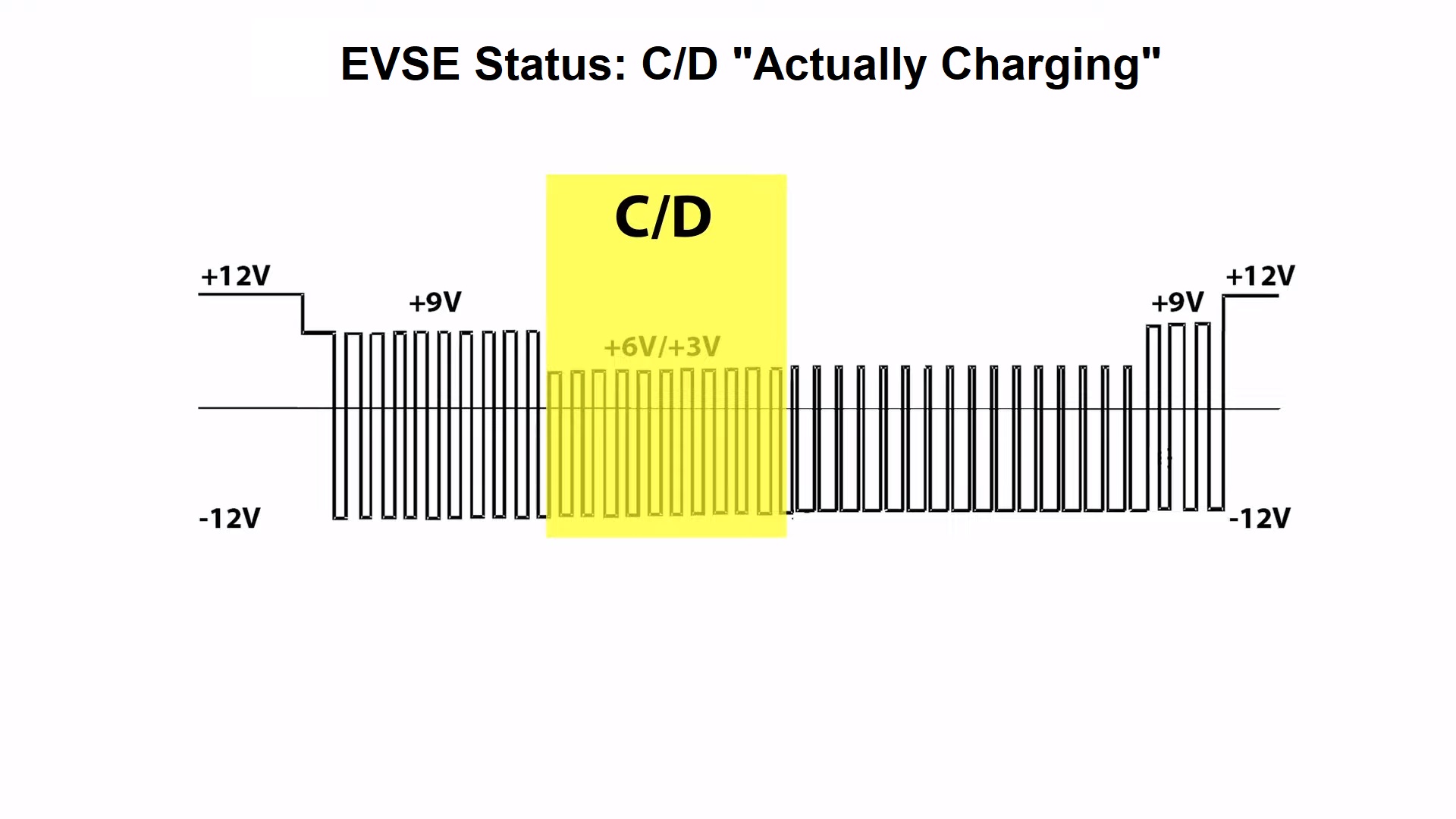

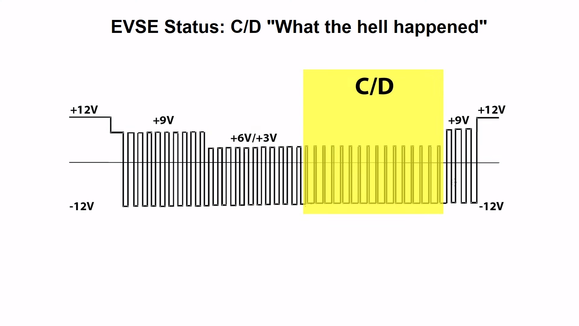

Post by Gregski »
Status C/D
C = Charging
D = in the old days of lead acid batteries meant Charging with Ventilation
