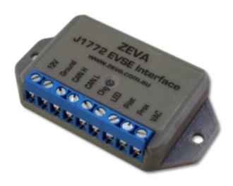

among the devices was a J1772 EVSE Interface a small gizmo slightly larger than a piece of domino which allowed DIY EV Conversions to charge at public charging stations.
ZEVA Interface.jpg (17.98 KiB) Viewed 8099 times

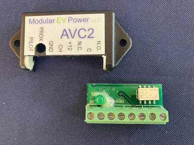

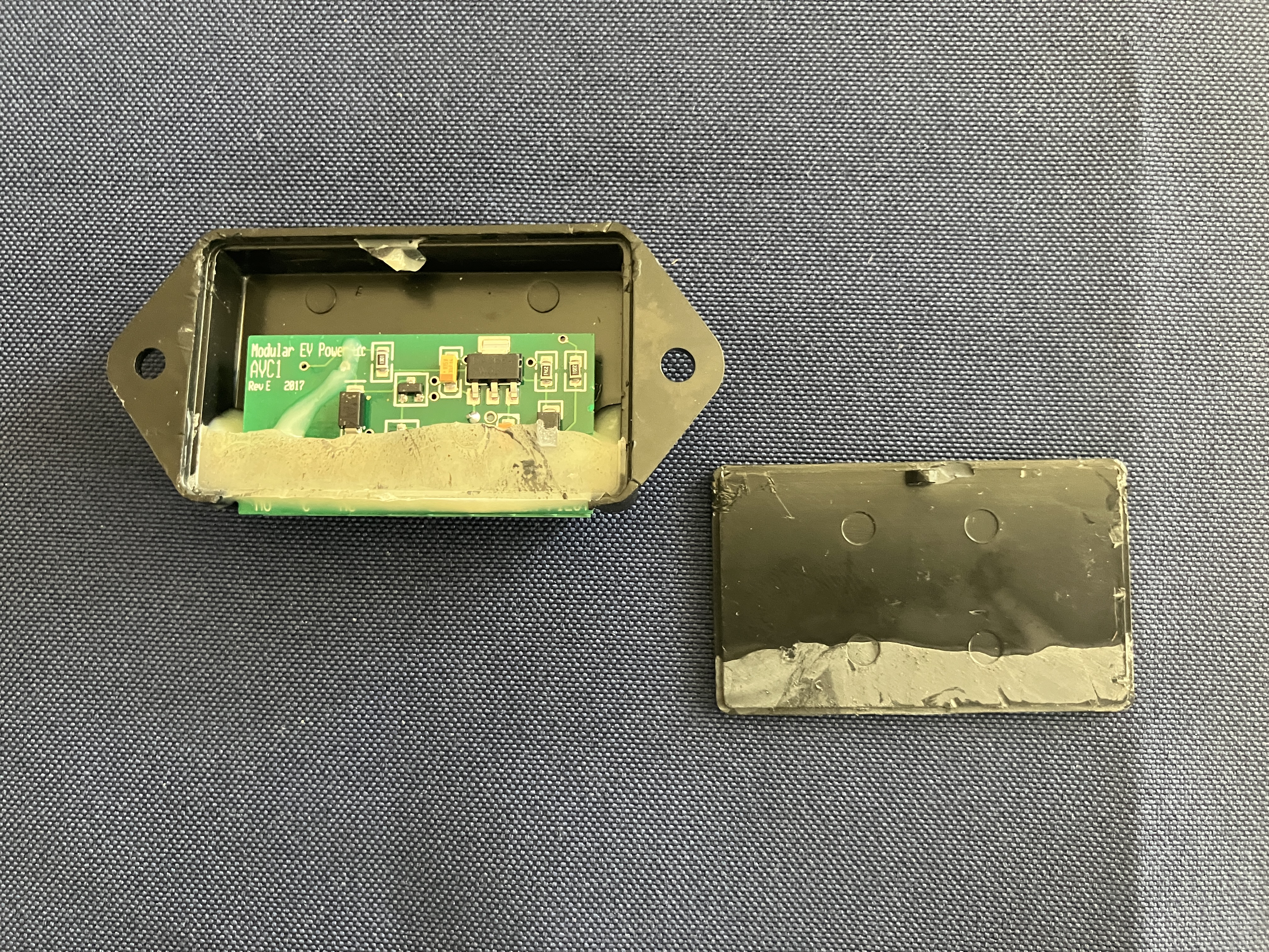

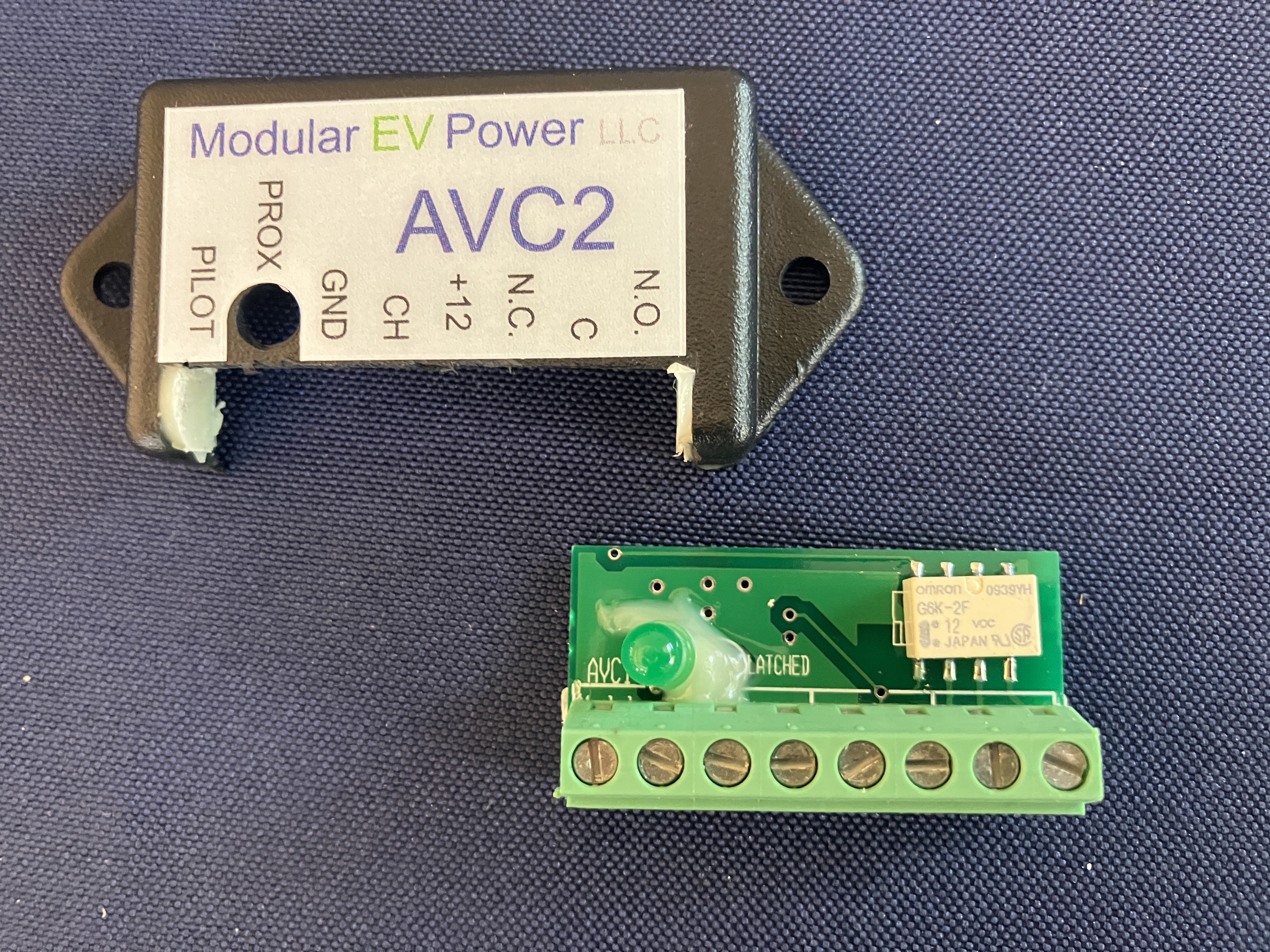

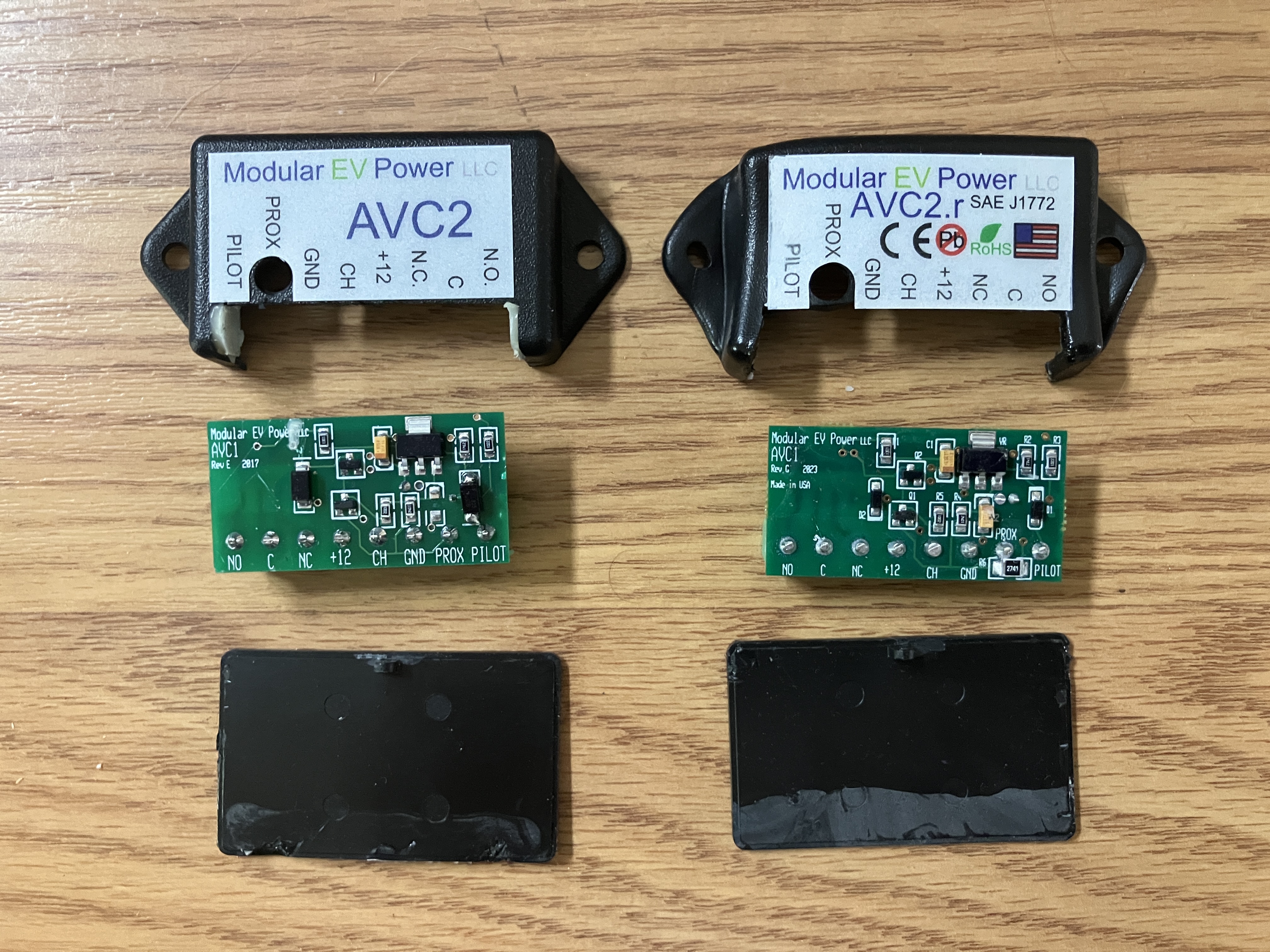

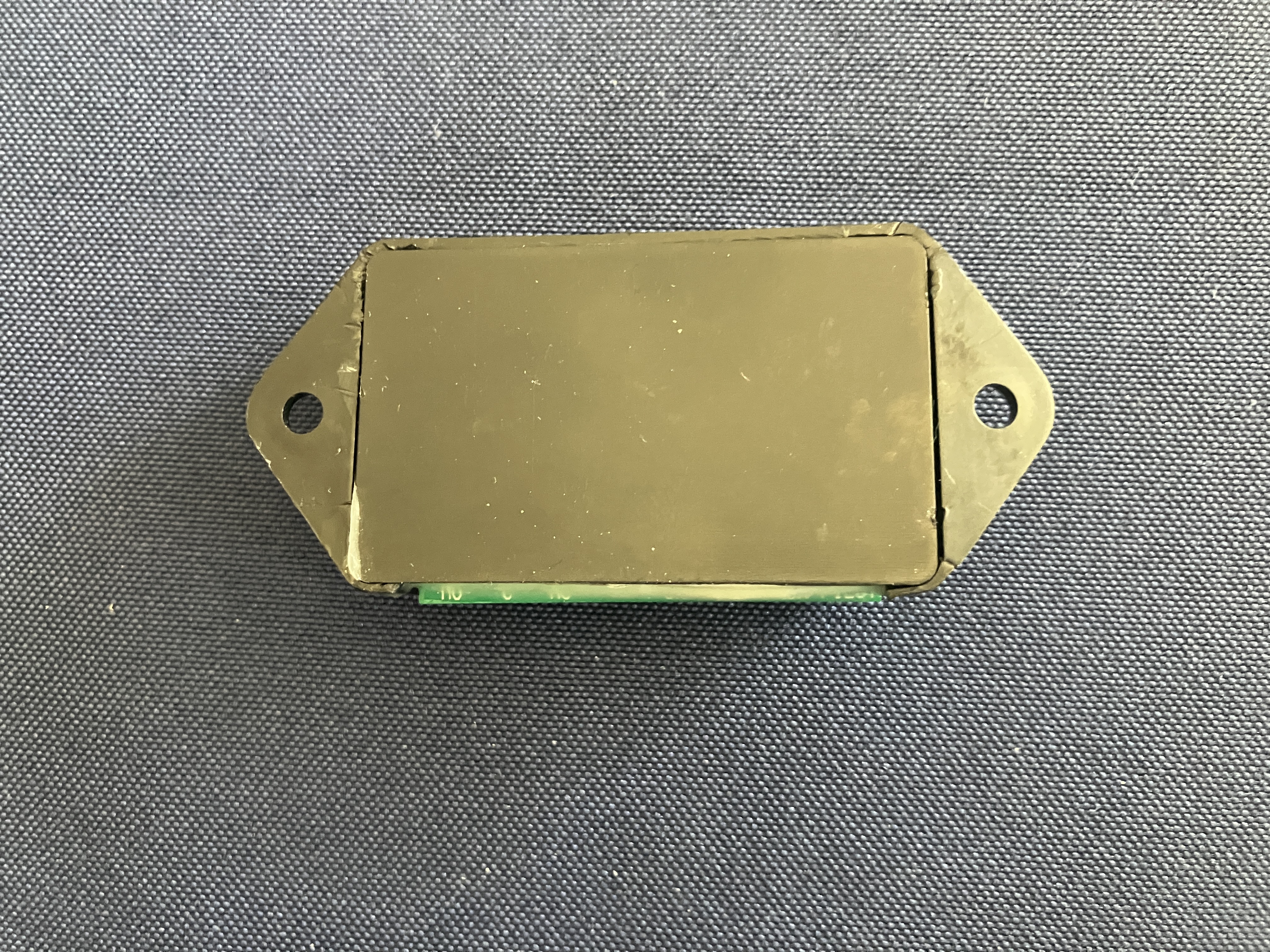

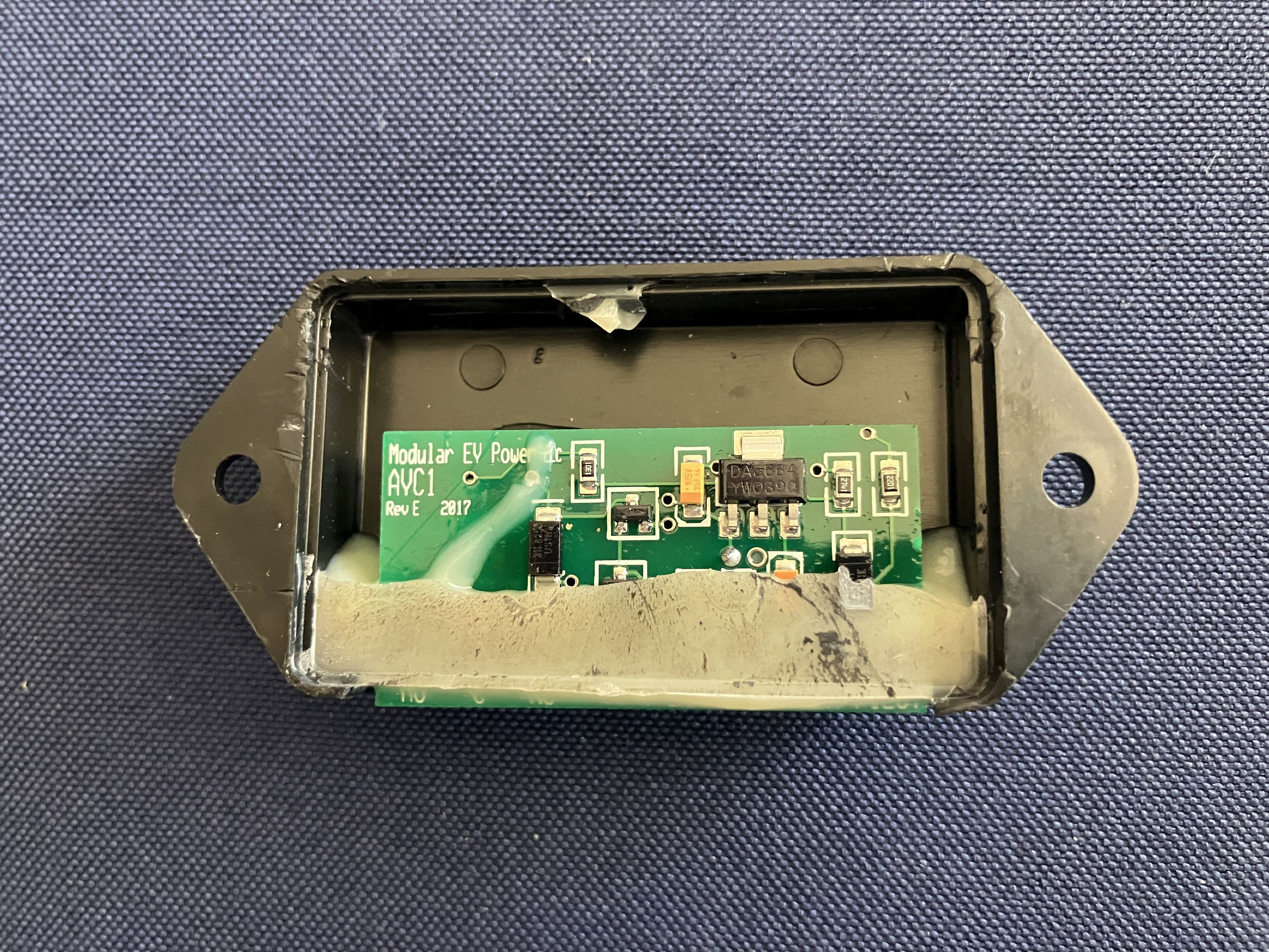

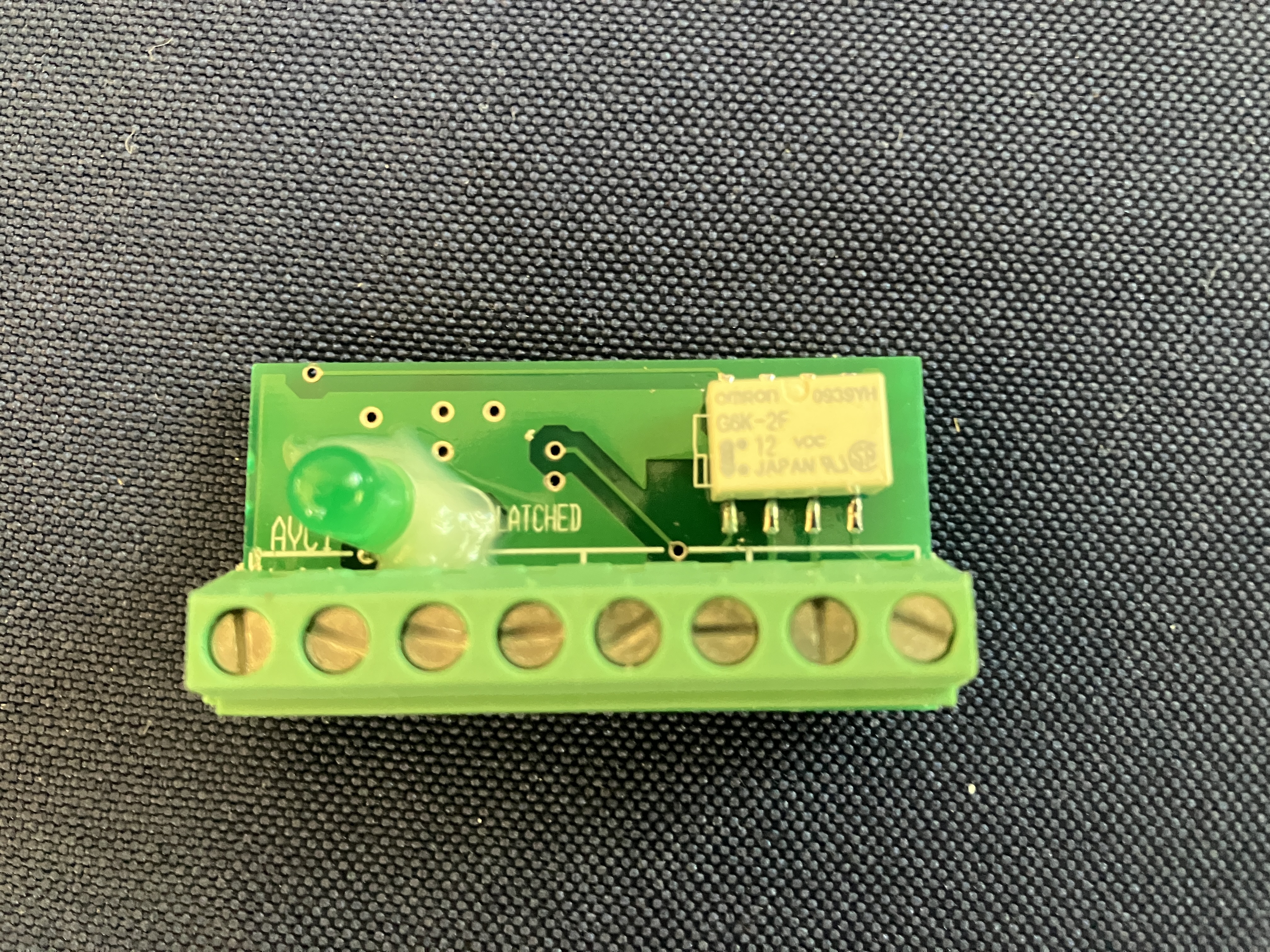

I am offering a peak inside one of these gizmos for those of us "schematic averse"

Gregski wrote: Thu Oct 12, 2023 5:11 pm I am offering a peak inside one of these gizmos for those of us "schematic averse"
Cool, a bunch of little magic smoke containers! 8-)

jrbe wrote: Thu Oct 12, 2023 6:49 pm Cool, a bunch of little magic smoke containers! 8-)
yup, and alien snot

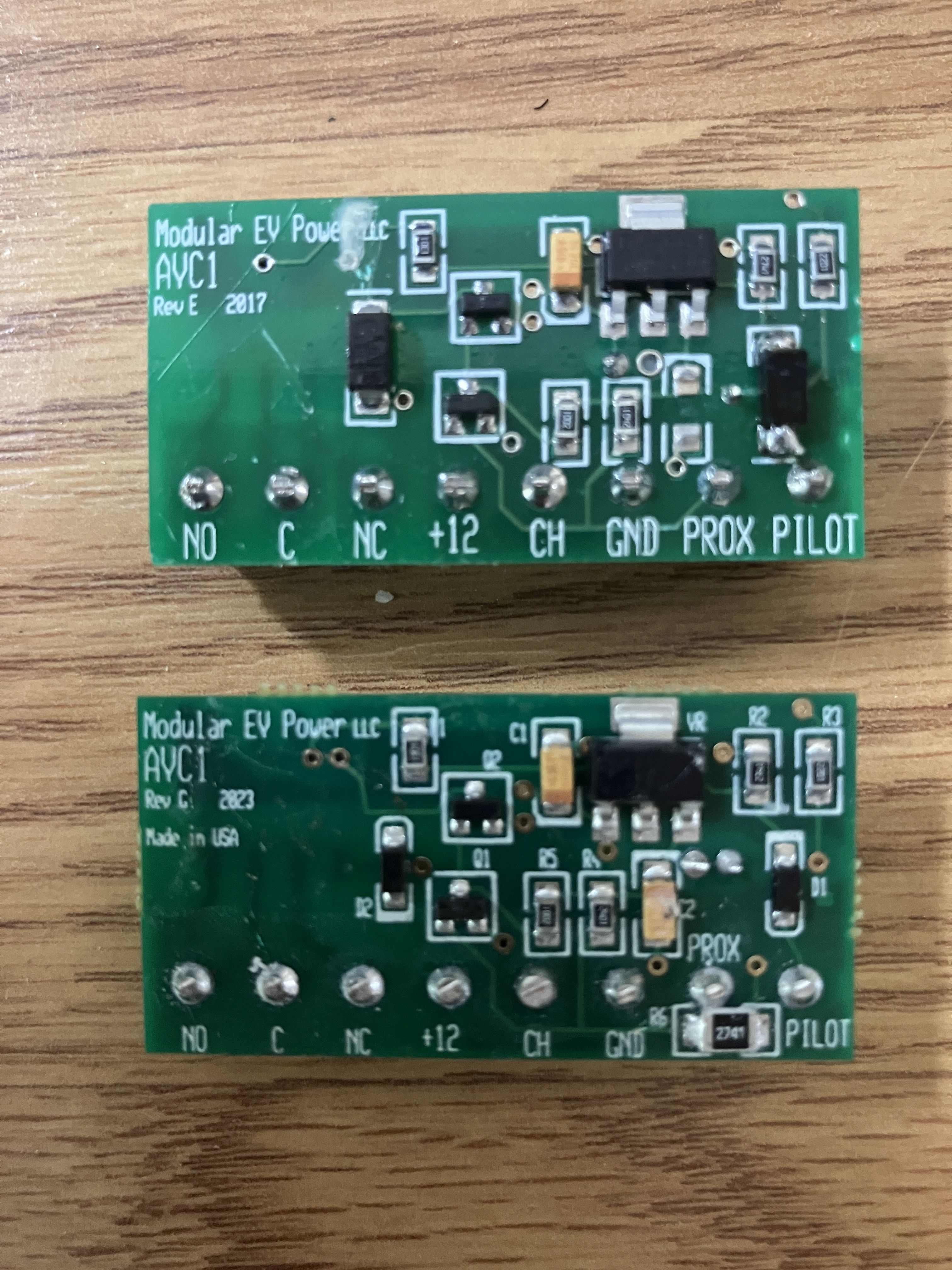

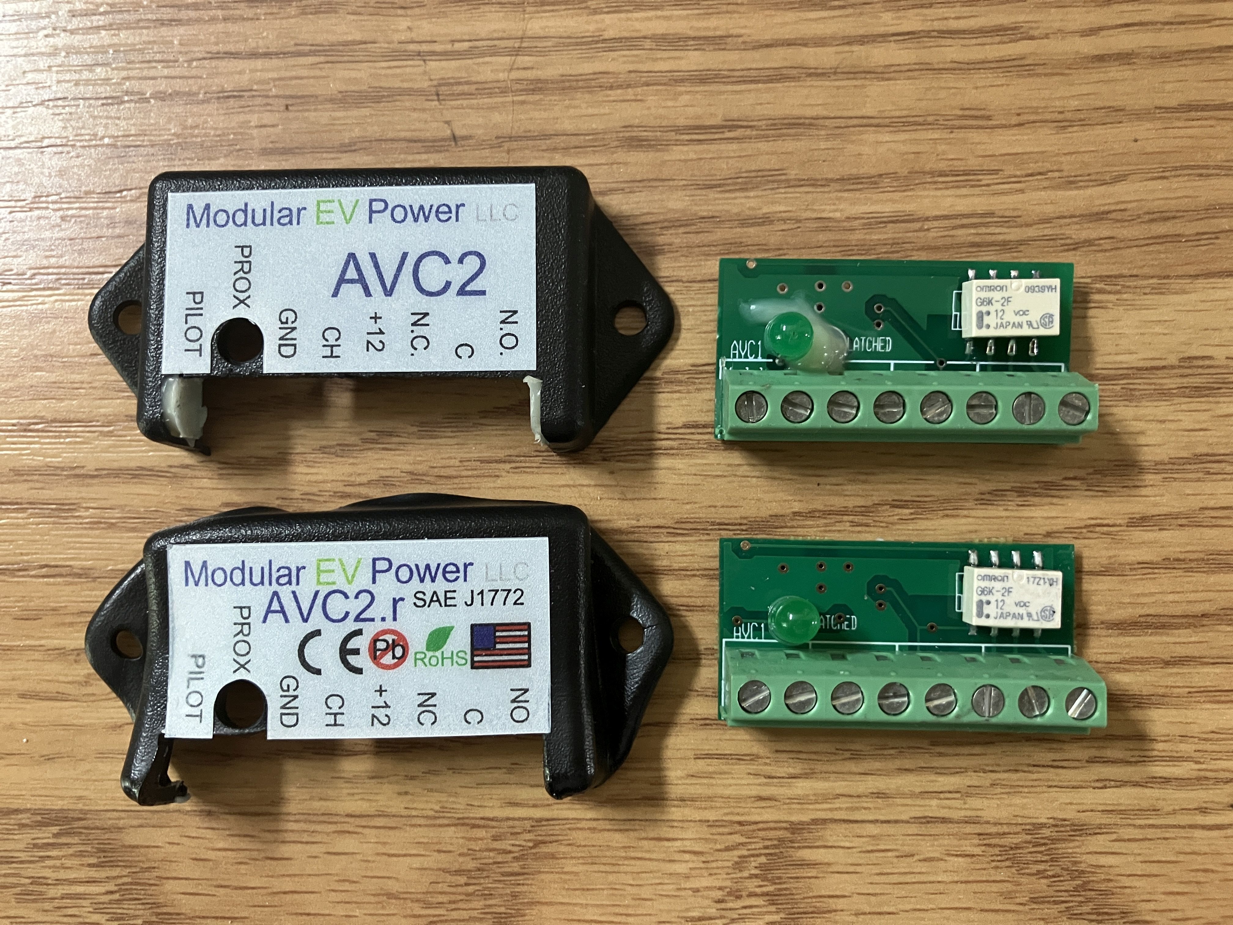

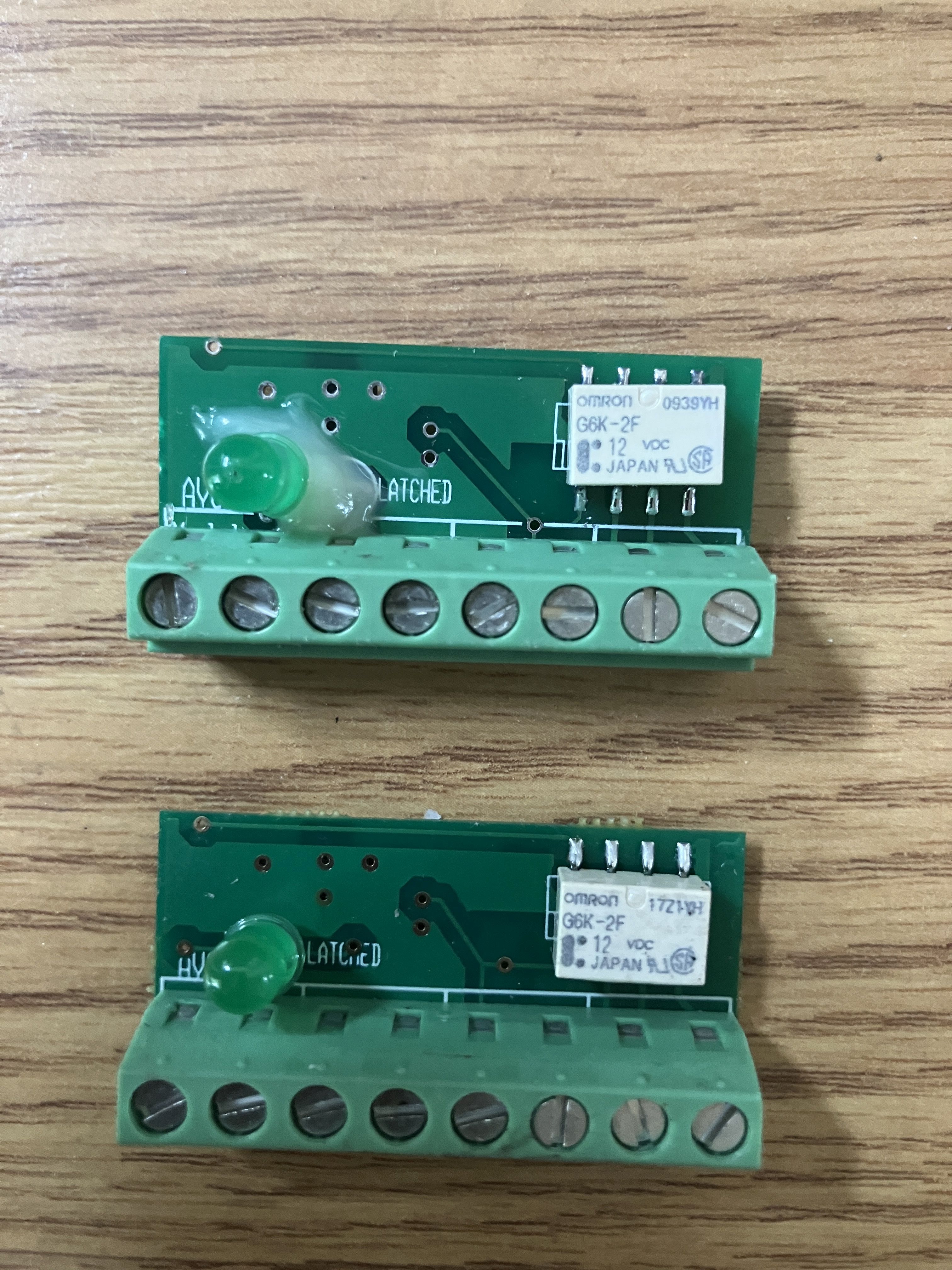

wait did this fool really buy another one of them things just to tear it apart
Let's play Spot The Difference:
It's the AVC2 vs the AVC2.r (Race model)
Modular EV Power
