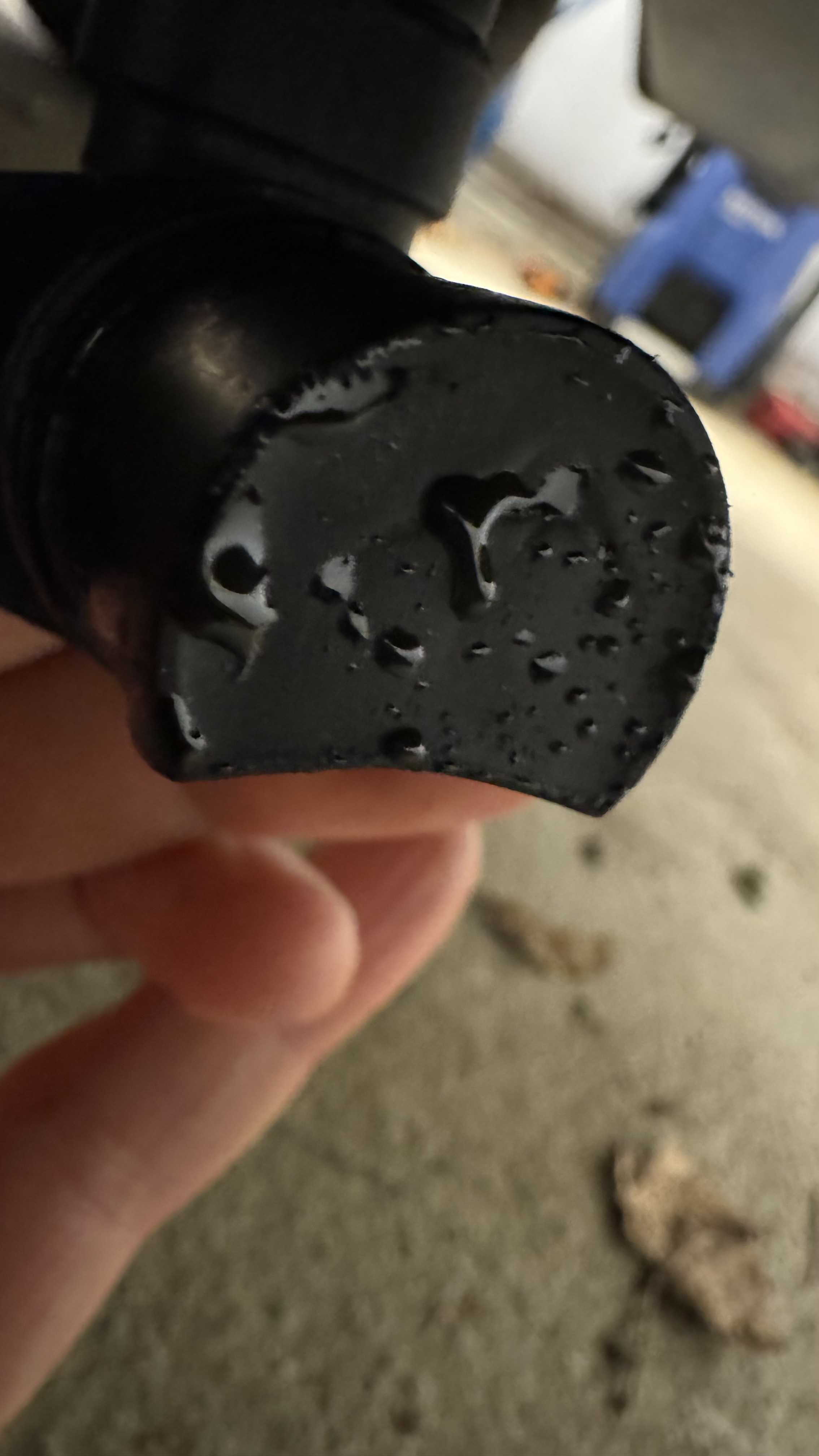

First one blew because of BMS lifting contactors when car was doing regen. That was fixed then by disabling BMS contactor control when key was turned to 2nd position. This time, I was parked and ready to go. Turning the key and smoothly pressing the accelerator, nothing happens. Power off, try again.. still nothing. Deeper power cycle - 12v power off, HV service switch off. Leave it there for minute .. put back on, still the same thing. Usually this helps if for some reason OVERCURRENT has happened. Checking web interface with laptop, lasterr shows OVERCURRENT. Even before turning the gear on, just start signal. Last time, OVERCURRENT happened only when switching from N to D.
Had to tow the car home and now very confused what could have happened. I have had OVERCURRENT happening when reversing off the yard and changing from R to D, or wise versa. I always thought that I must have done some too sudden accelerator move or something .. but it has never happened during drive. This time I wasn't even moving. Car was parked on a bus stop while I was doing some instrument cluster coding there :) .. then ready to go, gear to D and nothing.
I'm really confused what can cause this. One thing that I started thinking, was that maybe the precharge resistor got broken when the first LDU broke a month ago. And after (too many) startups without that precharge, something might get broken.
Any other ideas?

Weirdness continues. Car moved this morning as well.. but later today, same thing. Lasterr = OVERCURRENT. Car was just sitting parked in warm garage.
I did notice something odd about the board. WiFi kept disconnecting.. and then, parameters were gone.
Last time the desat error happened due board being moist. I think the water/moisture is doing some damage here now. Maybe some Igbt pins are wet and it incorrectly detects some bad current, and triggers overcurrent error.

Gunk is coolant. I swapped the blown inverter out, and in with the new. But somehow the new seems to leak .. or the leak is coming from motor side throgh temp sensor hole, as the encoder is wet. Replacing the seal this week and see what's in there.

I think it's just the moisture/water going to wrong places. I have another (3rd) P85 LDU waiting to be installed end of this week. Hopefully it's water proof :D

I'm trying to understand the fault that my 3rd LDU has. It's similar that my 2nd LDU had. Summing up the issues, it was like this
1) First LDU broke because contactor was opened during regen (bad settings, my bad)
2) Second LDU leaked from both sides. Water in rotor/stator side and water got into inverter side as well. Caused rg. DESAT error which should not be possible. After that, randomly OVERCURRENT errors when turning the power on.
3) Third LDU (the one that is in right now) is very latest revision number. They seem to be replacing P100D rear motors with that this year. So this is probably the best LDU so far. But after driving that a day, it also started to throw OVERCURRENT when starting up and latest in mid drive and that hasn't resetted after that. Impedance readings show that phases should be ok. din_ocur shows = Ok at the same time when Lasterr = OVERCURRENT.
So, my best guess so far is that the board took some water damage during the second LDU, as the random OVERCURRENT fails started at that point and continued to way newer LDU as well. But also bit skeptical that if something in my parameters for example can cause this or something else. I did drive about 300-400km with first motor with these settings, so that's not the first on my list..
Another thing I did after first blown LDU was to add a relay between BMS main contactor control. This was to prevent the BMS to open main contactor during drive. So when ignition is not in drive position, BMS can control main contactor. So it can for example disconnect battery from charger if some fault happens. When key is in drive position, the relay control is "taken over" from BMS and forced to be "on", even if BMS would want to open main contactor. But what I noticed here is that when relay control is switched to "power on" -mode, relay switches and there is a very short 12V drop. Like maybe 10 milliseconds (coil moves inside the relay). I started wondering could that short 12V drop cause the contactor to open and close and maybe cause a current spike to motor?
Measuring the phases with multimeter in impedance mode, I get 0,85 from + and - terminals. So that at least seems good. First motor did show 0,35 when at least one stage was blown.

I'm not very helpful in the coding side but have some ideas for you on the mechanical & electrical sides.
Are you using a xxdt (a normally open and normally closed position) relay? Sounds like it based on your description.
If so, during the relay switching time it can end up getting a voltage spike in regen if the shifter moves, someone bumps it, if wiring isn't 100%, or if there's an issue with the relay.
Theres a slim chance that this quick power cycle might also be scrambling some logic process that's hard to see in our observable time.
You could use diodes to the relay coil wiring so you don't back feed the board. But any failure here in regen could also blow the power section.
If your contactor doesn't have a built in economizer circuit it could be overheating and possibly dropping out with some thermal protection mechanism.
Any chance you have a grounding issue for the motor or motor controls to openinverter board? Almost sounds like a floating / weak ground or some resistance in an unexpected place tripping desat.
Have you cleaned the board and dried it in a low temp oven after all the wet episodes?
Did you dry out all the connectors & harnesses?
Also, .5 second precharge time sounds too short to me. Have you scoped the capacitor voltage while doing a precharge to main cycle? Your main contactor may be taking a huge hit because the capacitor hasn't charged up enough before the main contactor closes. Wondering if your main contactor may have suffered some damage / accumulated damage from this.
