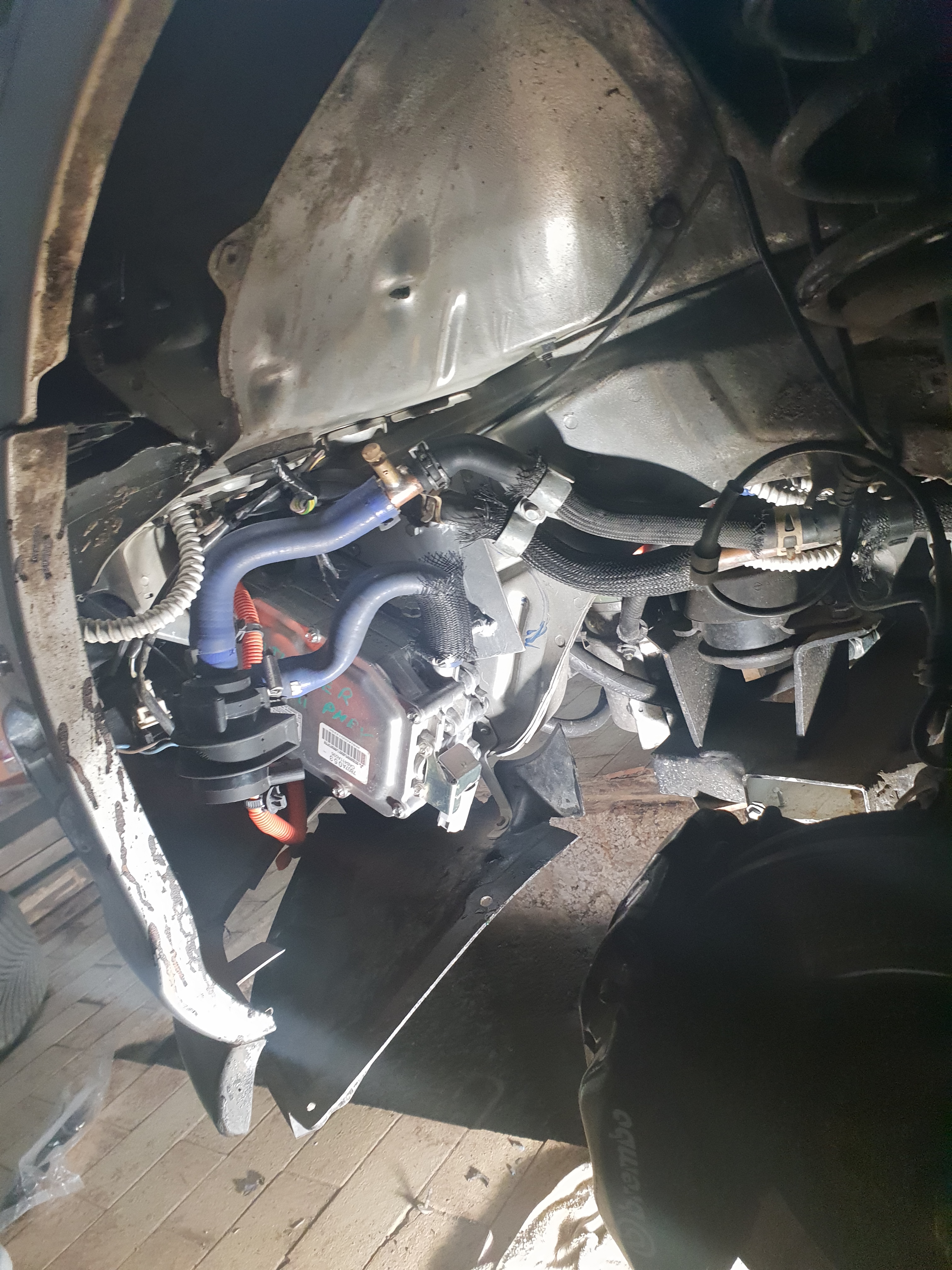

I'm getting round to one of the final steps and putting cabin heating in the EV, based upon an Outlander HV heater.
At the weekend i hooked up a coolant loop though cabin matrix, pump, heater and Teed in a small expansion bottle.
I struggled to get good flow through the matrix using one of those VW aux pumps https://www.ebay.co.uk/itm/204365441881
I wondered what pumps others have used, is mine undersized or do i have a blockage somewhere ? I ran out of time to investigate with a hose etc
I verified the old control valve is no longer present, that was in the engine bay and is long gone.

I used those old 12v audi pumps with two pins. I think you use one of those PWM controled pumps with 3 pins in a connector. Maybe it works in default at slow speed without signal connected?FFMan wrote: ↑Tue Oct 17, 2023 1:48 pm.
I wondered what pumps others have used, is mine undersized or do i have a blockage somewhere ? I ran out of time to investigate with a hose etc.

I find that hard to belive, P/N 04L965567 is 3 pin. Observe the rear plate diagram. You should see - + S schematic for connection.
Ok this is the pump i use P/N 7L0965561D and it provides quite enough pressure to feed either heating or cooling system
https://www.ebay.de/itm/283846097712
Did you investigate your heater matrix by connecting tap water pressure to hoses and observe the output? Maybe your heater matrix is cloged?

ok this was actually the pump
https://www.amazon.co.uk/dp/B098NRBXPL? ... ct_details
only two pins, came with a small loom
but now i read the comments, the word pathetic springs to mind - buy cheap buy twice !

Hm... i actually have that pump too. I didnt use it for cooling as its tubes were not aligned with what i need. But from what i did test with heating i would say this pumps impeler needs to be completely flooded. I think you need to make this pump the lowest point in your system and it should provide enough pressure then.FFMan wrote: ↑Tue Oct 17, 2023 7:38 pm ok this was actually the pump
Also air bubbles will degrade the flow dramaticaly so make the highest point of your system your bleed point.
You can buy brass bleed valve and solder it to the top of a copper tube. I use a blowtorch and plummers paste with solder.

I am also using that pump and have no issues with flow. I did have to run it quite some time to get all the air out of it. It will get very quiet once all the air is gone.

thanks - i'll persevere this weekend. I have that same pump on the coolant loop and its ok though flow isn't great, but its not needed really.PatrcioEV-ATX wrote: ↑Tue Oct 17, 2023 9:07 pm I am also using that pump and have no issues with flow. I did have to run it quite some time to get all the air out of it. It will get very quiet once all the air is gone.

Well if you use it for heating then you dont really need that much flow. It actually gives heater more time to transfer energy to liquid...
And those heating cores have spiral things inside to restrict flow so they give out more heat... those can get blocked...
