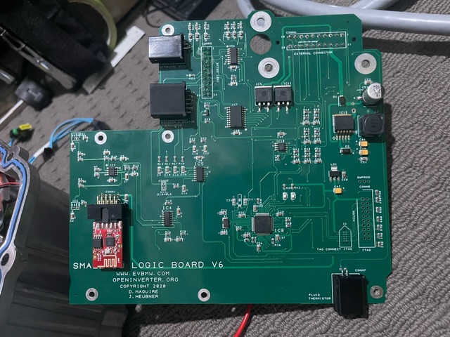

My board is V6 but does not have L2, just L3. The supply to the wifi module is measures at 3.4V, However I always have issues connecting on wifi (intermittent) and when I connect I can upload parameters OK but cannot download spot values - Just get a blank page. Does anybody have any ideas as to what the problem might be?

Can you supply a picture of your board?

Yep, typo in my opening post, should say V7, V8. This thread doesn't apply to your board then. Just make sure the 3.3V rail is dead stable. Measure between some GND and the upper rightmost pin of the wifi module socket

Is the design intent for the V8 boards for the user (me) to source my own ESP32 chip and install it? Or were these part of the poor connectivity issues when the inverter is closed up, and hence the move away from them?

The design intent of V7 was to replace the esp8266 plug-in module with the soldered esp32 module. Turns out either way the connectivity is poor. So the boards I sell now do not have any wifi module onboard but you can choose to buy a CAN connected wifi module that can live pretty much anywhere in your car.
