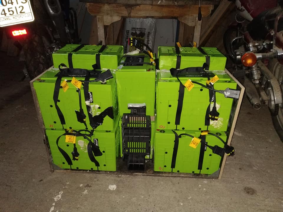

The batteries are being distributed between two to three locations:
-Under the bonnet can fit 10-12 while leaving space for a front motor install tab a later stage.
-where the fuel tank was
-In the rear of the car spare wheel well /open space where exhaust back boxes lived.
-Battery capacity is likely around 36kwh if I use all 22 of the valence batteries.

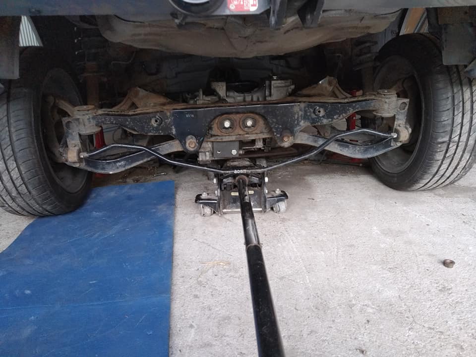

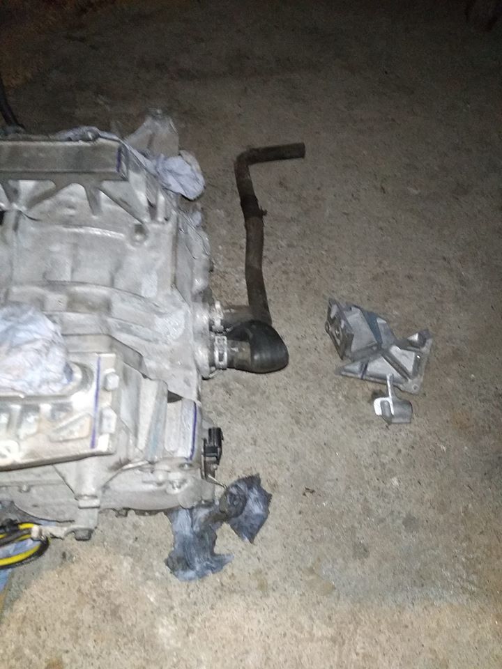

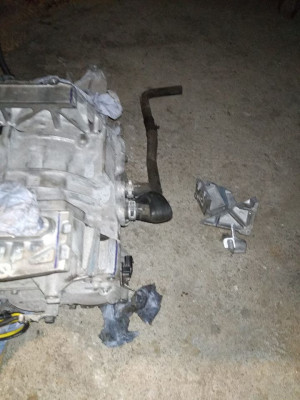

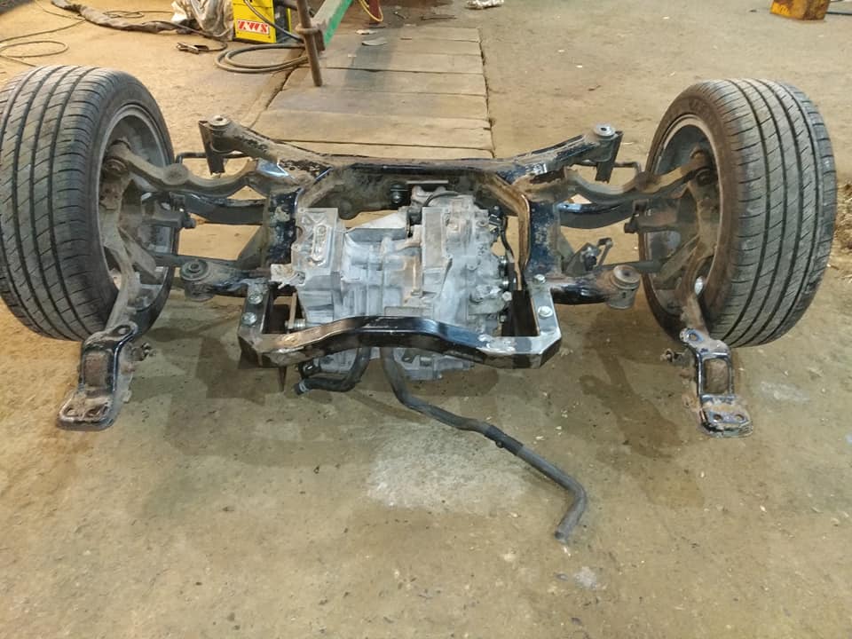

Update:

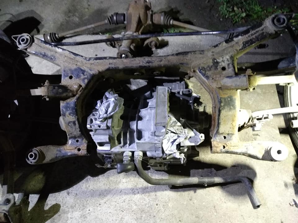

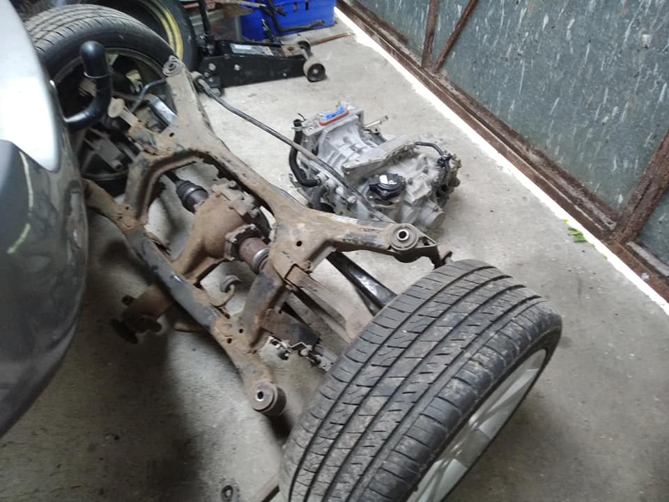

-Rear subframe was removed from car (leaf motor placed beside car for reference) -Motor top of motor required some surgery(originally I planned for a gen 1 motor, Gen 1.5 is taller) -Subframe required some cutting to fit motor( modifications to follow) -Motor is now spinning on 60v using leaf contractor box( Currently using P&S board as that came with motor)

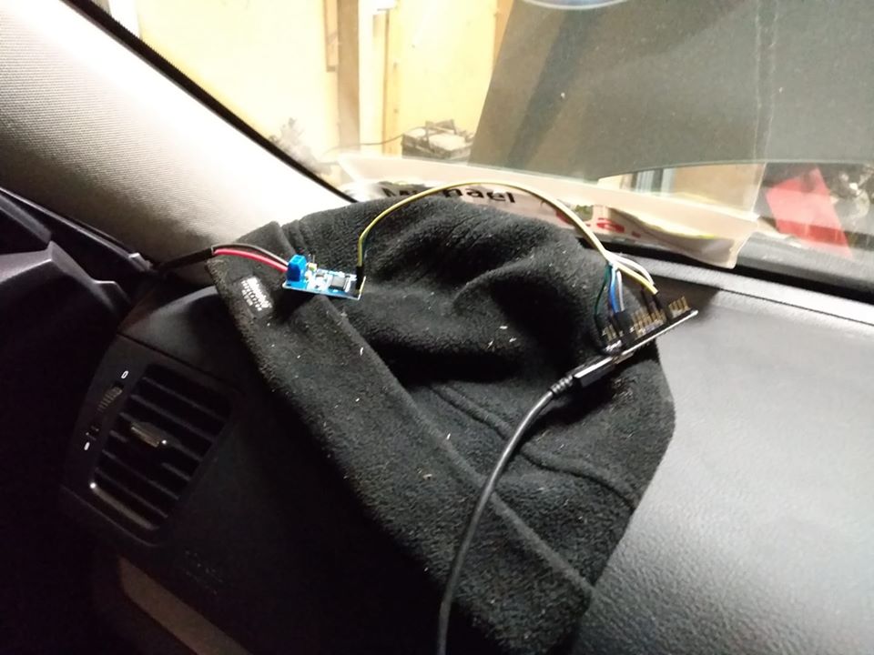

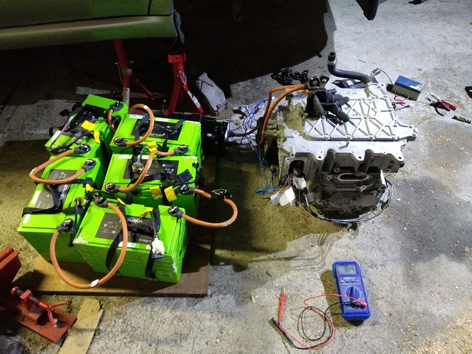

-Have the factory electric power steering working by injecting a can message (with kind help from Rikohm)

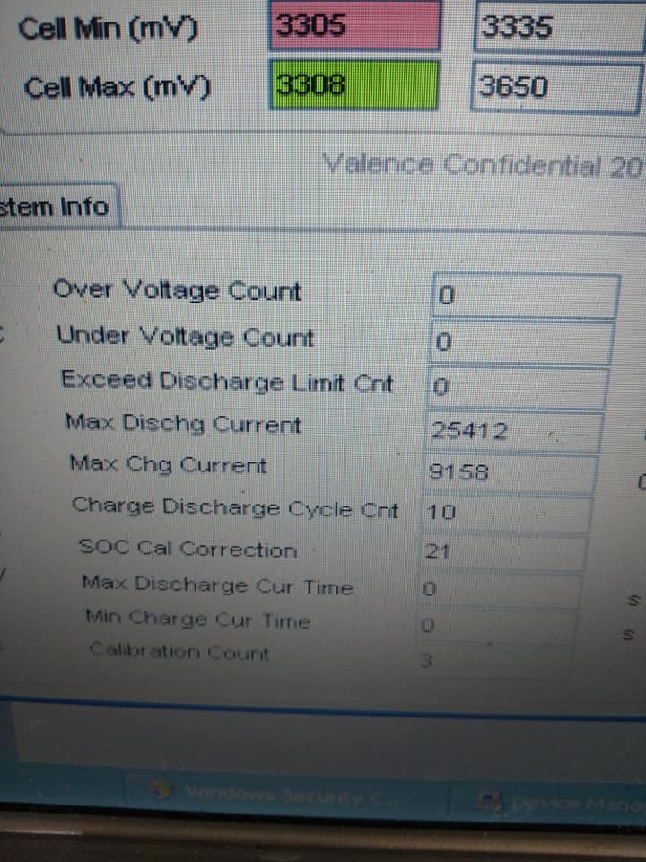

For the minute I'm using a Arduino nano with a mcp2515 simply sending the required can message once when key is turned to seat position. -Successfully got the valence batteries to communicate with the valence software( look at the cycle count) -Mocking up of front most battery box continues( one of three battery boxes) -Rear subframe has been modified -Test fitting to confirm all bracket locations are correct and have enough clearance

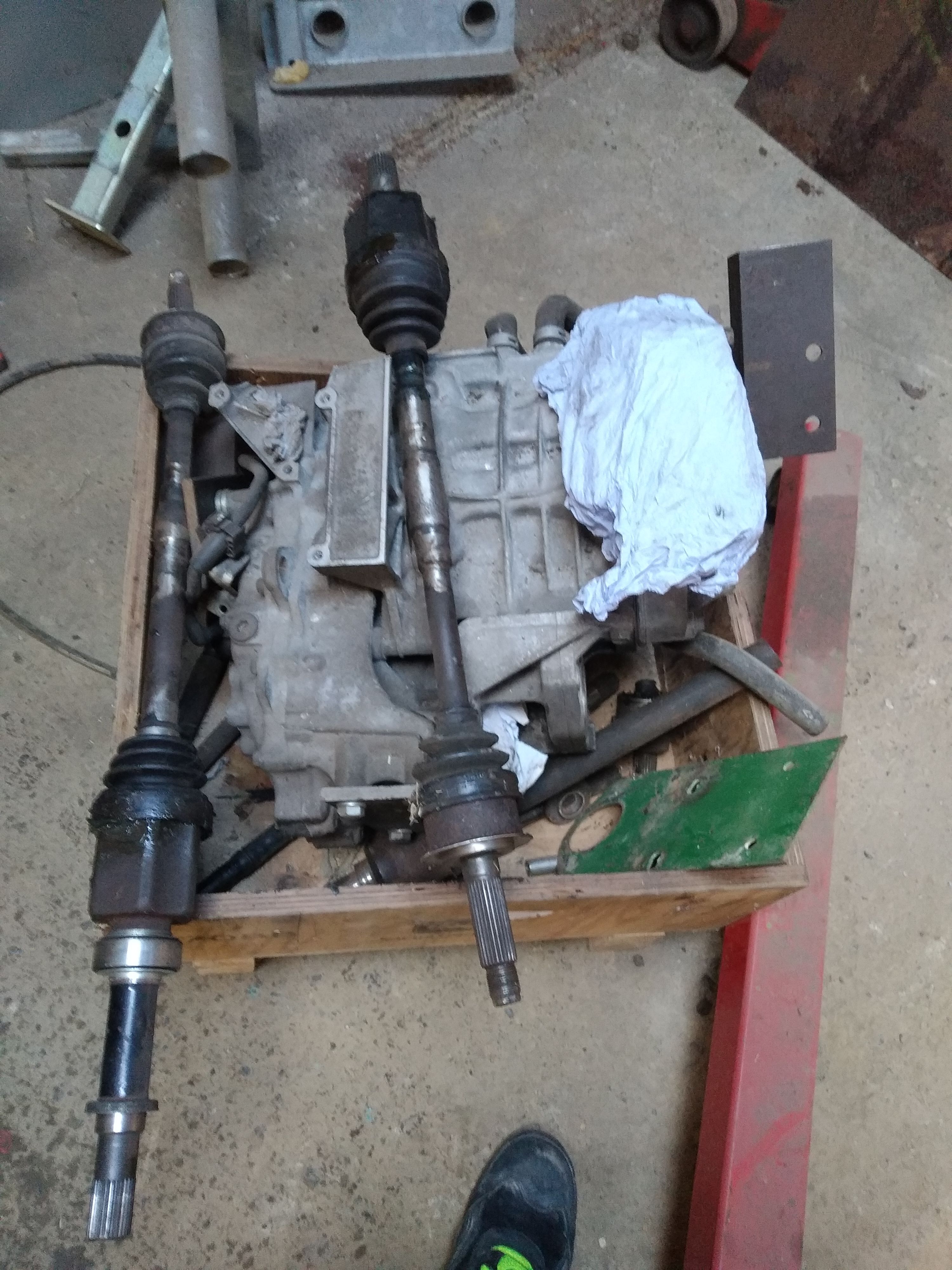

Cool, gen 2 motor and gear box will fit in the rear without modding the body. what are you planing on doing for axels? Nissan and Subaru... might be worth it to see if the races or doh cups or shafts will hybrid together.
Or see if the leaf wheel bearing bolts into the Subaru knuckle.
Subaru and Nissan have shared rear diffs forever... People often swap in Subaru r180 diffs into Z cars. Bolt in affair!

Hi , sorry for delay never saw your reply. I have some prototype axles made out of a mix of leaf smart roadster and Subaru shafts.The smart shafts have a very convenient step down that matches leaf shaft at one end a Subaru at other end. I will be getting custom set made up once prototype ones are tested and I'm happy with them.

paaa wrote: ↑Mon Dec 07, 2020 7:55 pm Hi , sorry for delay never saw your reply. I have some prototype axles made out of a mix of leaf smart roadster and Subaru shafts.The smart shafts have a very convenient step down that matches leaf shaft at one end a Subaru at other end. I will be getting custom set made up once prototype ones are tested and I'm happy with them.
Wow awesome, so leaf inner doj ->smart roadster shaft-> Subaru outer cv joint all just fits together? Amazing. Just about getting the right length. Got any photos?

I have a picture somewhere , Im only using it to mock up the shaft lengths so they can be sent off to get a matching set made. The smart shafts I have were already cut so not as much shaft as I would like to do a good welding job. Also don't think they will balance too well compared to a custom shaft.

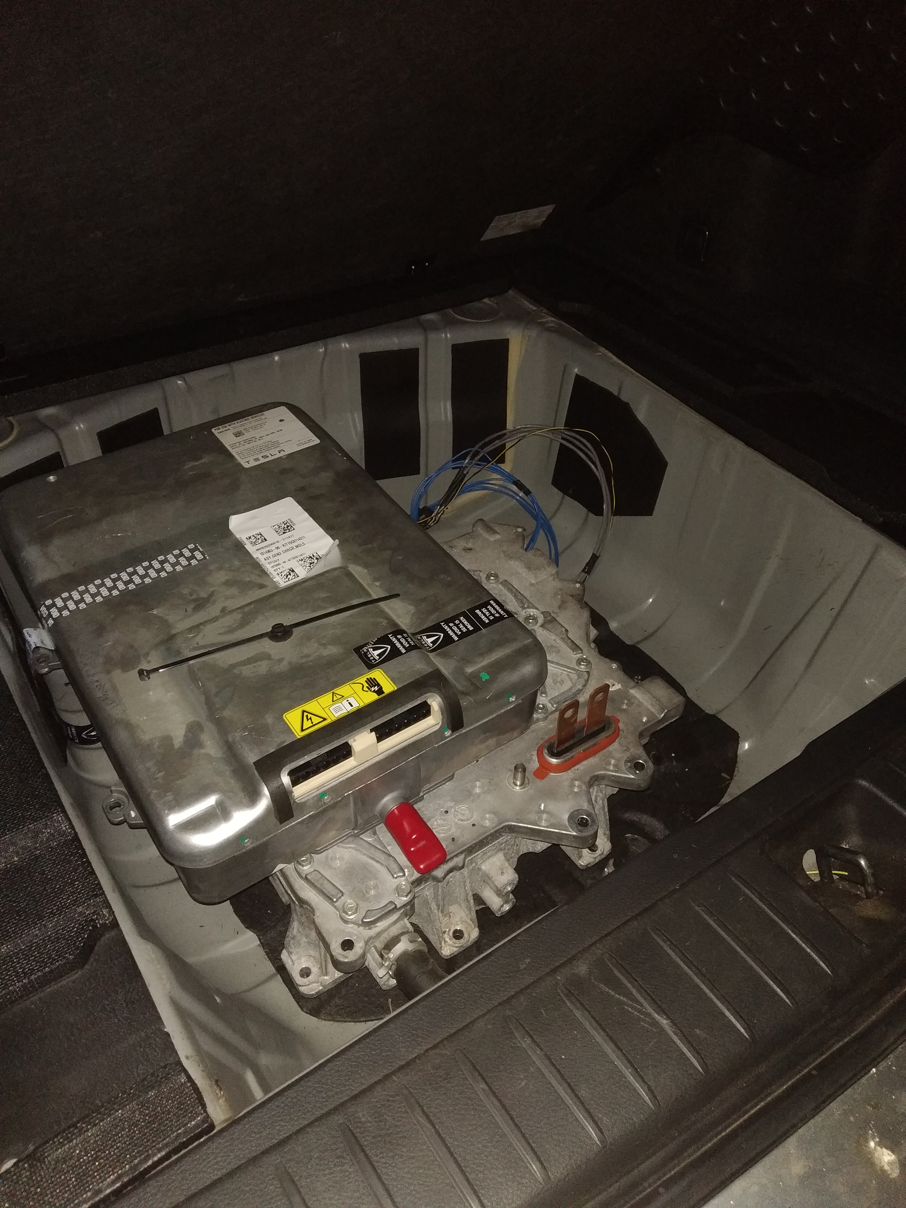

Got myself a Gen 2 Tesla charger and a Tesla DC-DC converter on eBay. Charger has arrived and just need to get a Tesla charger control board . Driveshafts are only being used to test fit and to measure for getting a proper set built before anyone asks.

Good luck with the build. Those valence batteries have done nothing if that discharge count is right. Well done.

Been meaning to a do an update for a long time but thanks to covid I don't have access to my car very often these days.Anyway while I had access I have been working on do some preventive maintenance seen as the subframe is out. Main jobs were to clean up any rust and then then prepare surfaces paint and rust proof the whole underbody while I'm working on it. On the bright sight I bought some nice Tesla parts to improve the build. I got a Tesla gen 1 DC-DC and a US model3 PCS to play with.
