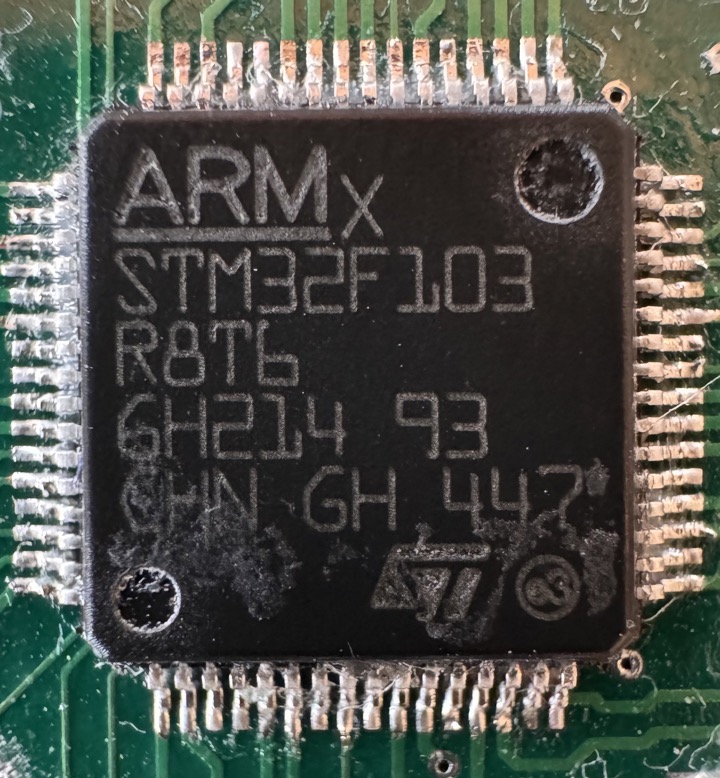

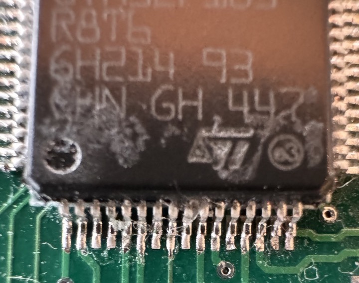

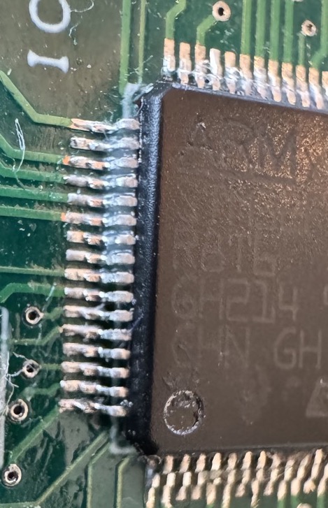

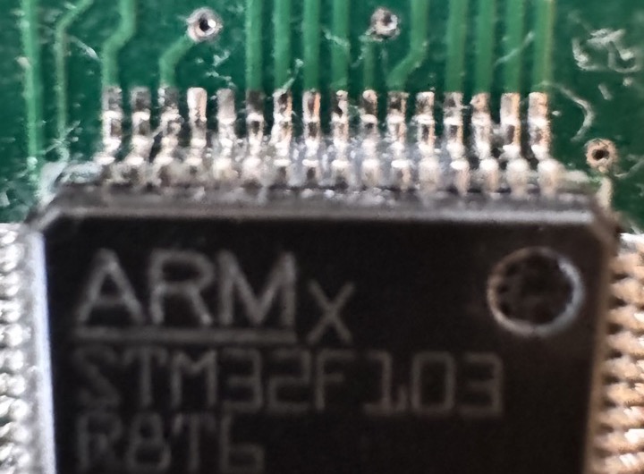

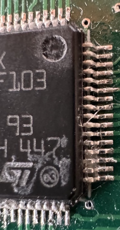

Can you post a close-up of the processor region. I have a suspicion.

Close up pictures from CPU. I think there is some flux residue between the cpu legs, could that be an issue or can you see something else?

Oh no, that is one of the chip crisis boards that came without stm32 and I fitted it myself. Tested all the digital and some analog signals but not all.
Which order number was this? If it's not easily fixable I'll send out a new one.

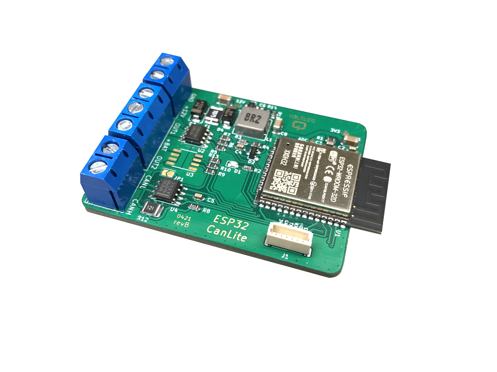

A CAN wifi bridge will be in the shop soon. It's based on the CanLite but has an SD card slot instead of the high side drivers.
Some info on the software here:

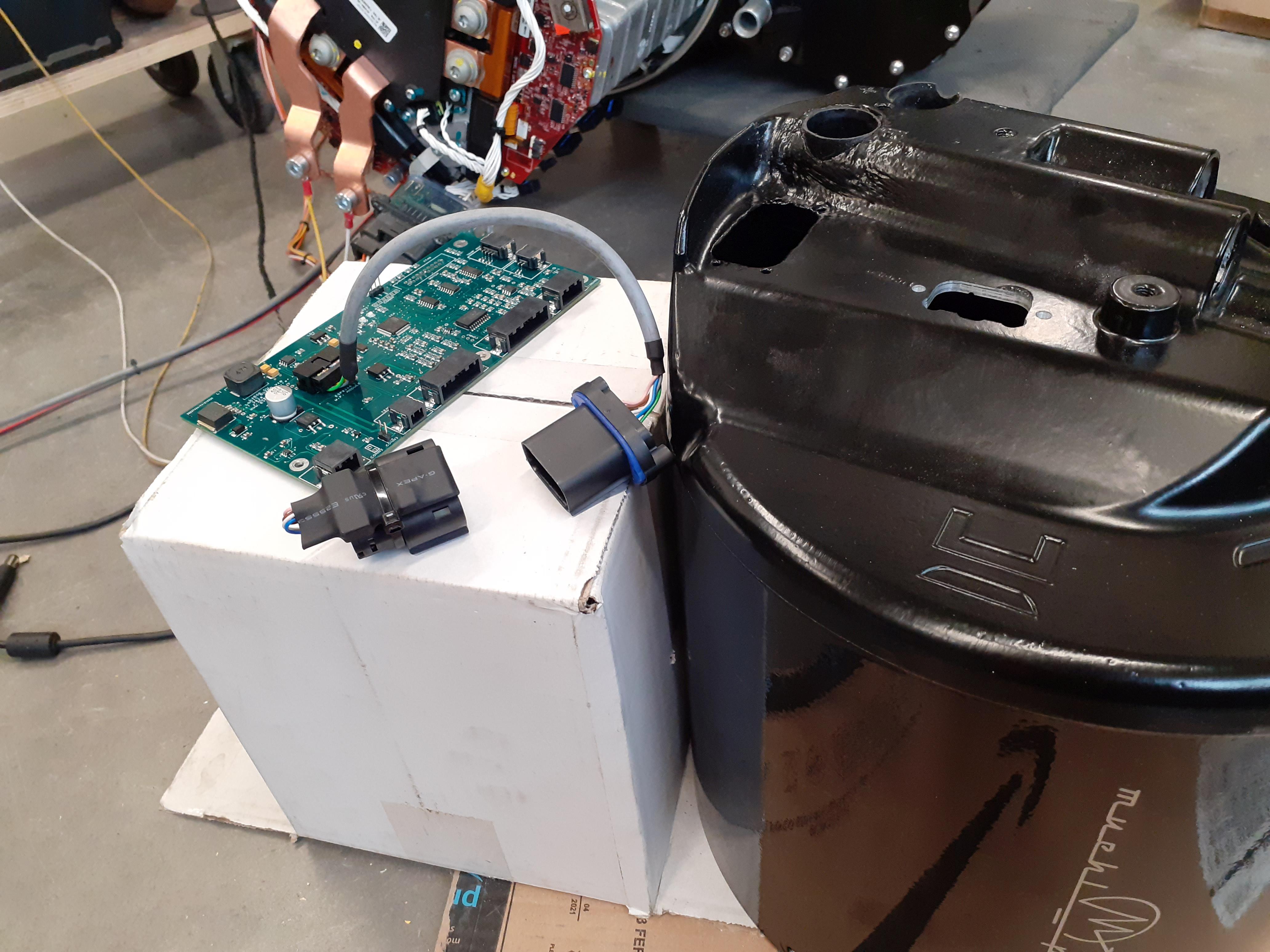

The ESP32 has an option with a u.fl connector on it to plug in an external antenna. Is this worth pursuing at all? Only downside I could think of is if its noticed during inspection. I'm not sure how it would do with vibration.P.S.Mangelsdorf wrote: ↑Mon Oct 30, 2023 12:23 pm This seems to be especially true with the big metal case of the LDU. I have to have my laptop directly over the LDU to get a reliable connection.

Yeah, a hole in the inverter case /cover, insert the antenna, then plug the connector into the esp32, zip tie the antenna wire for a connector strain relief. There are also extension wires available if it's not an easy to reach connection.P.S.Mangelsdorf wrote: ↑Wed Nov 01, 2023 11:48 pm Yeah but if the antenna is outside the case, you have to connect to it somehow, and unless there is a way to tap an unused pin on the 23 pin, that means a new connection through the case.
And keeping this genetic for the Tesla area, an inverter IO plug wouldn't be good for WiFi signal.

I have moved the whole wifi module outside. For this I have made a cable with a molex connector and cut a suitable hole in the housing. The mudul is attached to the molex counterpart and sealed. In addition, I have also led the programming connections for the STM32 out, so that I can connect a ST Link without opening the inverter.
