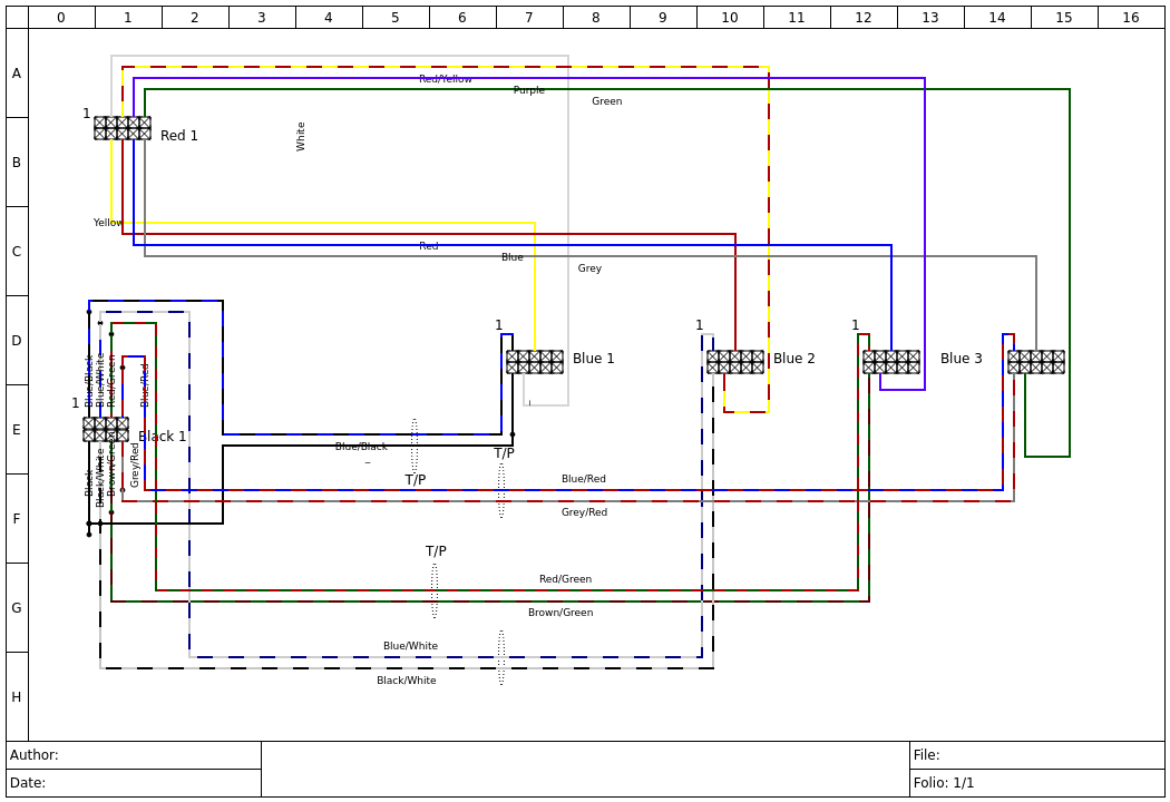

I have seen that thread and it has a lot info info and does imply point 2 but it doesn't say it. My unravelling of a wiring loom implies it too but I was hoping for a second opinion as I want to start putting my pack together but also because I want to add the missing info to the wiki and don't want to give anyone the wrong info.
I have drawn up a section of the wiring loom. This piece connects four dumb 2S batteries to a 4S smart battery.
The four are connected to the connectors I have labelled "Blue 1", "Blue 2" etc. Then the smart battery is connected to "Red 1" and "Black 1".
Although I am confident I have got the wires correct, I have no way to know if "Blue 1" is the most +ve of the dumb packs or the most -ve. I am not even sure that they run in order (though they probably do)
Please can anyone help?
Thanks,
Andy.

Hi, I have been off the forum for a while but if you stille need this:acollins22 wrote: ↑Sun Nov 12, 2023 4:22 pm Thank you tom91,
Thanks,
Andy.
The smart module is most negative in the series.
The blue connectors run in order.
Measuring from the smart module positive to the slave cells
White cell1 positive (blue1)
Yellow cell2 positive (blue1)
And so on like your drawing, its good.
So the blue4 connector in your picture with green and grey wires,
is most positive in the module series.
When connecting check the voltages are correctly rising from the red connector before inserting it to the smart module to prevent any damage.
