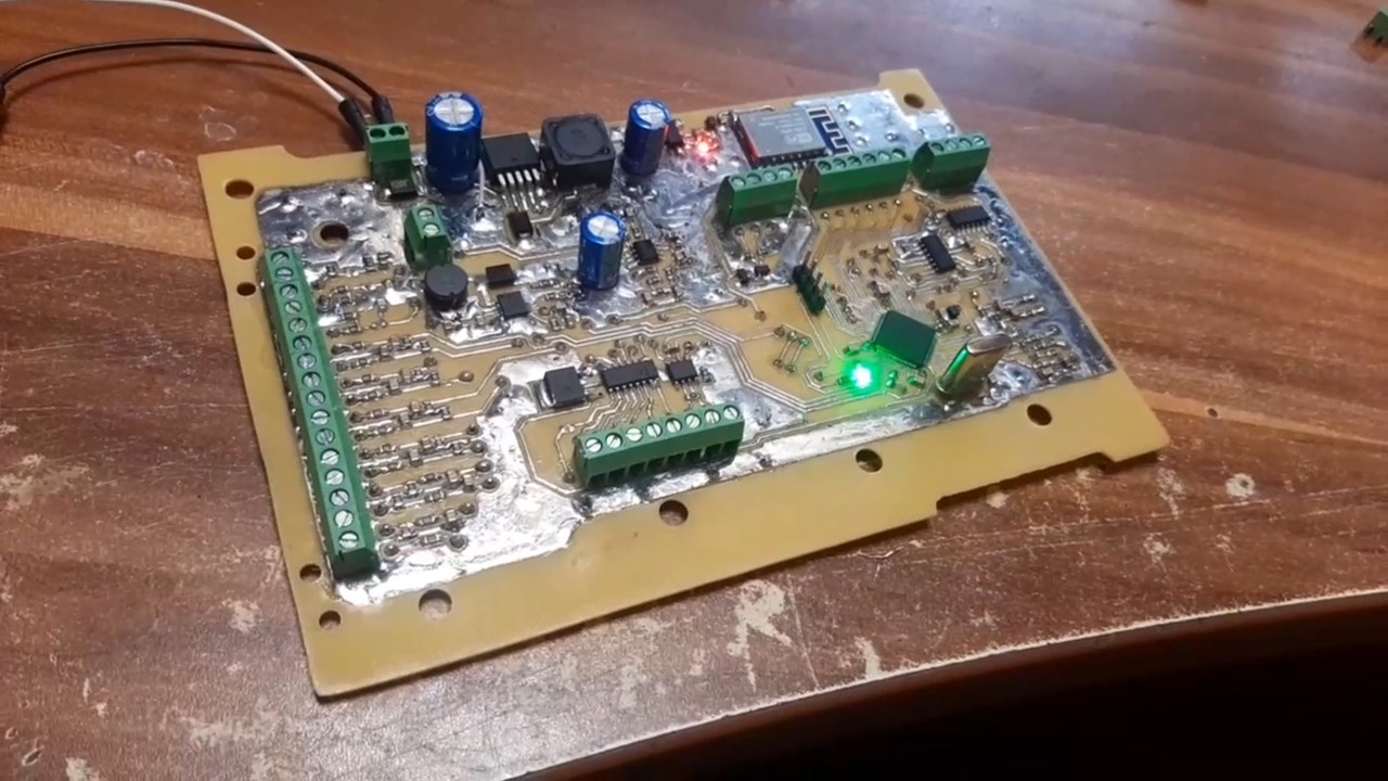

Right now I'm working on Leaf-related project - my friends are building custom electro-bike using Leaf powertrain. And I'm making inverter control board for them. We have good engine, 90%-probability-good driver board, battery assembly (now balancing) and toasted inverter logic board.
All parts are from crashed and burned car. Previous owner lost/burned all internal wires, so I need to be sure if I'm connecting Openinverter board just right.
So now I need CNDR1 and CNDR2 pinouts. I briefly searched through Gen1 and Gen3 threads, but wasn't able to find this info.
We're going a bit crazy here, so here's my version of OpenInverter hardware, homebrew etched. Some sections were changed - I used another PWM controller for resolver excitation, 3,5mm 'degsons' instead of proprietary connectors, different ESP8266 module etc. Overall it's based on mainboard v3.4 + leaf adapter. Seems to be working good right now, so we're ready to wire it up.

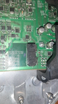

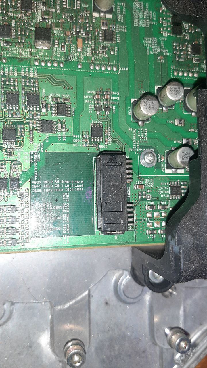

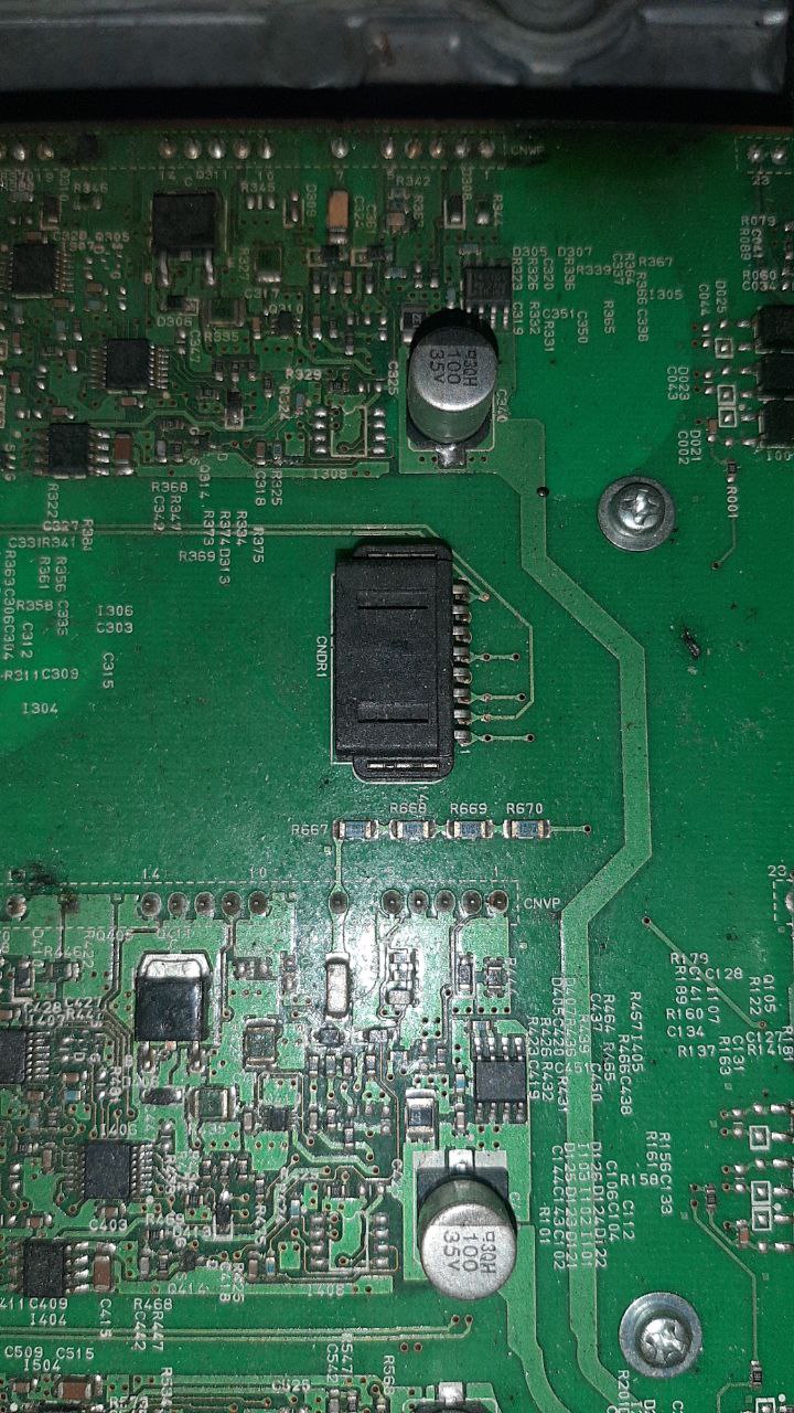

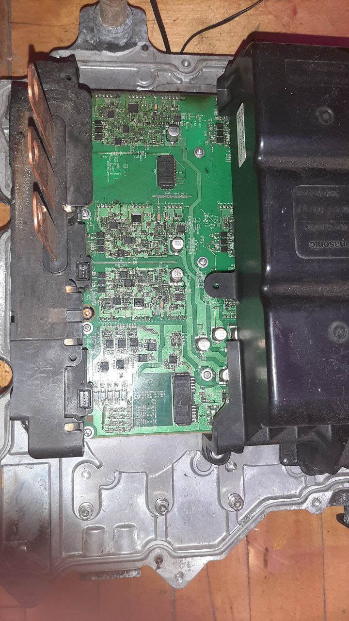

As i said, I don't have stock cables. I can tell where all six PWM signals go, but I'm not sure about FAULT1, FAULT2, UDC_PWM, heatsink temp and both current sensors.
I'm talking about this board and sockets:

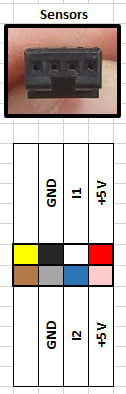

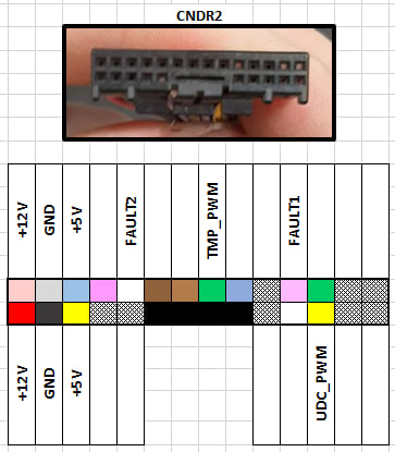

Well... Should be something like this.
Please correct me if I'm wrong here.

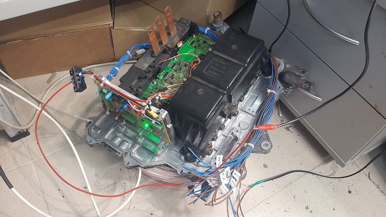

Ok. First, some problems with current sensors were solved. Now it calibrates just fine. Also, there were some strange shenanigans with protection circuit comparator and input/output logic. Also solved. Second, I found cross-layer short-circuit on IGBT board and restored and replaced everything damaged by high temperatures.
So, we had persistent precharge error, several strange overcurrents without any currents and HV, no stable calibration, i changed current sensor dividers etc, etc... Now we have no errors at all, which is good.

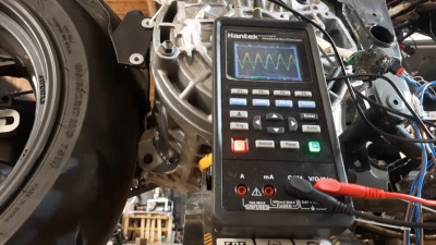

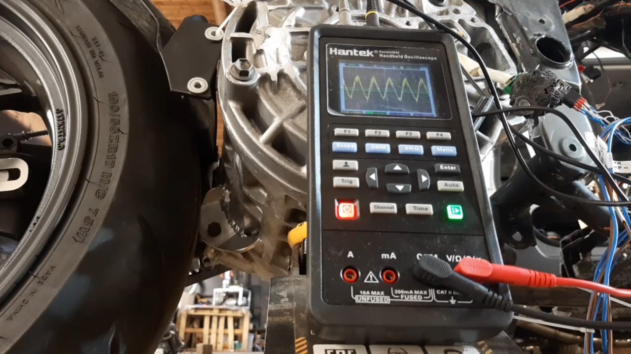

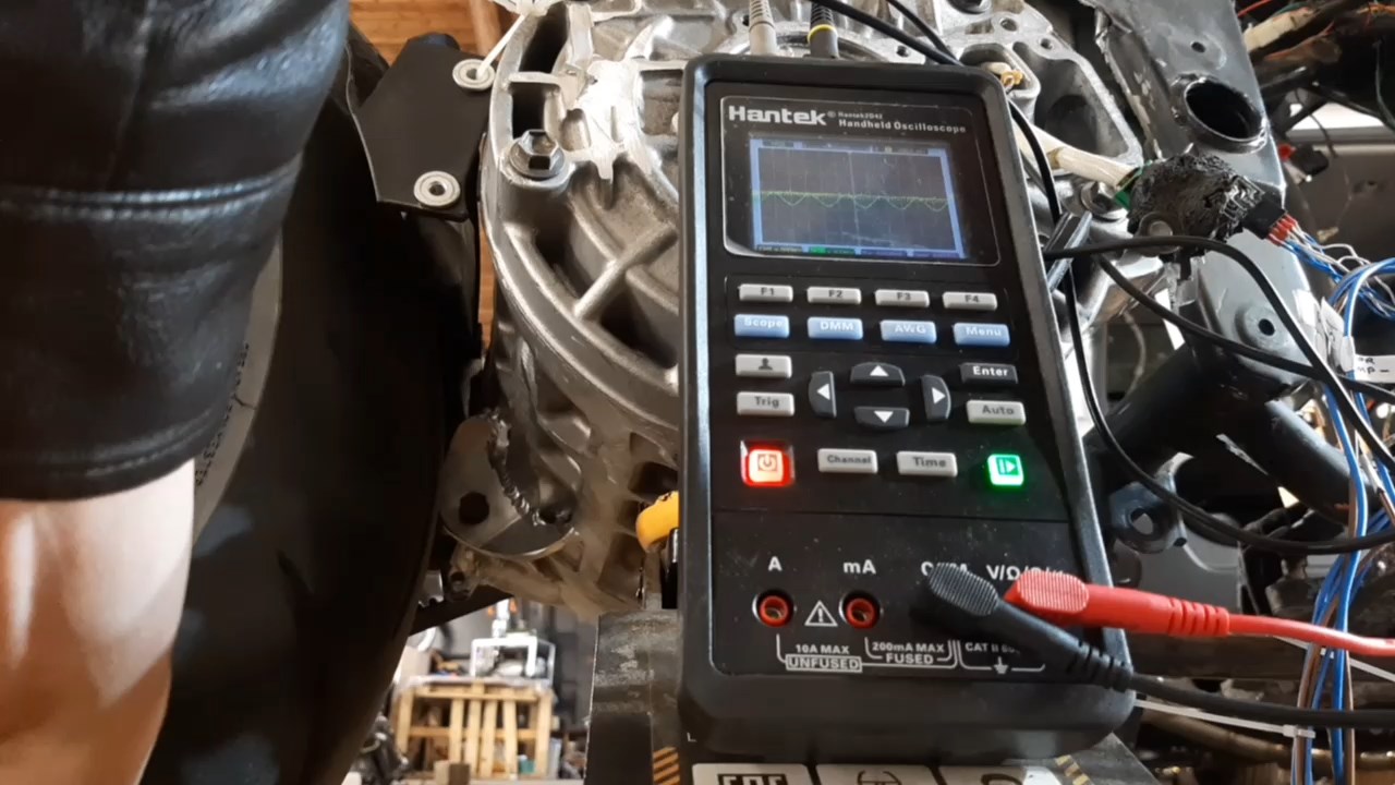

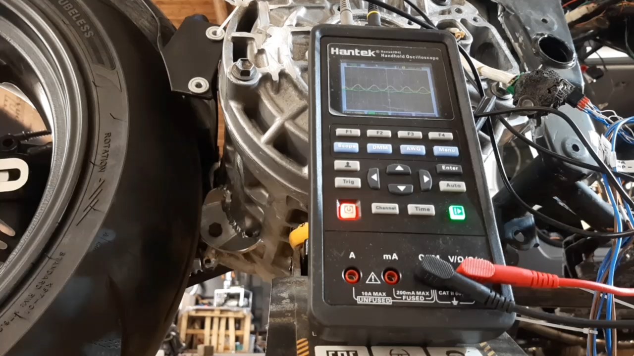

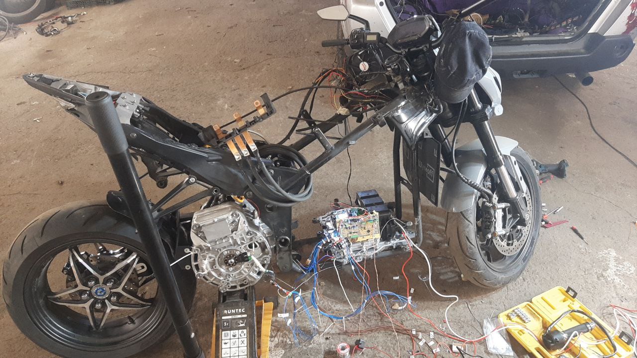

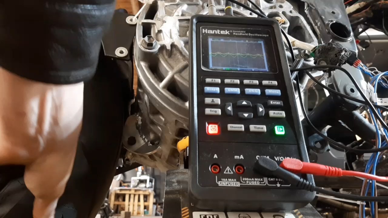

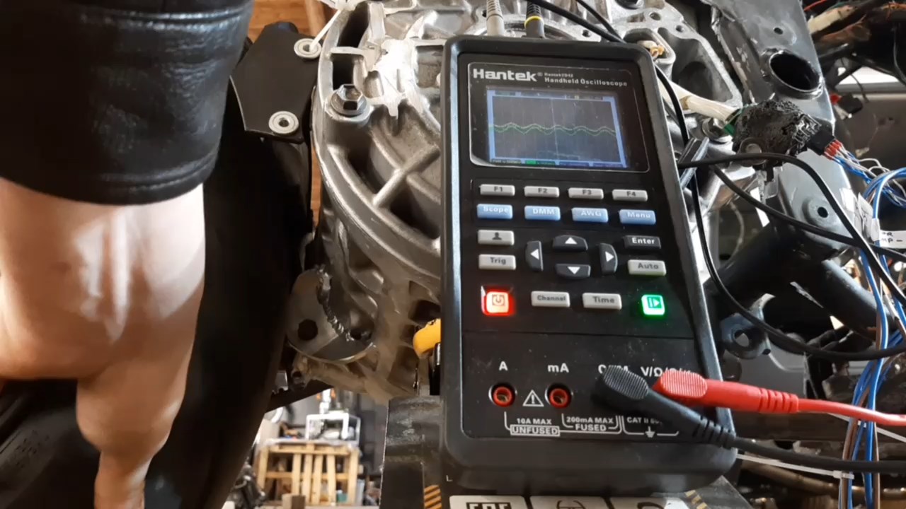

Now we can't properly calibrate resolver. I rolled back to FOC 4.97R FW. Angle indicator jumps between 150 and 340 deg. It doesn't mater if you rotate motor or not. The resolver (and engine) was not damaged by fire, so it's not the cause. 1,65V bias presents. We have nice cin/cos signals. But sin/cos waveforms seem to have low swing just around 500 mV (AFAIK, it should be close to 0...3v3 range - correct me if I'm wrong), and excitation waveform is too fuzzy.
My guesses are:
- bad TDA2822 - will check it this evening
- my TPS55340 booster provides wrong supply voltage for TDA amplifier.
According to my computations, MIC2288 should provide 1,24*(3300/510+1) = 9,26 volts with 510+3k3 divider. So does my TPS55340 with 10k+64k9 divider.
Can you show me excitation waveform parameters? What swing should it have? What output voltage your MIC2288 booster provides? Am I wrong?
Sorry for bad photo quality - pretty hard to test and film everything in process. It's excitation waveform and sin/cos outputs. Also, the bike =)
Also, please 'un-solve' this topic. We still have ways to go in this struggle =)

It was TDA. Now we have some spin. Time to tinker with resolver offset.
UPD. Got some decent RPMs and almost found good syncofs. But half-baked IGBTs finally decided to die. RIP.
Will wait for new inverter now. While it's been delivered I will apply some fixes to my logic board, also rework wires etc. And try to play with CAN bus control and something zombieverter-like in process.
