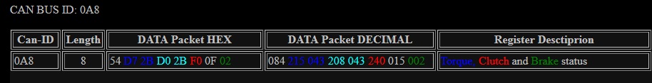

Hello all,
I have some doubt about canio setting. I want how much is possible to read parameters from BMW E87 via CAN. I was trying to read brake status, but until now without success. In my case according to http://www.loopybunny.co.uk/CarPC/can/0A8.html
I have:
So in my car is:
Byte 7 = Brake:- 0,1,2 or 3 = Brake released, 32,67,98 or 99 = Brake pressed.
For sensing brake pedal usage simply detect <20 = off and >20 on.
And now what I saw on wiki should I write:
can rx canio 168 7 * *
What should be under "*"? How should I take this value <20 = off and >20 and say to Bit 2: brake inverter "this is released or pressed?

Uh I'm afraid the generic method won't allow this, also since brake pedal most likely isn't the only signal you're trying to read? If you have multiple mappings on canio they'll overwrite each other.
There seems to be no common bit that is always set on brake, only bit 6 is mostly set:
00 = 0000000
01 = 0000001
02 = 0000010
03 = 0000010
32 = 0100000
67 = 1000011
98 = 1100010
99 = 1100011
In that case you could do "can rx canio 168 62 1 128" So map the 62th bit (bit 6 of byte 7 = 54+6) to the 2nd bit (32*2*2) of canio . You'd miss the 32 case though.
So either install a VCU with some custom code to translate CAN messages or compile your own custom inverter code.

It works perfectly, so thank You Johannes very much. Bottle of something good is almost full, so I have to send it directly to You
Until virus will gone, we can't drink it together.

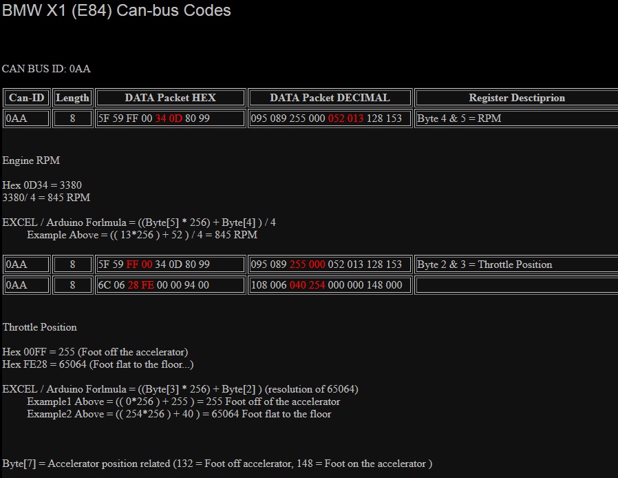

I have another question according to CAN settings.
Now I have in E87 116i:
POT -> can rx pot 170 24 8 32
what is similar to loopybunny at In my car only byte 3 changes value from 0 to 254 according to throttle pedal position - this works fine.
And now - at the same adress is motor RPM at byte 4 and 5. Is it possible to read and write values from the same adress at the same time?
for writing RPM should I write:
can tx rpm 170 32 16 XX where scaling (what value - I don't know)
This should work?

Now I did small trial and is possible to read value
and transmit
SPEED -> can tx speed 170 32 16 10000
In this case however BMW rpm needle go immediately to max 7krpm. Smaller values don't moving needle at all. Idle speed 500rpm also doesn't move needle.
Is it possible to move it without external arduino for CAN translation?

I had no idea what gain should be, so I tried to put any value from 1000-10000 with step 1000 and with this one needle moves
Probably if motor speed is from 0-10000 rpm
and
expected by instrument cluster value is 0 to 28000 (7krpm *4) but coded like:
Hex 0D34 = 3380
3380/ 4 = 845 RPM
So right, gain should be 2 to 4, but it doesn't move the needle.
Byte[4] = 34 hex = 52 dec
Byte[5] = 0D hex = 13 dec
Arduino Forlmula = ((Byte[5] * 256) + Byte[4] ) / 4
Example Above = (( 13*256 ) + 52 ) / 4 = 845 RPM
EDIT: now it works!
Not perfect, because from time to time needle goes to 0 and then after some time goes back. Gain = 4
Reason, why previously wasn't good? canperiod should be 10ms for BMW E87 instrument cluster
Johannes, how did You solve, when on idle You have 800rpm, and then if motor increases speed needle goes up? You are using another arduino?
And another: Johannes You should be a teacher! Your one question "why gain 10000" puts my brain into deep searching mode
Thank You.

I indeed have a separate VCU generate the speed message and that just never drops below 800rpm while inverter is in run mode.
Some older firmwares had wrong CAN configuration, it did not resend lost messages. Recent 4.76 certainly has that fixed. That used to be the reason why I got a droppy needle.
