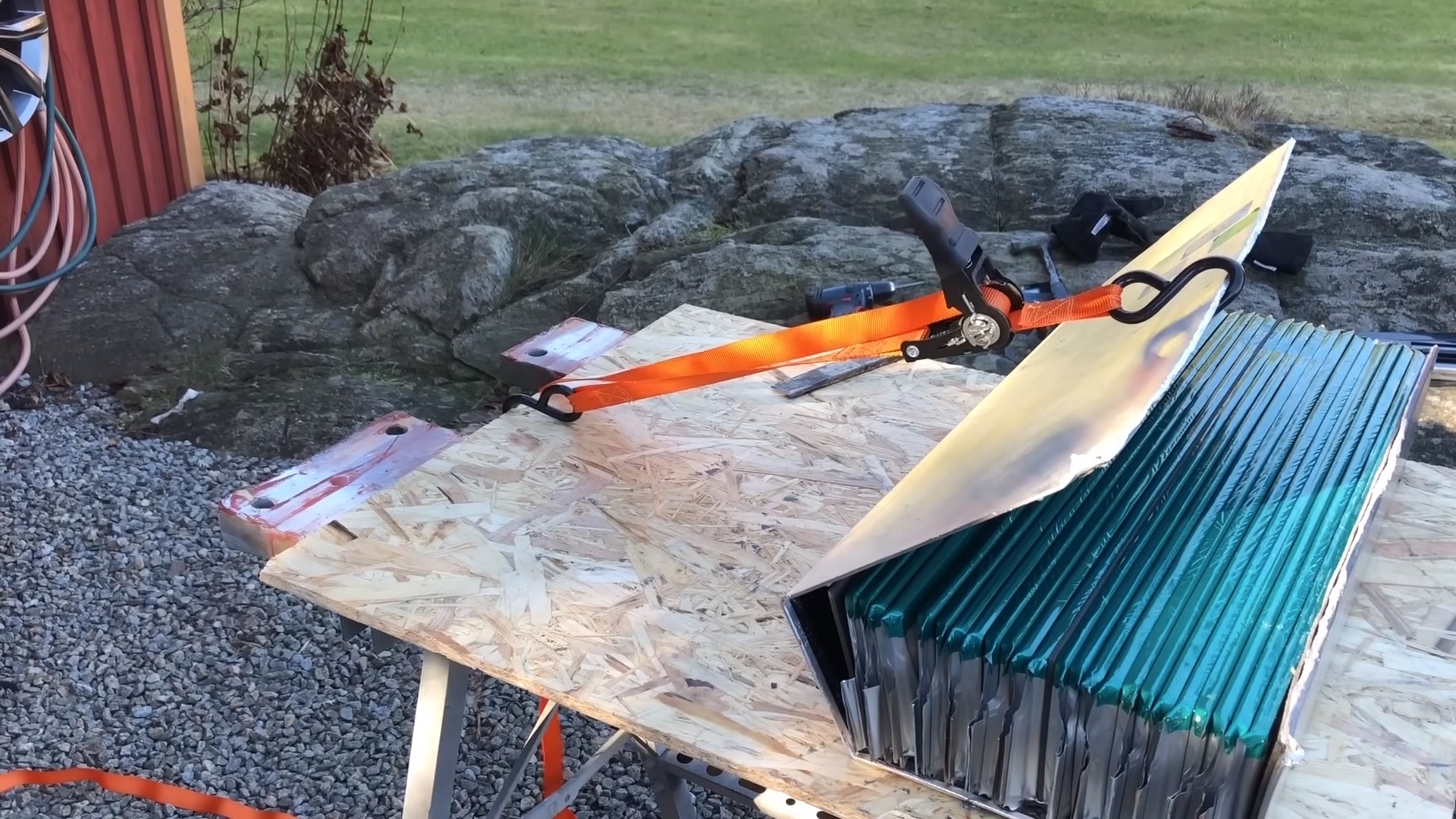

Open up a VW id3 id4 lithium battery module.
Re: VW ID.3 62kwh Battery Pack Teardown
Posted: Mon Nov 20, 2023 6:04 am
by arber333
Gregski wrote: Mon Nov 20, 2023 2:46 am Open up a VW id3 id4 lithium battery module.
Yeah... i just managed to burn some fuses in my modules. I will have to cut those modules and then figure out how to fix them in place since i will be cutting the back flange off...
After i repair the fuse i intend to glue the block back but for sure it wont be able to carry 30kg!!!
