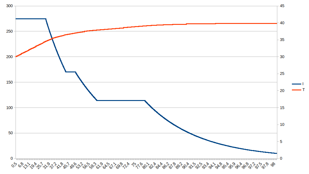

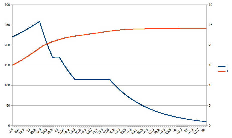

Now for me one of the most critical parts is the charge curve. I think manufacturers spend a lot of time tuning them in a way that you have good charge speed and longevity. So I want to mimic as closely as possible what VW does.
So I went on the internet and searched for Björn Nyland recording a charge session of an ID.3 with the 62 kWh battery.
Then I wrote down the voltage and current curves and also tried to work out the internal resistance of the entire system by using the current step at the beginning of the charging session.
With that done I arrived at this: It may not immediately jump out from the curve but it does when looking at the raw data: It seems like they are running 2 3 subsequent CC-CV curves.
The first: CC=310A, CV=3.93V (per cell). In the recorded session that runs to 50%.
The second CC=170A, CV=4.03V (60-70%)
The third: CC=114A, CV=4.25V - yes they actually go above 4.2V, 459V on the charger display and it is a 108S pack
In the session that started at 70% till 100%
From 3.93V to 4.03V they seem to run some A/mV profile that starts at 170A (cutoff of first CV) and ends up at 114A (CC2).
By using a P-controller only the CV point is very soft and approached linearly.
At least that's how I interpret it and programmed it. I like making it all cell voltage rather than SoC dependent because in the latter case errors in SoC calculation could screw up the charge curve.
I have no data on temperature derating but I'm thinking this ideal charge curve would start at 20°C and end at 40°C. Outside that window I plan to derate the CC values. Most of all it should stop charging before 45°C because arber says that's where the cells behave unsound.
Will probably linearly ramp down the power to 50%@0°C. And below - I don't know.
Any input appreciated

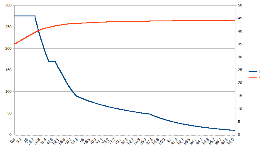

And here is the code I'm currently running. I've tested it with a "battery model" and results look sane.
https://github.com/jsphuebner/stm32-car ... mebbms.cpp
When comparing with the stock curve be aware the x-axis is time scaled
I have also implemented low and high temperature derating, here is a charge session starting with a 15°C cold battery The CC phase starts lower than normal and ramps up as the battery self-heats
And here is a charge session that overheats towards the end My battery model uses a constant internal resistance, so it won't behave that way with the actual battery. Also no cooling is simulated

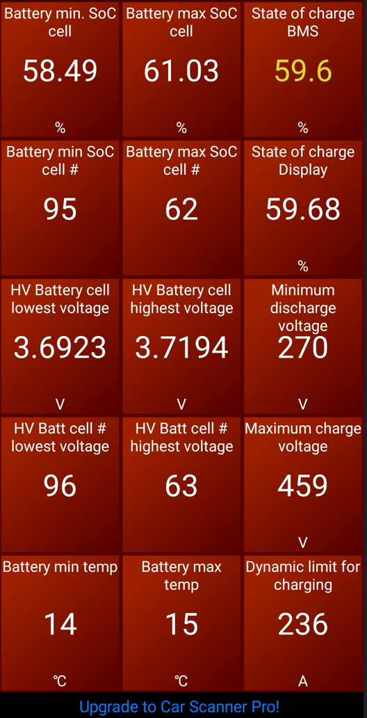

Re: Replacing the VW BMU aka implementing high level BMS functions

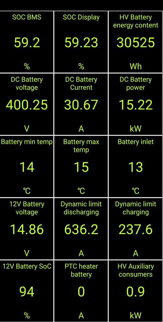

I'll try to remember to pull some data points from CarScanner for you. This is an older screenshot in my phone:
Hopefully you can cross reference these with your model and see that it lines up somewhat sensibly.

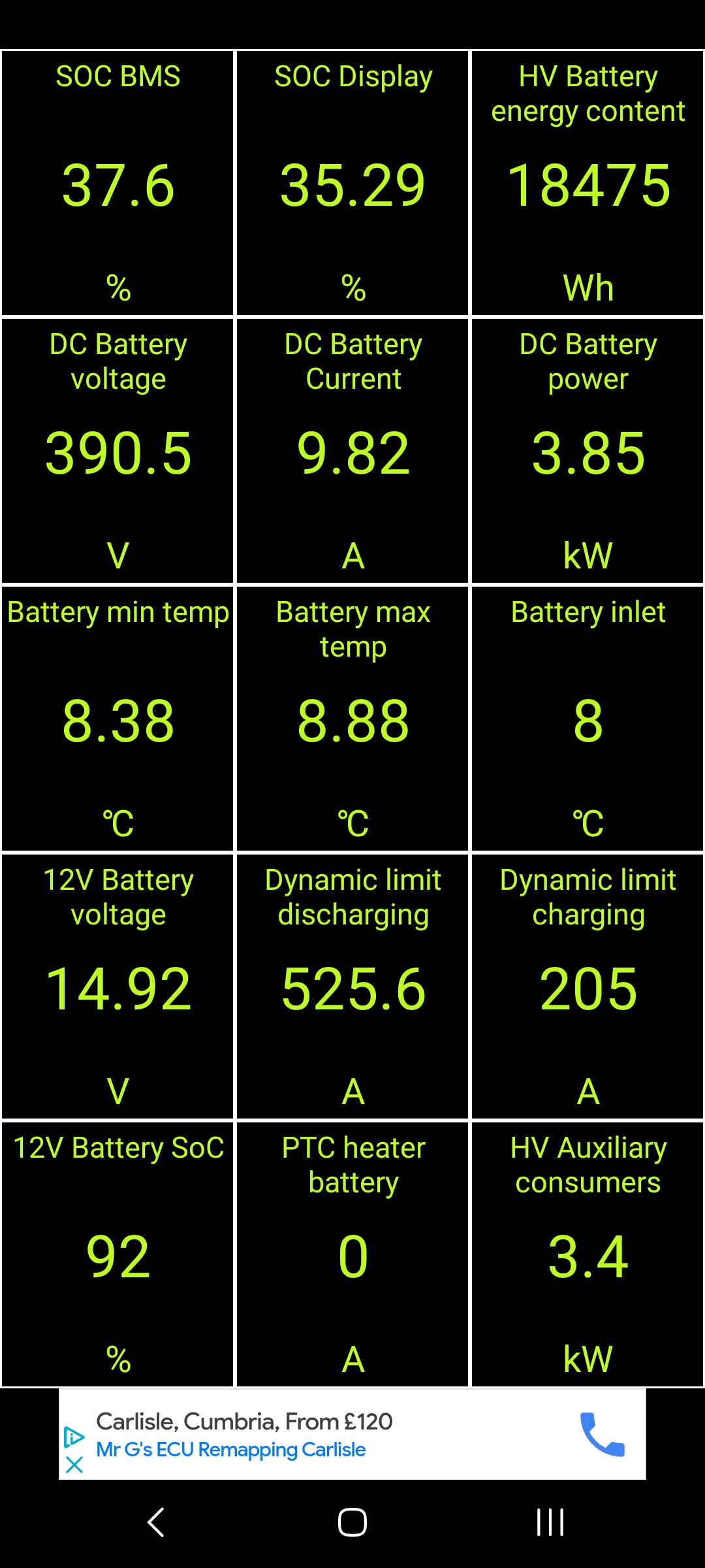

Thanks, yes more of that
The Nyland curve is 220A @ 35% or 204A@40%. Seems like there is not much derating at 8°C. Unless of course it goes down once you actually start charging. This could be the regen limit, right?
Yeah that is in "drive" mode, not sure if it would then apply different limits when charging vs regen.
I've seen one log taken during a rapid charge (from someone elses car) where it was showing 80A on a warm battery, with the charger churning along at 37kw, but that felt like it was showing the charger limit or something, because theres no reason i could see for it showing that low a value. The battery was over 20c and the SOC was low enough that it should have been doing 100kw+. As soon as it was unplugged it jumped back up to over 200A.
My own car only has the "50kw" charging option as i didnt pay the extra to unlock the full 120kw, so not sure what mine would show when charging.
I will try to get some more points on the curve and also see if i can get some at much lower temperatures once the weather cools.

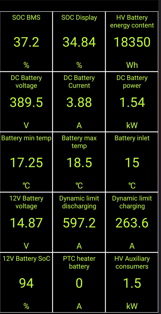

We can probably pull similar data from Carscanner as a cross reference, a different page can show us SOC and cell voltages (though for this particular screenshot i dont know if the battery was fully unloaded):
Two snaps from yesterday before leaving work and after getting home, bit warmer though so not giving us much data for low temps:

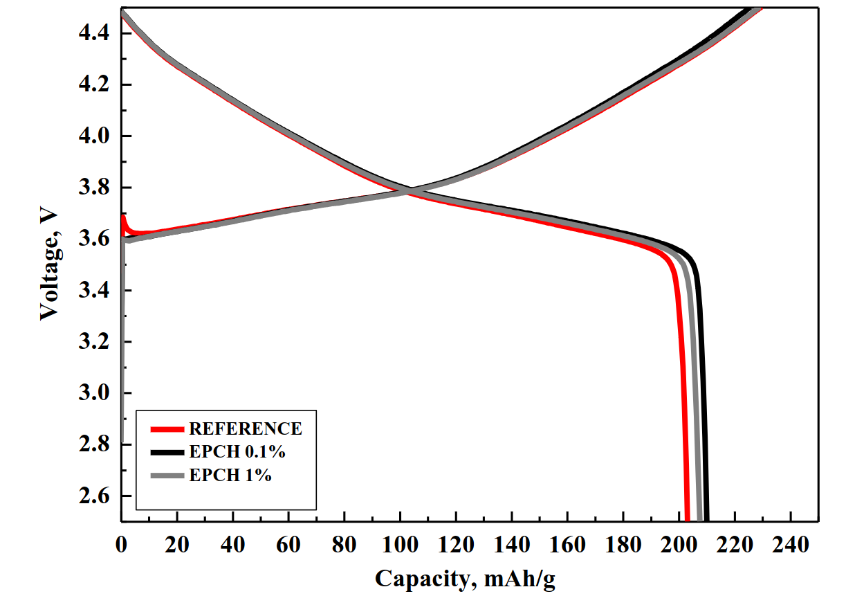

I found a curve for NCM712 chemistry which apparently the MEB cells are.
It is not open circuit though... Loaded with 0.2C
Surprised to see these can go to 4.4V. Explains why it is allowed to reach 4.25V in the charge session (and then still has a top buffer)

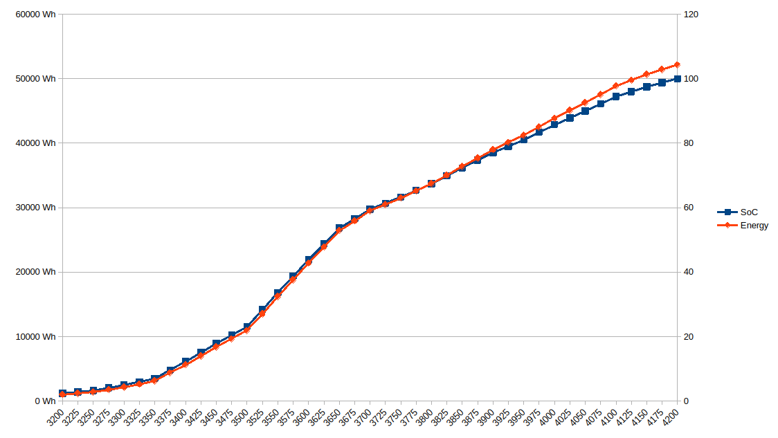

And next up is the "state of energy" or SoE. SoE as opposed to SoC takes the cell voltage into account. The upper 50% SoC contain more energy than the lower 50%. The voltage is then lower and the inverter will draw more amps for the same torque request.
Some cars only display SoC and even base the range estimate on it. Then you're in for a surprise when SoC drops much quicker at the low end.
I graphed it here: Basically made 5% segments and calculated the energy left in the middle of that segment. That is then divided by the total energy.
For both SoC and SoE to make sense the actual capacity of the worst cell must be known. So that is up next

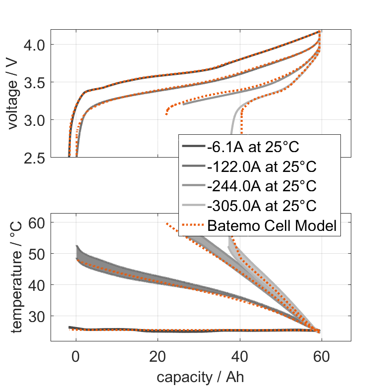

So the VW MEB LG cells are E78 cells. which is the same family as the E61V, made in the same factory.
https://gosavetime.com/specifications-l ... l-lg-chem/
https://www.lgensol.com/assets/file/LGE ... s_2022.pdf
https://www.batemo.com/products/batemo- ... chem-e61v/
giving you this curve

The SoC table is still inaccurate. Probably because the table from the video is taken under load 8A/0.1C. So SoC estimation is always to high, depending on the slop the error can be over 10%! Certainly need to fix this.
I think I'll make a new curve with the remaining module. Empty it, charge 5 Ah, wait 5 min., take voltage reading, charge 5 Ah,...
