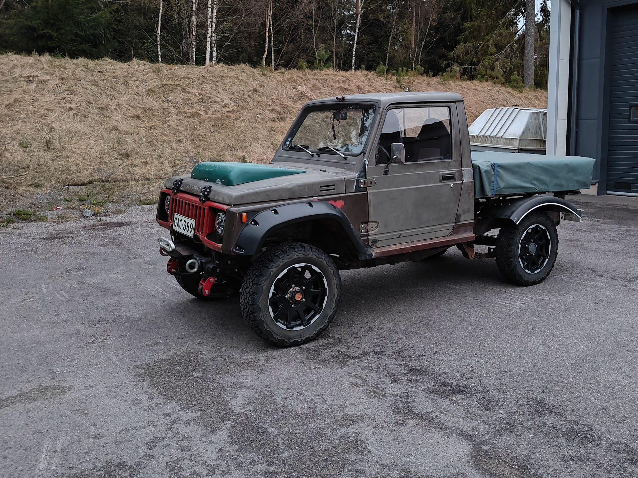

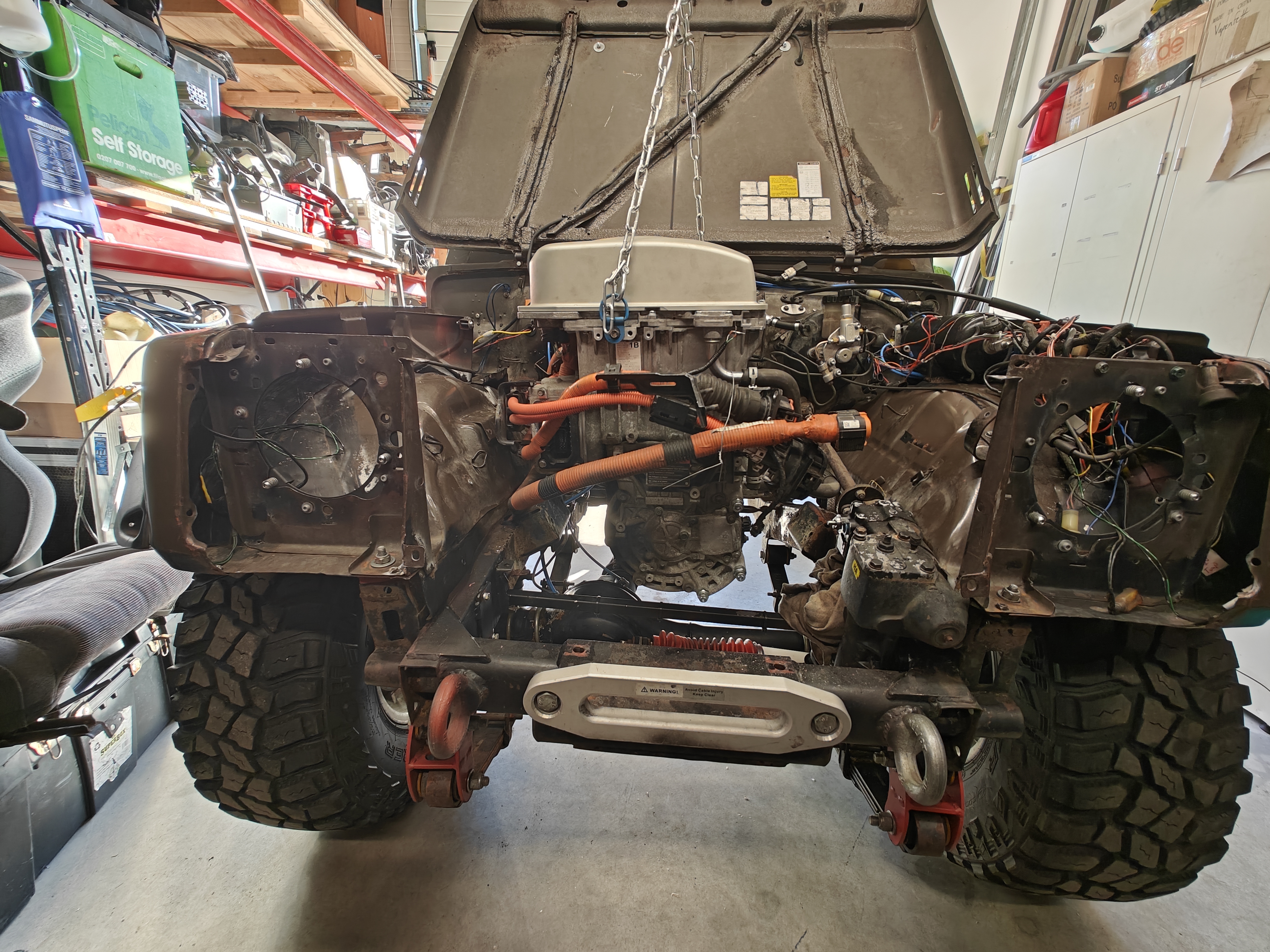

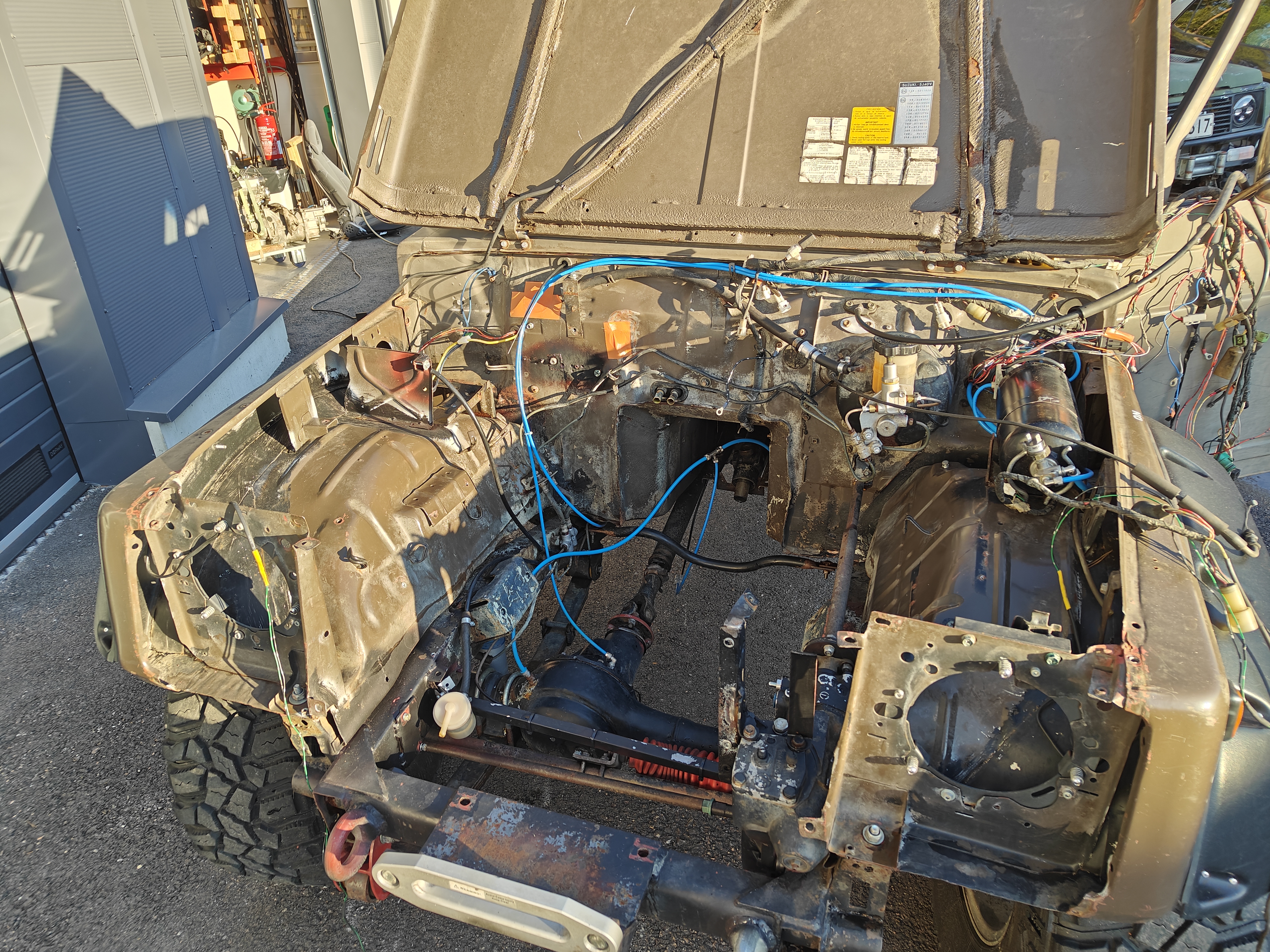

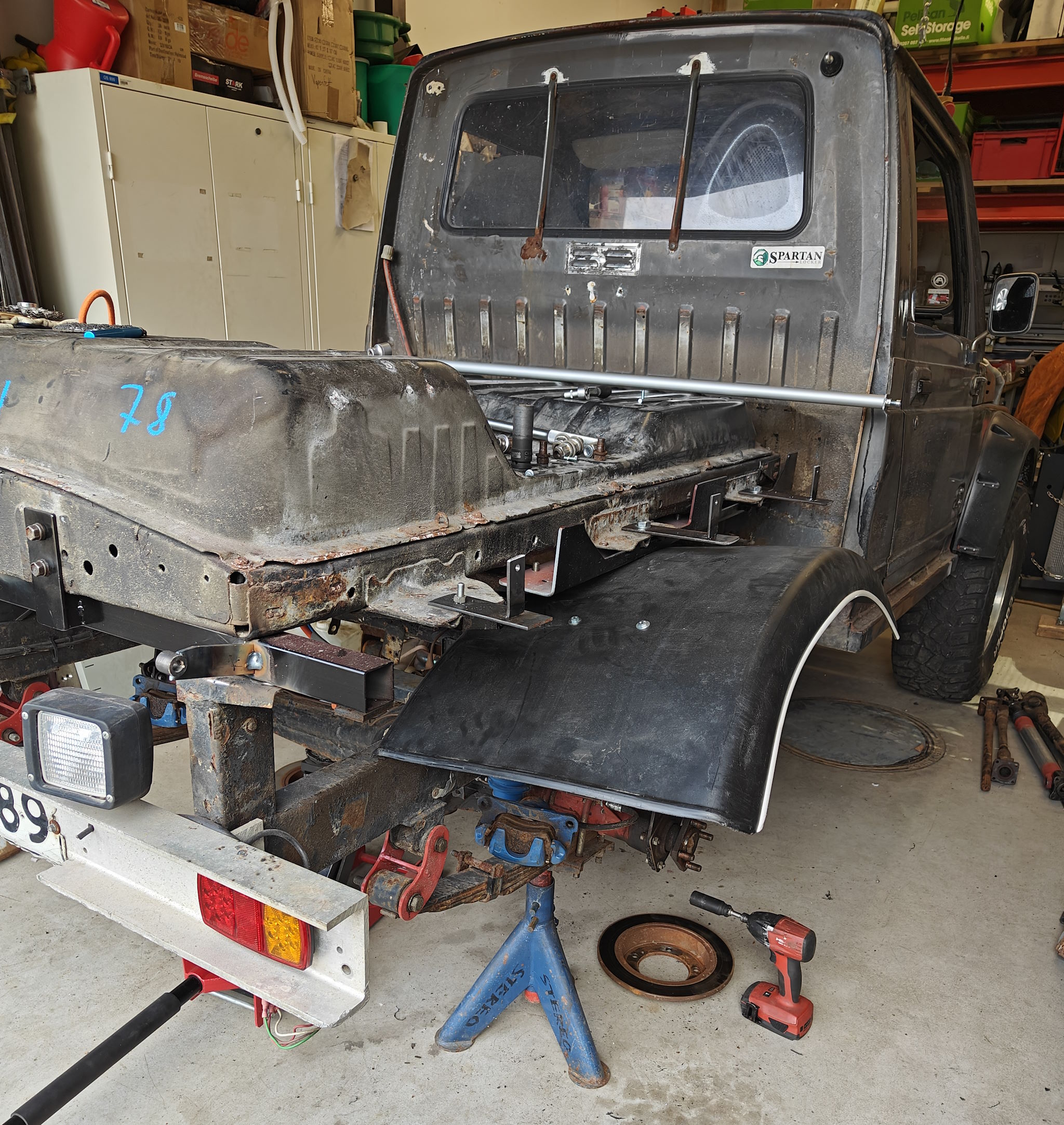

Well, looks like I'm in the business to shine some light to this project.

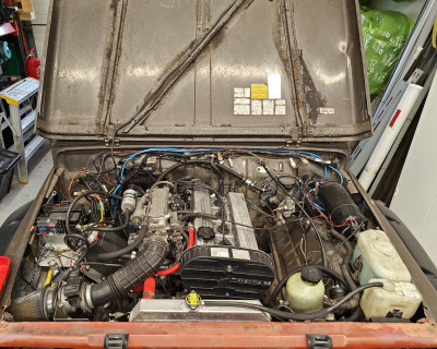

Maybe a word about myself first. I'm a mechanical engineer and a Suzuki nutter. The SJ Suzuki has been my 1st choise to rid me of my excess time and currency for over 25 years.
I've got a Suzuki SJ410k which has met a Samurai along its life and thus has Samurai running gear in.
This is a recreational Offroad vehicle for me but is also driven on pavement a day of driving is maybe 100-120km at worst (typical would be less than 50km and then a day of wheeling) So in that sense also a perfect candidate for a Leaf swap:)
Yes, this is a rusty shitbox, but I'm not bothered about it.
The plan:

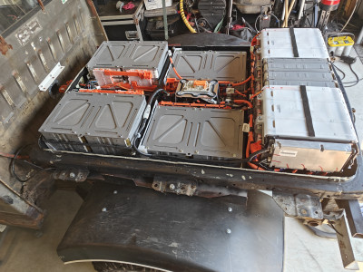

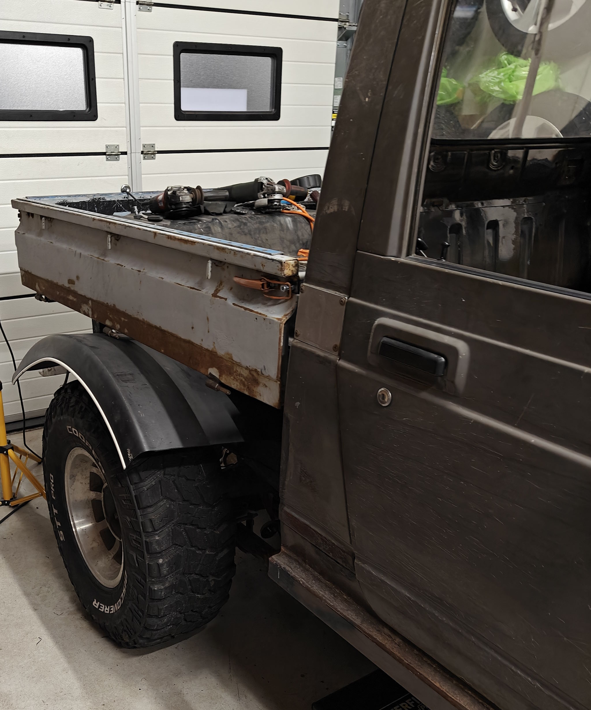

Phase I - Get the motor stack in and run Leaf battery on the pick up bed (if it fits). The idea is to skip motor coupling with transmission and go to TC with a drive shaft. Gearing should be ok
As this will be a road use car, I'll need to add a heater. Suzuki didn't make the heater core too big, so instead of shoehorning a PTC in place of it, I'm thinking about solving heater topic with a Volkswagen heater. I was looking at them from a online wrecker and they don't seem to cost a dick and an arm. This probably needs another coolant circulation pump?
I've already converted the retrofit powersteering to electrohydraulic, so brakes would be next. Vacuum pump should do the job.
It should be a first drive at the end of Phase I.
Also MOT at the end of Phase I

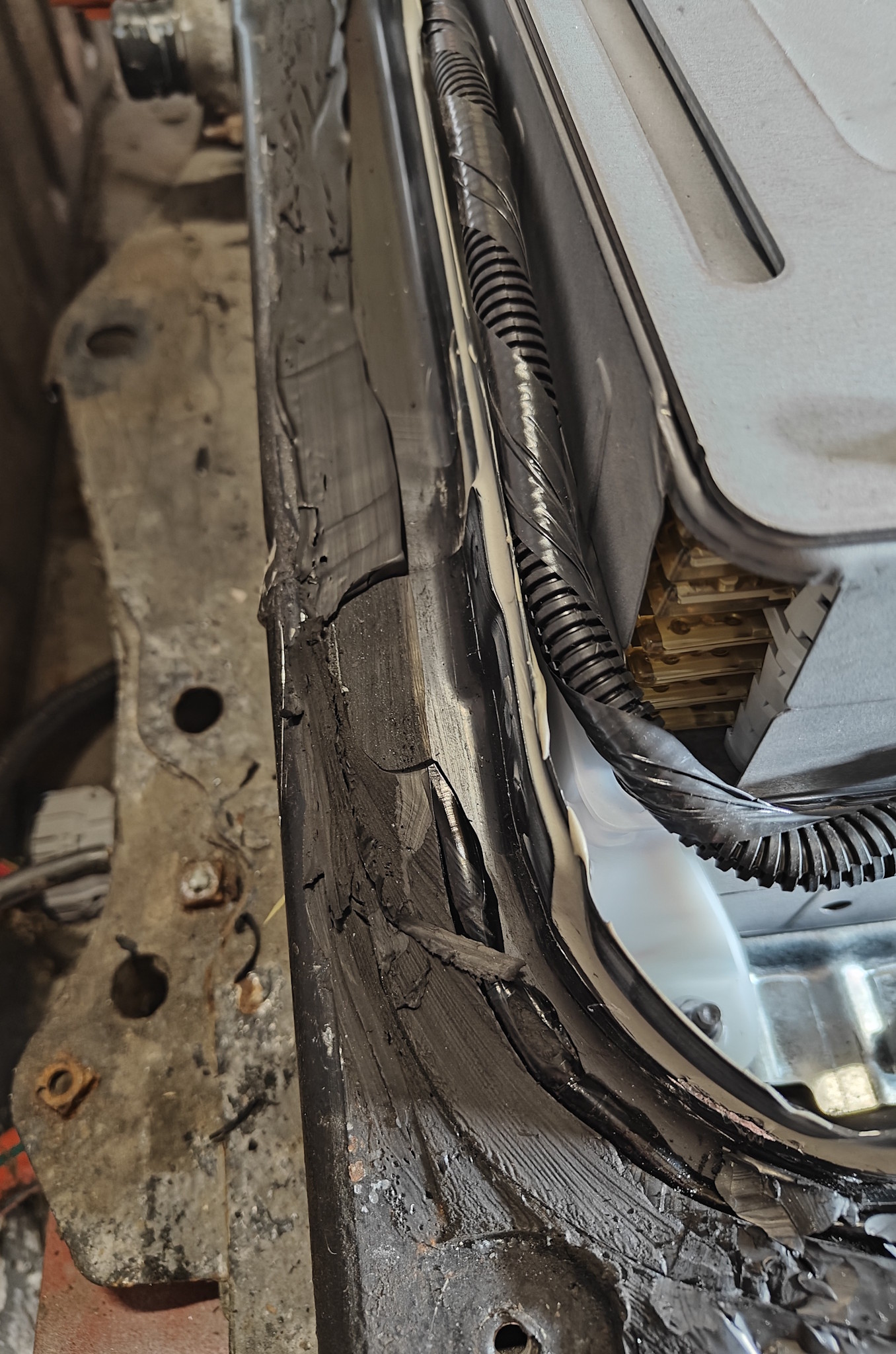

Phase II - Repack the battery so it can be squeezed lower, between the frame rails and majority of the mass in front of the rear axle to better weight distribution. Cleanup the rats nest of cable job that will definetly emerge along the way. I'll most likely eat my words, but for the time being I don't want to invest in a separate BMS, so Leaf LBC will be used and rewiring ahead.
I can't seem to get my head wrapped around the BMS topic. Why people seem to chose something else over the Leaf LBC even when using Leaf modules?
Inspection / MOT at the end of Phase II
Phase III - The winch --> This is a wild thought for the moment, but once I have 400V on the car, why not upgrade the winch motor from a 12v Amp chomper to something more sensible? A typical winch motor is 2-3Hp, so there should be at least some options for this. Hyundai HSG or something like that? Any Idea what power the electric AC compressor motors make?

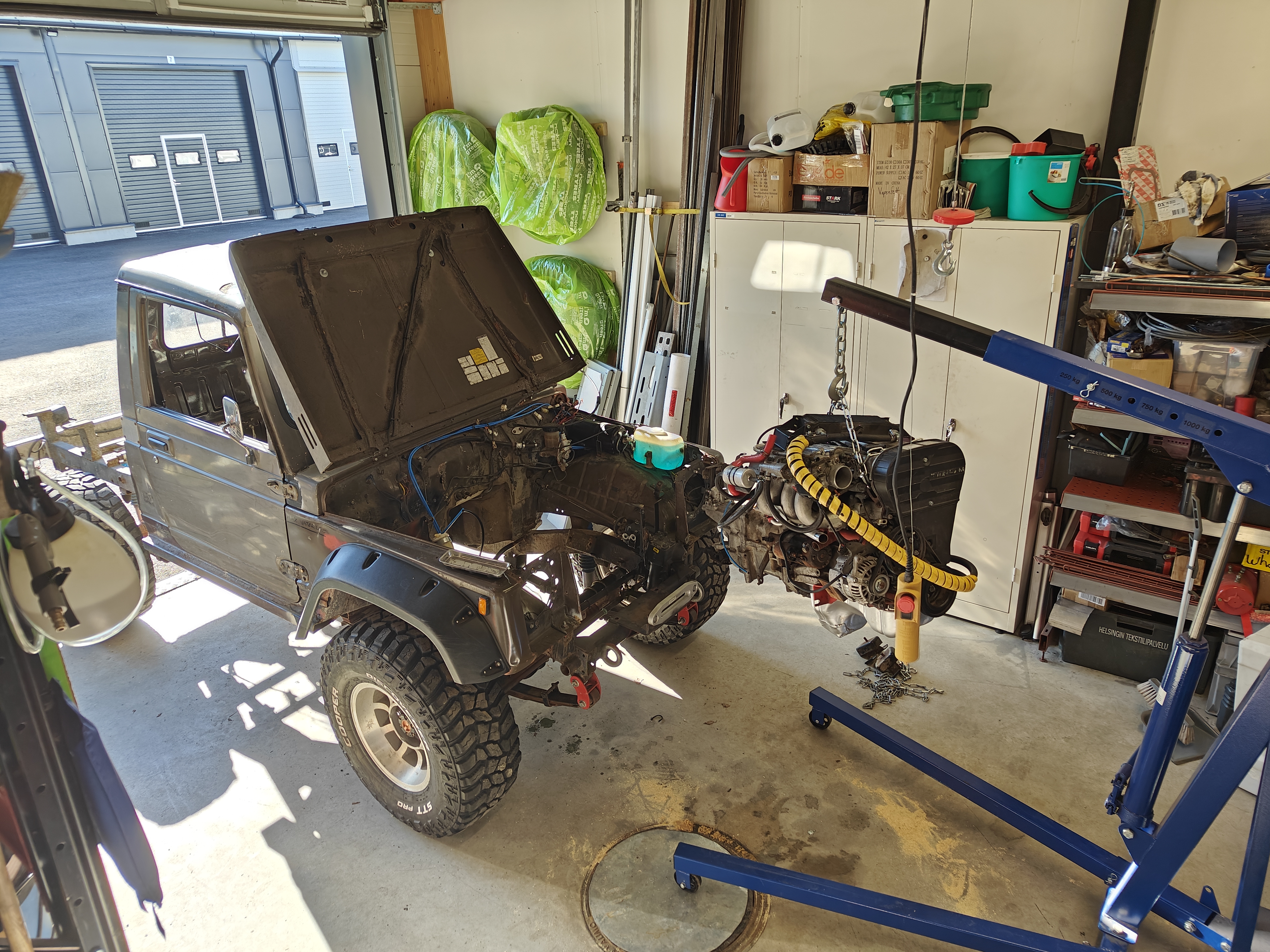

Next on the list would be yanking all the ICE stuff out and get on with building.
I've ordered a full Leaf drive stack with a 30kWh battery, they should be arriving during next few weeks.
I'm now in the controller lookout phase.

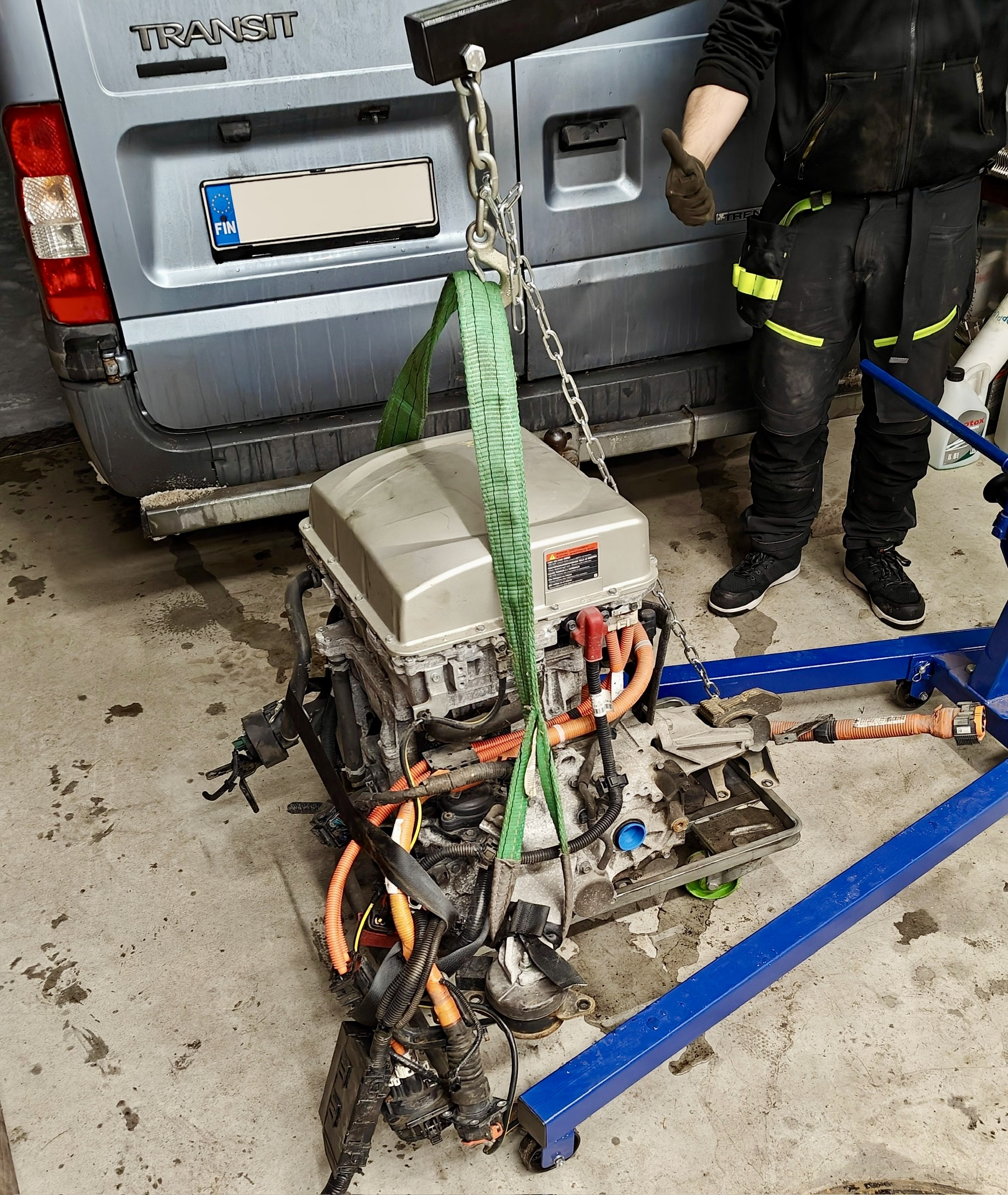

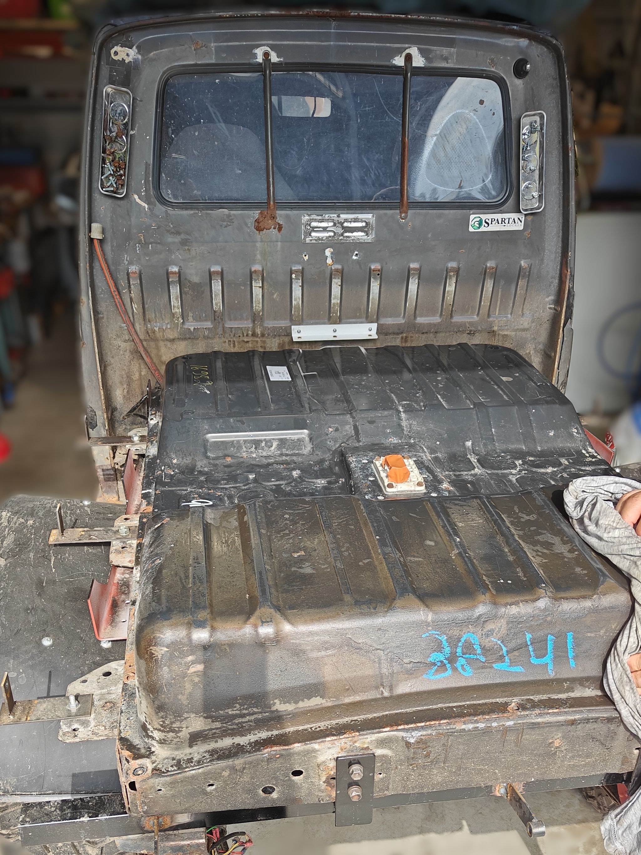

Some goodies came in yesterday!
Got the motor stack and battery in the shop now.
Looks like I got most of what I is needed. The heater? cable/connector seems to be the only thing missing. Anyone have a part number for this cable so I can find this easier online?

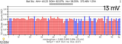

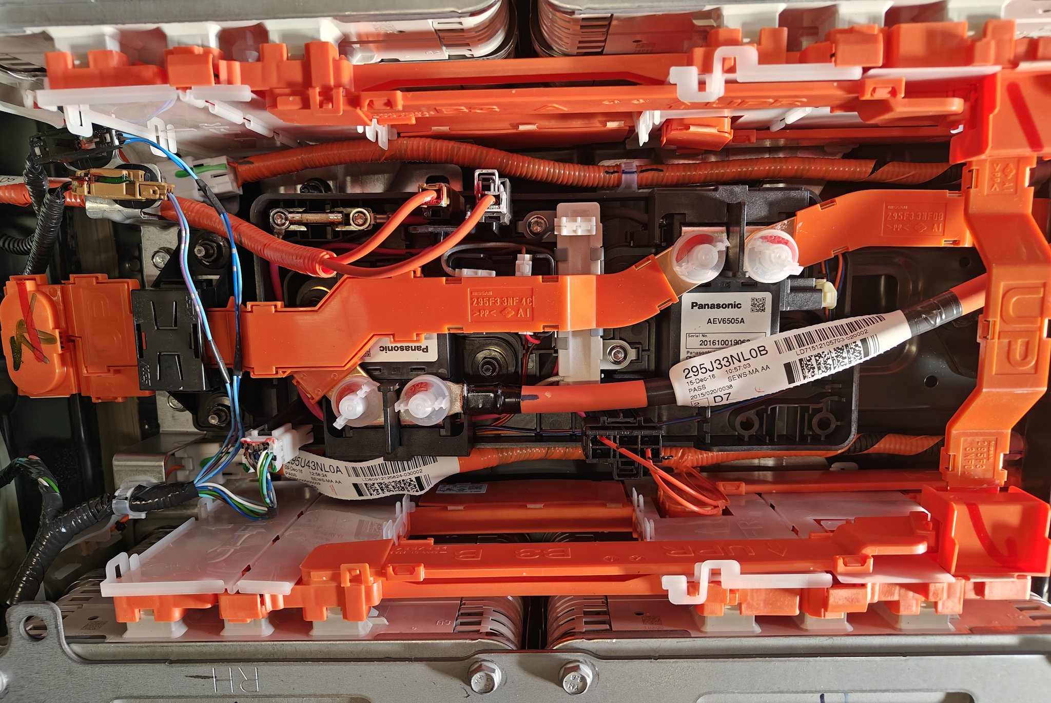

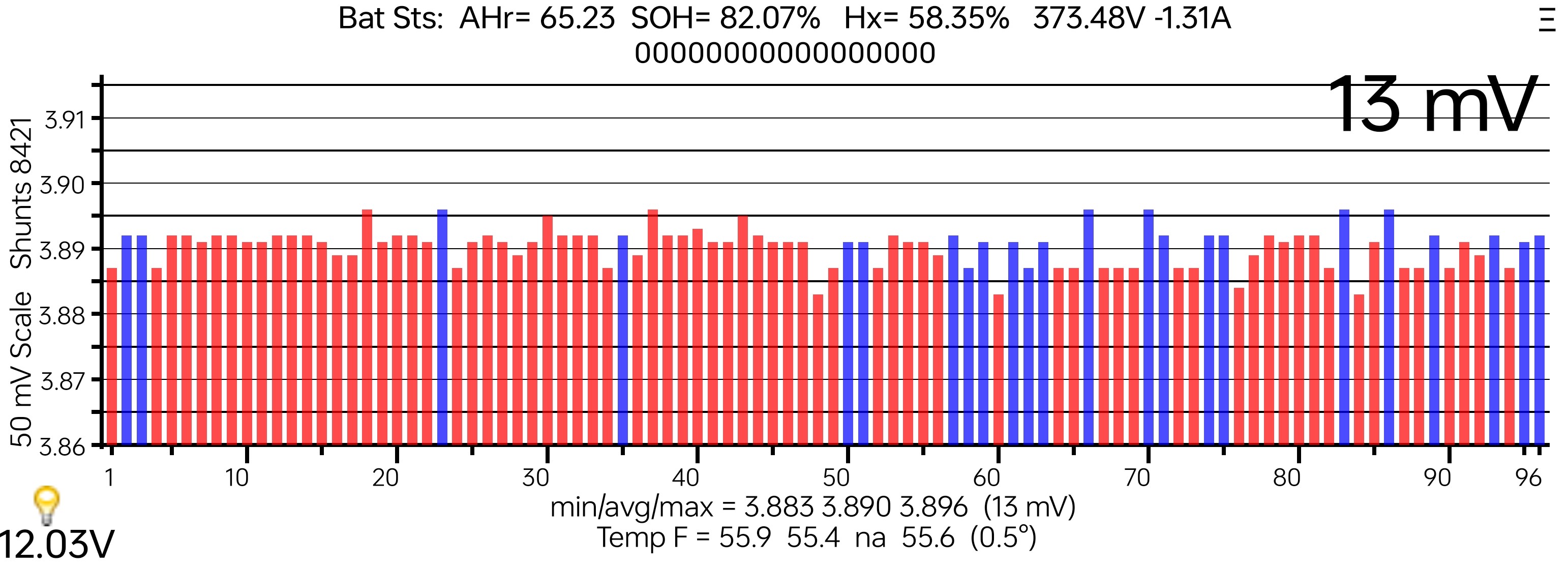

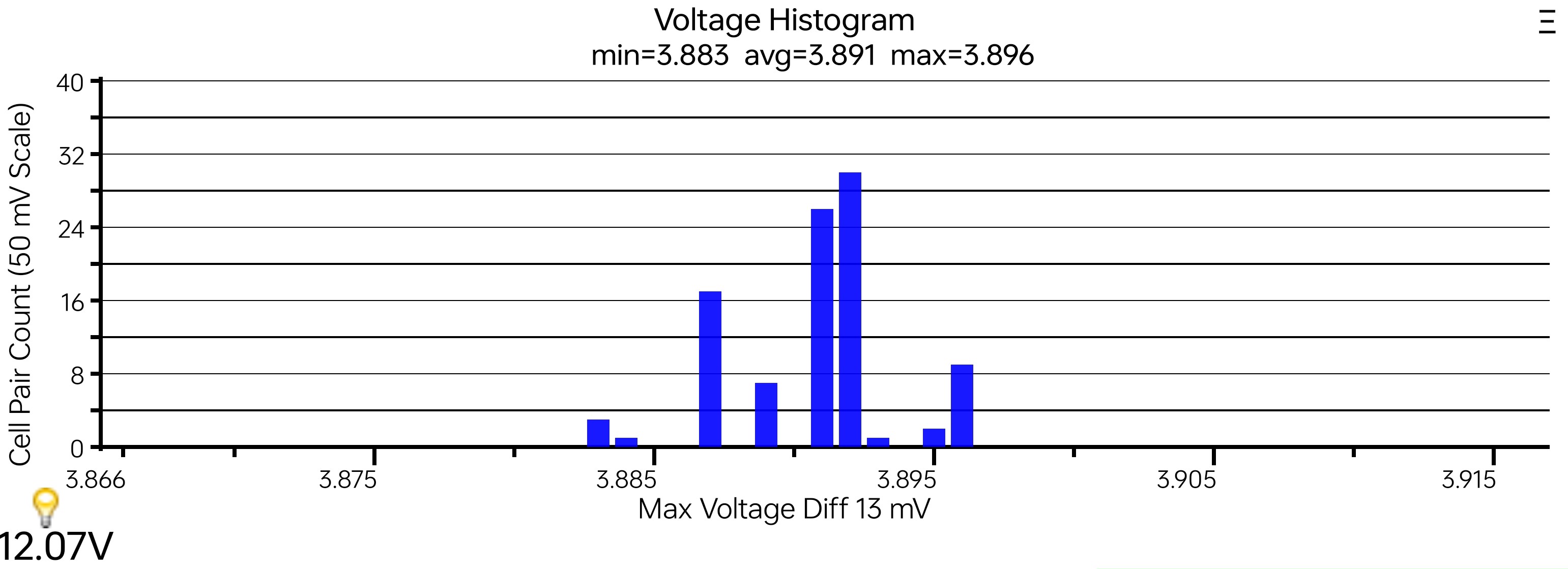

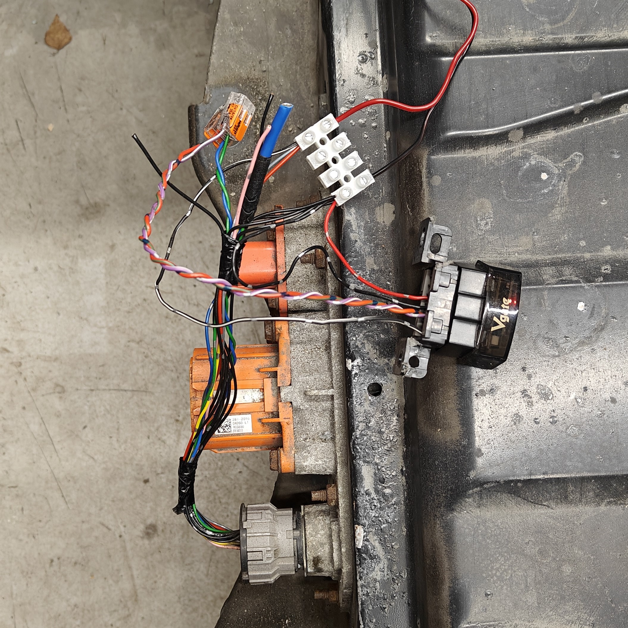

I used the good info by Dala to make a rats nest of a battery sniffer to see how the 30kWh battery is doing.
Well, as the Norwegian wreckers pre -dismantle pics showed 11/12 battery soh bars, I was expecting around 80% condition when purchasing this.
I still don't hve a deep enough understanding of the battery side to interpret whether this is in good condition or not, but maybe the community can shine some light on how to make sense of the Leaf Spy data :)
The leaf SM on battery says on the battery part that a maximum cell voltage ±33mV. I suppose that this 13mV seen in the LeafSpy schreenshots means that battery is good.

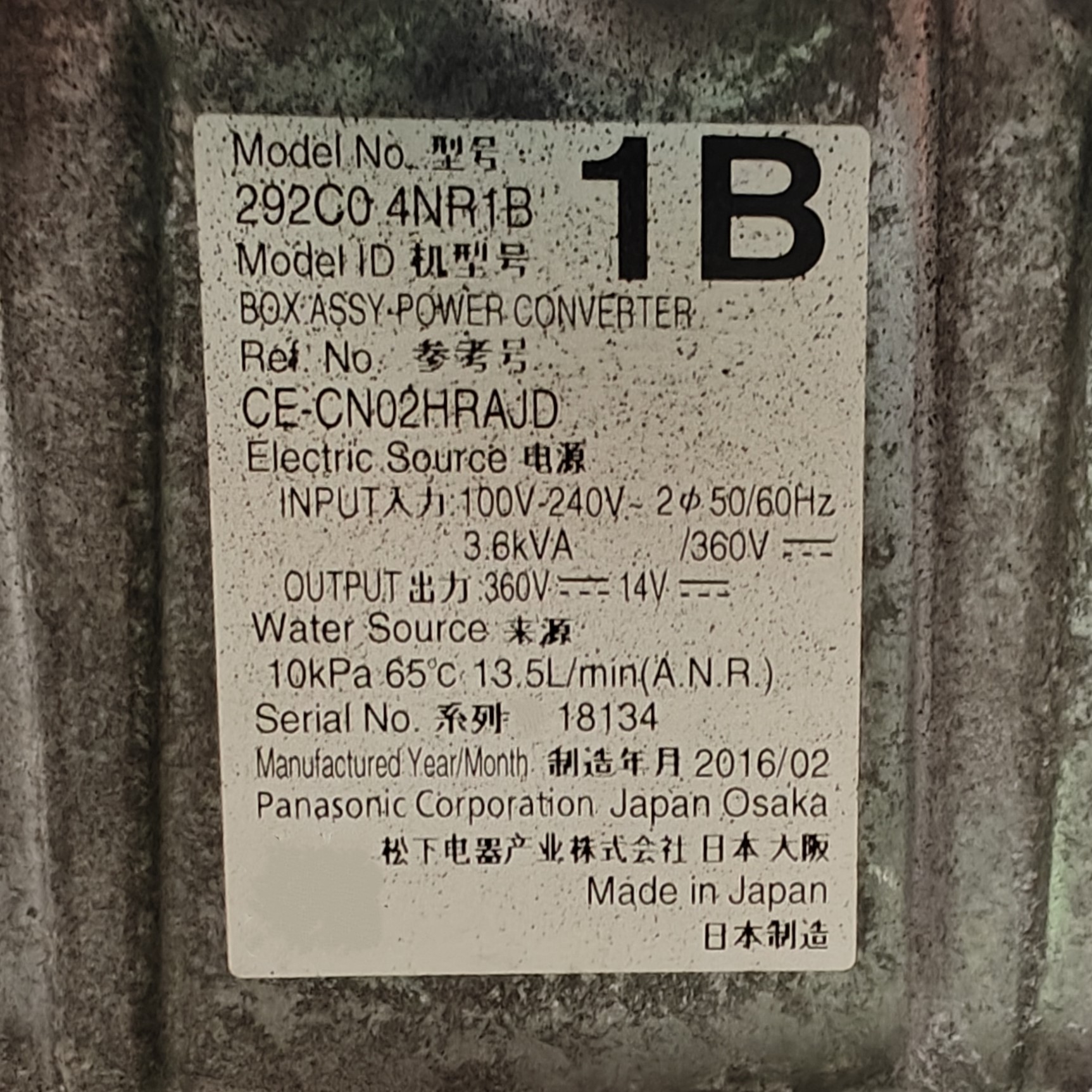

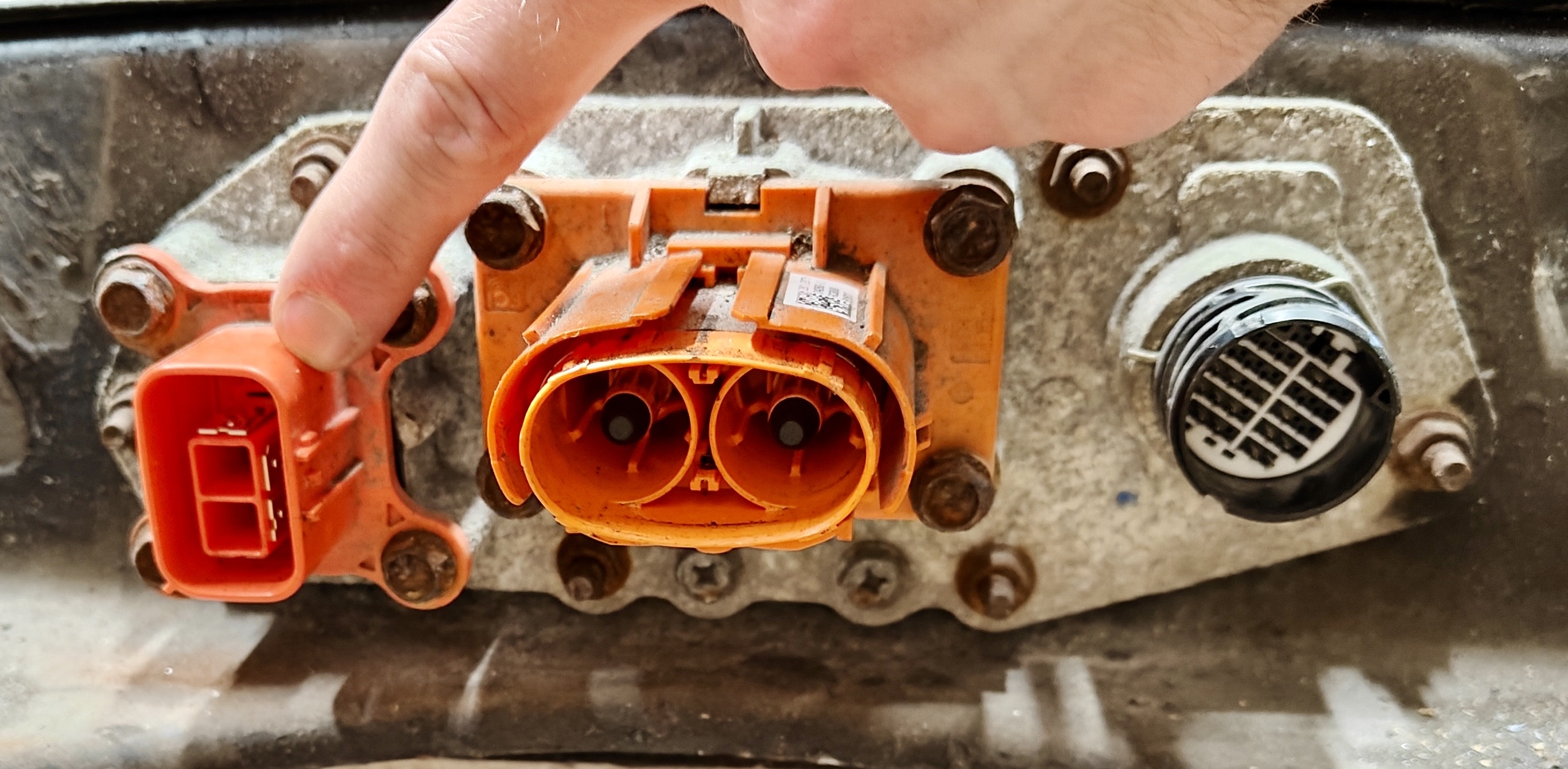

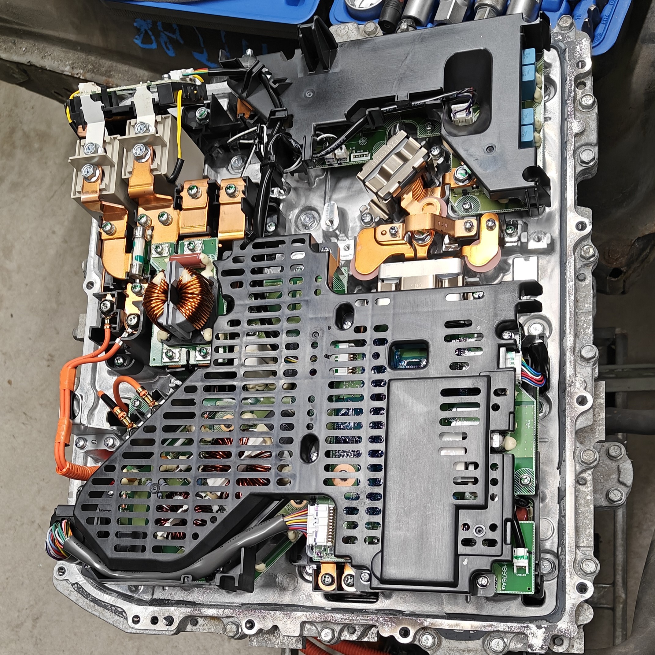

Looks like I didn't win in the PDM bingo and got a 3,6kW charger. Well, shouldn't be a too big of a bummer as this is a single phase charger and I'll be charging this with a 10A schuko plug charger anyways for most of the time.

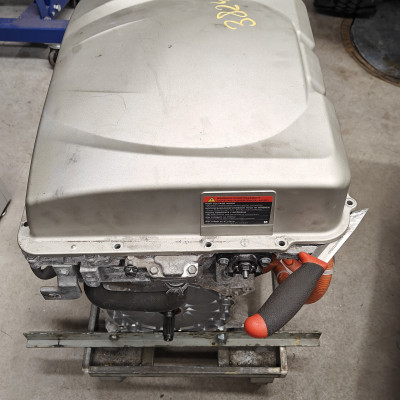

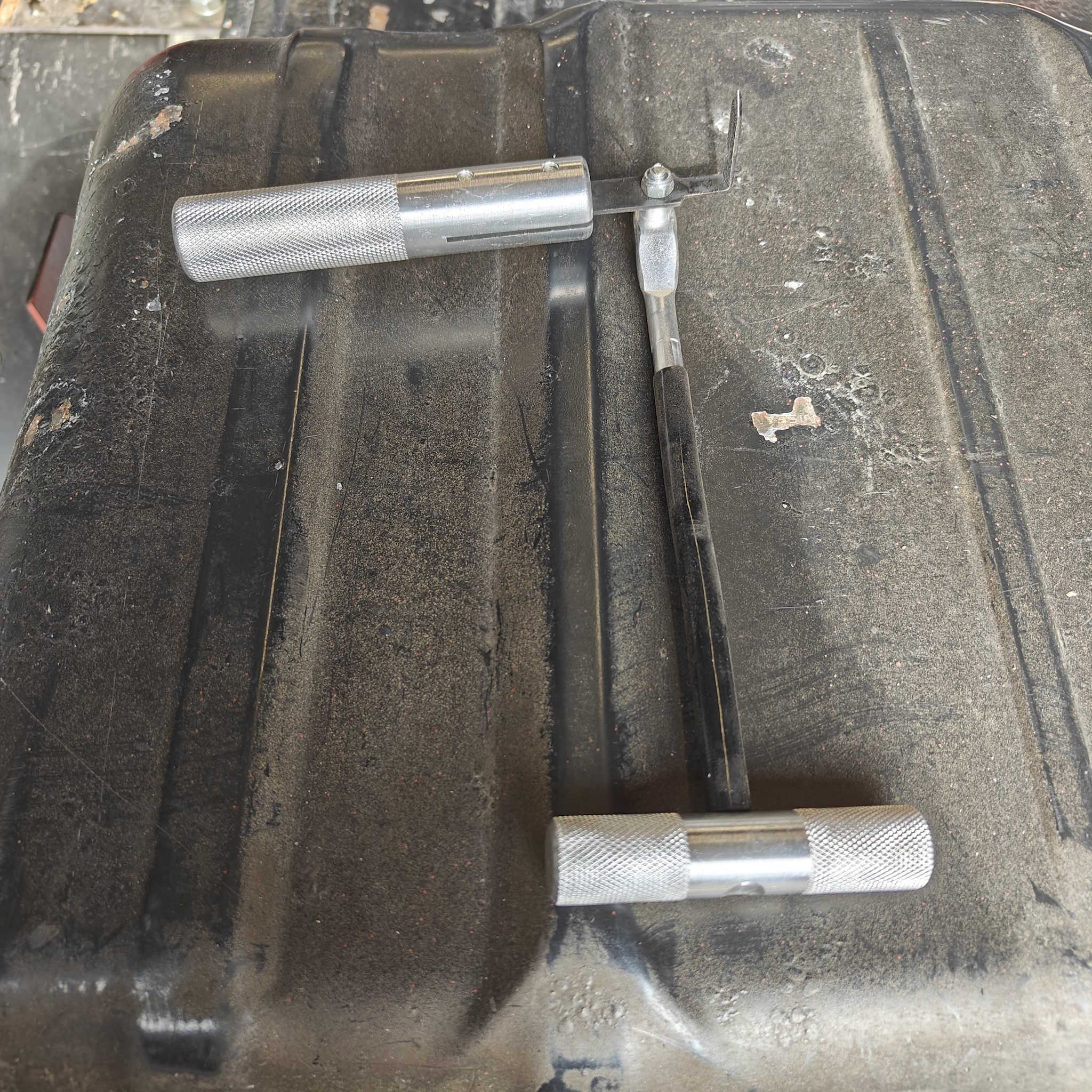

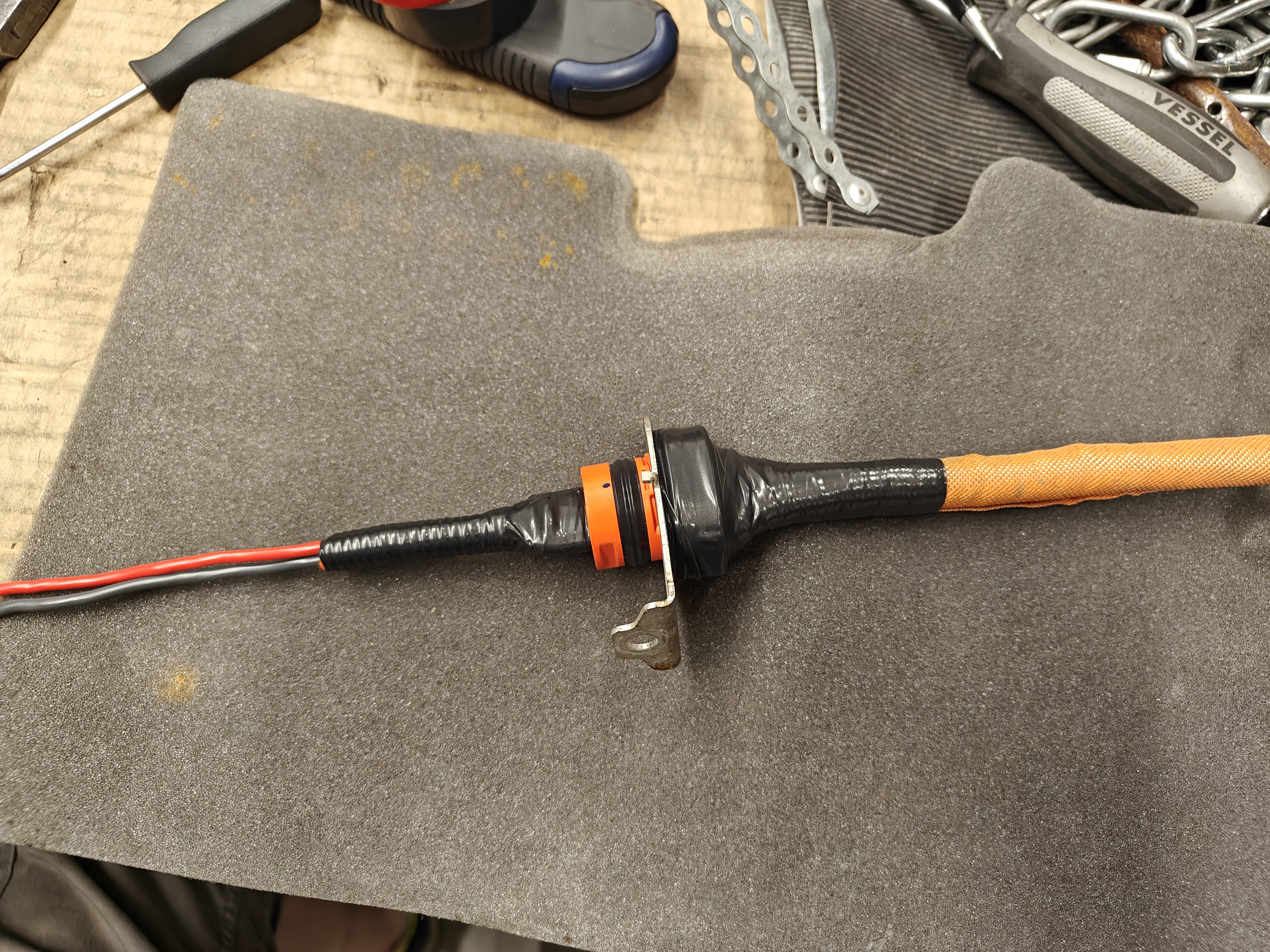

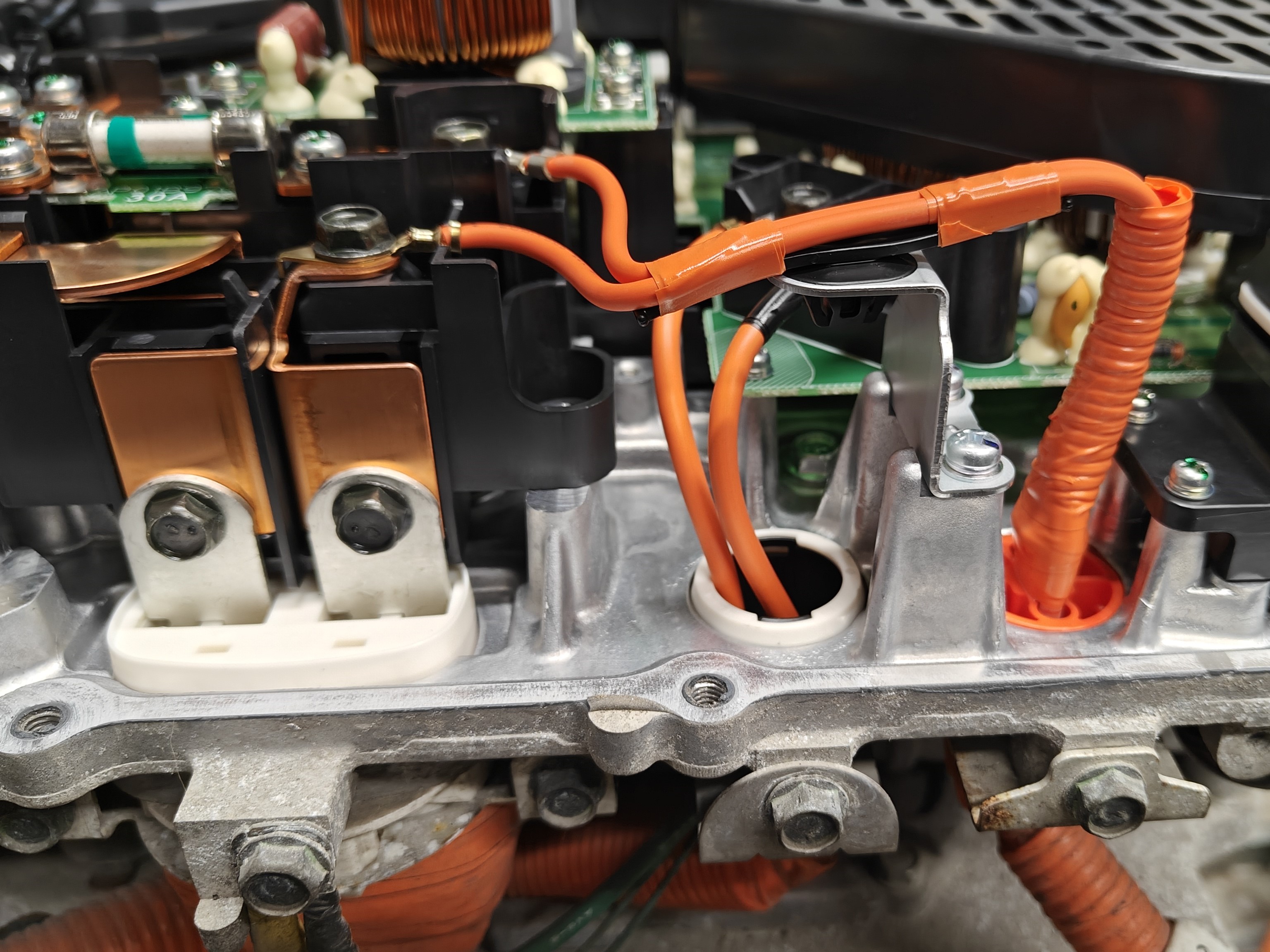

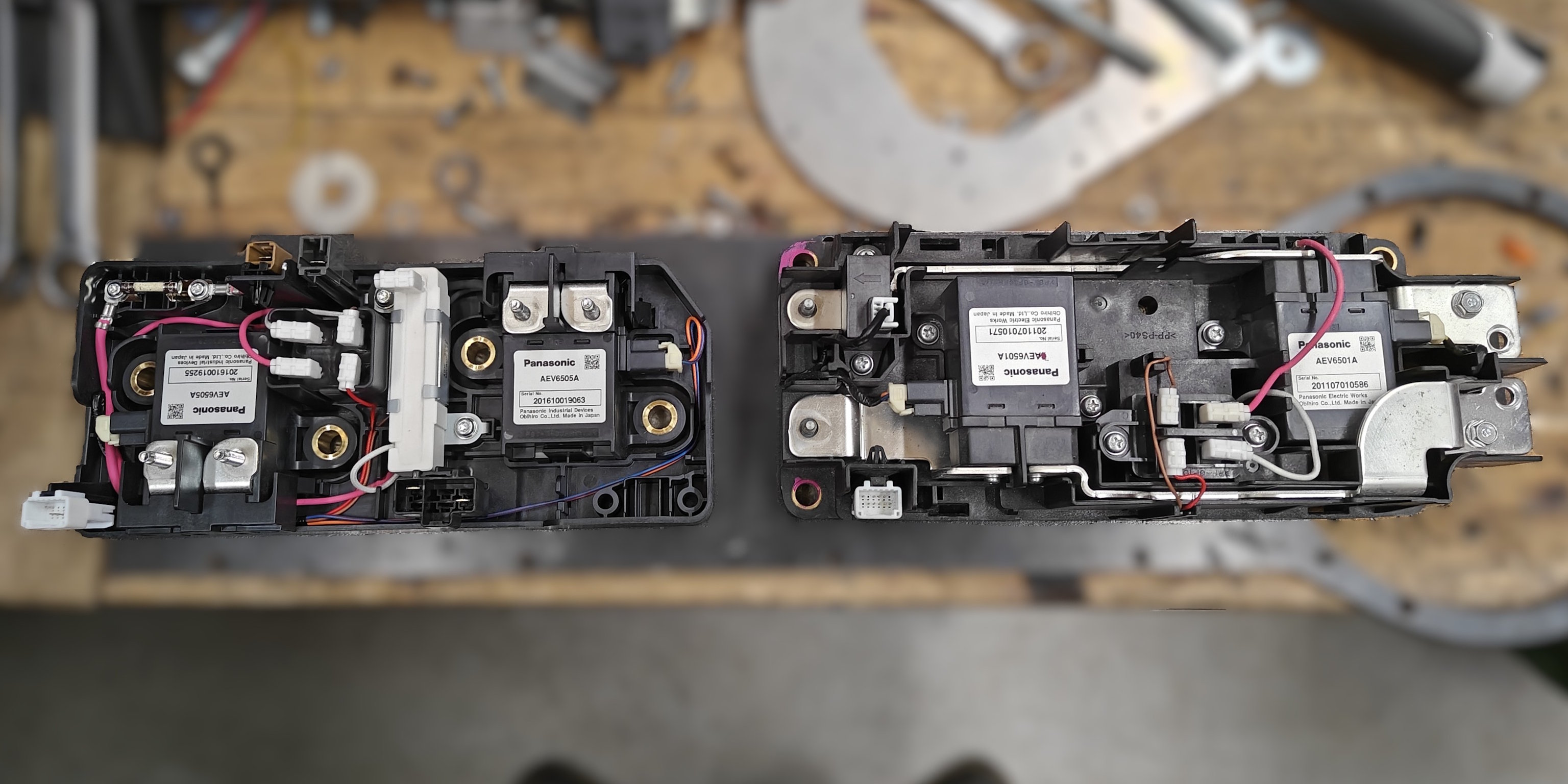

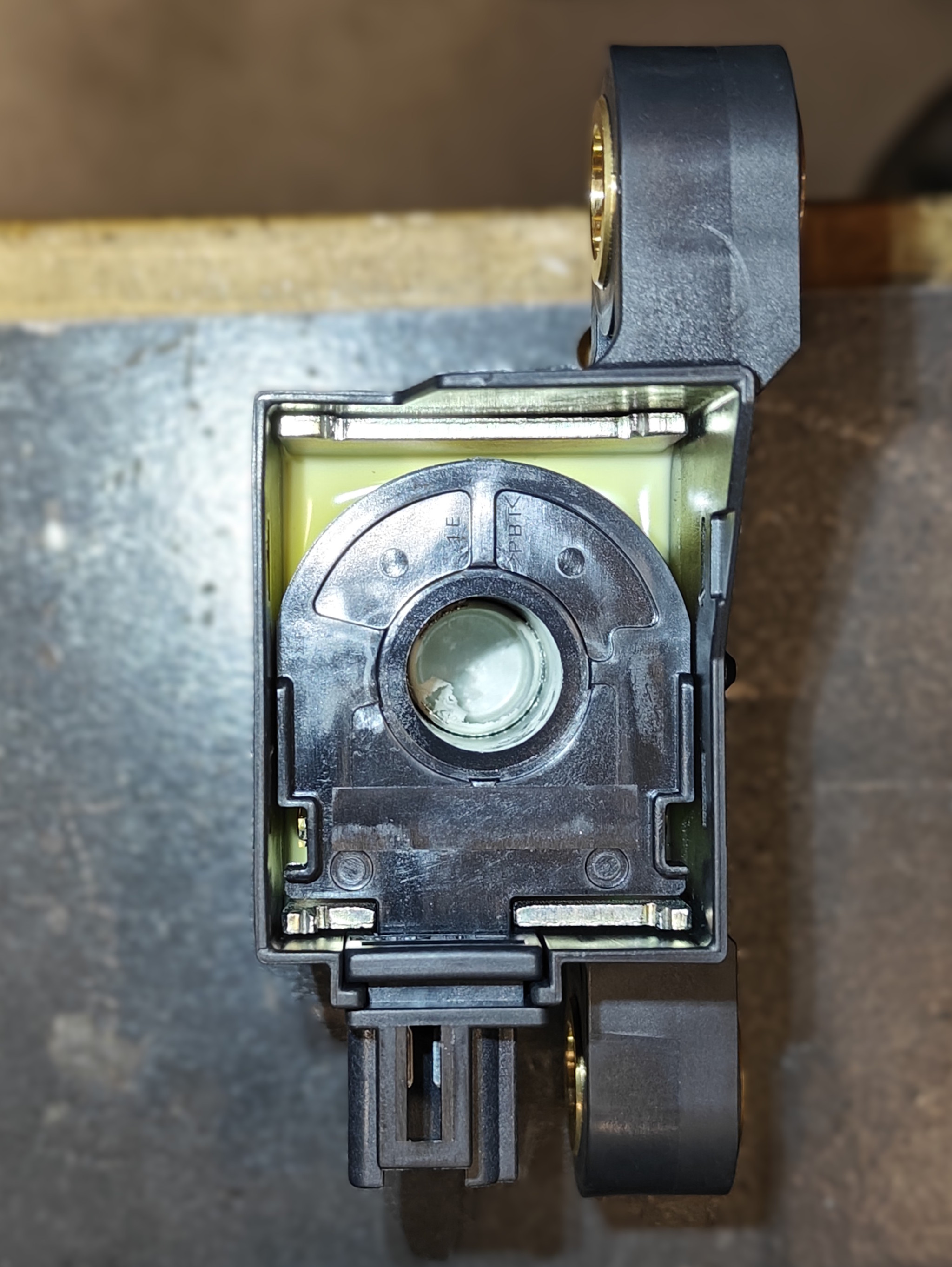

I cracked open the PDM to remove the AC comp cable. A nice tool to use in the opening is a cheap knife
Later I read from the Leaf SM that you shouldn't use a metal tool to scrape the sealant as it can (will) cause shavings that can enter the PDM :o

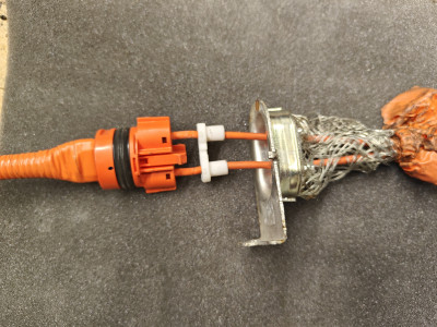

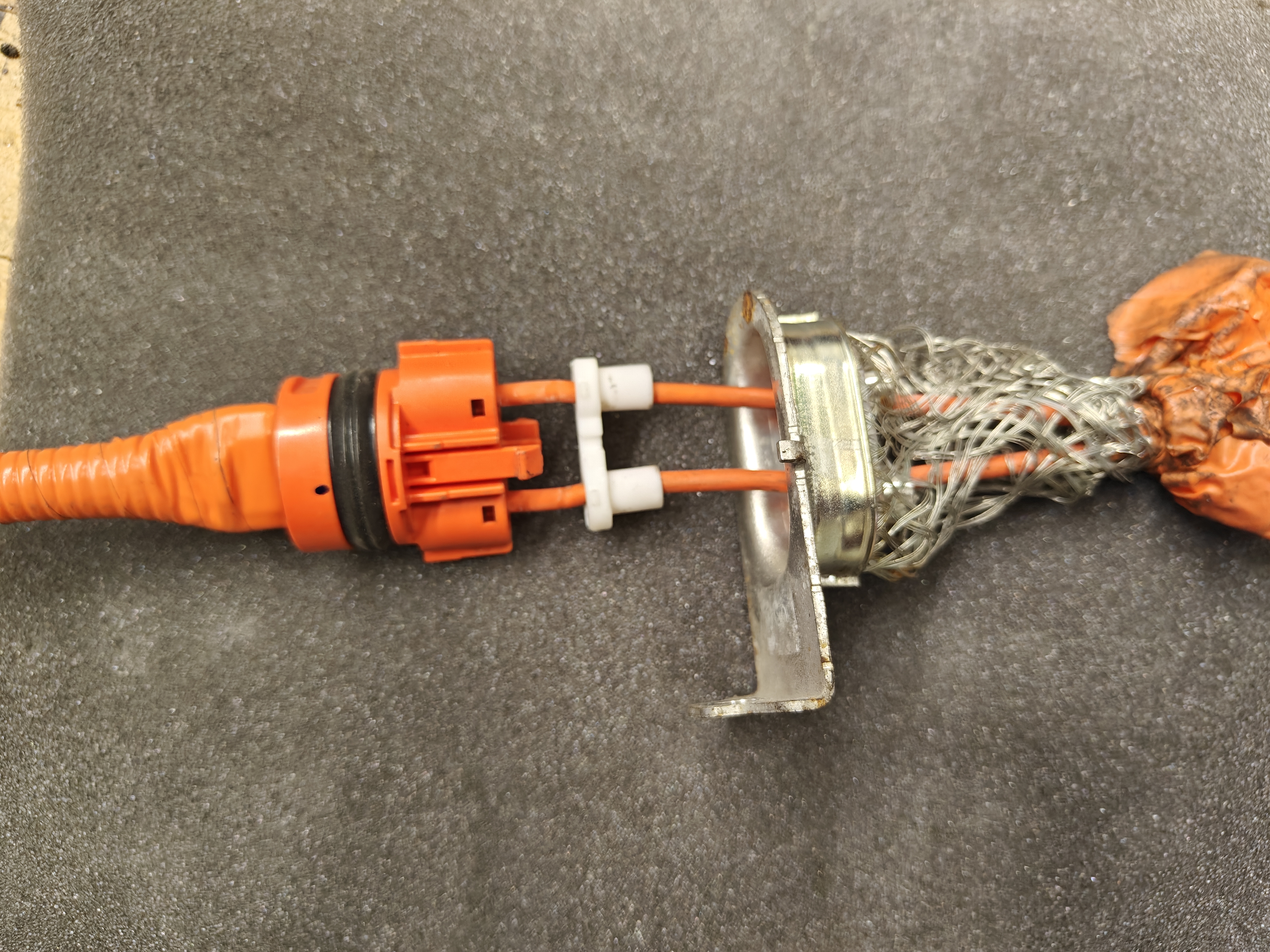

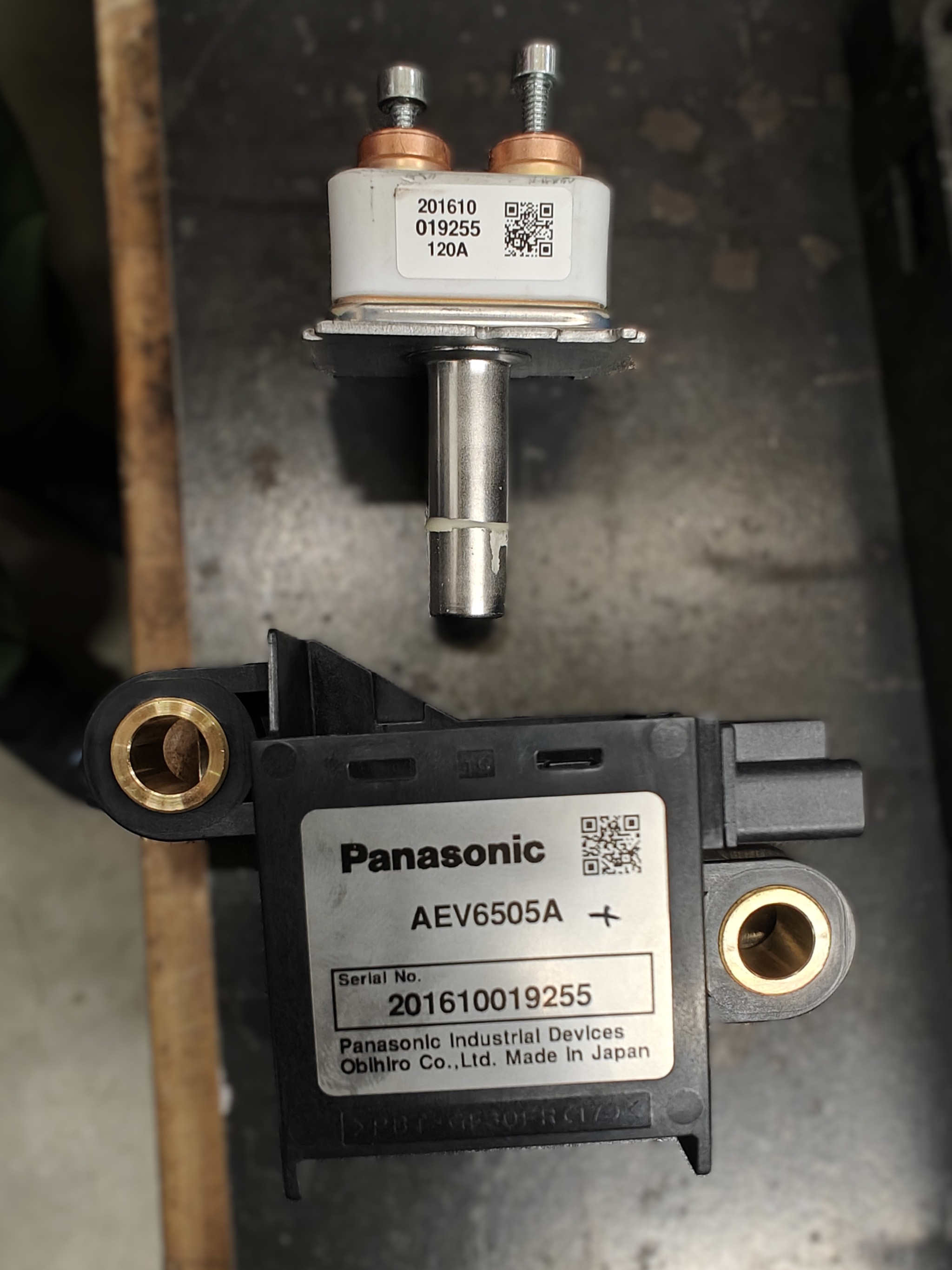

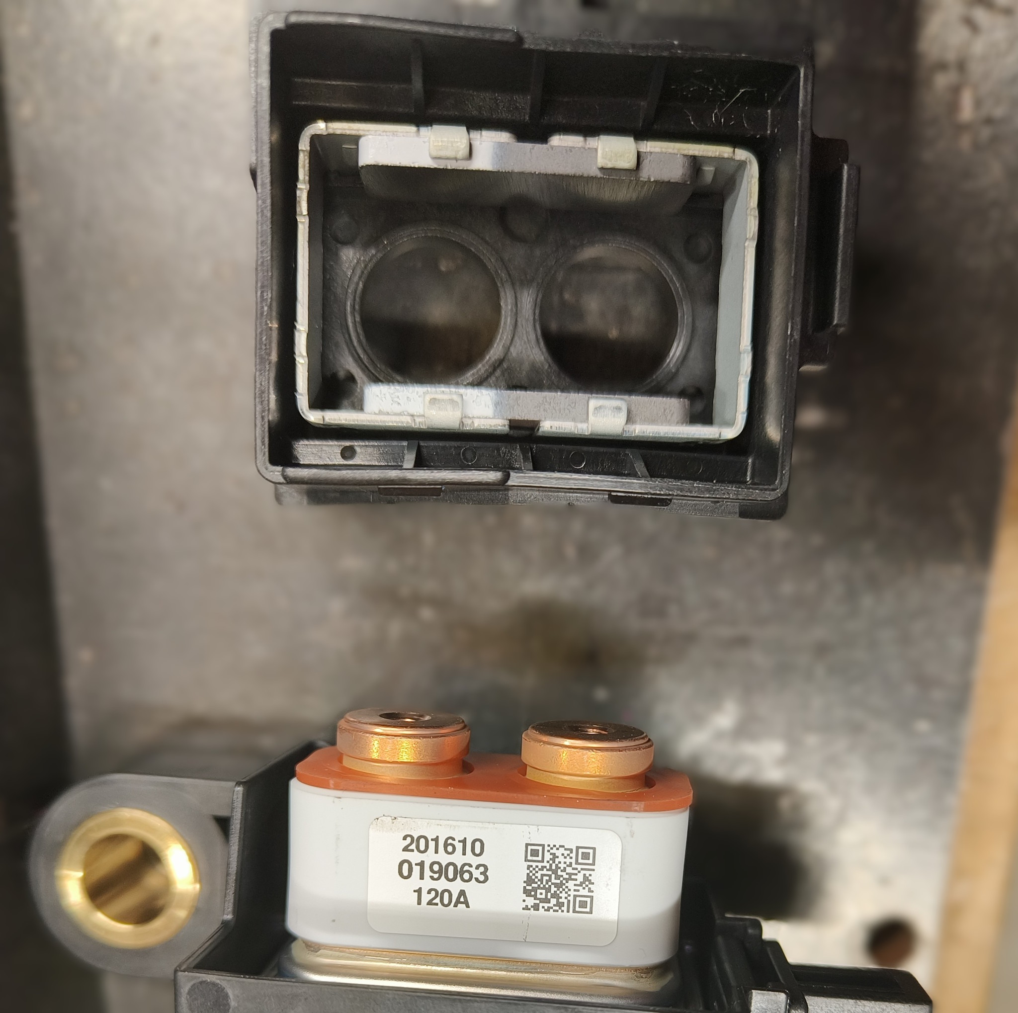

AC compressor cable attaches to the battery input bus bars and there is a 30A fuse (400V), I wonder if there is anything limiting the max current which can be drawn here? See thoughts for phase 3 of this project ;)

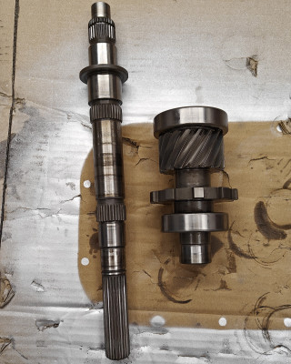

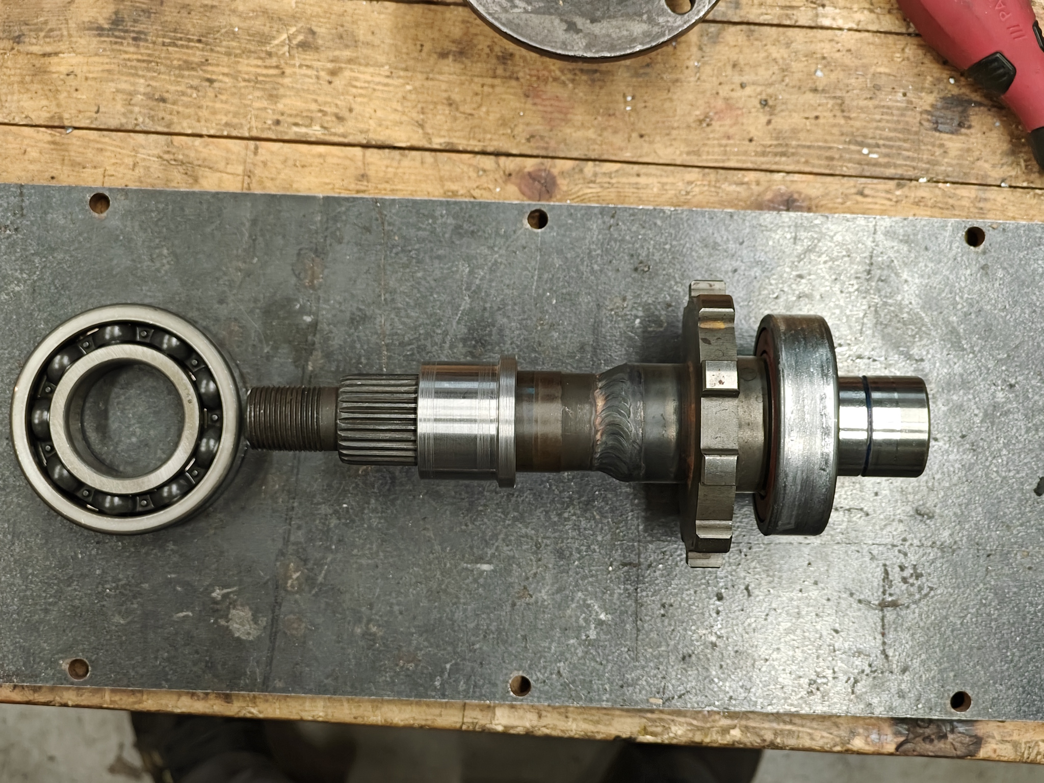

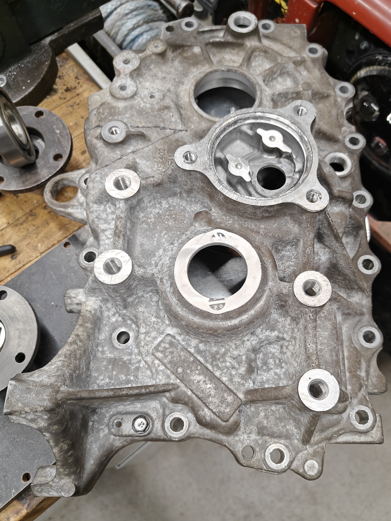

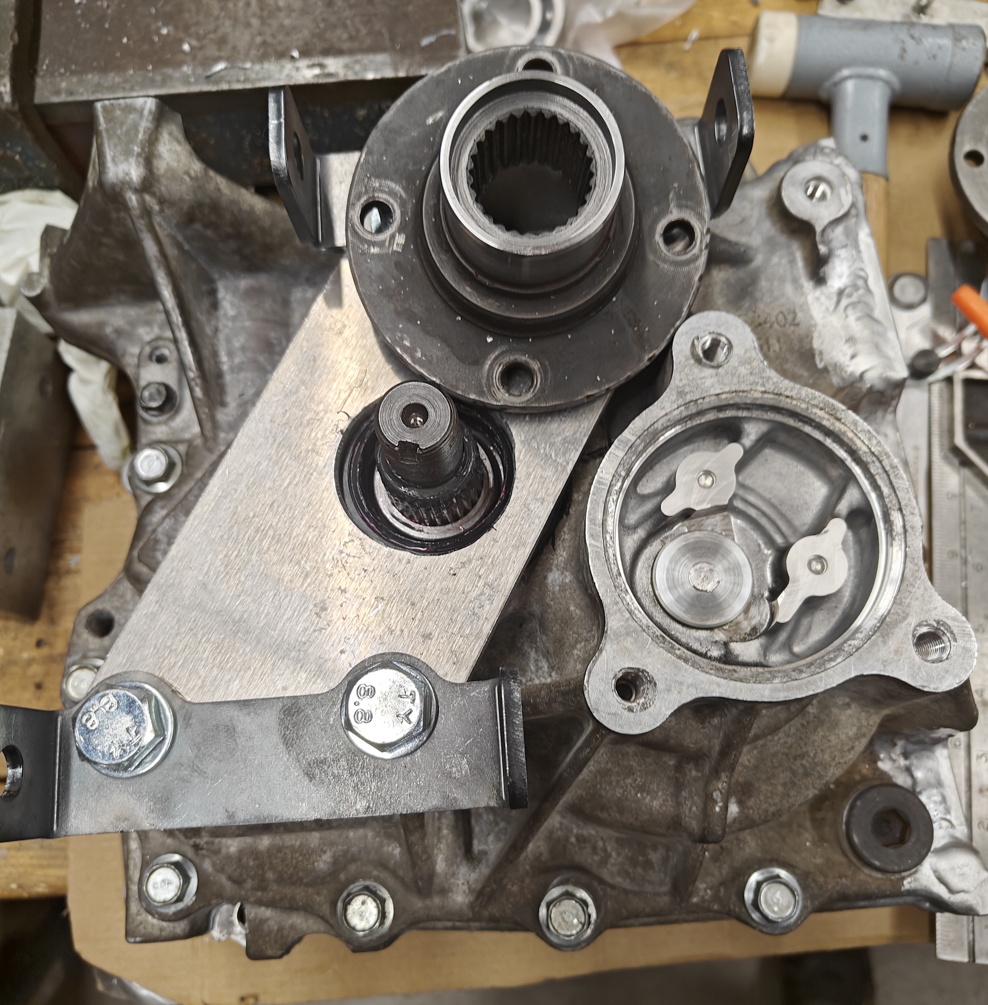

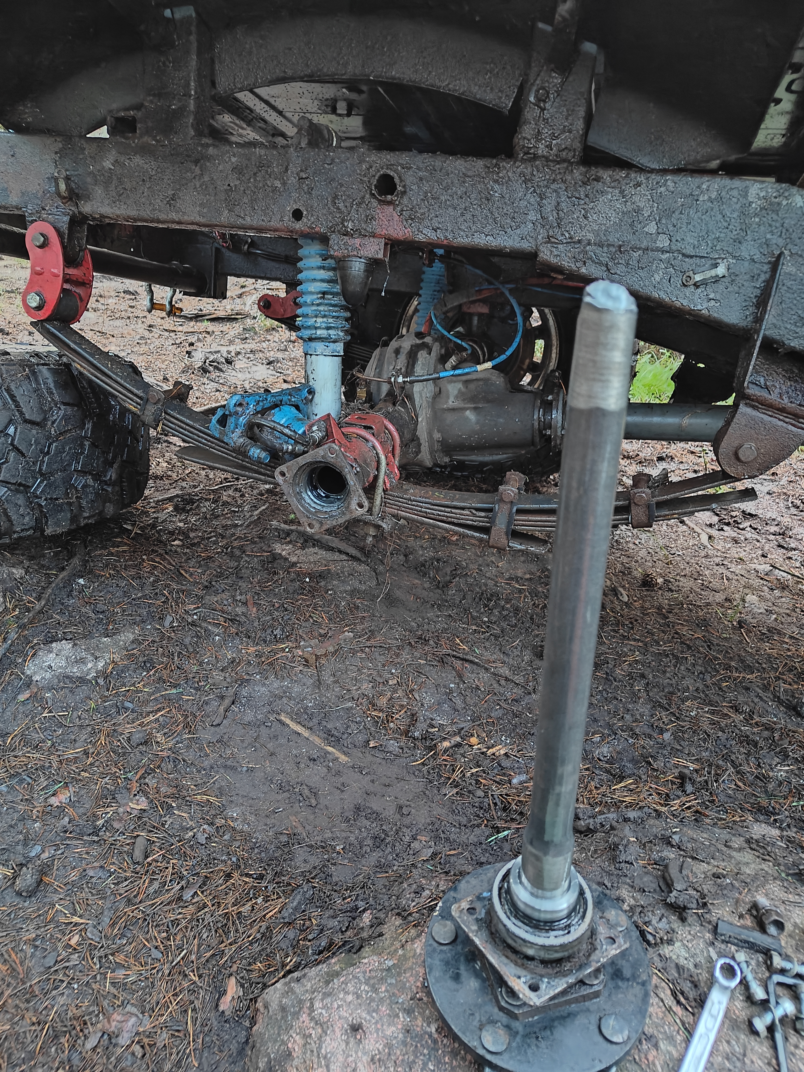

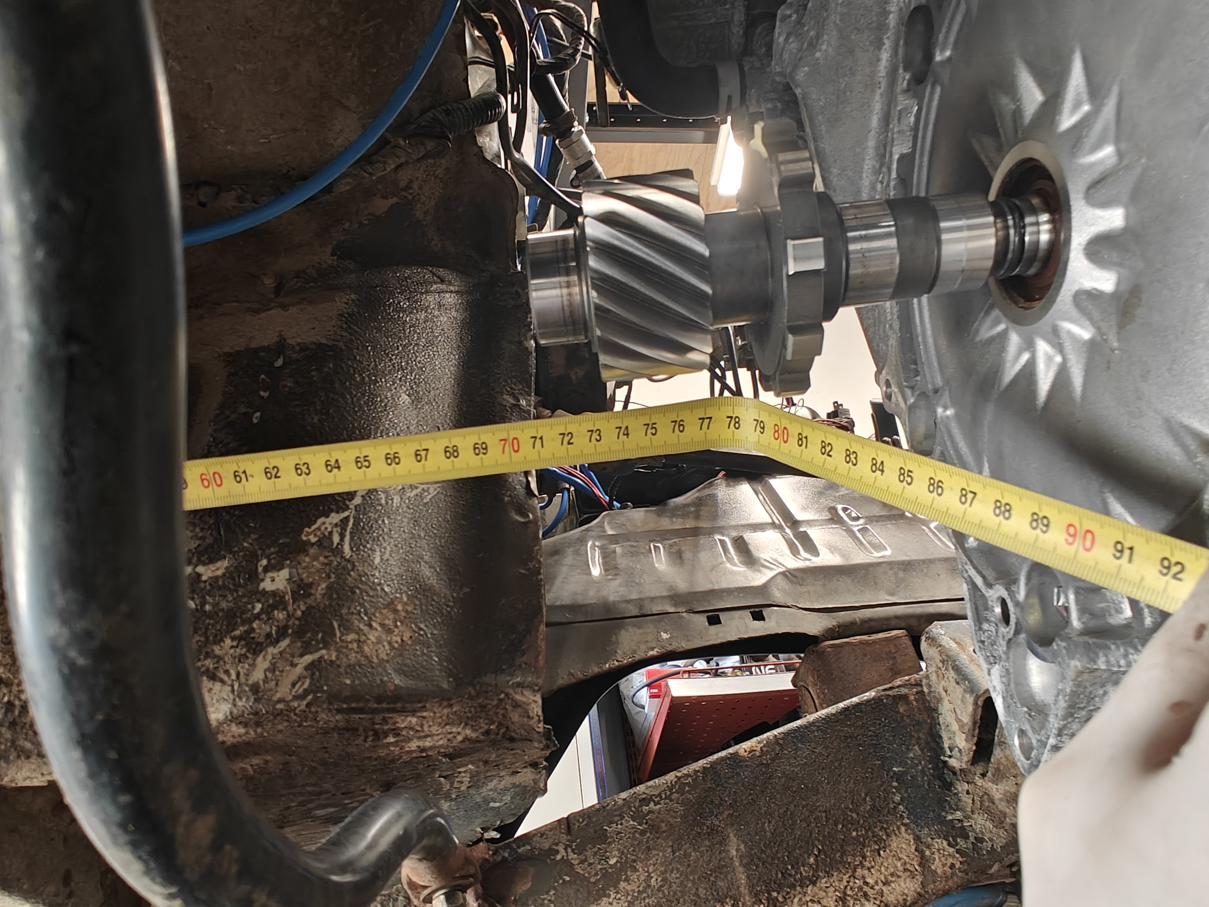

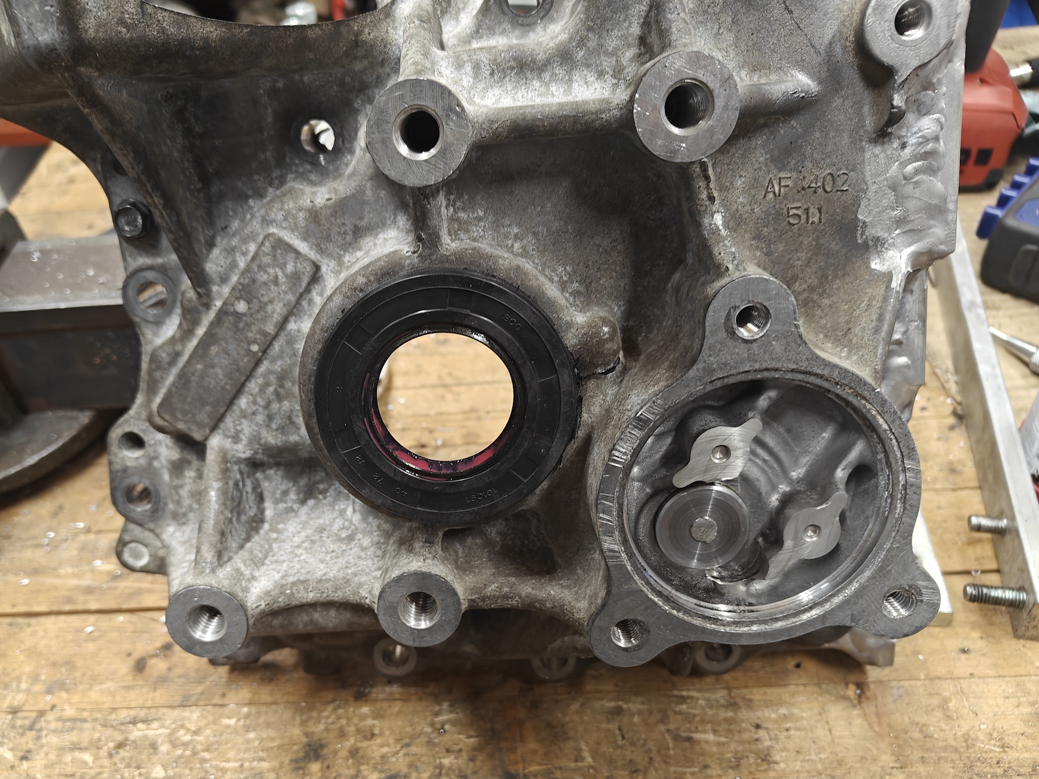

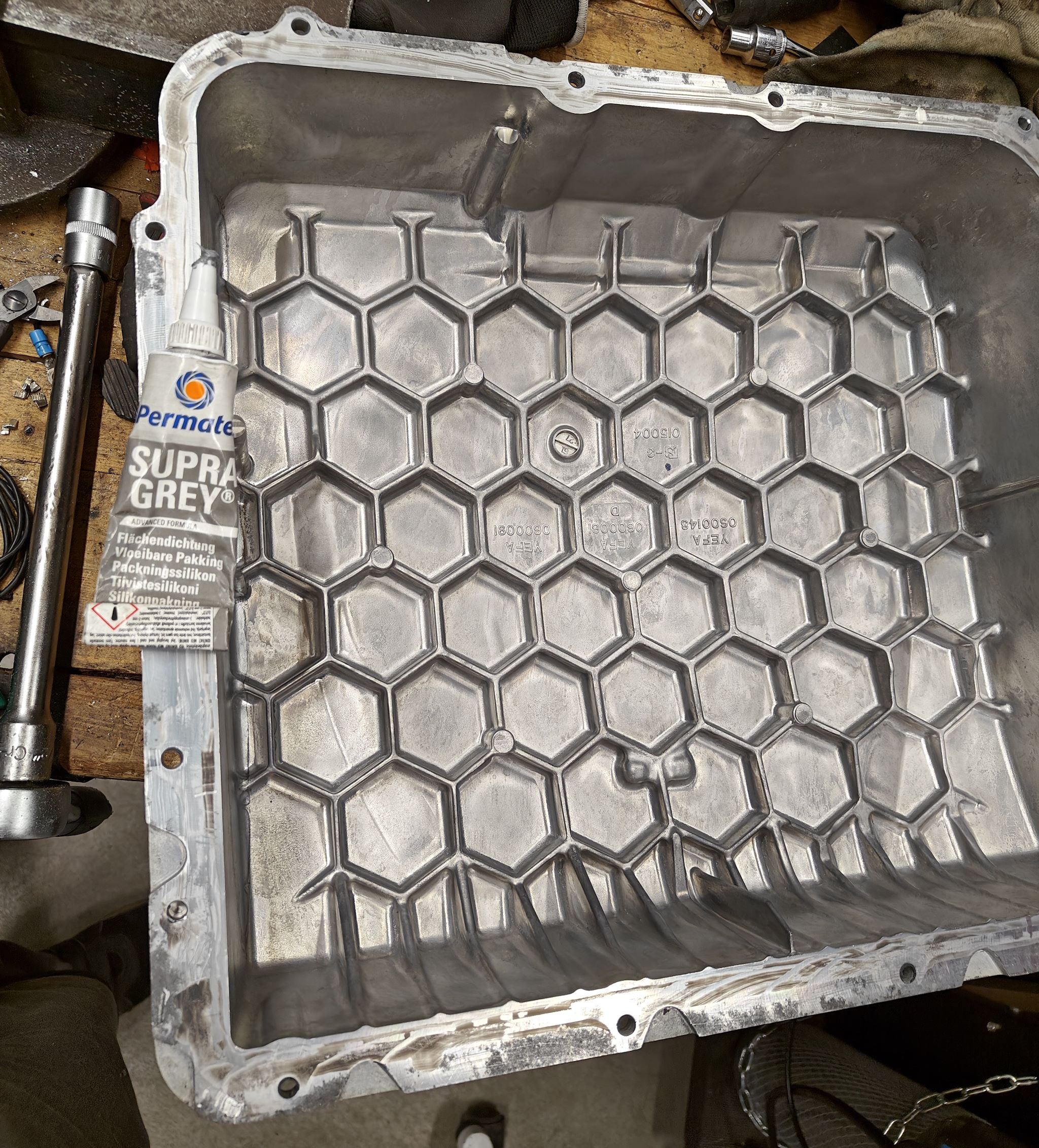

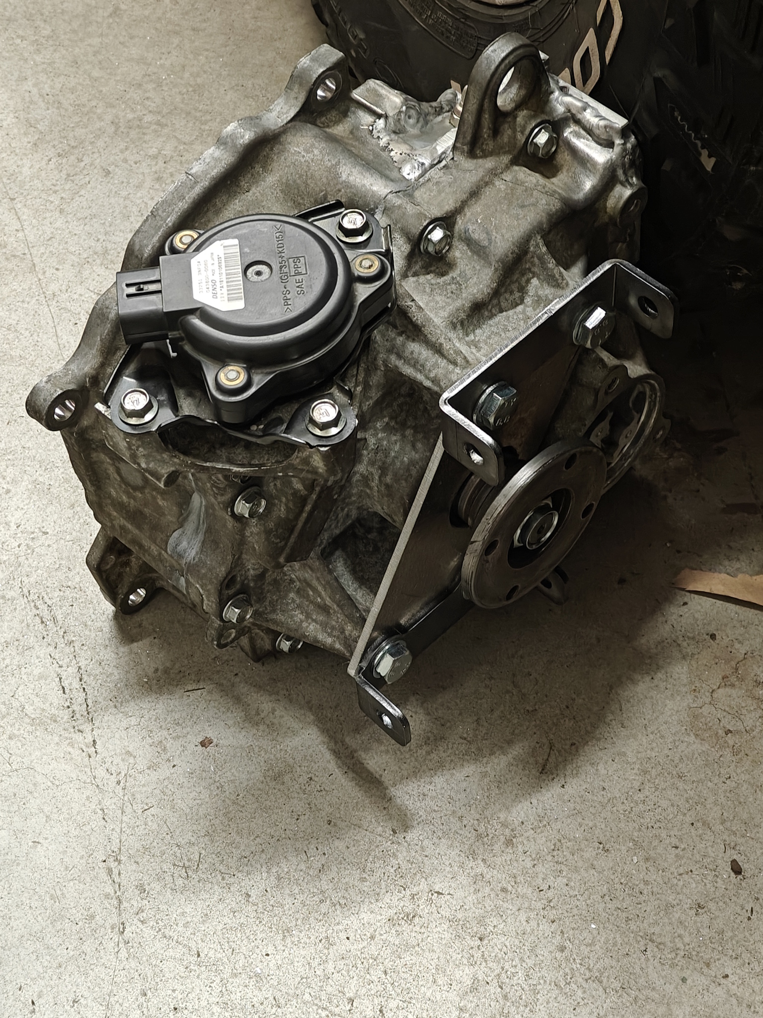

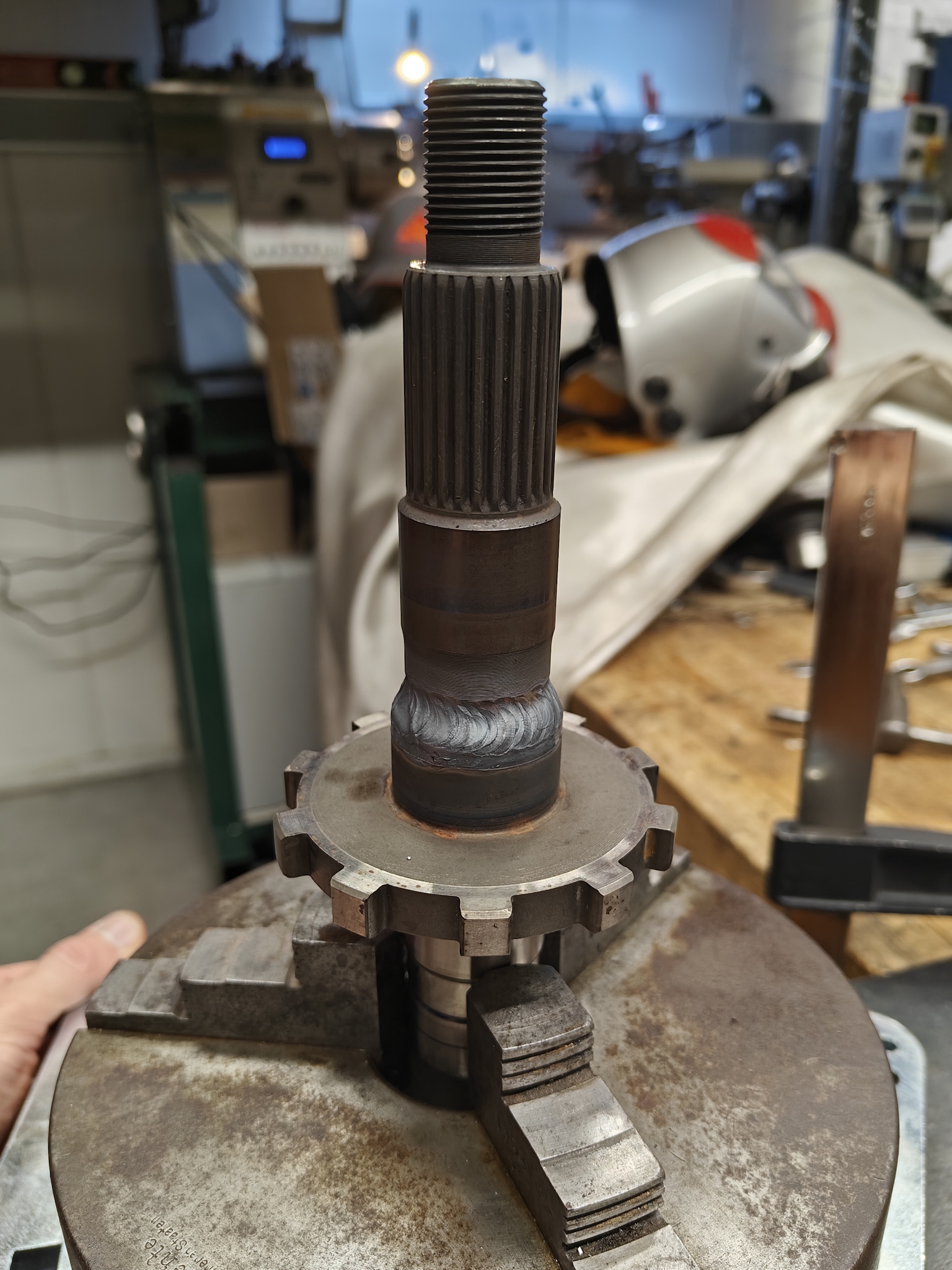

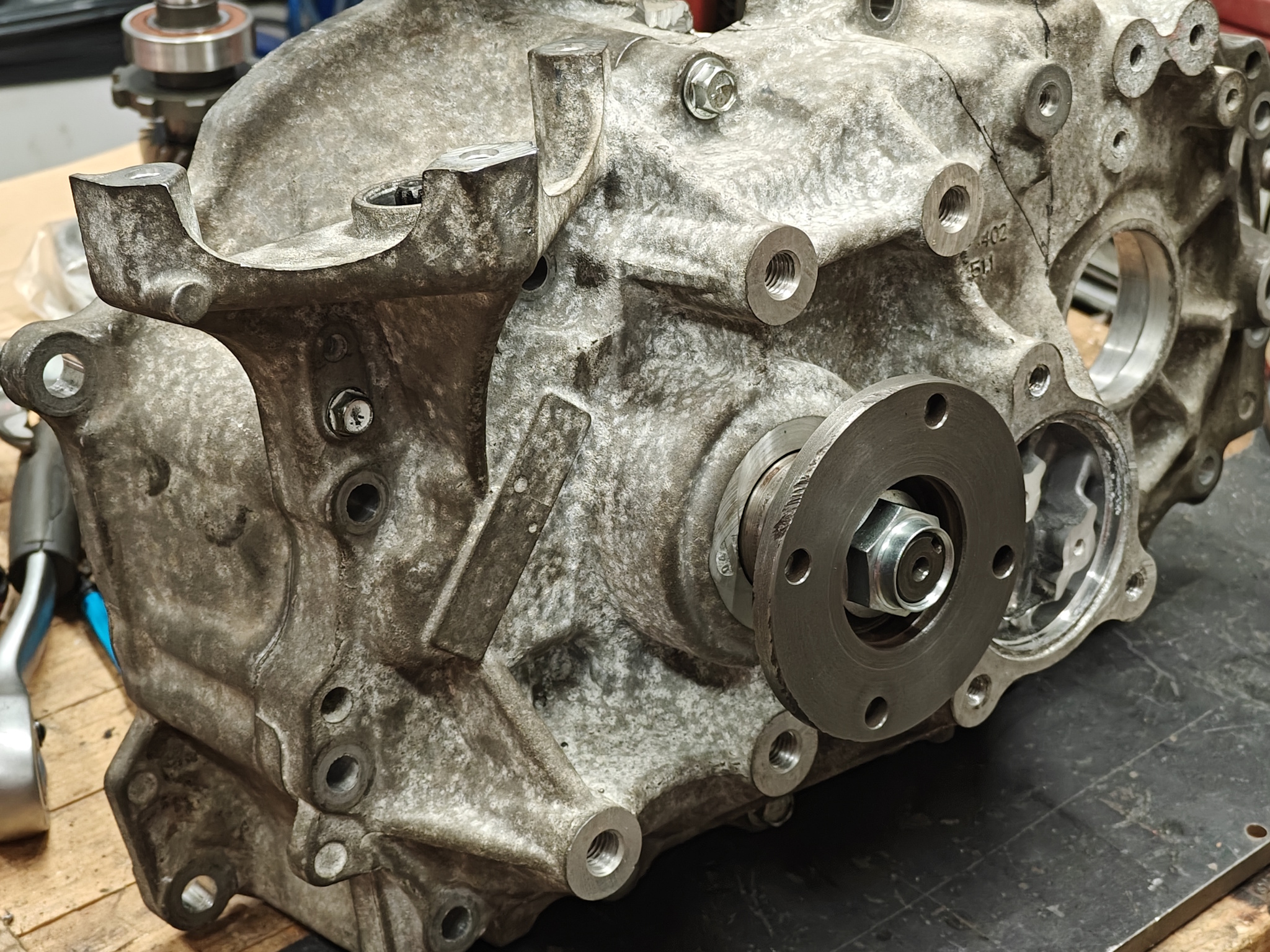

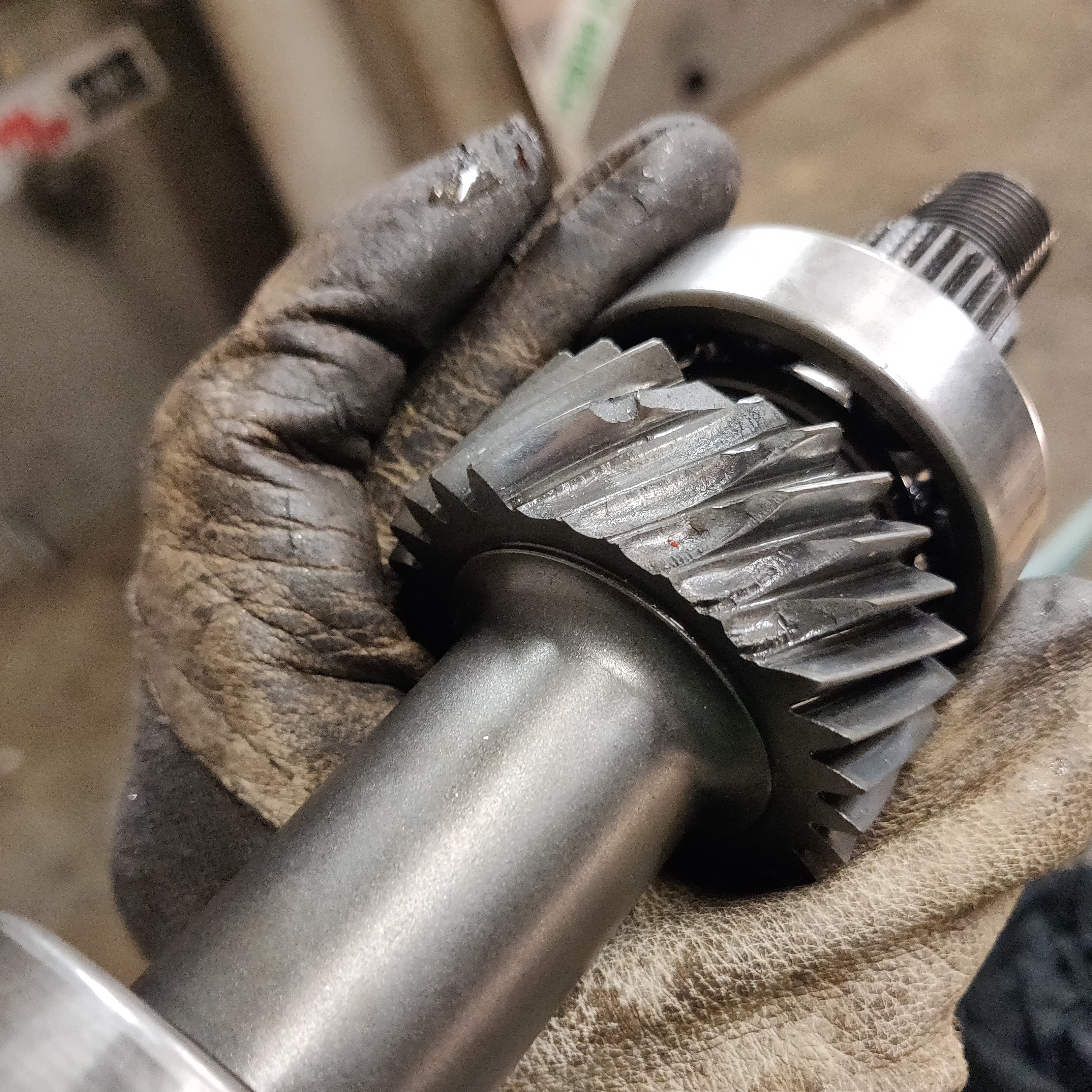

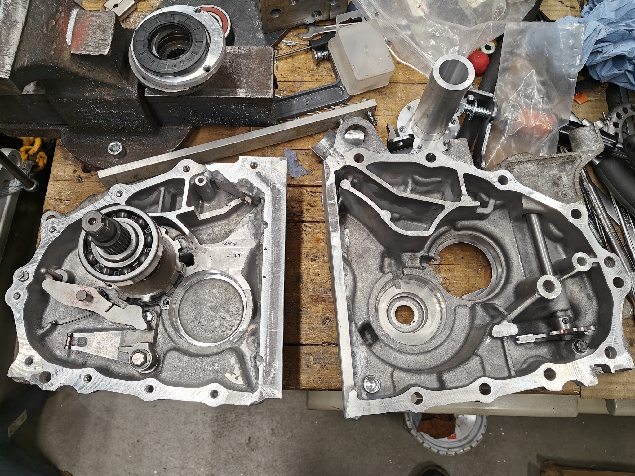

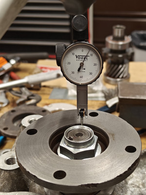

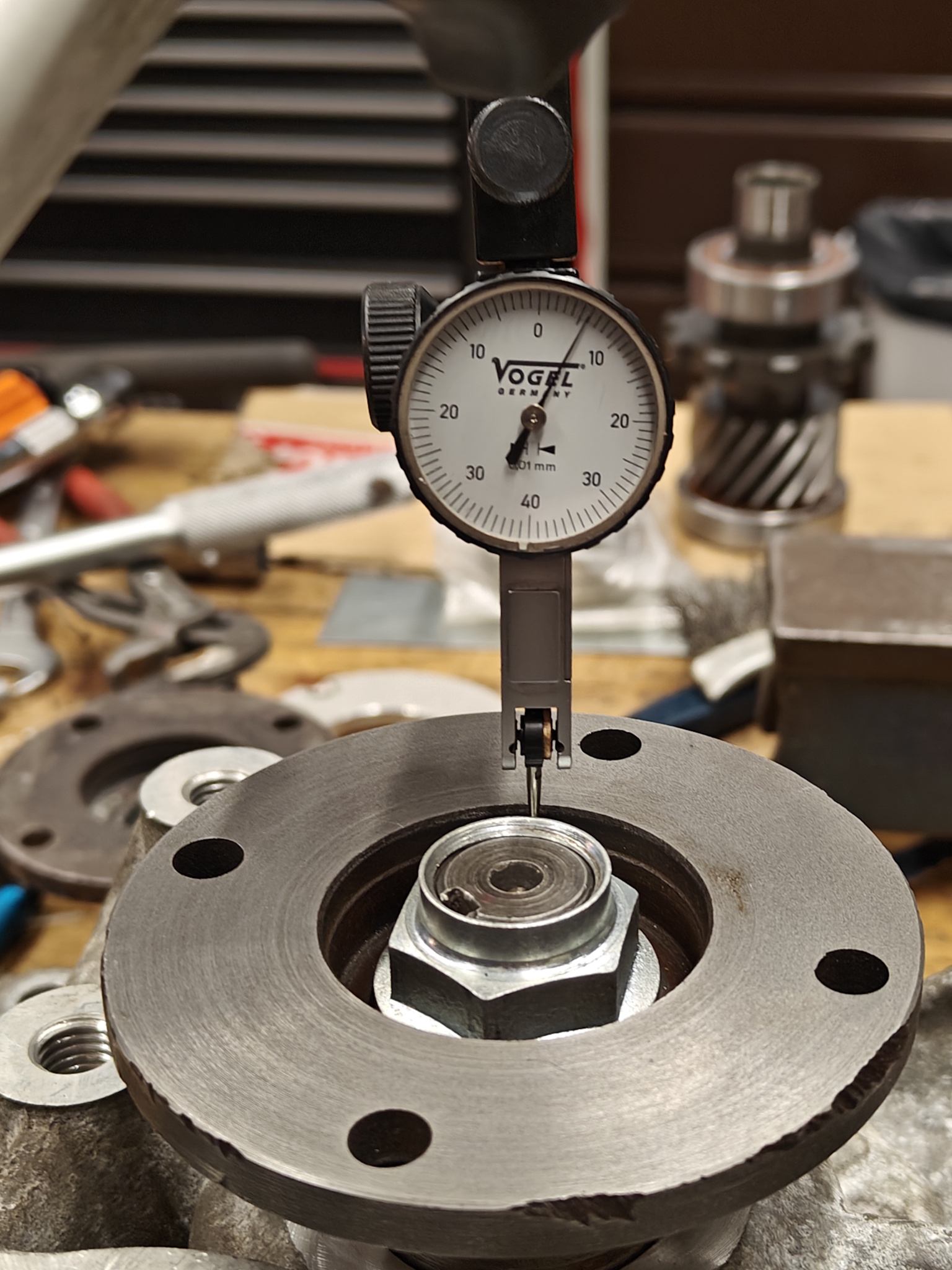

I extracted the Leaf reduction gear input shaft as it is useless for me in any other purpose than adapter building. I had a Suzuki transmission main shaft with the splined output that was the first thing I thought of for the other part of the adapter build.
The other day I remembered that I have laying somewhere in the parts bin this TC input gear that needs a dentist. This should be a more suitable blank to work on as it has the splined driveshaft flange end :)

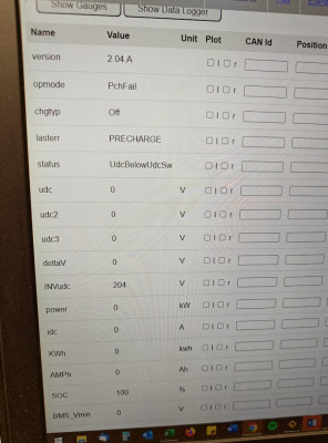

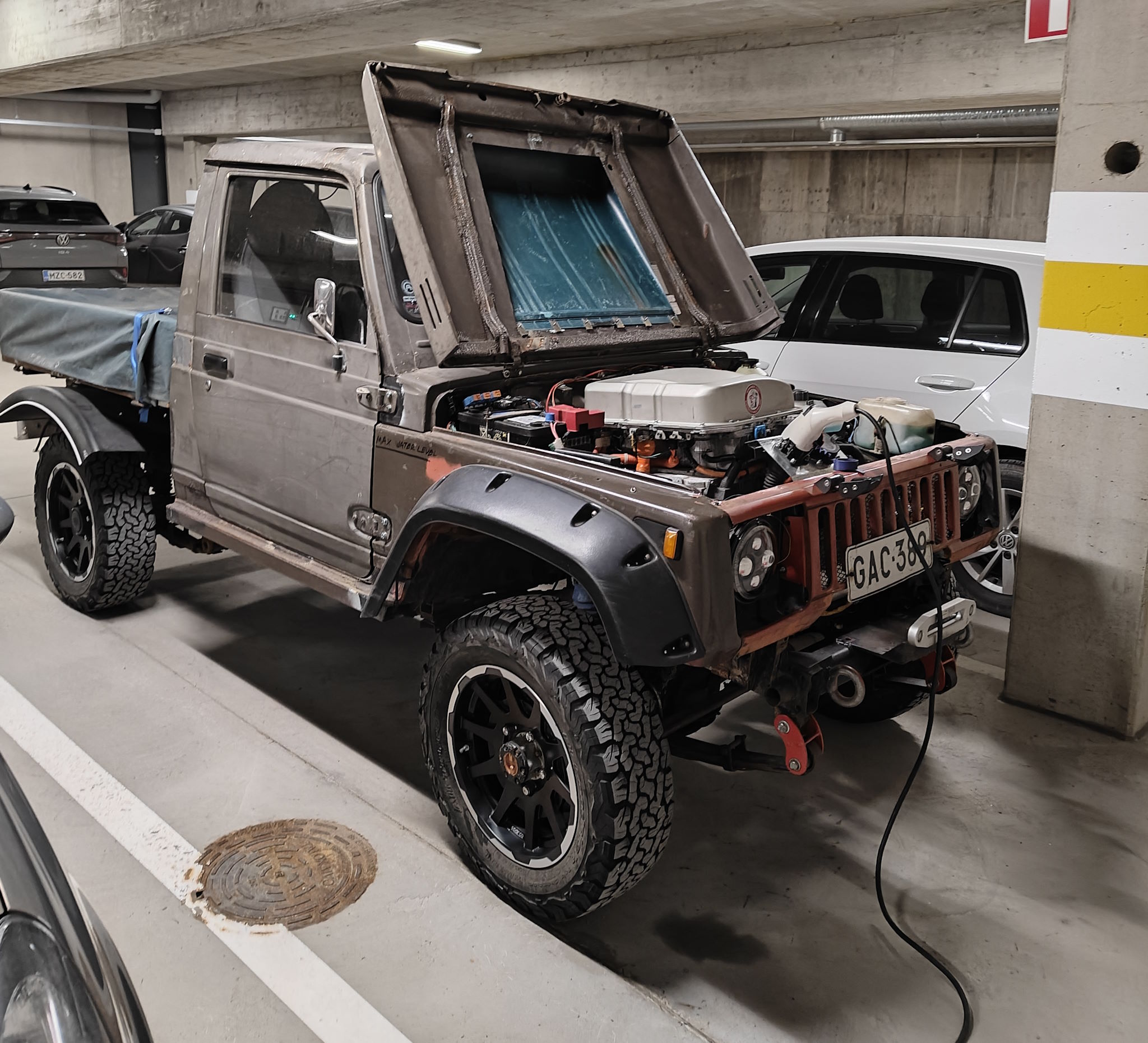

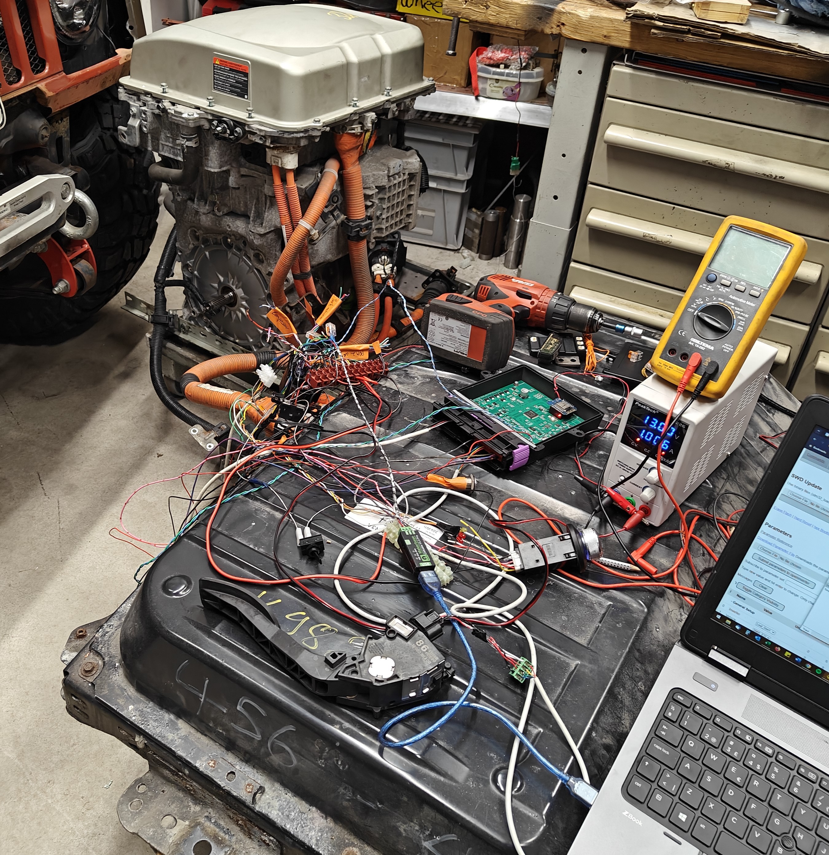

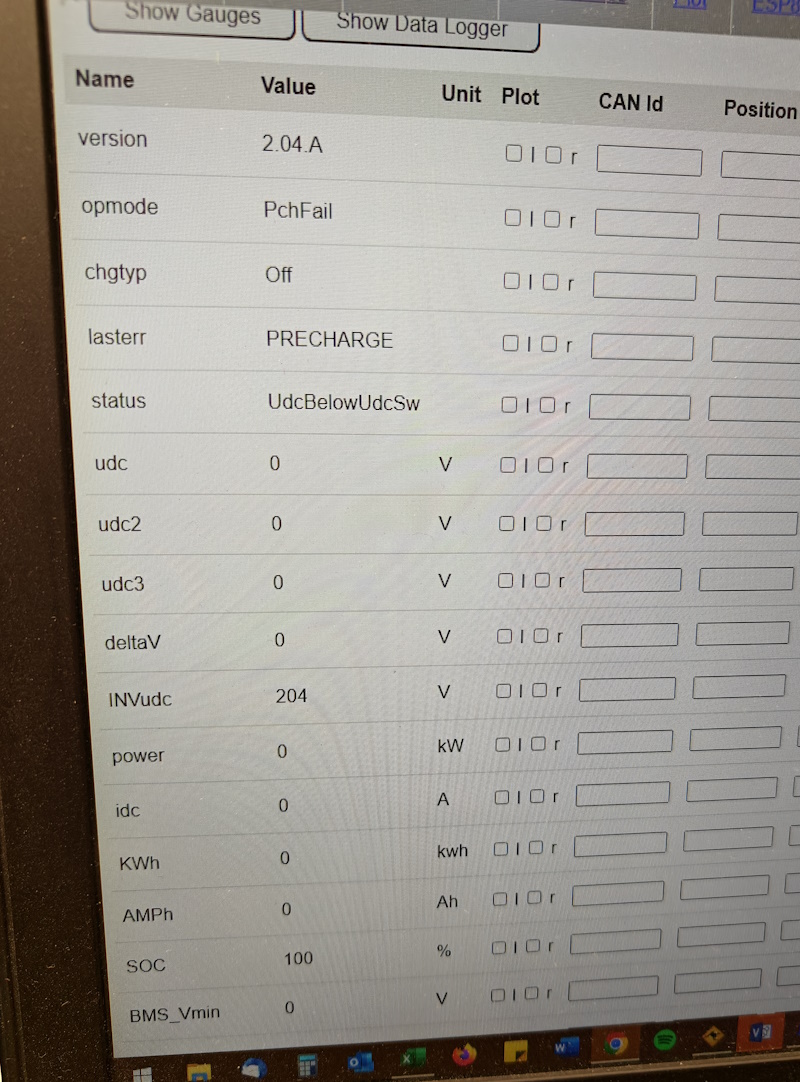

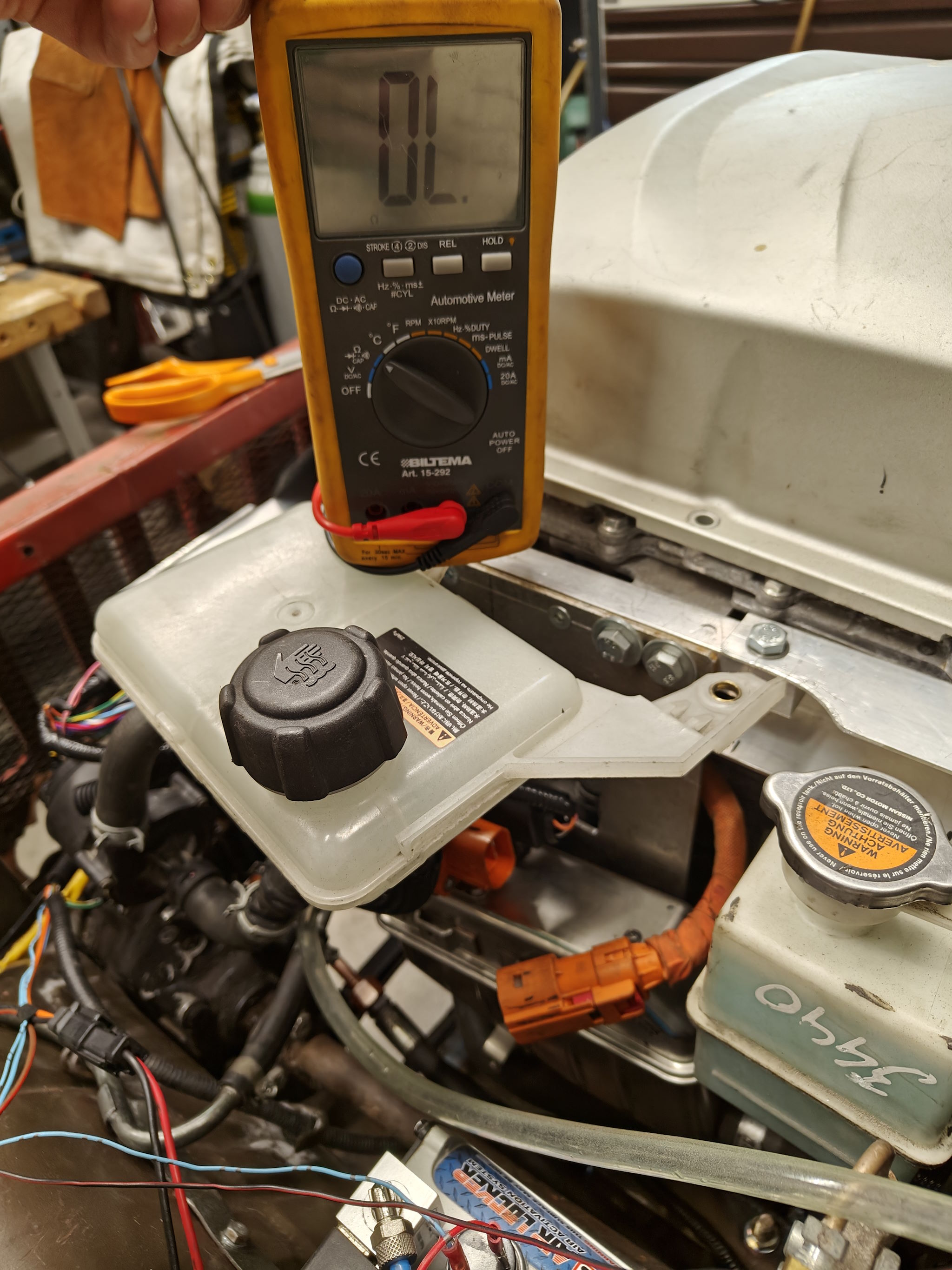

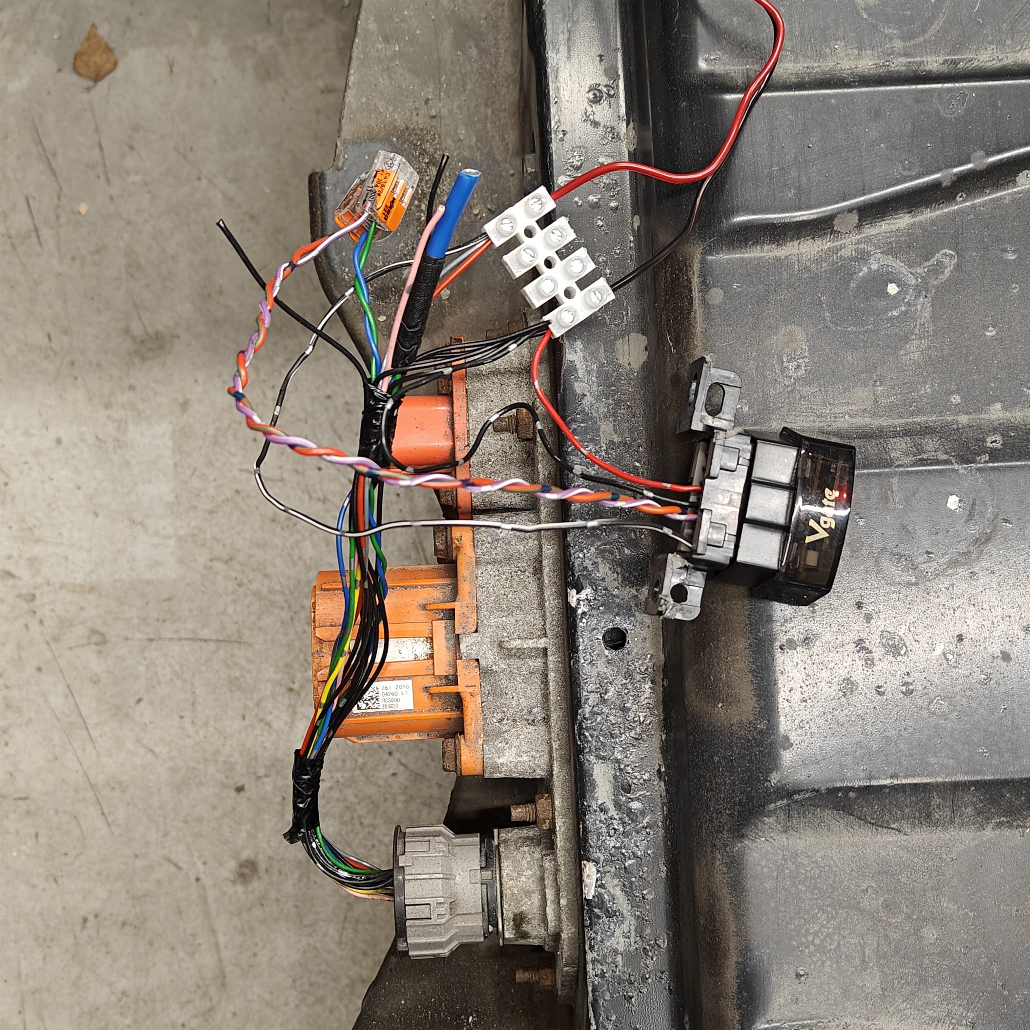

The other day I got things connected to the extent that I plugged the HV battery to see if the inverter would see the voltage rise during precharge (I did study the Leaf SM and to me it looks like the inverter voltage measurement is used during precharge to determine when to close main contactor.
Inverter voltage goes up during precharge, so next I'll attempt some copy-paste-coding and see if I can get the Leaf BMS talking with zombie

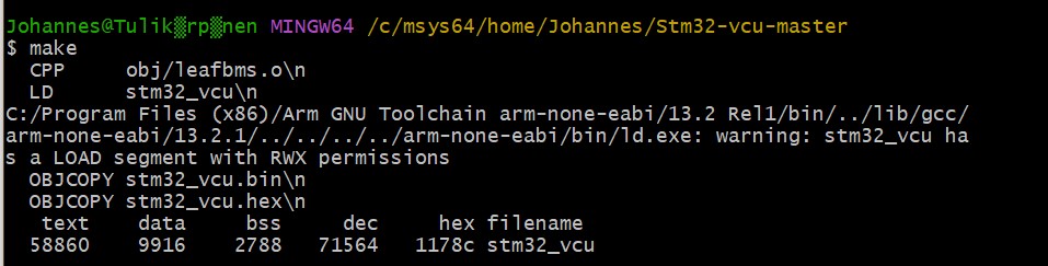

After some headscratching and pain with getting my modifications to compile, success?

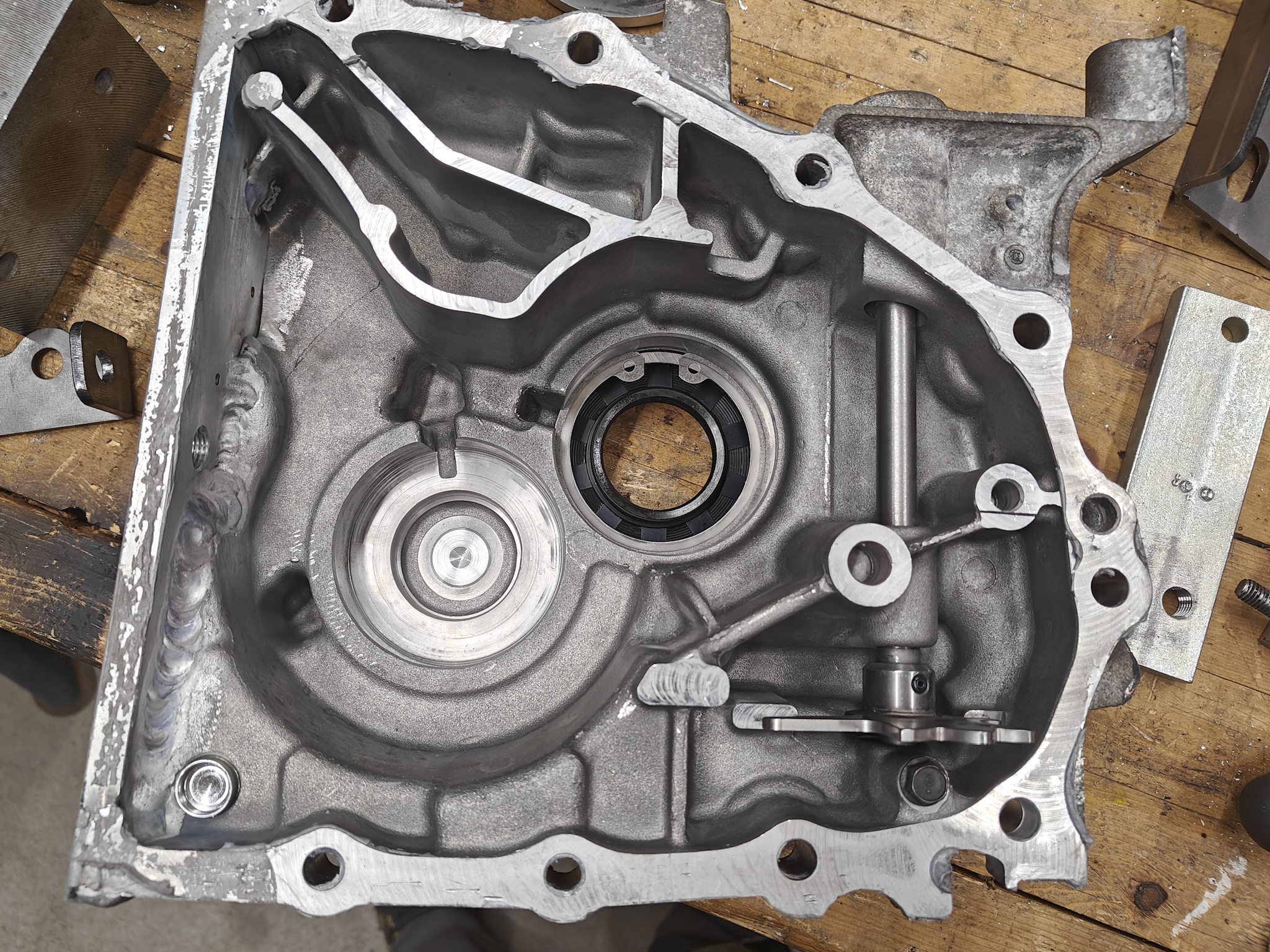

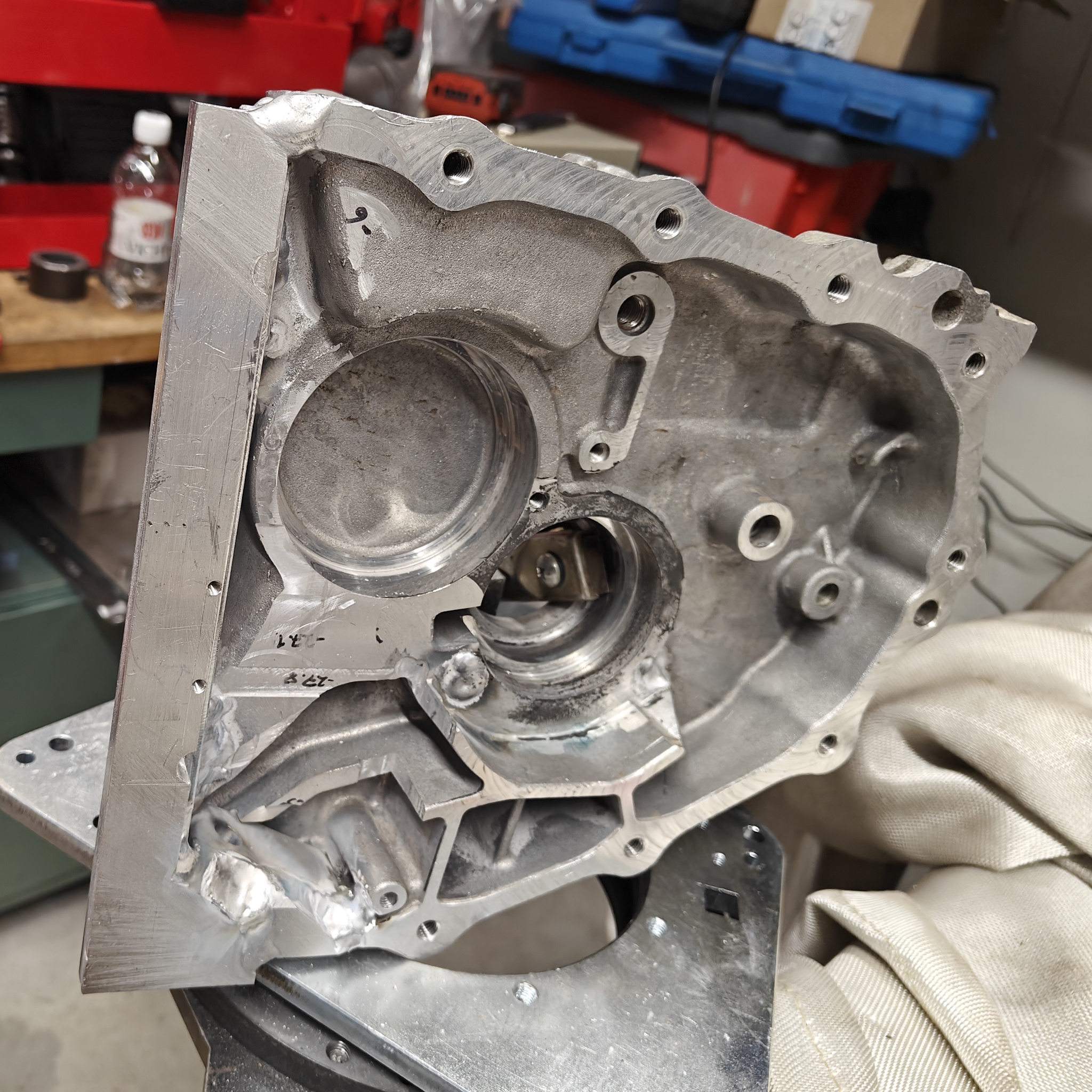

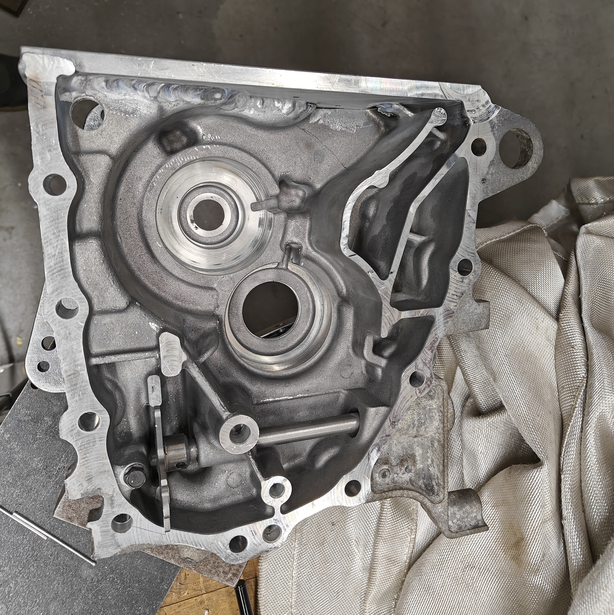

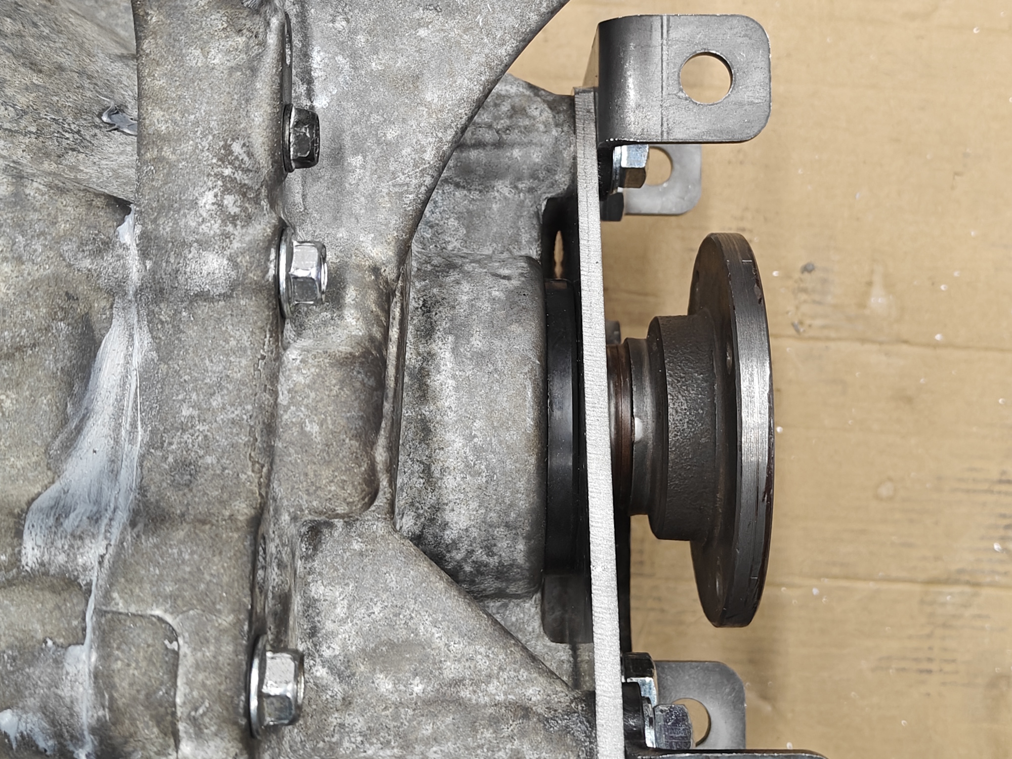

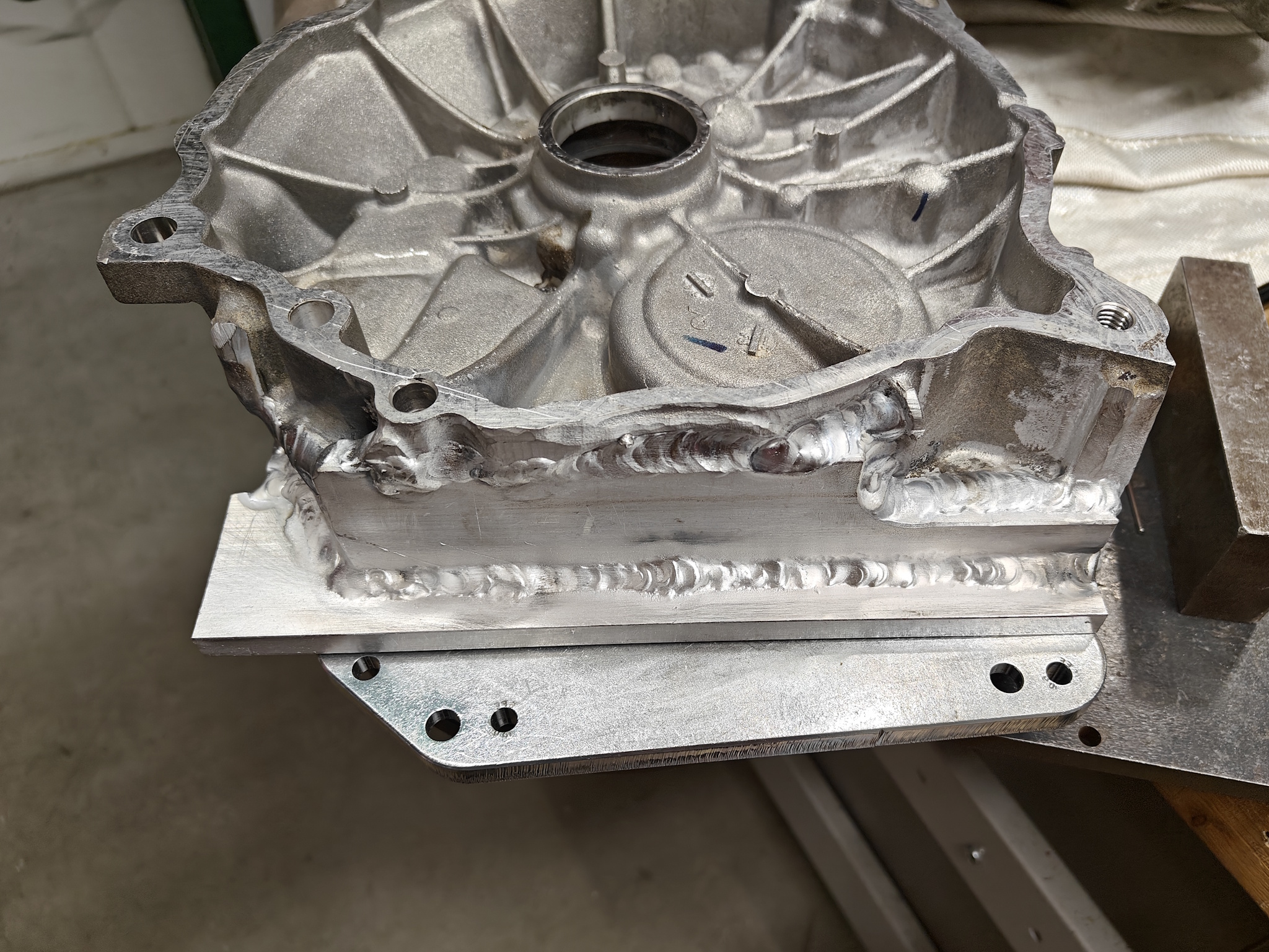

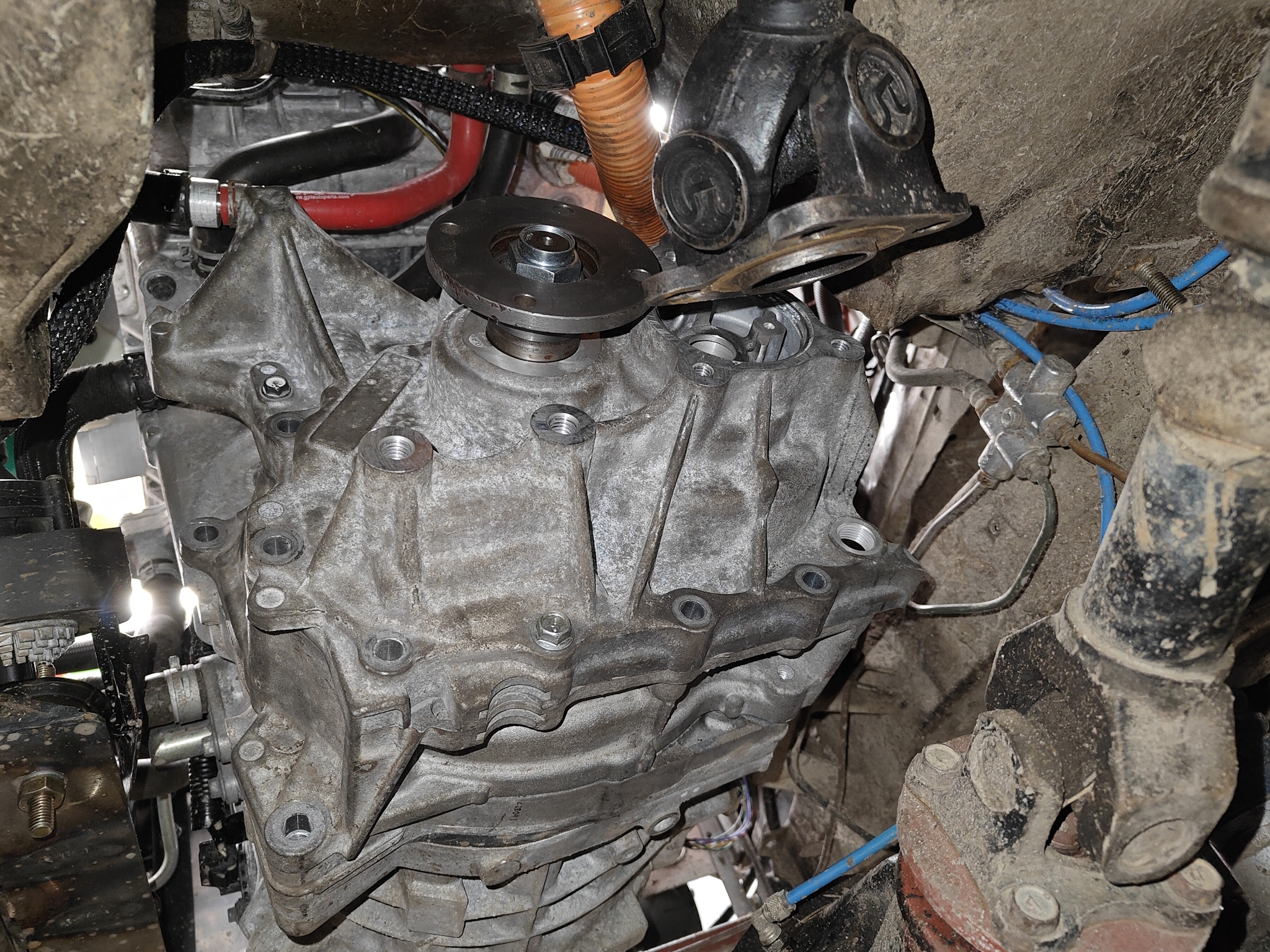

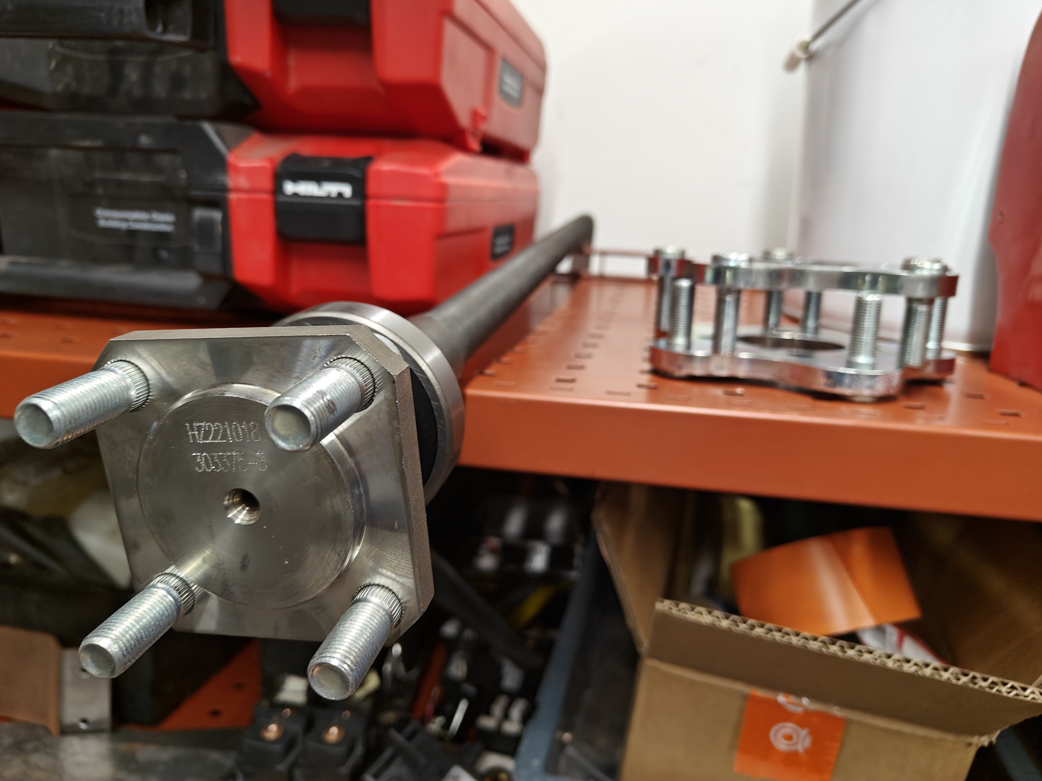

I've started to gather materials for motor/driveshaft adapter. Will use a 15mm aluminum plate as base and make a bearing mount in the middle.

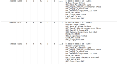

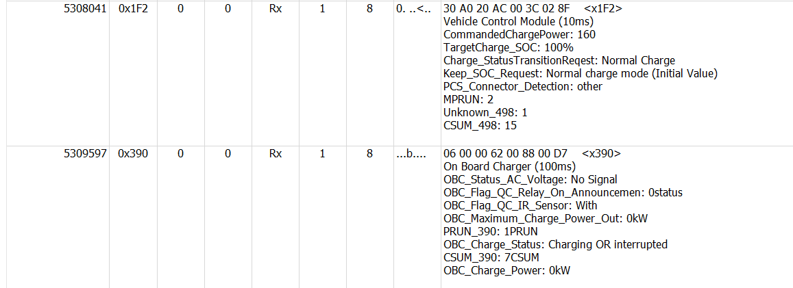

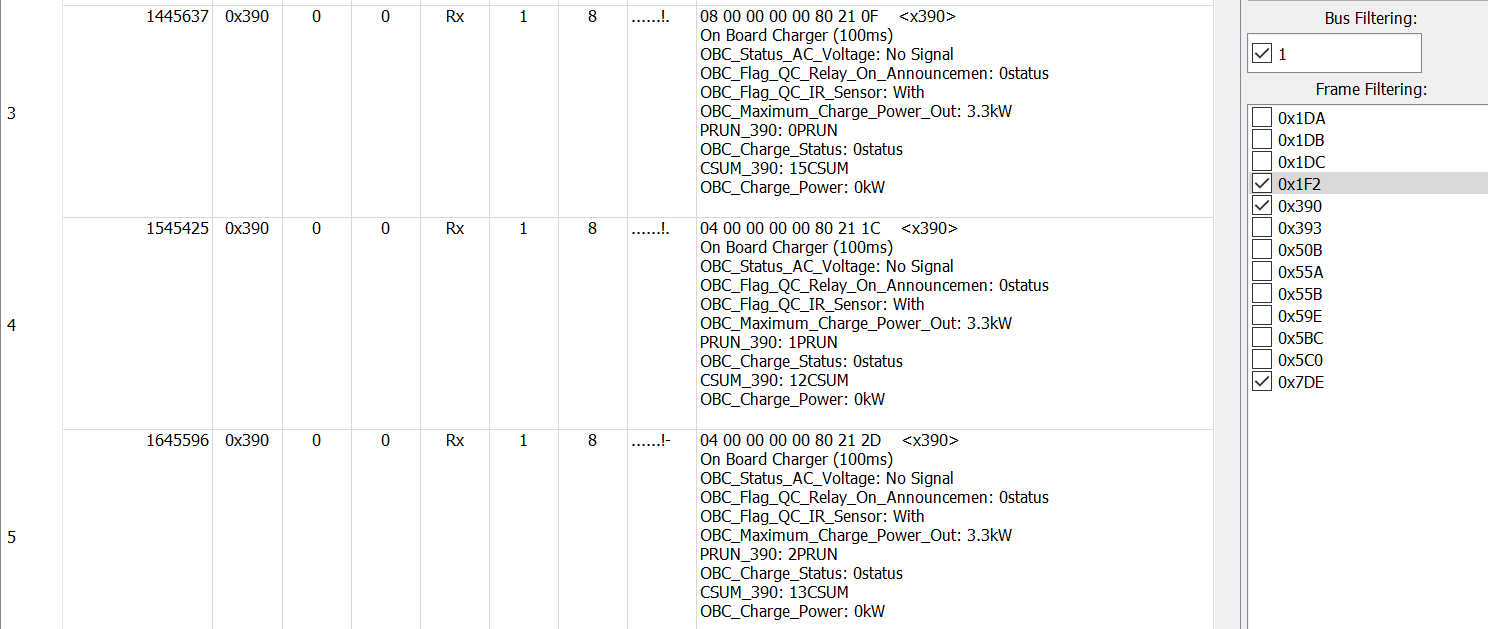

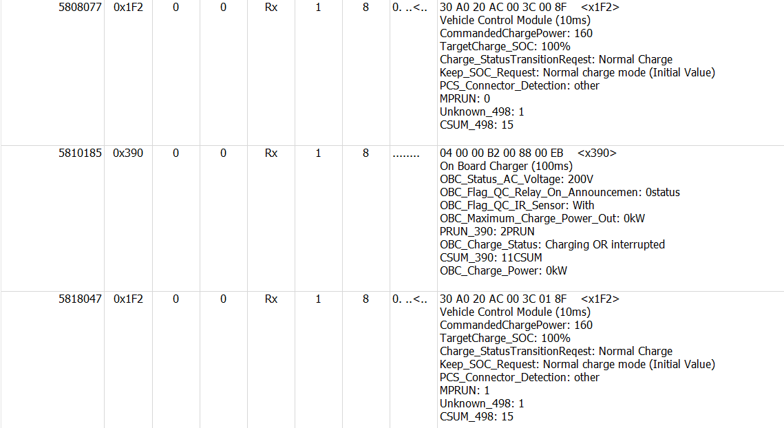

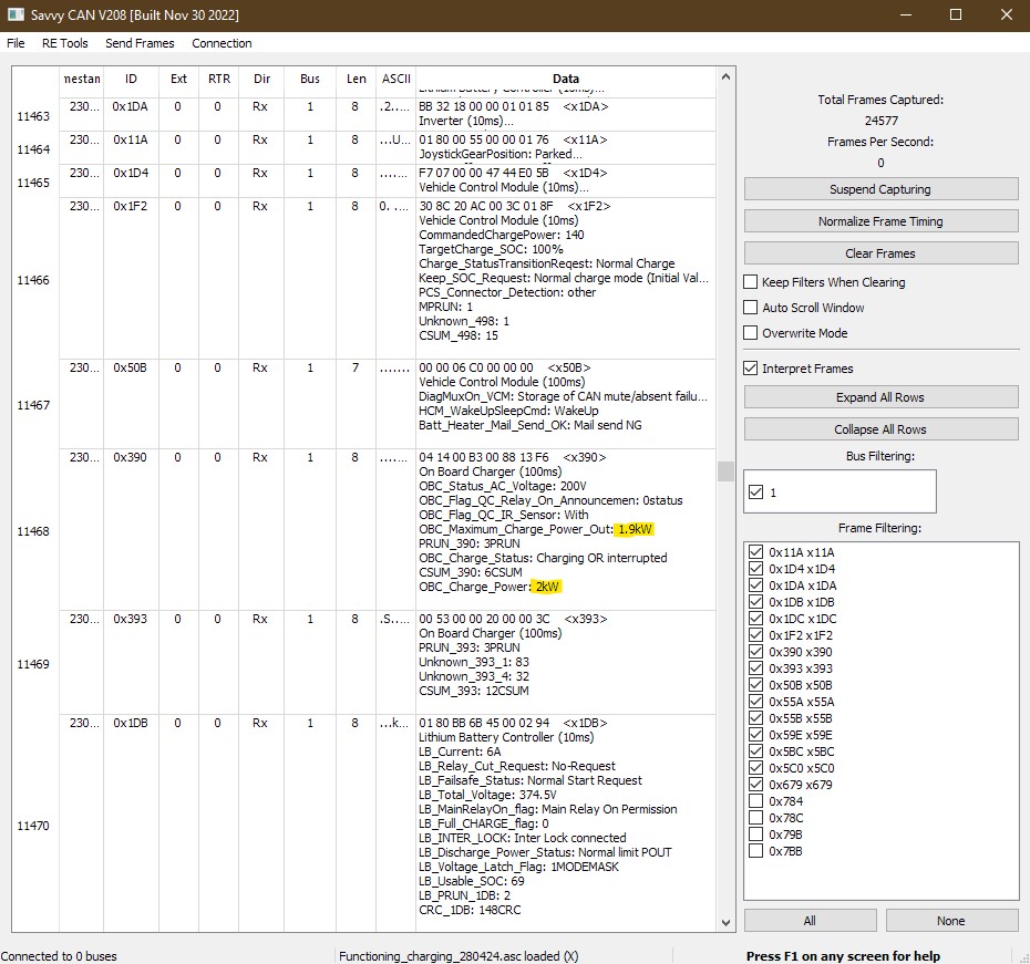

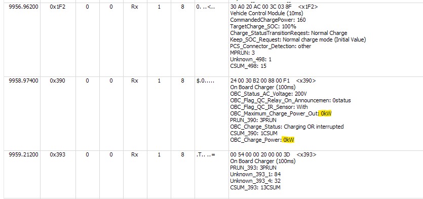

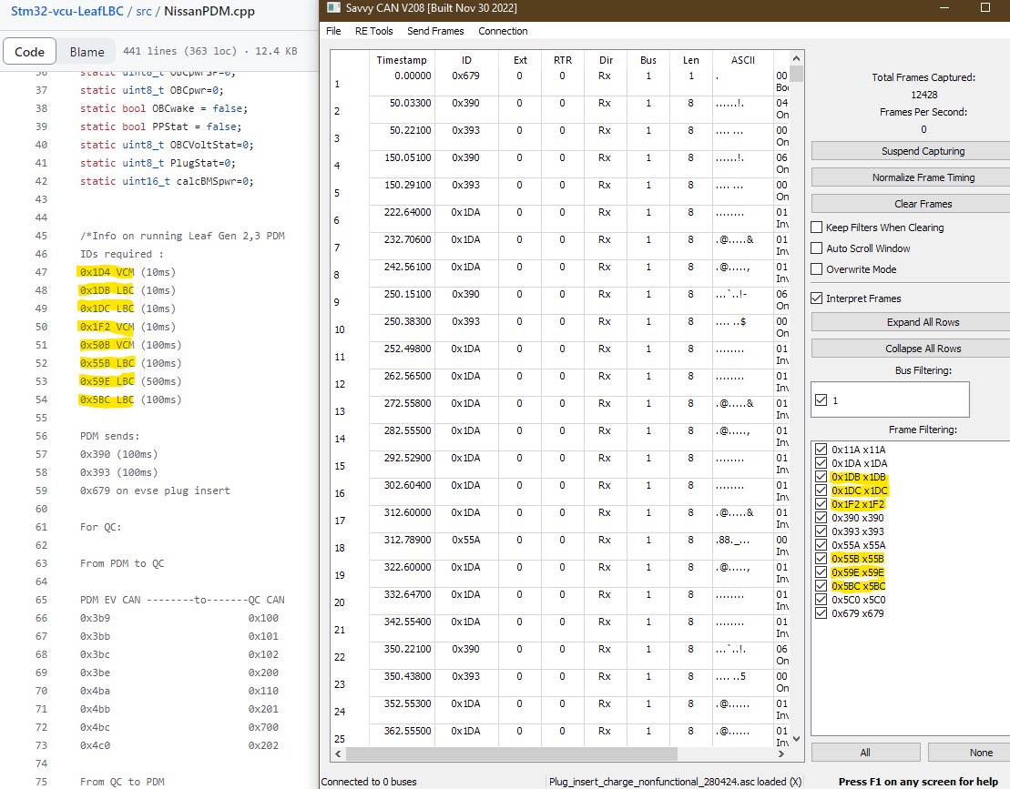

NEW ability unlocked, now I can CANtrace and decode with savvyCAN, this is really cool :D I use the AZE0 DBC by Dala
IF I'm quick, I can get the charger to click but no current. I may have found out the reason for no current, but at the moment don't fully understand what is happening.
The way I read this is that when the OBC wakes up, it's happy to output 3.3kW
This status shift realated to OBC bootup?
Zombie sends a charge power command, before there is AC voltage signal. Is this sensitive to the sequence of events.
Then there is AC status voltage, but nothing changes afterwards
Here's a CANdump of what I'm looking into at the moment. Here I have both the spoofing messages Zombie sends and the actual LeafLBC messages, but to me it looks like the OBC doesn't get upset because of all those LBC messages flying around. Thoughts and input are more than welcome :)
IF there would be a kind someone with a Zombieverter with Leaf stack and slow charging works for comparison a CANdump could be useful :) (of the process of plugging in the charger to a system which is OFF until the EVSE clicks and current flows)
140424-1710_Startup_sequence_WITH_LEAF_BMS_Plug in during boot.txt
(2.93 MiB) Downloaded 816 times

I have no experience with leaf PDM etc, but your code on github does not look up to date as it does not compile and has other errors.
From you CAN log the zombieverter is still sending data on 3 ids which may be causing the problems. I think this is because where you have declared/defined the variable to compare BMS type ( a bit confusing you are using shunt type parameter ) is fixed at compile time and is not code that is executed at run time.

0x59E, 0x55B and 0x5BC. If you look at each id one at a time it's clear that most of the messages sent are the fixed values from leafinv.cpp.

royhen99 wrote: Mon Apr 15, 2024 11:21 pm 0x59E, 0x55B and 0x5BC. If you look at each id one at a time it's clear that most of the messages sent are the fixed values from leafinv.cpp.
Oh yeah those, thanks for chicking this out and spotting them :) Like you mentioned, the declaration/definition of the variable to check shunt type was outside any called function, so it wouldn't have updated and thus my attempt to mute the messages didn't work.

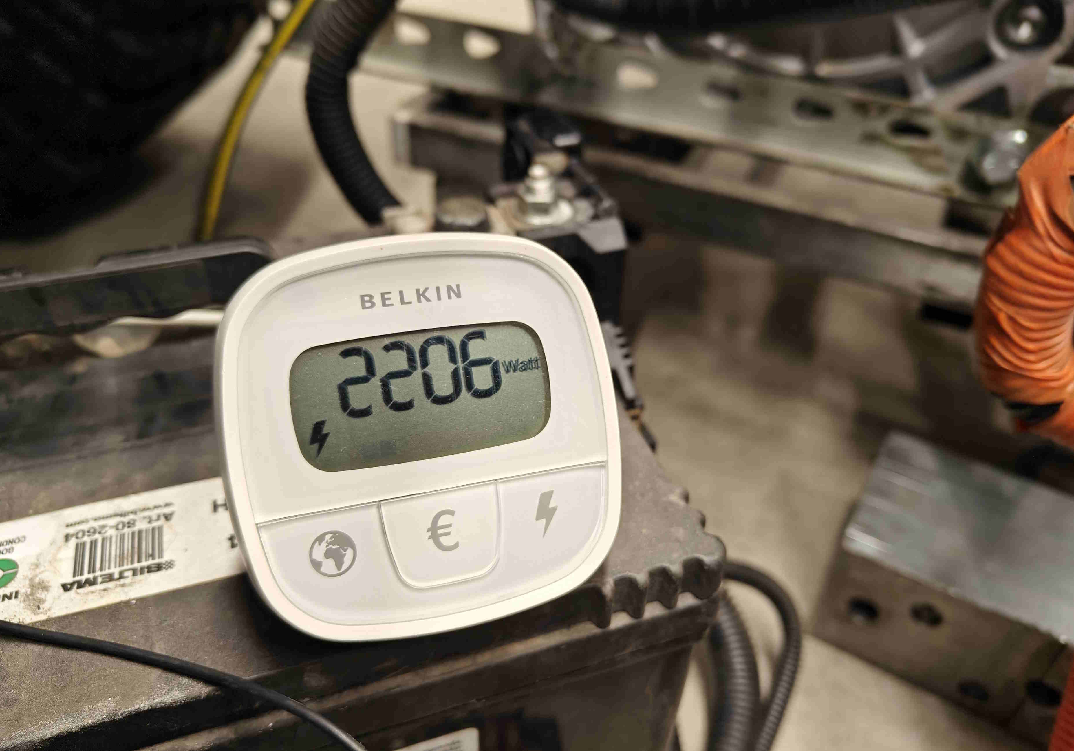

AC Charging works!!!
Post by J0hannes »
Woah, today I split the atom (well for me this felt like it :D)
My code botchery was only partially to be blamed for AC charging not working. While I've been beating myself why I'm unable to copy paste the work of others and tweak it so I'd get what I need, I also started to notice that I'm not alone with my troubles.
How come there are all these comments on this forum that AC charding does not work on Leaf PDM?
Bratitude has no AC charge
Then vin also has problems
What I have had working for quite a while now is contactor control by reading Leaf inverter voltage for precharging (just as Nissan does it, inverter is on when HV is on) and LBC current is visible on web ui --> current is read from LBC. Since I was getting more and more confident that my LBC "integration is not the problem, I began suspecting that there must be something not working properly with the part of Zombie code I have not touched.

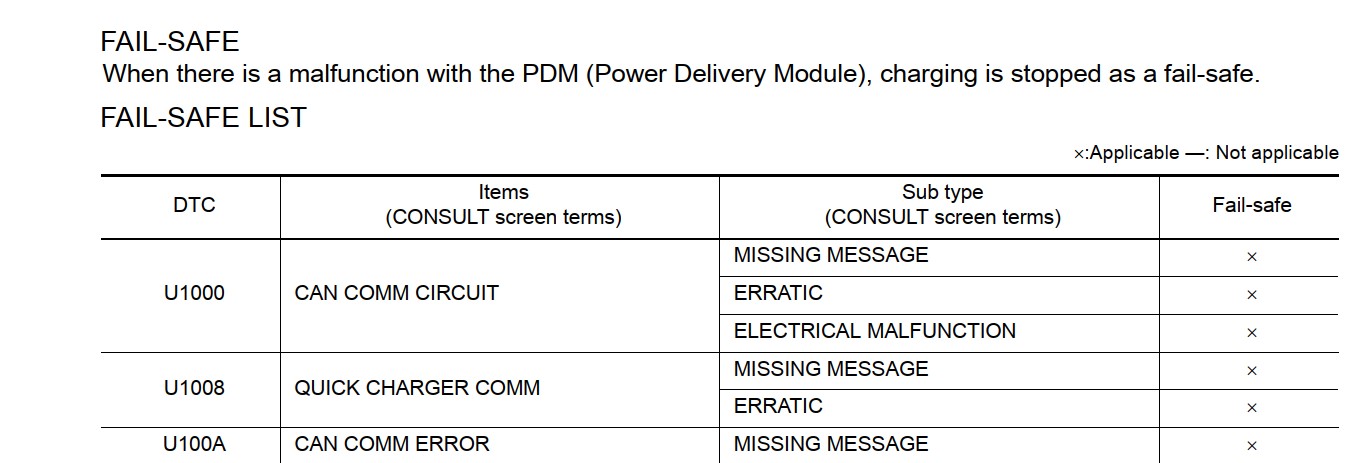

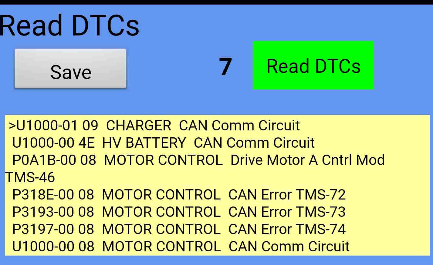

I invested in LeafSpyPro to read the DTCs of the modules. Read the DTCs after I plugged in the EVSE and relays clicked and EVSE showed charging status.
CAN still showed that PDM is not happy and doesn't want to output anything
Some DTCs that come back after clearing them, motor control DTC were related to the topic at and in a way yes...
Looked these up from Nissan SM
So it's understandable that PDM closes shop if it doesnd get all the info it needs.
It's really difficult to catch something that you are overlooking (because you make the assumption that this is proven working and there can't be any issues with it) I was close already, but then it finally hit me like an electric shock, while I was explaining to my friend how this is supposed to work and had the code and my latest can trace of system not working side by side. "You see, this part of the code is nice because it has quite a lot of comments that help to understand how this works. Like the PDM needs all these messages to operate and here you can see them being transmitted to CAN..."
Can you spot the difference :lol:
I'll copy it here from NissanPDN.CPP for clarity and so that this is expressed somewhere on this forum posts so search can find this too.
Info on running Leaf Gen 2,3 PDM
IDs required :
0x1D4 VCM (10ms)
0x1DB LBC (10ms)
0x1DC LBC (10ms)
0x1F2 VCM (10ms)
0x50B VCM (100ms)
0x55B LBC (100ms)
0x59E LBC (500ms)
0x5BC LBC (100ms)
So yes, you need all of the above CAN messages to be sent in order for Leaf PDM to function and to have AC charging working.
For anyone struggling with AC charging, check that you have these messages being sent
I will admit that, I was a little overzealous in muting the LCB spoof messages zombieverter sent and by mistake turned off needed message 50B.
But the real issue had been identified and fixed once over and got broken again as code has been modified, restructured and rewritten between releases.
Now I do not know what was the last published version of Zombie firmware that the AC charging on leaf PDM would have actually worked with Nissan original type 1 charge port. If I have understood correctly, using type 2 charging port needs some signaling going directly to Zombie?
Anyways, now the Leaf PDM AC charging can be fixed that it would work for ALL Zombieverter users :)
My GitHub should be up to date at the moment.
I got the Outlender EVSE connected to an energy consumption meter and that is a rowof digits I've been chasing here
CAN also tells the truth
N00b here doesn't understand how a pull request works and when it would be appropriate to make one.
This is still in quite raw shape, but since I have your attention now, maybe I can get some comments on how to make this better.
This is likely a result of my code botching, but something weird is happening when I have the system run mode (T15 active) and shut it off. It seems to want to jump to charge mode, meaning contactors shut off but then immediately it tries to go to charge mode. I have not looked into this properly yet.

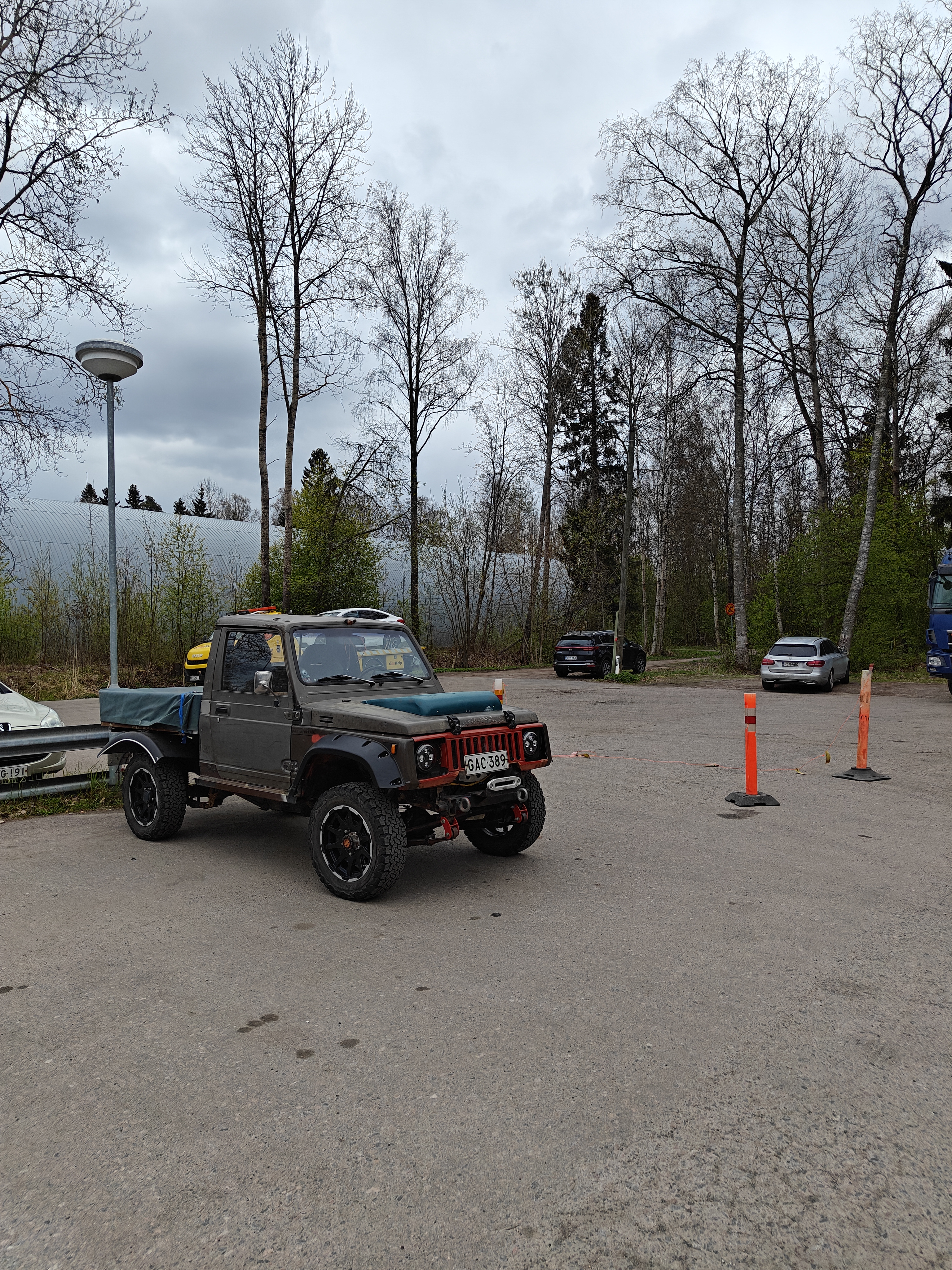

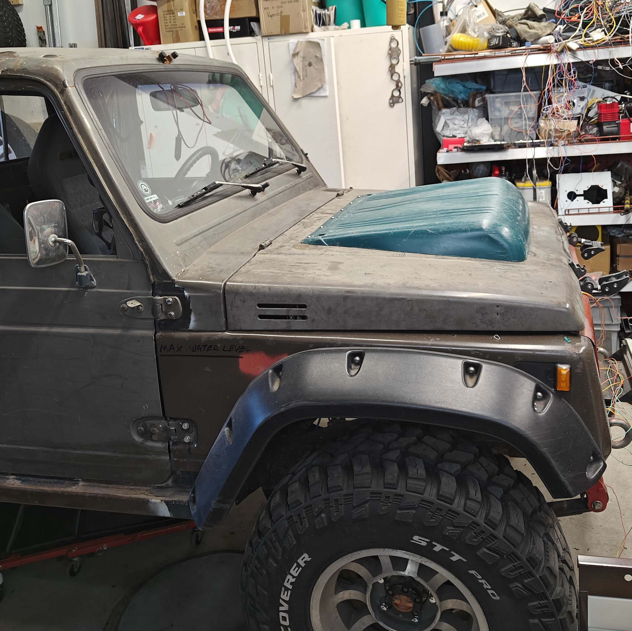

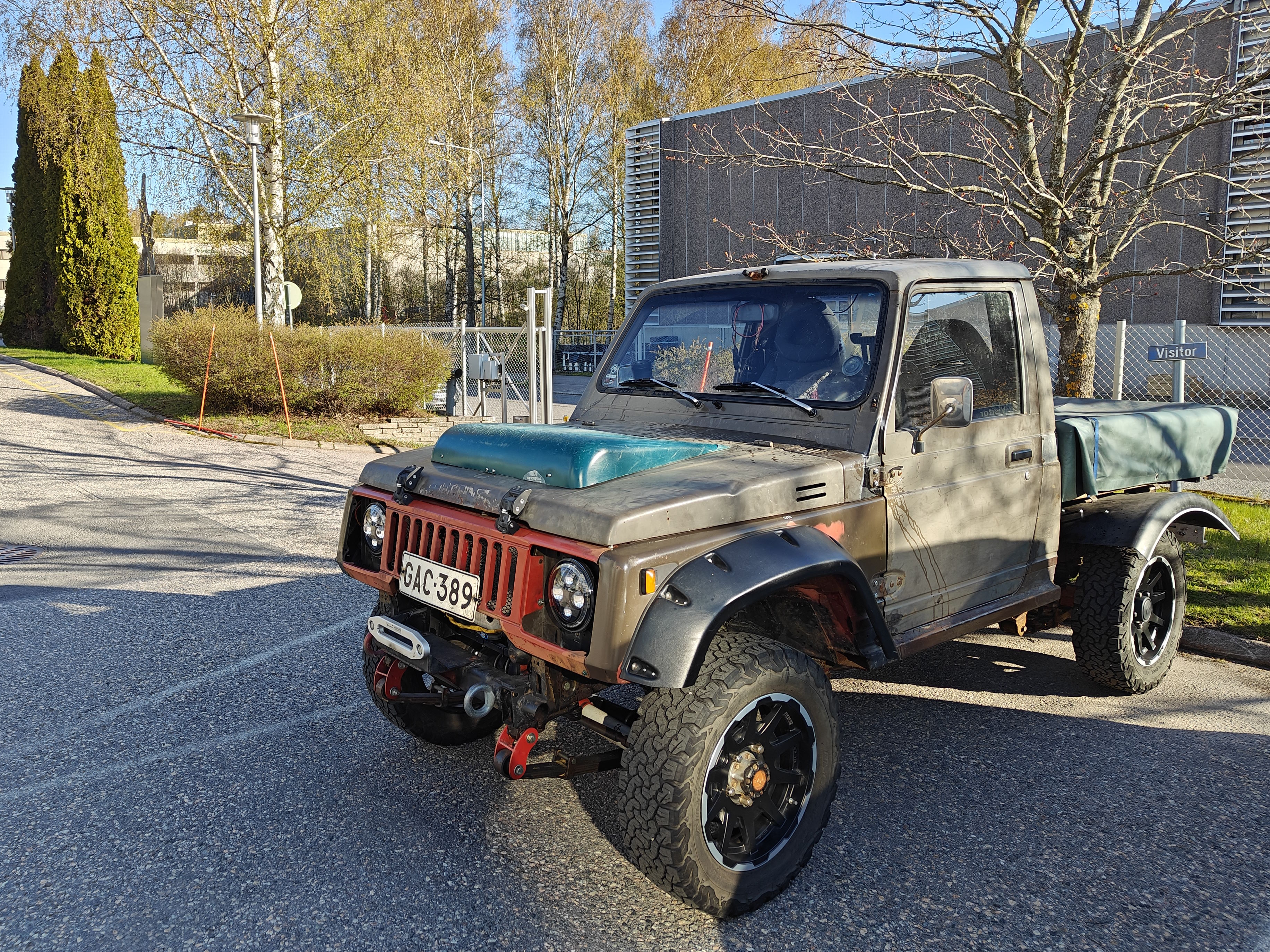

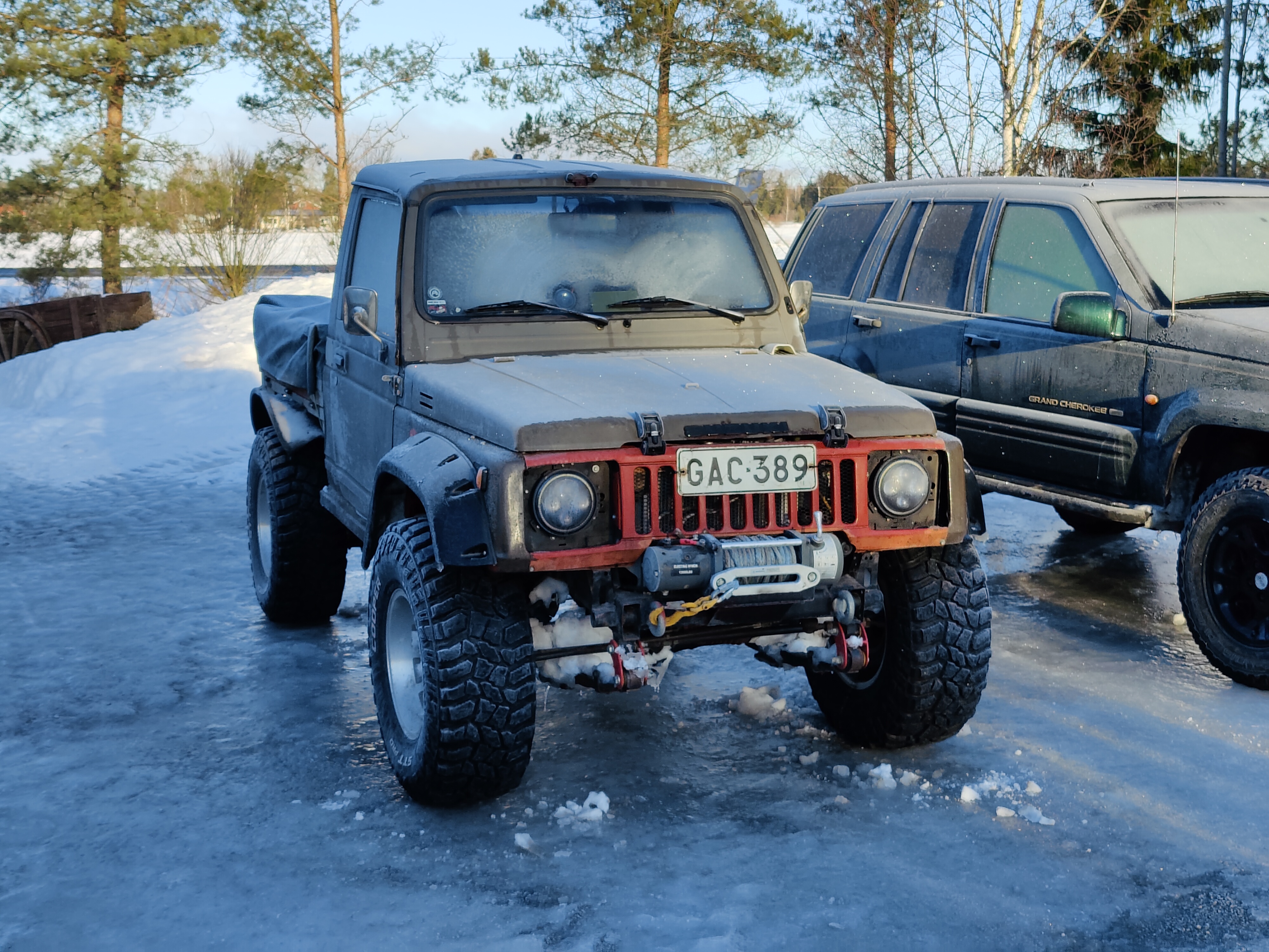

Yesterday had this pass yearly roadworthiness inspection likely for the last time with ICE :D Started to take things apart...

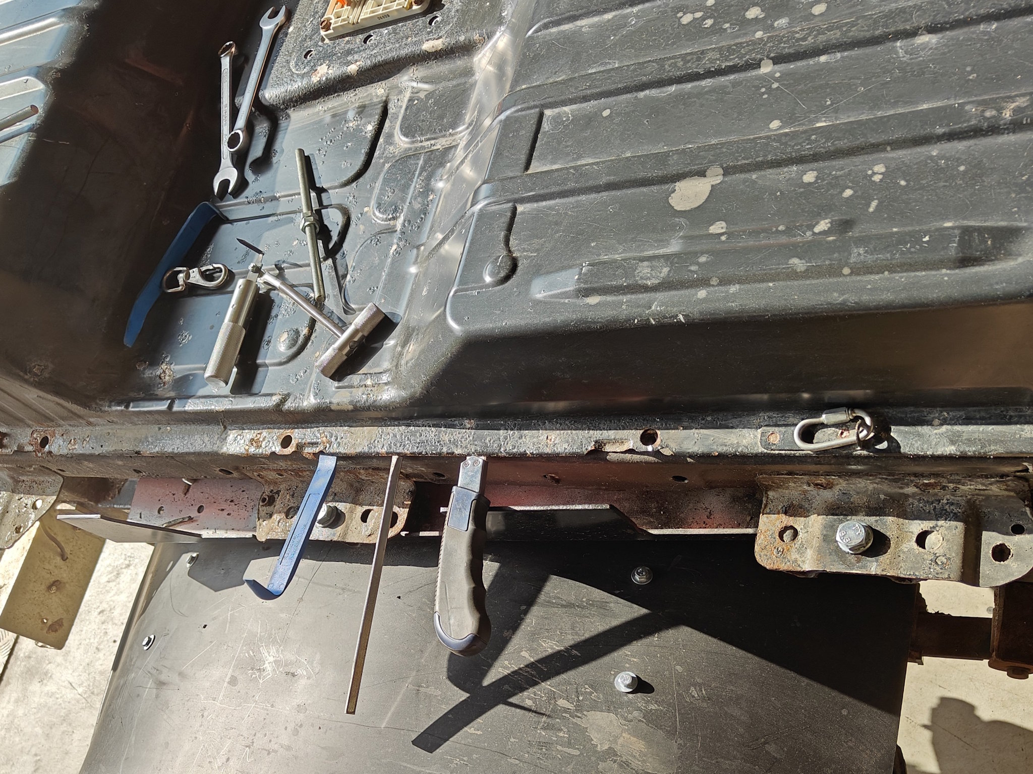

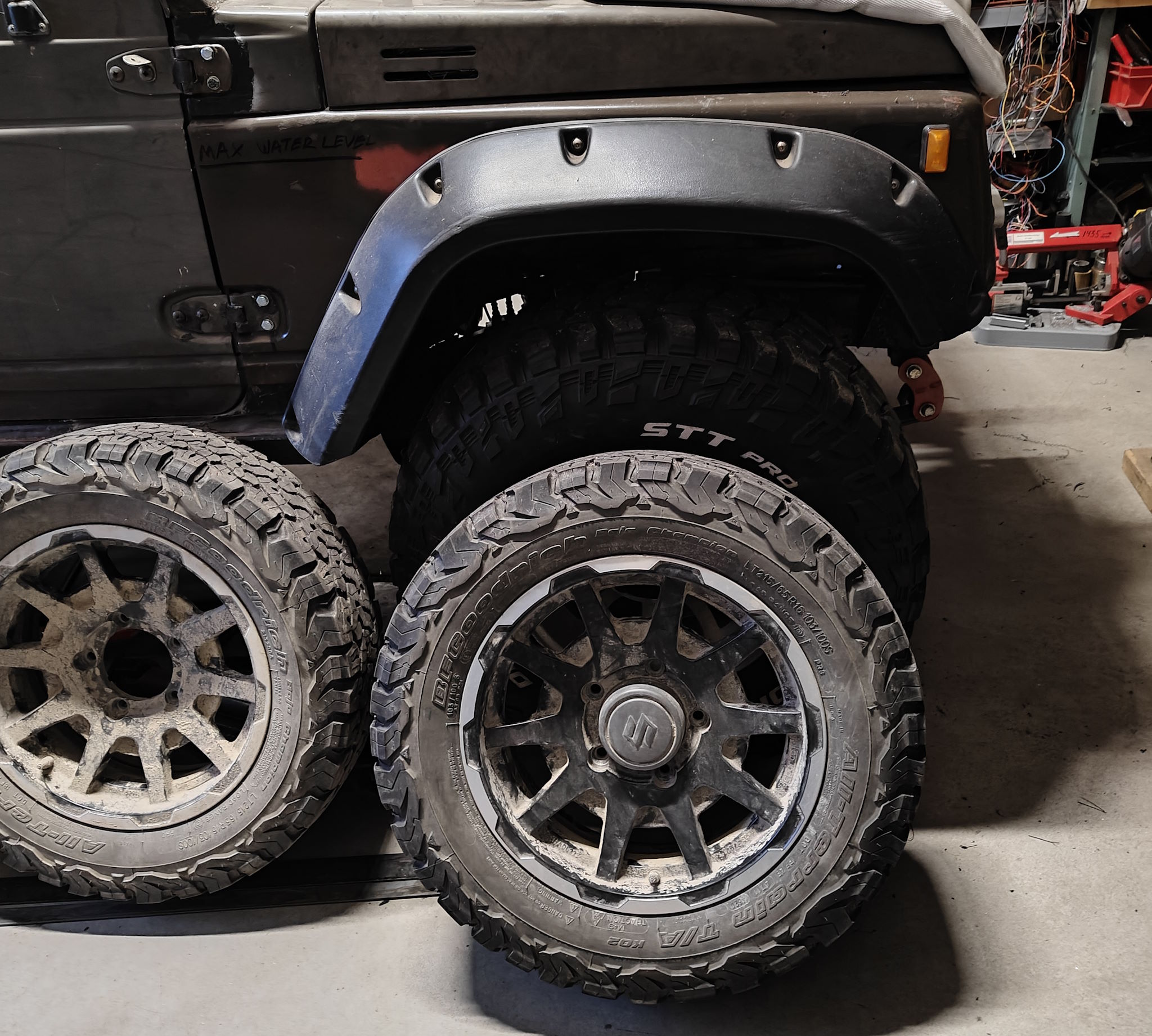

Since I still don't have accurate number for current weight of the car, I'll try to weigh at least most of the parts that come off, so I have some understanding of the weight bugdet.
The pickup bed for example ~83kg in total

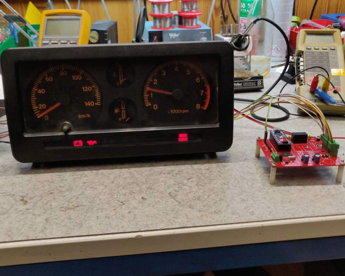

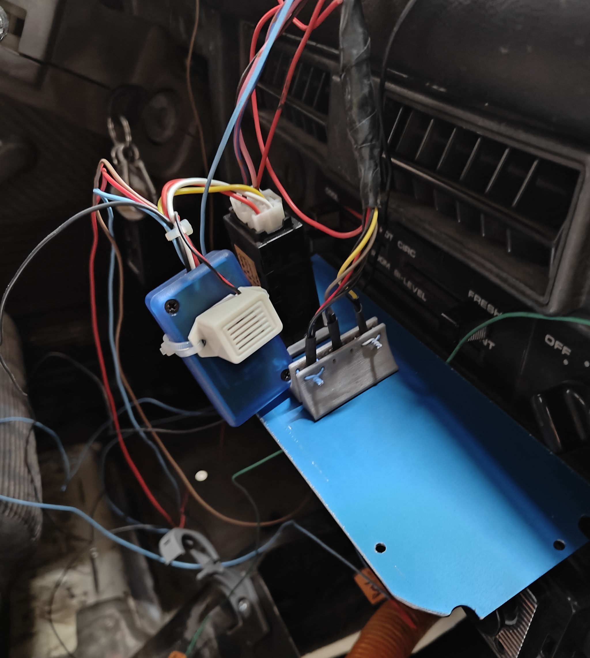

My father has been working on a meter cluster controller for the Suzuki cluster. Fuel gauge, engine temp, tacho and couple of lights are now CAN connected 8-)
Tacho for now is just motor revs, but eventually needs a new face and mapping for inverter applied torque or battery current.
Fuel gauge and alternator light will be used for SOC indication --> alternator light on when SOC below 20 %. Maybe have it also do some flashing sequence during charging too.

J0hannes wrote: Sat May 11, 2024 9:52 am My father has been working on a meter cluster controller for the Suzuki cluster. Fuel gauge, engine temp, tacho and couple of lights are now CAN connected 8-)
This is interesting for me, would love to have more details on how thats achieved if you don't mind sharing some details :D

That's a neat instrument cluster. How are you controlling the Speedo? Is that still mechanical from the gearbox?

Jacobsmess wrote: Sat May 11, 2024 10:09 am That's a neat instrument cluster. How are you controlling the Speedo? Is that still mechanical from the gearbox?
Luckily, Suzuki has had the speedo gear in the transfer case, so speedo will stay mechanical

If y'all want to read more about the CANification of the meter cluster, you can go to this Offipalsta.com thread about it
This is in Finnish, but Google translate seems to do a pretty ok job translating it to English :)

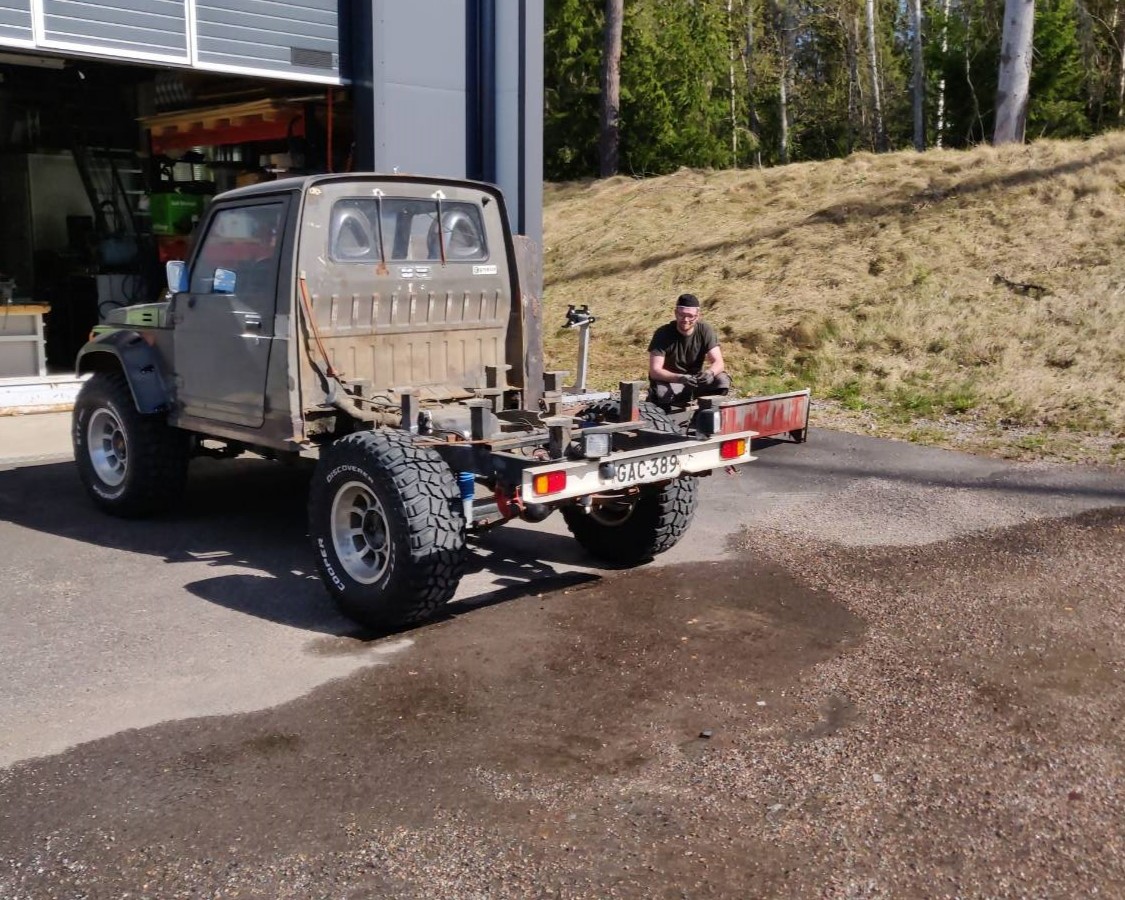

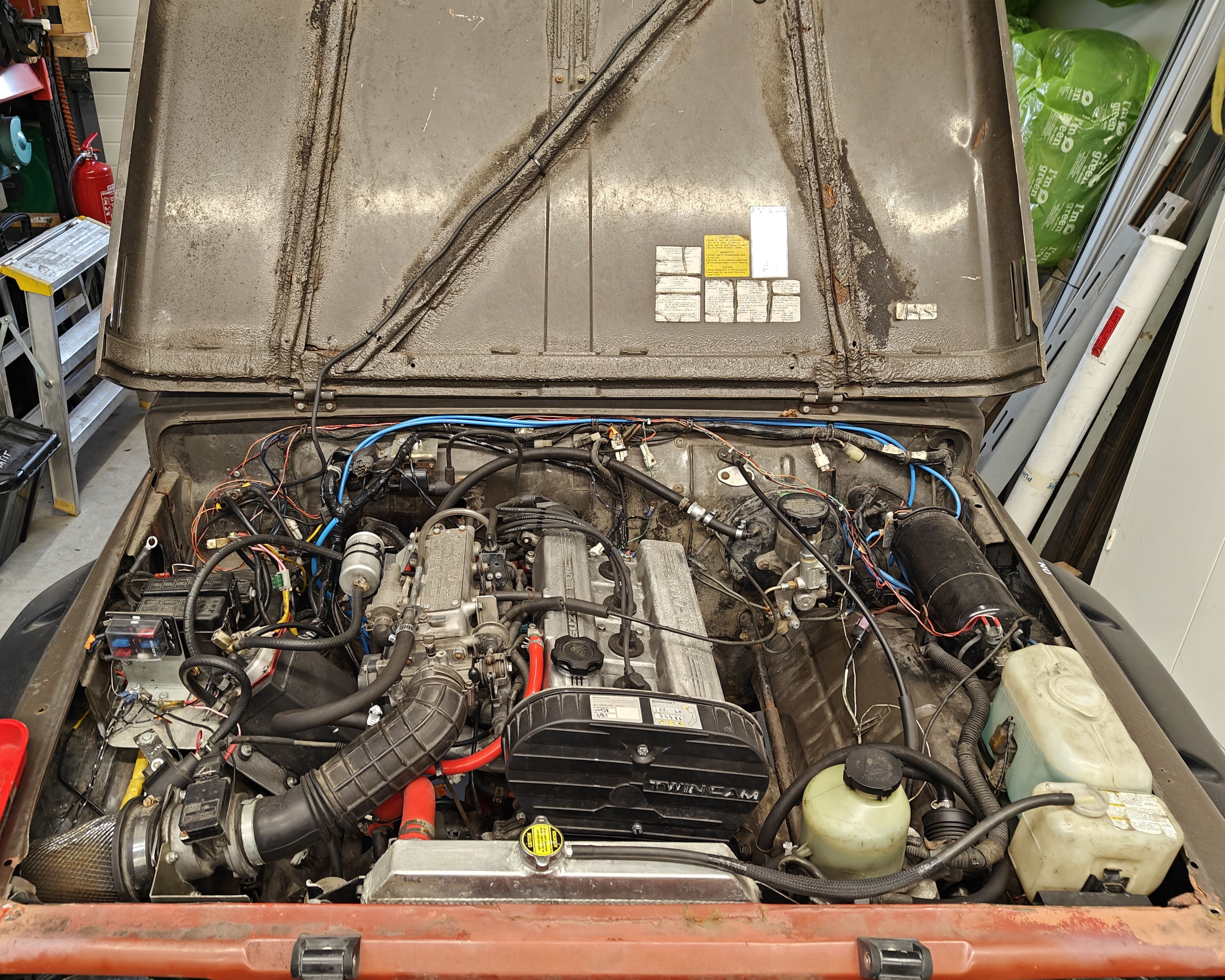

There was a divorce this weekend! Didn't weigh the engine and transmission yet, but so far I've removed about 150kg of parts and this doesn't include the exhaust or fuel tank either.
Washed the engine bay, although it wasn't too bad, now at least it's nicer to fit the Leaf drive stack in.
Did also some heater cable modding so I can plug it in Leaf PDM.
VW heater cable now in Leaf AC compressor cable gland.

CANified meter cluster working!
Intermediate driveshaft would be close to 80 cm, I I'm not going to divorce the drivestack
Otherwise it looks that it would fit
Ok, not really...
I was secretly hoping that this would fit, but the PDM really is a chunk
Weighed the Leaf divestack, 104kg
Removed GTi engine with gearbox approx 135kg
Tires are quite heavy, 33,2gk each.
