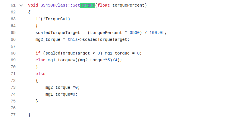

an extra couple of thoughts have come to me...
1. Which inverter have you selected in the zombie gs450h/300h? as the code that is sent to the inverter is different.
2. Is your driveshaft locked yet?
3. there is a difference between the 300/450h transmissions in of the mg1:mg2 ratios i'm wondering if this mismatch is causing one to get dragged and hence acting like a rev limiter, (i can find the code gs450h in zombie but not the corresponding code for 300h).

Thanks for the excellent advice
1. I've selected the 300h inverter option in Zombieverter.
2. The driveshaft is locked
3. Oh I see. In 450h the torque request ratio is (MG1/MG2) is around (2.29/1.9). In 300h it is around (2.6/3.3) - Pretty much 5/4 vs 4/5
I'll change the code and have a go tomorrow.

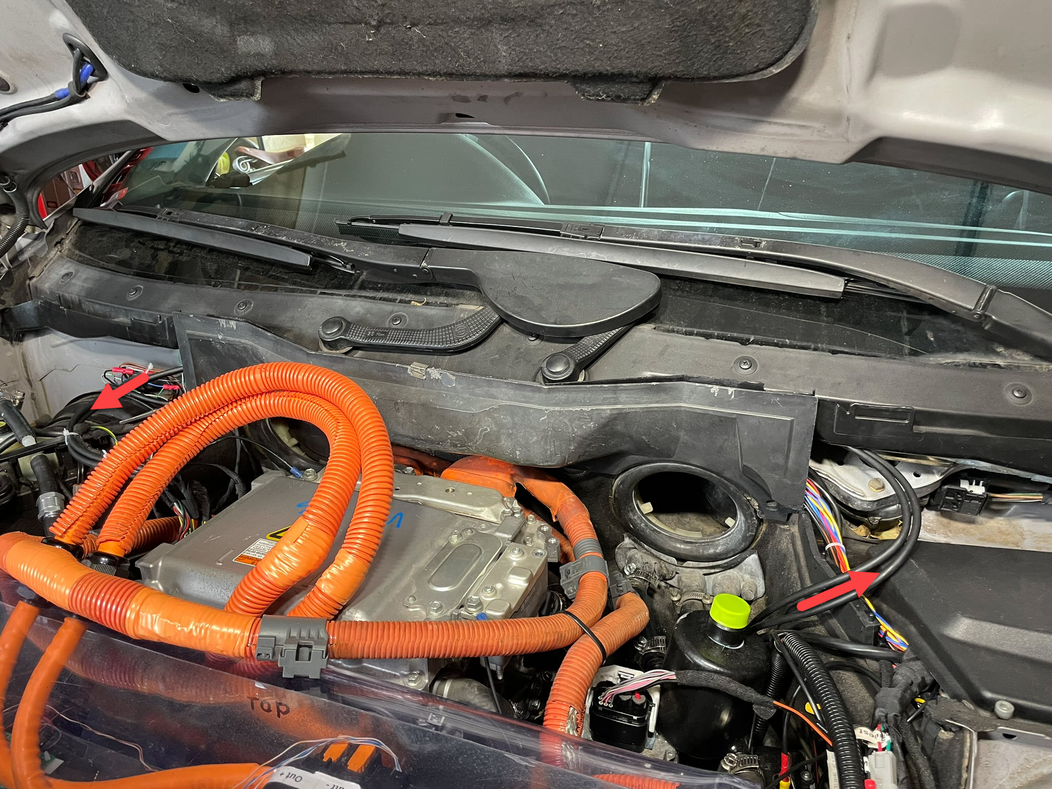

I replaced the shielded resolver cables and moved them away from HV cables. This didn't have much of an effect

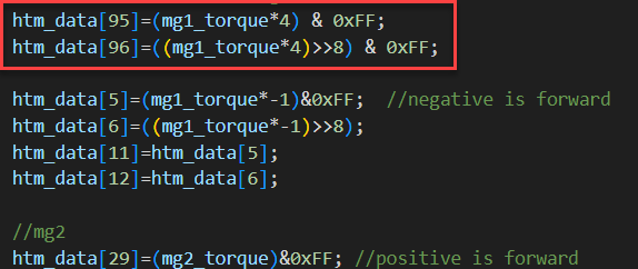

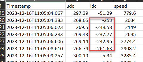

I did some more digging in the Camry logs from @johnspark and found code to unlocking power.
This changed the current draw on MG2 from around 125Amps to 250Amps
The issue with the speed being limited remains though. Might have something to do with the Speedsum HTM[0] but haven't figured it out.
