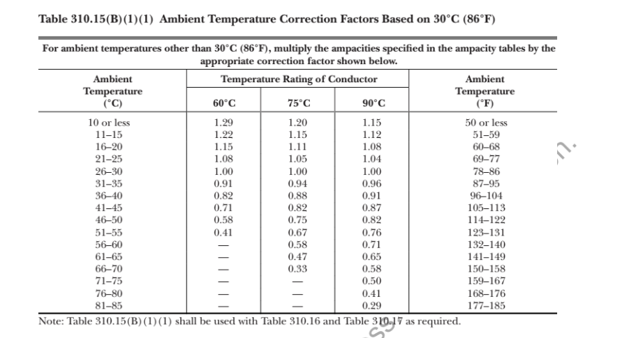

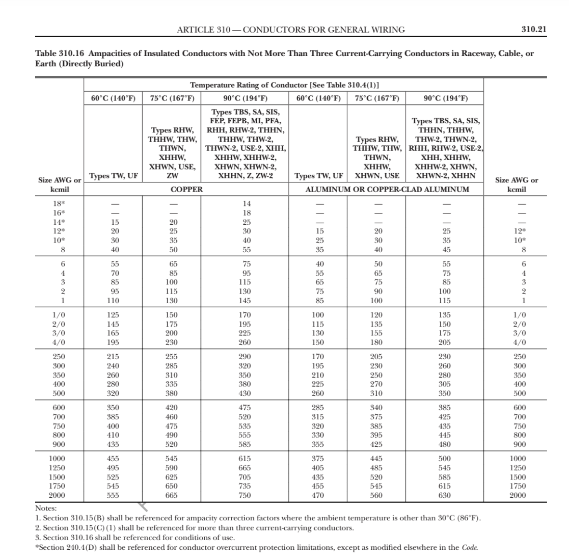

This would be my approach.
To select the conductor size assuming - For US, AC current, 50A max. continuous current in a cable of no more than 3 current carrying conductors (ground is not a current carrying) and with ambient temp of no more than 30C.
Multiply your max current by 125% factor. Then use the NFPA70 table 310.16 based on your wire type (TW, THHN, etc.) - what max temp wires're designed for 60C, 75C, 90C etc. I go with 60C for the wire type not listed - max derating.
Given the above min wire size would be 6awg.
If the ambient temp is above 30C need to use NFPA70 310.15(b).(1).(1) table to de-rate cable capability which will increase the wire size. Ex. if your ambient temp is 40C I'd go to 4awg.
Can access NFPA70 for free here...https://www.nfpa.org/codes-and-standard ... lopment/70
