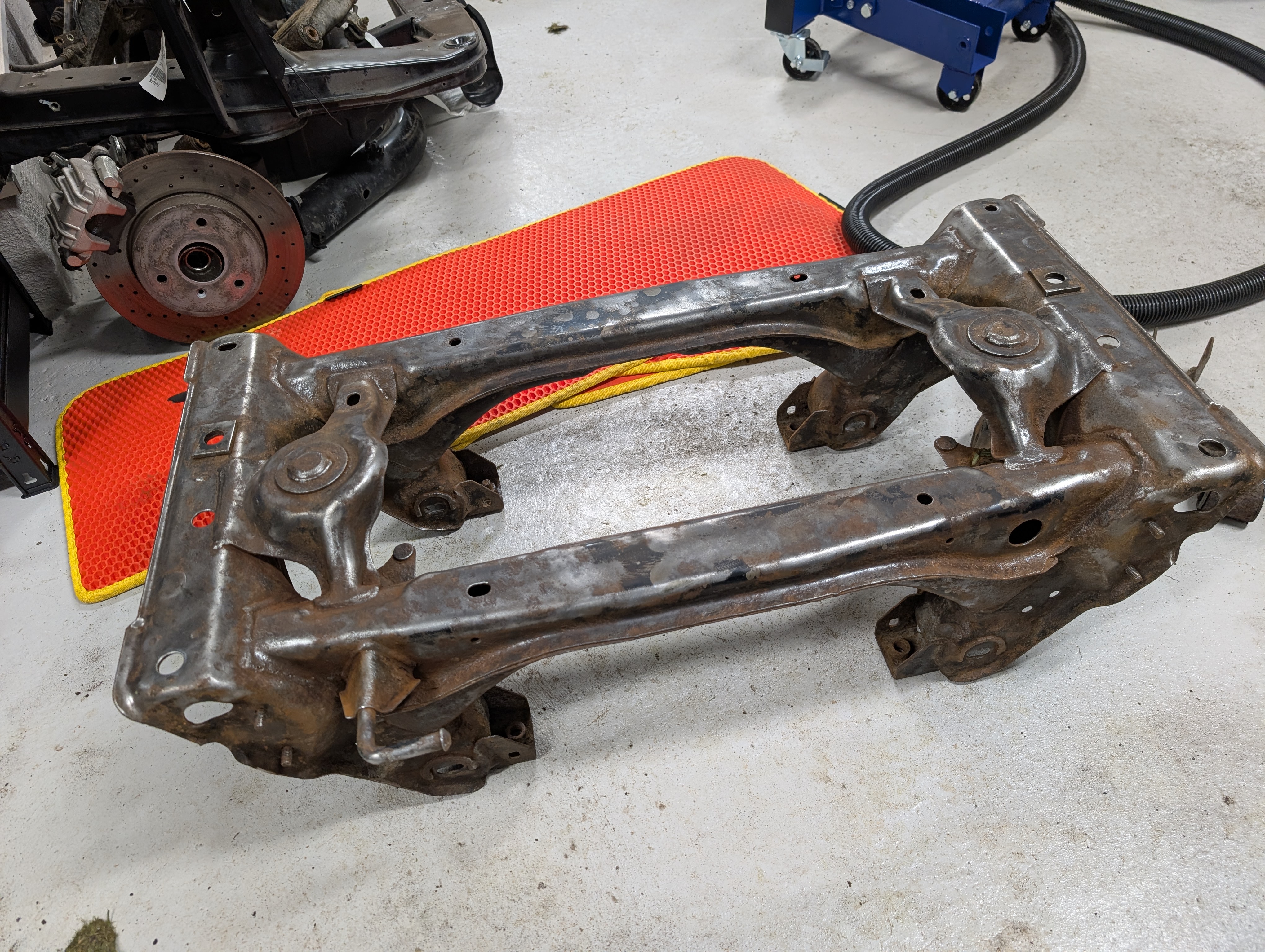

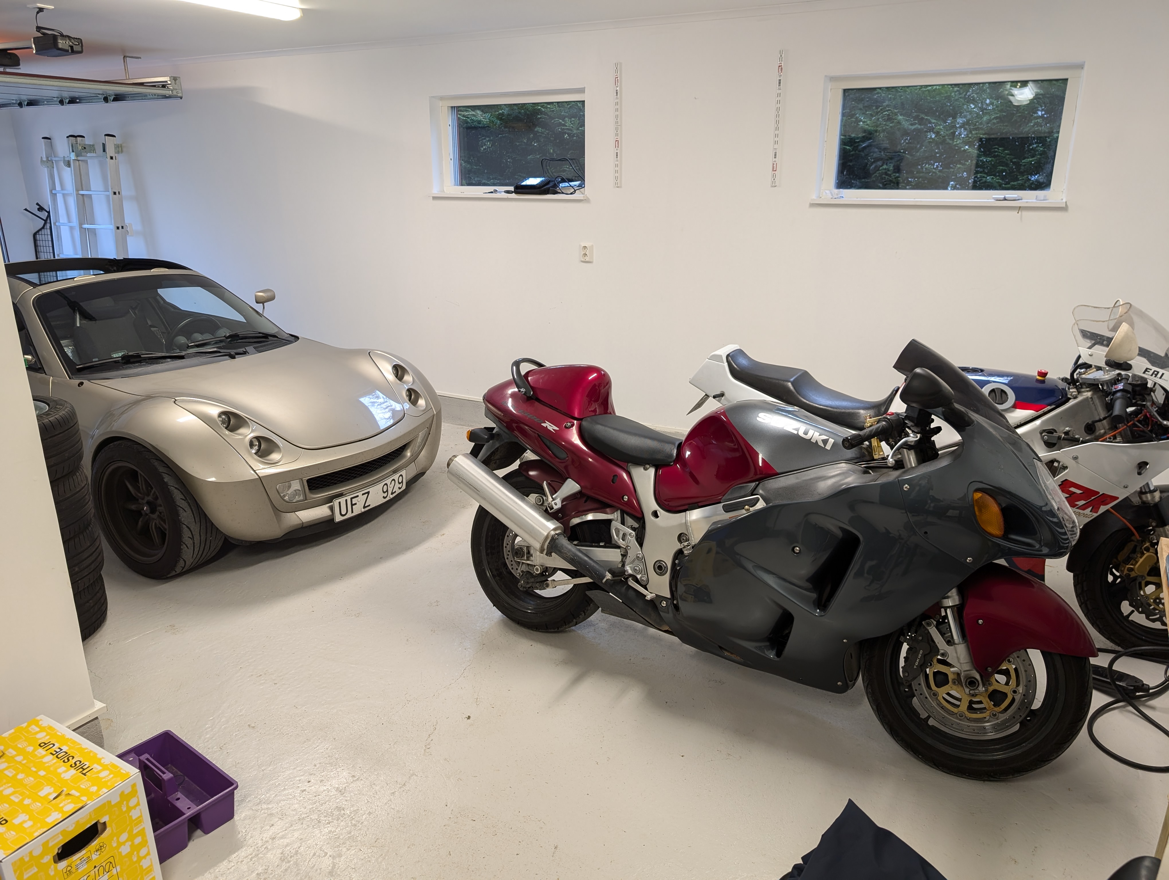

I recently bought a home with a garage and I have a spare rear subframe to build on, so the project has no set time limits. Took me about 5 years to get the motorcycle road legal, and I have no delusions of this going any faster.
I have access to a pretty well stocked makerspace workshop so shouldn't be too difficult to do most of the mechanical stuff.

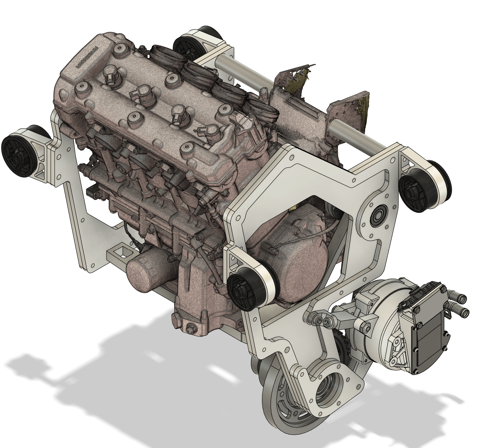

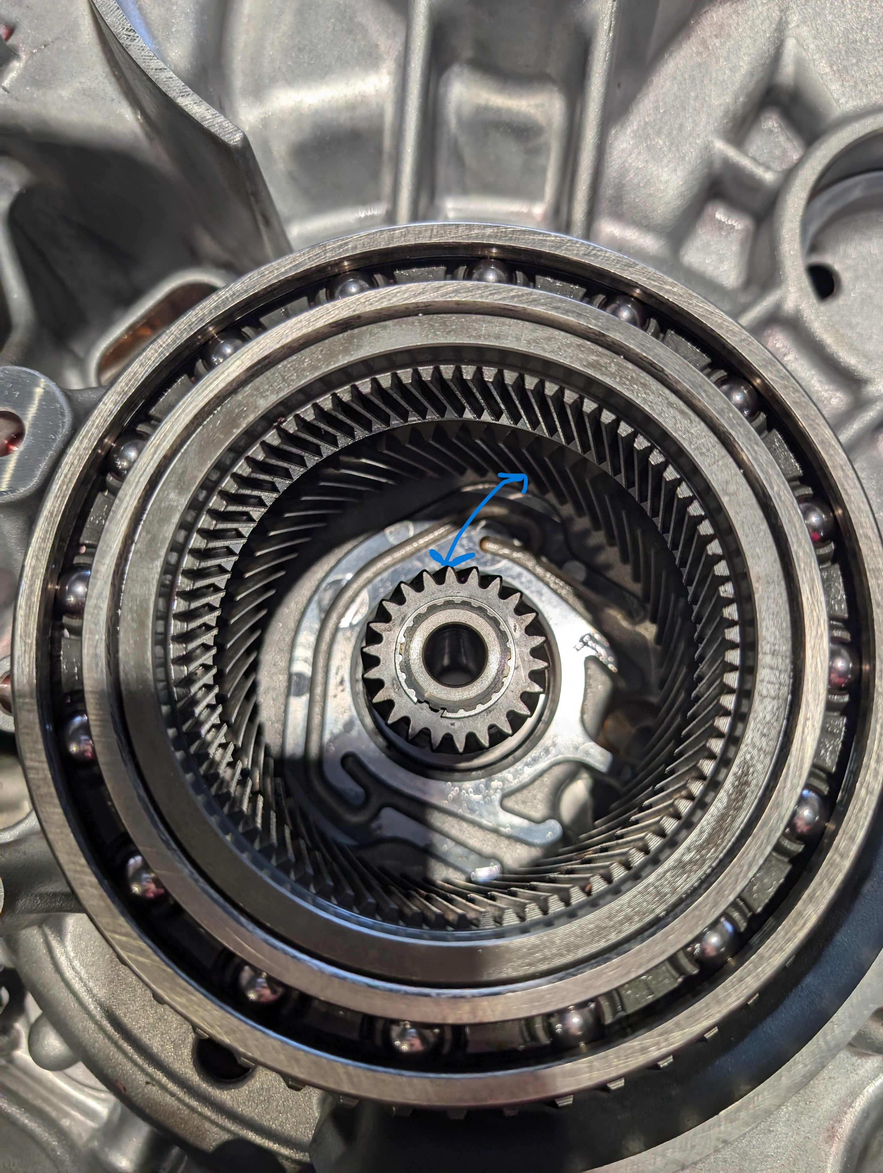

Built myself a working table and picked up some stuff for this project, got myself a Holset HX-35 Turbo, a laser scanner and a gen 3 prius gearbox. Will look into taking the MG1 out of the case and setting it up to run off a bike engine on the ICE input while keeping the MG2. Not entirely sure that's doable since the Prius engine spins at about half the rpm of a bike engine so might be more trouble than it's worth to try to redo the internal gearing etc. But there are limited slip diffs that fit the prius so if it does work it could work quite well. And it would be nice to skip the chaindrive.
I can try to do some half decent scans of the transmission case and throw up here in case people wants.
The electric supercharger/Turbo part isn't a critical part of the project, it'll work quite well with just a spicy bikemotor and a Prius MG2, but to me it's an interesting project. A bit of fun unnecessary complexity.
Prius gearbox cracked open
Playing with the scanner.

Should be fine to run the MG2 with a bike engine just by removing the MG2 planetary carrier and welding those two gears together, and then welding the MG1 planetary solid. Will be a lot of heavy pointless steel spinning, but it should work. Have to double check the gearing to the diff but I think it's a pretty reasonable finaldrive ratio.

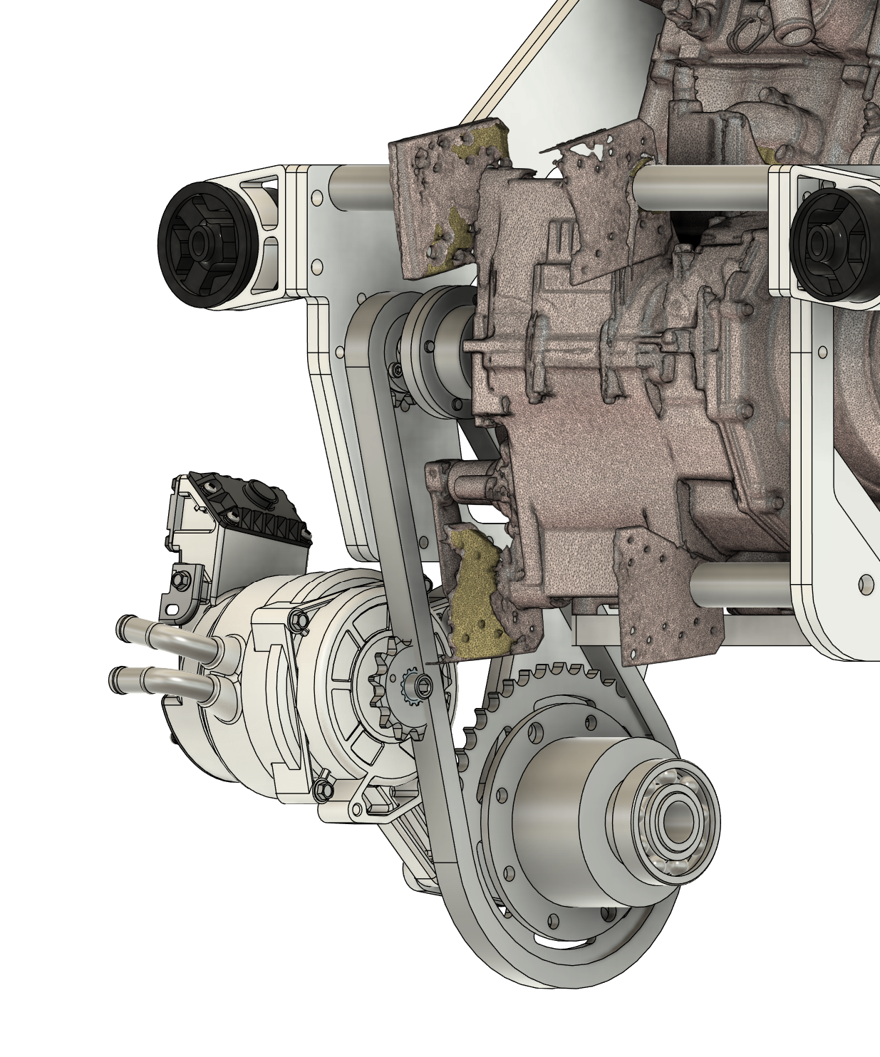

So now I'm back to trying to find a good traction motor and compatible inverter, I'm quite fond of the Prius P410 MG1 motor for use in the turbo MGU-H project so ideally I'd find a good smallish traction motor I could run with the Gen 3 Prius inverter. I have a KIA HSG I could use but that seems a bit too small to add any meaningful torque.
Taking MG2 out of the case could work but that seems like a lot of work. Outlander motors are quite compact and nice sealed units so that would be an option but not sure how compatible they are with the Prius inverter.

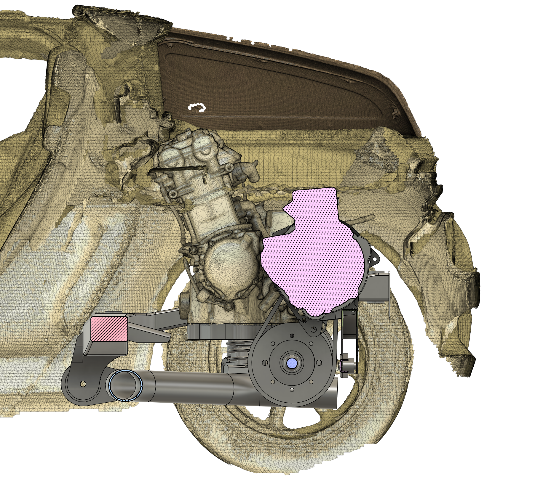

Re: [WIP] Smart Roadster Hybrid

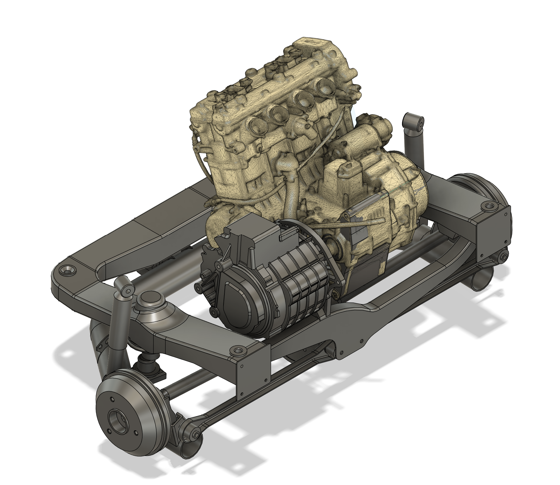

Somethings like that could work, decent amount of space for the inverter and turbo left. That's with the outlander rear motor, HSG is way smaller so could fit in the same config without issue. Would need to do a better scan of both the engine (this is crappy scan I found online) and the car to make sure. Batteries will have to go in the frunk or ideally under the seats.

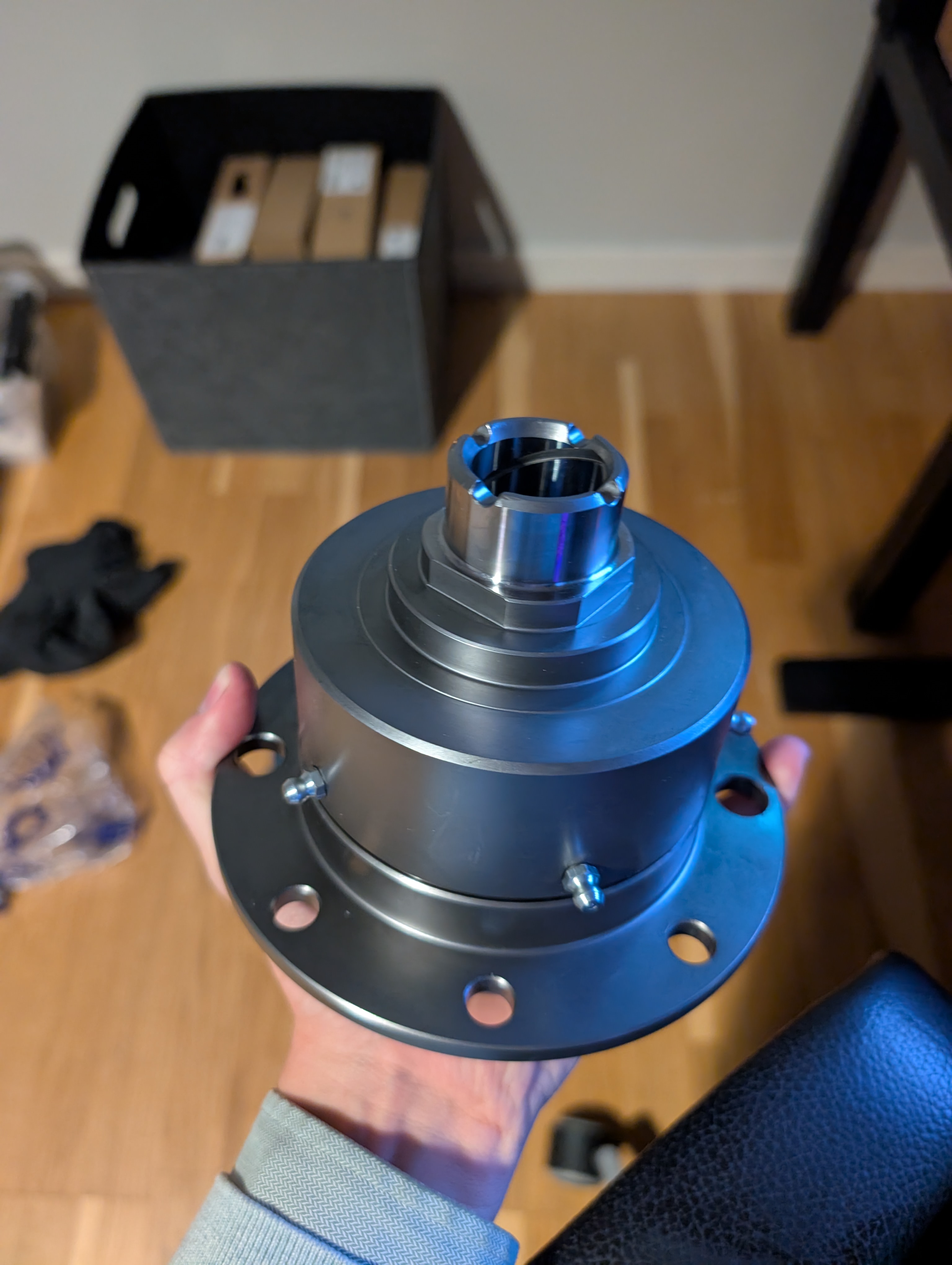

This is an interesting project. I think it's good to electrically compensate for the motorcycle engine's lack of reverse gear. How are you going to solve the differential problem?
- Posts: 10
- Joined: Mon Nov 06, 2023 9:02 am
- Has thanked: 5 times
- Been thanked: 5 times
That design is using Quaifes limited slip differential designed for motorcycle engine racecars.
https://www.demon-tweeks.com/se/quaife- ... q-eqdf7zr/
Hopefully I can integrate the tractionmotor well enough that it'll compensate both for the lack of reverse and the low torque of motorcycle motors at low rpm to make the car more drivable in traffic.

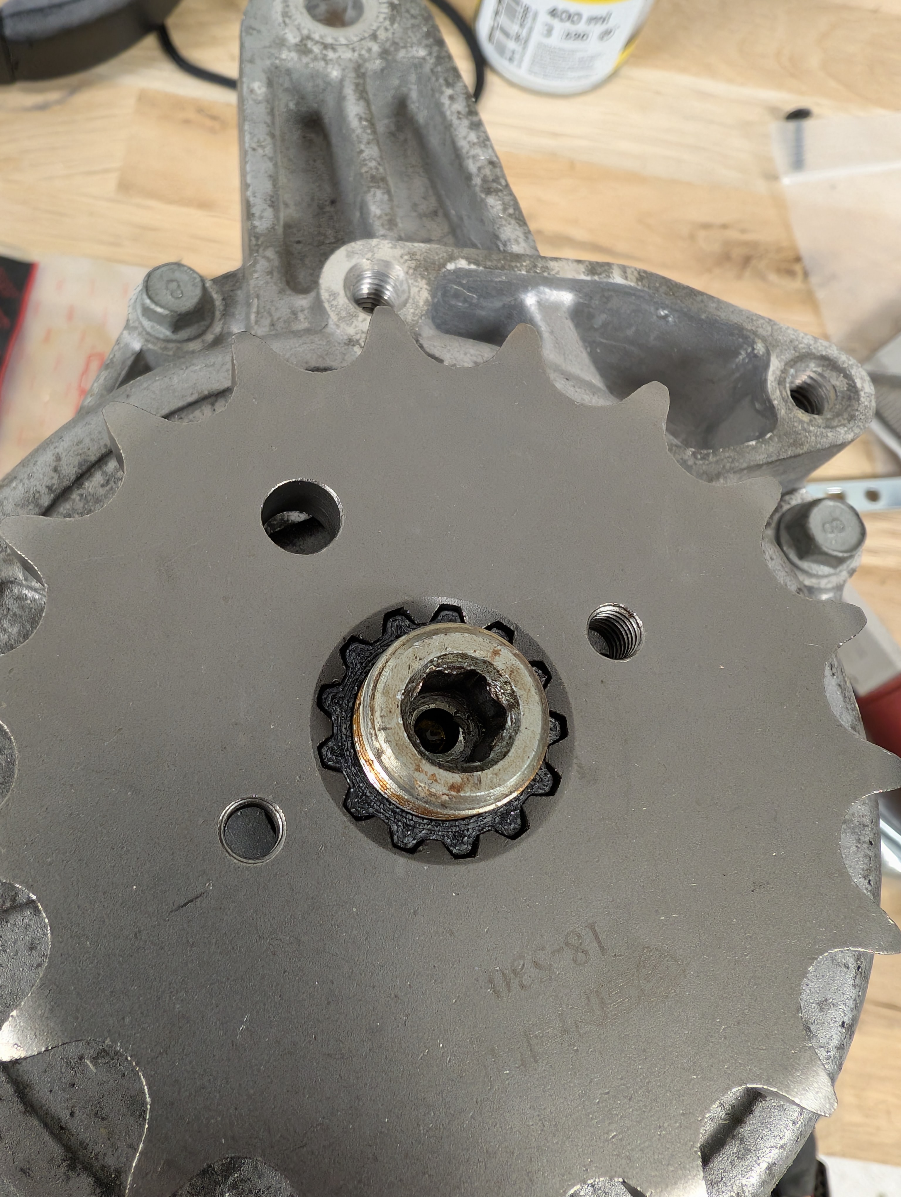

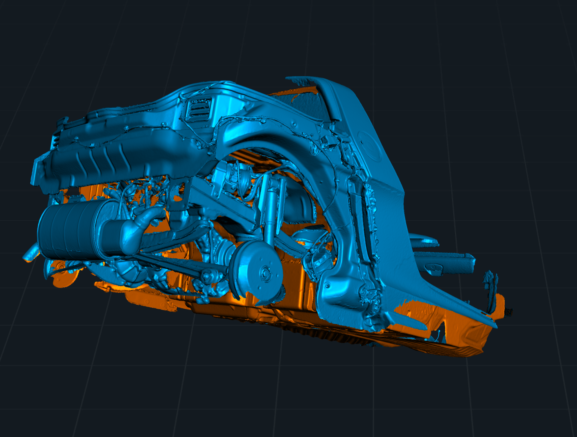

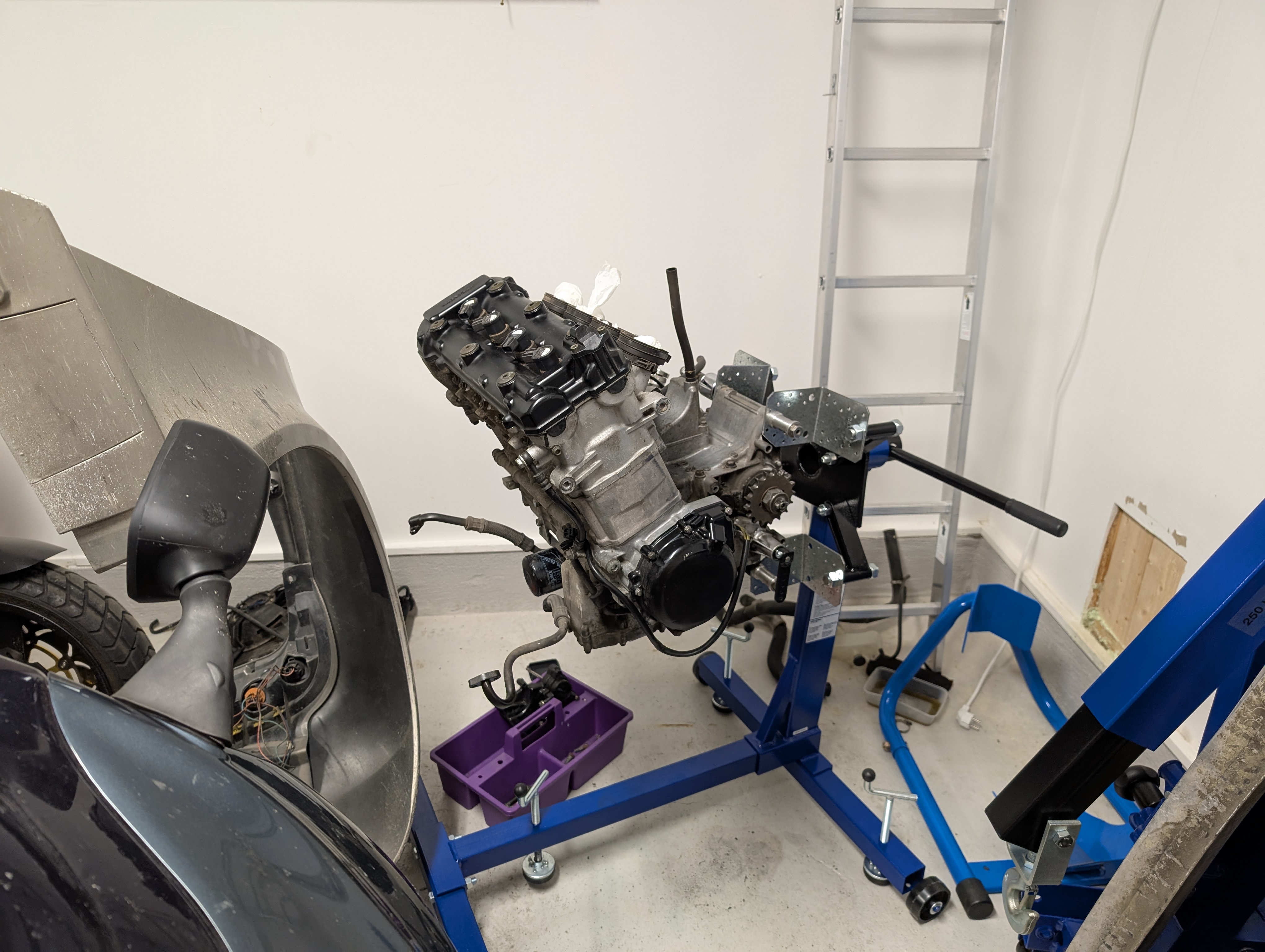

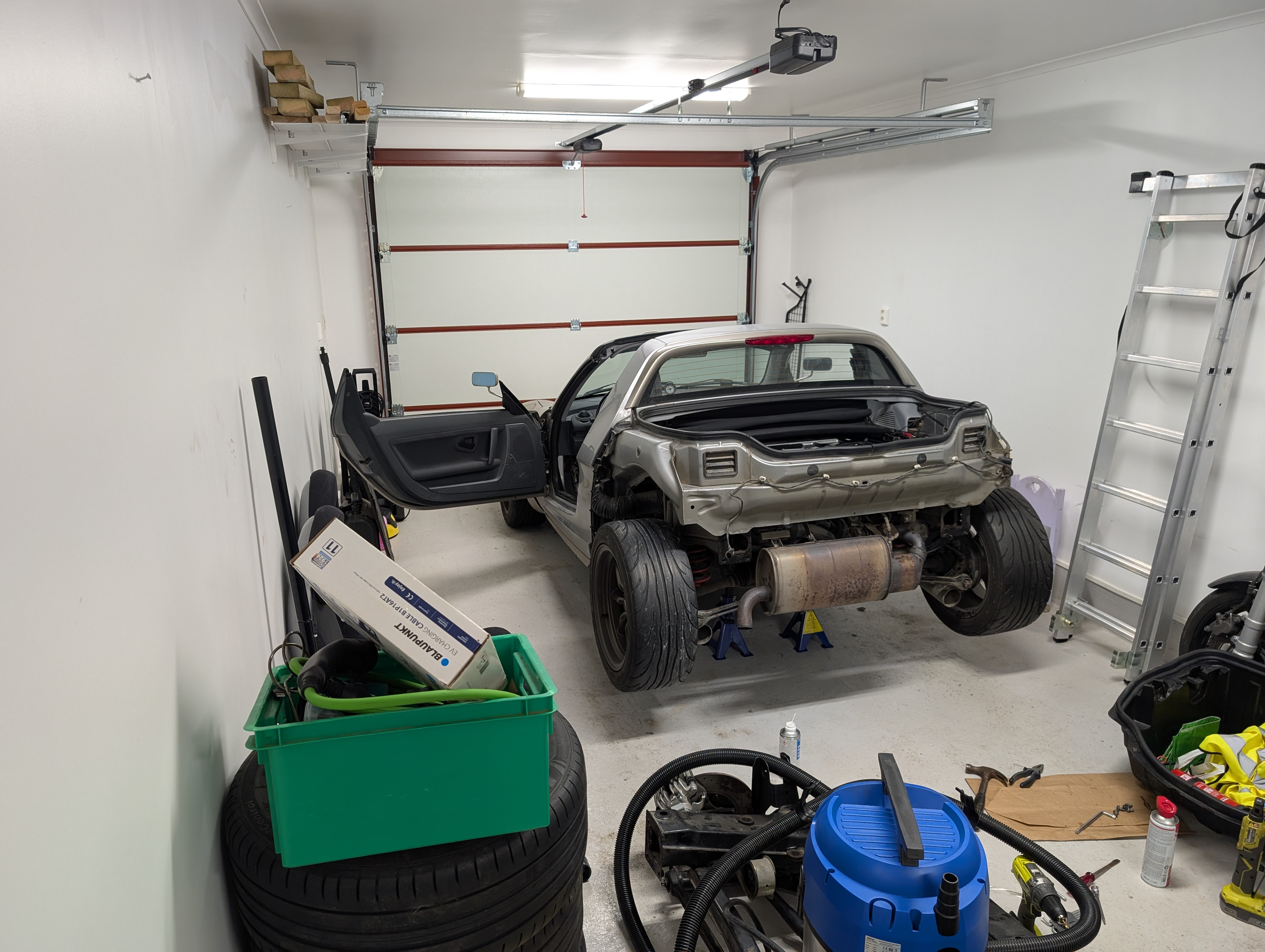

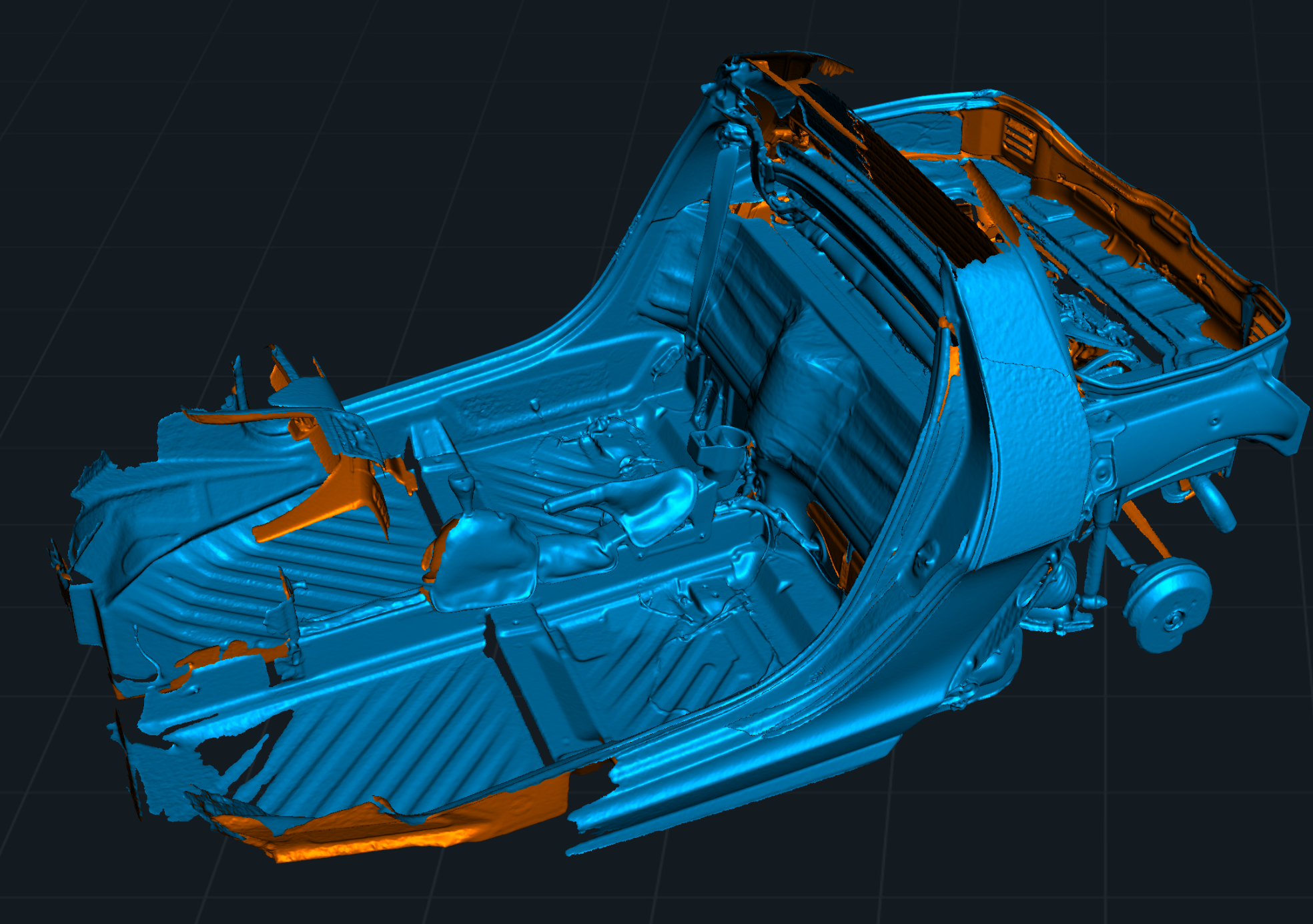

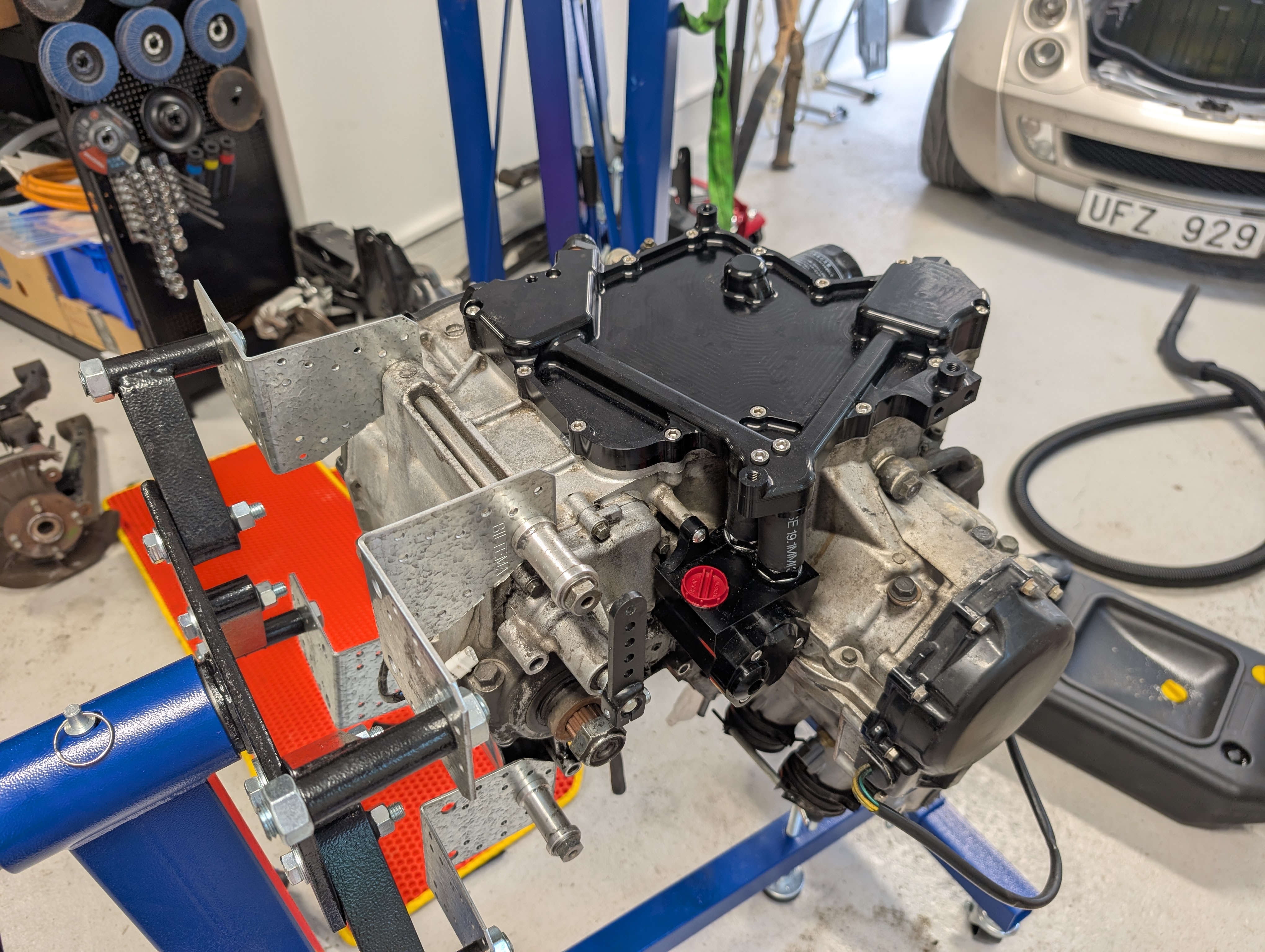

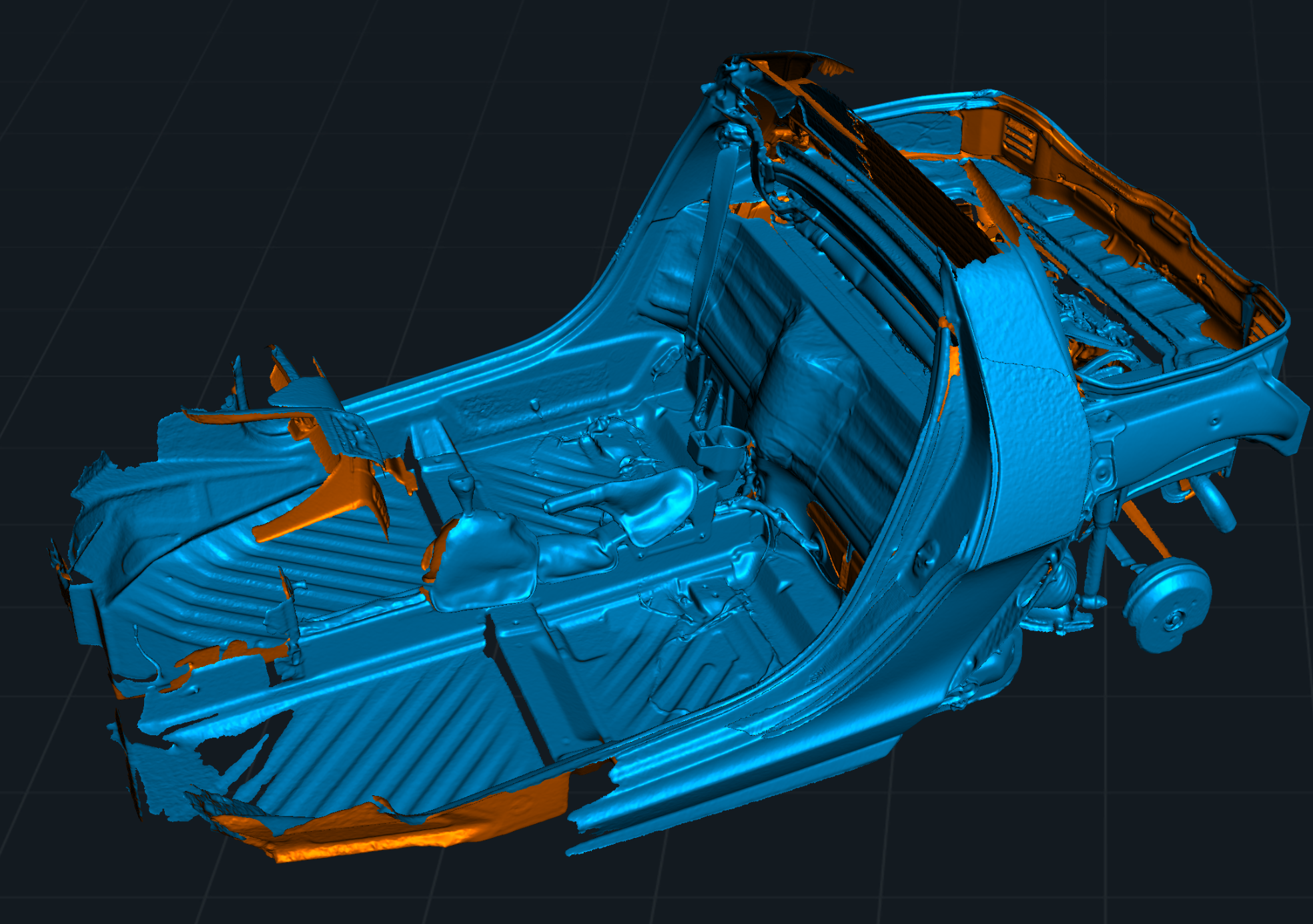

Got the engine out of the bike and started taking the car apart for more scanning. Leaning towards trying to run with the Kia HSG to start off with, if I manage to let the magic smoke out of it I'll pick up a beefier motor.
Car on sketchy stands without the rear bumper.
Hayabusa engine out of the car, it looks way bigger now than it did in the bike.
Scans using the Creality otter with the wireless attachment and a phone, still need to get myself a garage computer to do proper scan work in there. It seems a lot worse than using it plugged in to a PC but at least it gives workable results.
