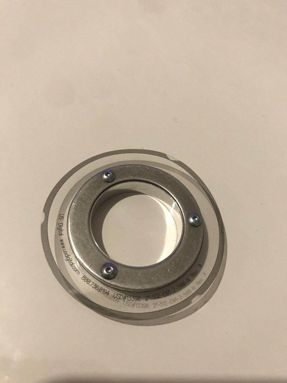

I had a similar issue too. Nothing was happening at high RPMs, even at full throttle. But it was tripping at very low speeds. Later I found that it was my encoder (US Digital E6-512-984-NE-S-D-D-B).
Inside the encoder, there is a nylon disk (photo attached). It was directly coupled to the rotor shaft. Turns out that the encoder cannot go above 80+ degrees. The disk curled a bit due to the heat from the motor and after curling, due to the friction between the optical sensor and the disk, some lines on the disk were removed. As a result, it was reading momentary but huge speed spikes. Like 6500 RPM instead of 500 RPM. So I replaced the encoder and coupled the new one with a different coupler, no issues so far.

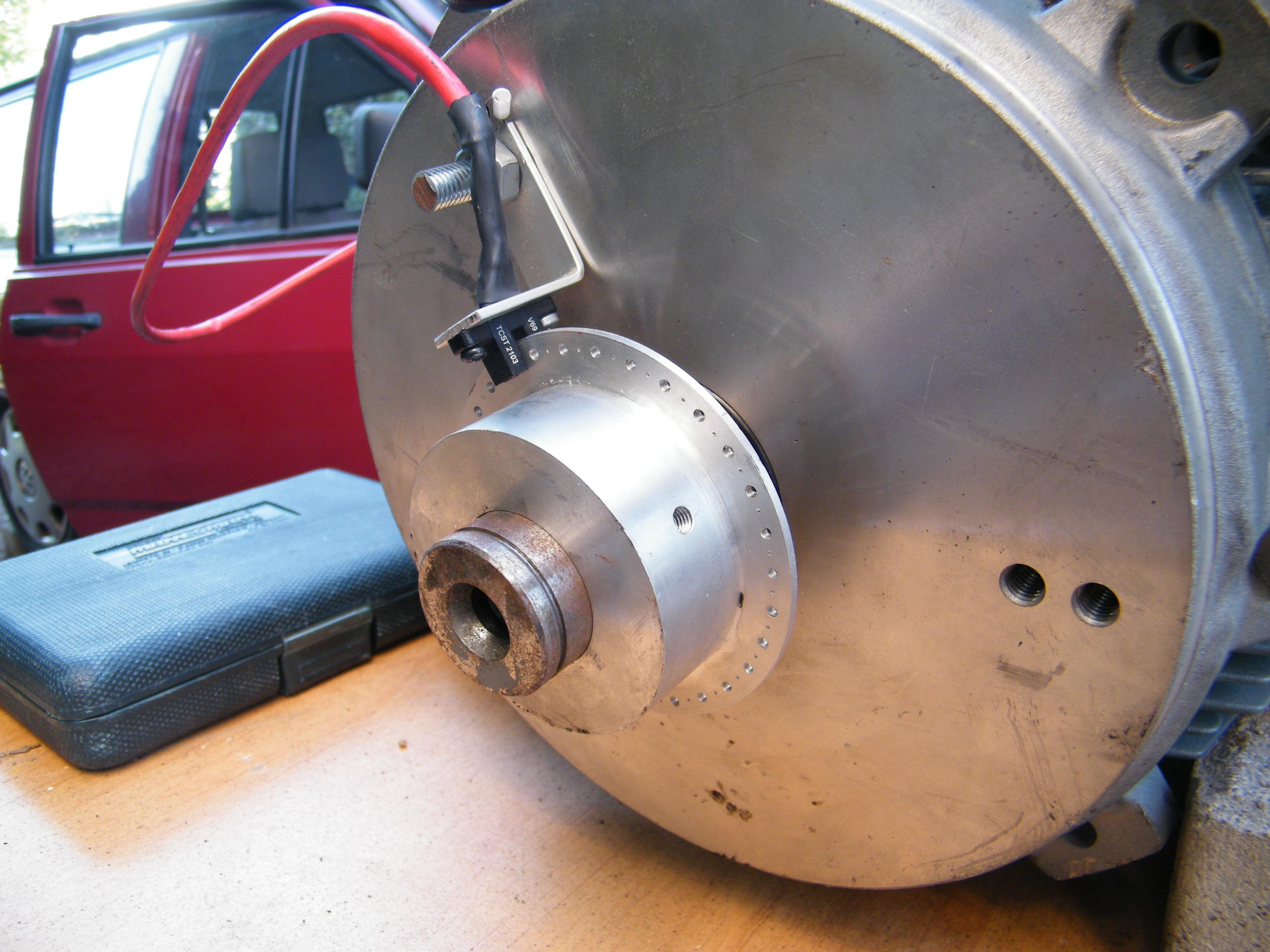

Yes, but my sensor is totaly enclosed and is automotive inductive sensor. This should mean it gets funny ticks only after signal enters the main board.
