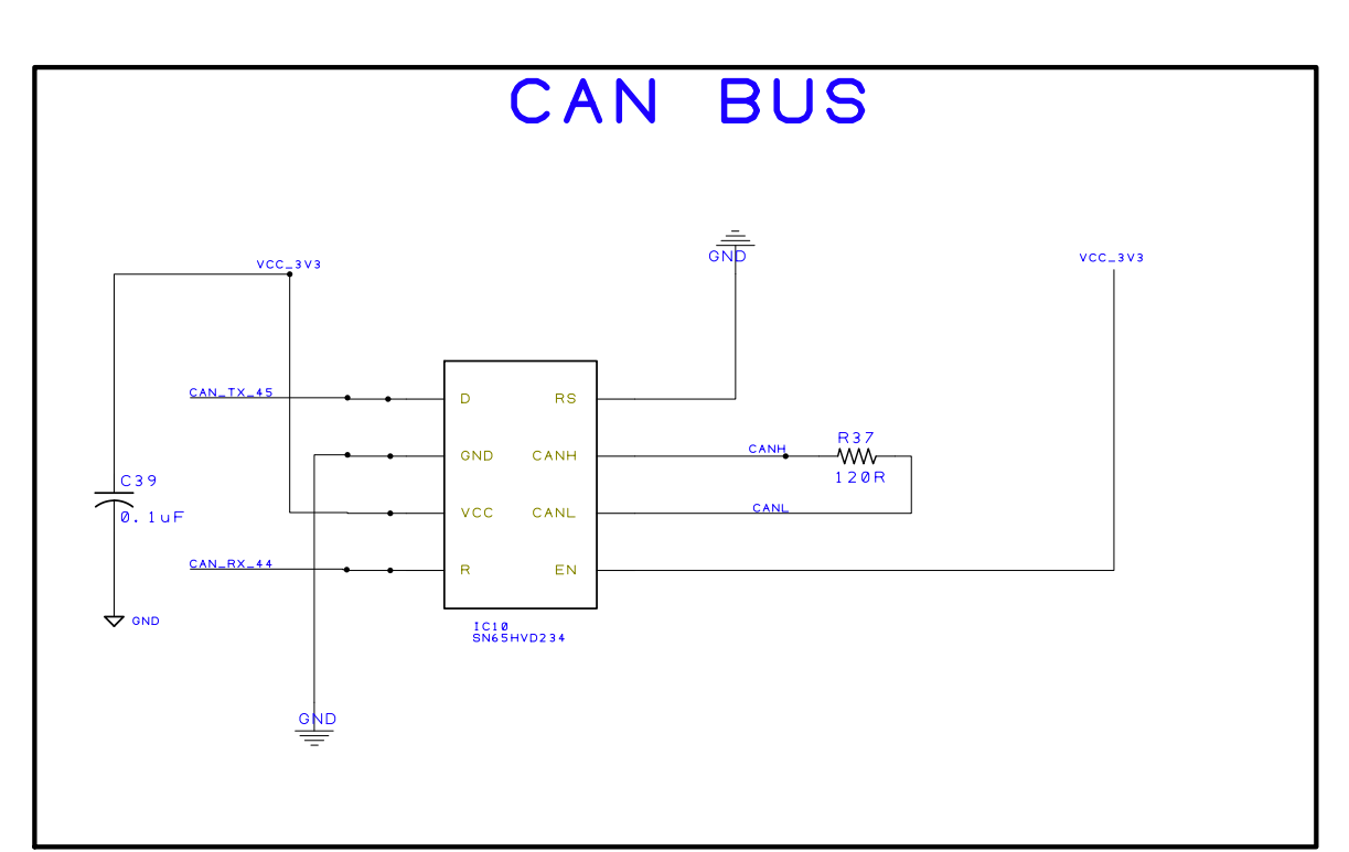

Hello folks.
A quick confirmation. If my SDU isn't the last device on the CANbus I just need to de-solder the R37 terminating resistor?
Posts: 6745
Has thanked: 380 times
Been thanked: 1568 times
Re: SDU CAN bus connection
Yes!
