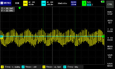

Hi Everyone, I have a small problem with my Rev2 Inverter. 5 years ago, after building the kit, it would run the (Enova) motor ok on basic tests. The motor has been fitted in the car for a while now, but I cannot get it to run. Nothing obvious (to me) has changed. Has anyone got any Ideas??
The motor turns freely by hand ( or at least by screwdriver through a hole). I'm using 39v from batteries via a 15A fuse, to test.

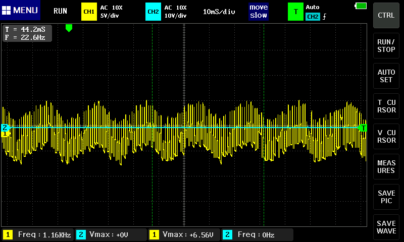

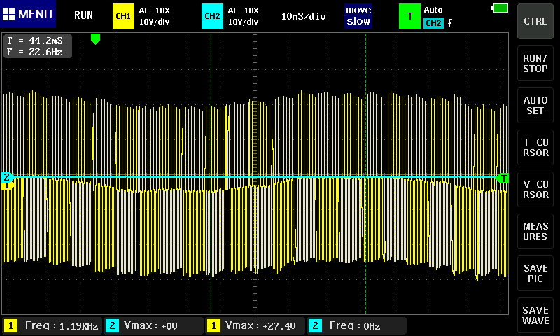

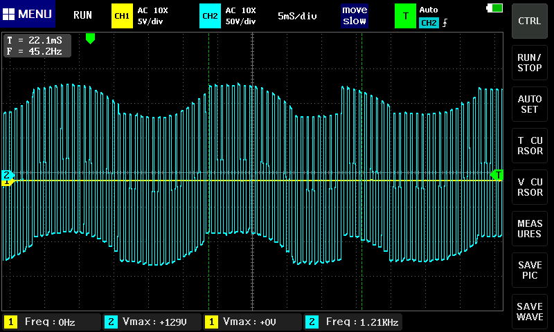

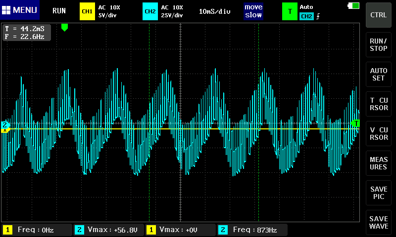

Checking waveforms, I get more of a triangle form at the gate driver input (see pic) and (to me) a peculiar form on each of the phases to the motor.
All my readings/waves are the same for all of the 3 inputs/outputs. What am I doing wrong? Thanks in advance for Any ideas.

These are the latest waves - fweak 10, fslipspnt 10, ampnom100 voltage and freq can be seen on lower screen.

Damien had problems with the Enova motors where the resolvers got lose and I think the cable was either unshielded or the shielding was attached somewhere where it would pick up noise from the inverter.
There are some videos from him about the topic, you should find them when searching for "Enova" on his channel: https://www.youtube.com/@Evbmw/search?query=enova
Other than that: Is the gate driver voltage the signal from the Open Inverter board to the gate drivers or the output of the gate drivers to the power transistors of the inverter?
In every case the high and low voltages should remain pretty much constant and not have that "secondary waveform".

Without knowing parameters we can only guess. I suppose boost/fweak must be changed to match the low voltage
