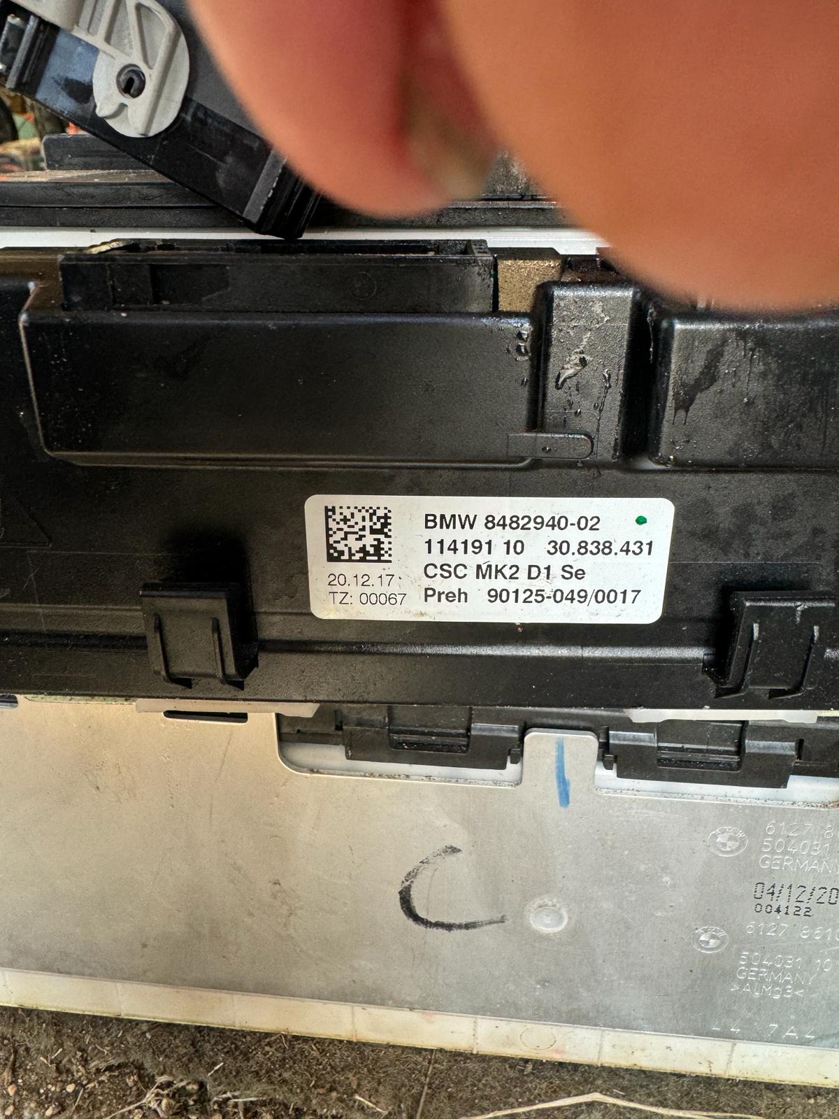

do you have a picture of one ?

andybpowell wrote: Mon Feb 26, 2024 1:32 pm do you have a picture of one ?
it's a close up of the info panel - best i have to hand

From photos here viewtopic.php?p=61468#p61468 your rear pack is gen2. Gold coloured covers on modules and white cmc on the module marked "6".

Yea you really need to decide if they are all black or not as shown in the picture, I'd hope BMW would have keyed the connectors so they are not interchangeable but you never know and plugging the wrong modules in could prove costly

I'm guessing from the picture you supplied earlier that you have gen1 on the 1.5kwh modules since it's dated 2017 and gen 2 on the 2kwh

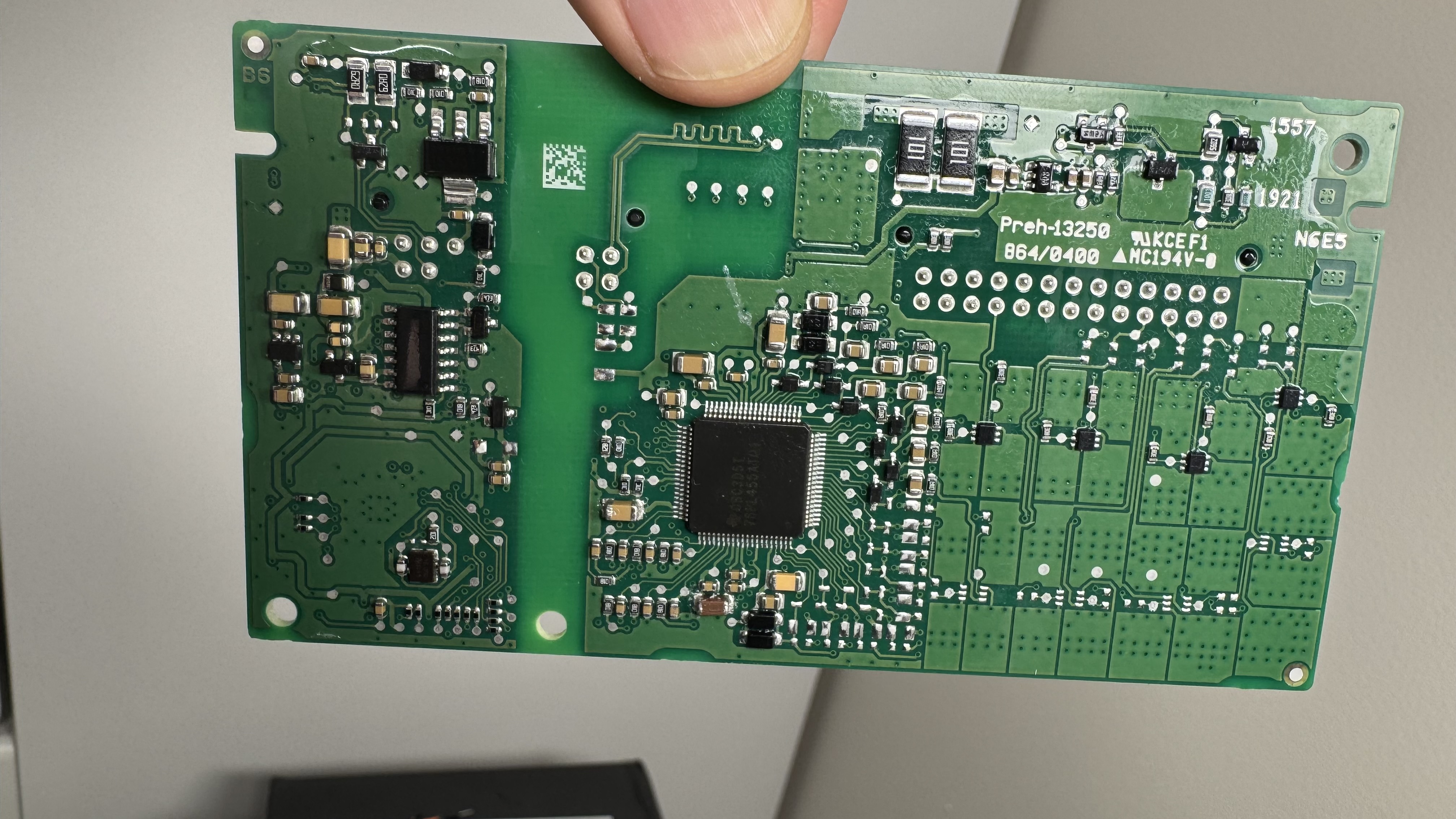

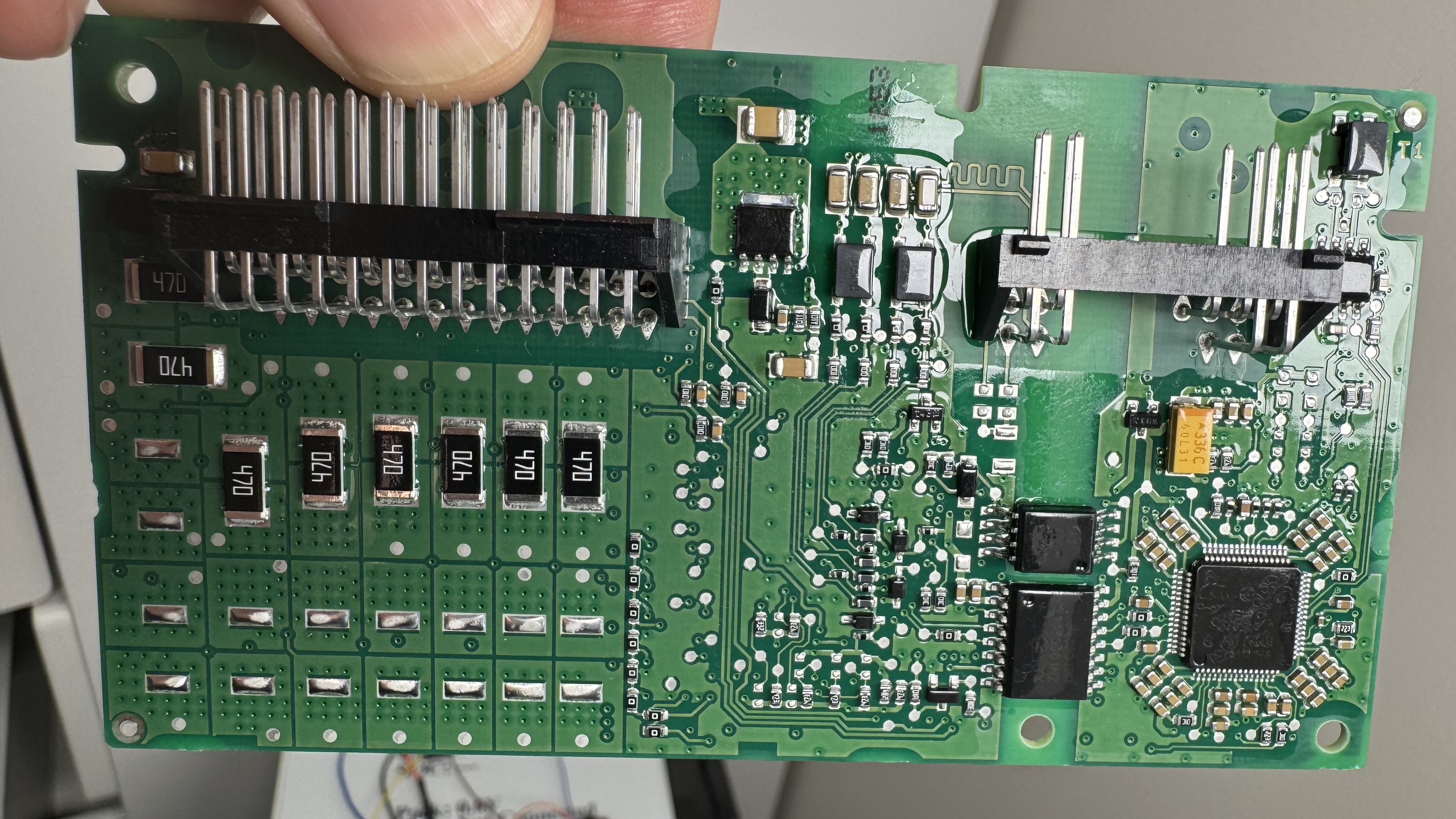

I’m unfortunate to join this thread. I accidentally gave 12V for the master slave (gen2) and now it won’t respond
to can messages anymore. It pulls power about 0,6 amps and about 1A when giving interlock 5V. Can bus shows steady 2.5V all the time but won’t respond to any messages. I think I might have fried something but when looking at the card, I can’t see anything burnt or smelly. It’s X5 pack with 12 modules, master is white and others are black. Now I wonder what to do. I don’t think bmw sells these from the counter?
Here’s two pics of the board.
Any ideas? Anyone have one to sell?
